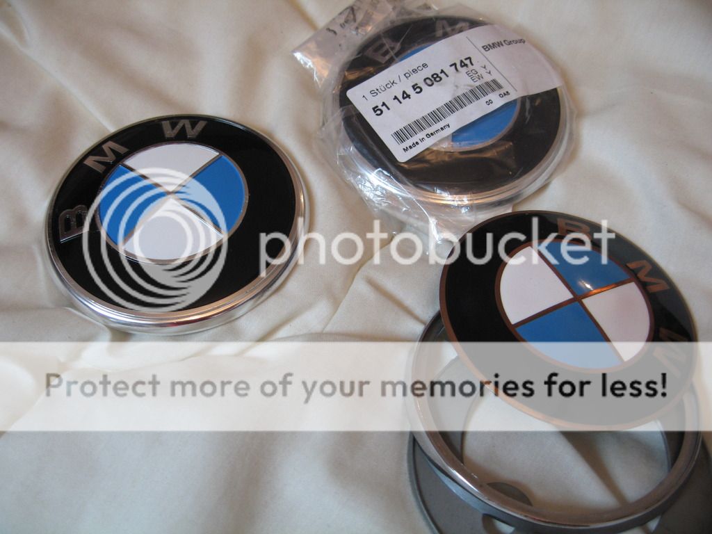

Correct REPLACEMENT hood(bonnet)/trunk(boot) roundels
Thought this may be of interest to those wanting to replace their old, worn-
Hood Roundel:The original was in 2 pieces: I am not sure what the part number for the roundel is but it is NLA. Roundel 51 14 5 480 181 which is RAISED letter and die-cast painted metal is supposed to be the replacement if you have the separate base (socket) 51 14 5 780 170.
Of note....I ordered "181" to use with an original "170" base and it was just slightly larger diameter (by a millimeter) to fit into the indentation in the socket.
REPLACEMENT hood roundel with an integrated base: 51 14 5 081 747 is RAISED letter and PAINTED.
Trunk Emblem: The original was in 3 pieces: Roundel 51 14 1 813 833 is NLA. The Base 51 14 5 780 171 and Gasket 51 14 5 780 172 are available.
REPLACEMENT trunk roundel with an integrated base: 51 14 1 872 327 is SMOOTH and ENAMEL.

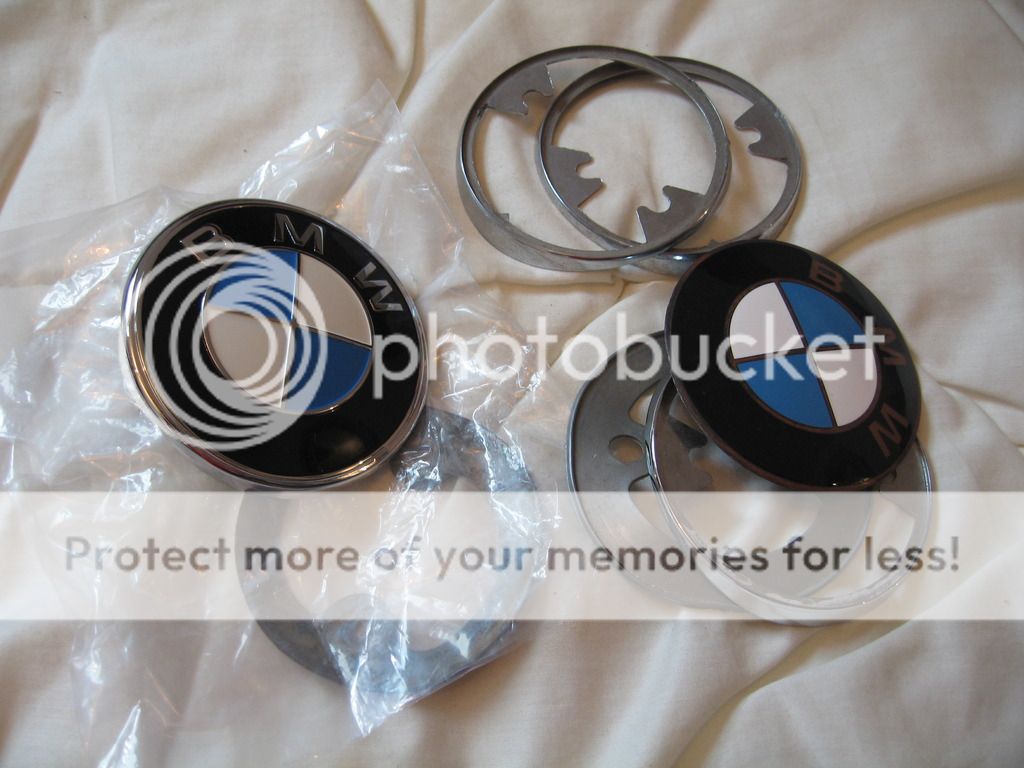

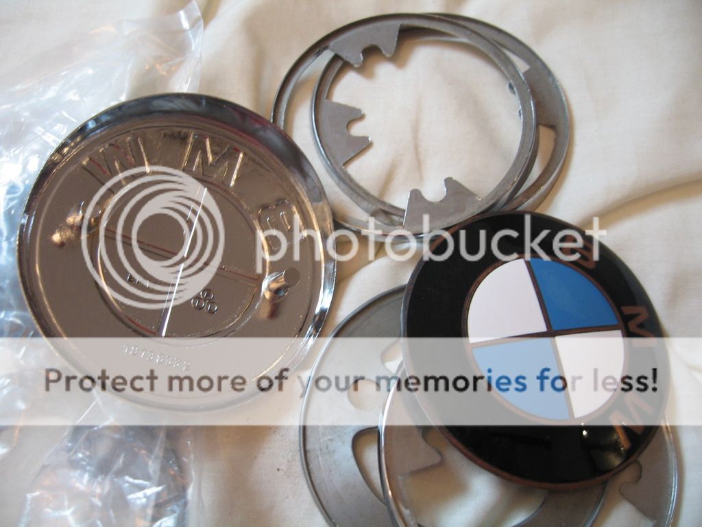

Just in case there is some confusion....
Here ae a couple of pics that show some bezels and roundels... (part of my collection)
(Pic w 6 items)
Upper left: one piece raised letter roundel with integrated bezel. has part # 00095808103
Upper center: OEM front bezel
Upper right: OEM rear bezel
Lower left: OEM raised letter roundel (no bezel) part # 0009580811.4
Lower center: OEM raised letter roundel (no Bezel) part # 1811992.4
Lower right: Gasket
