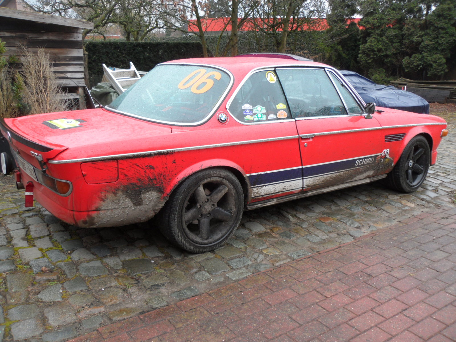

after the rally last saturday again some mud pleasure ... enjoy ! :D

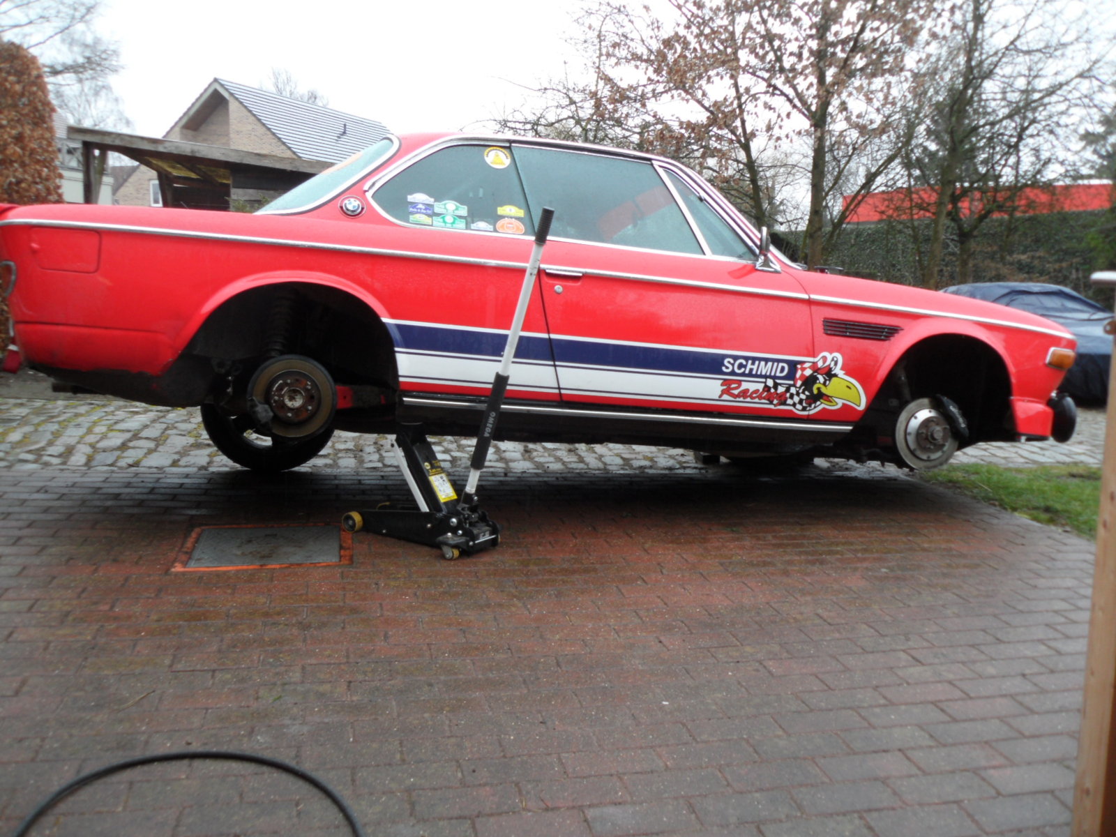

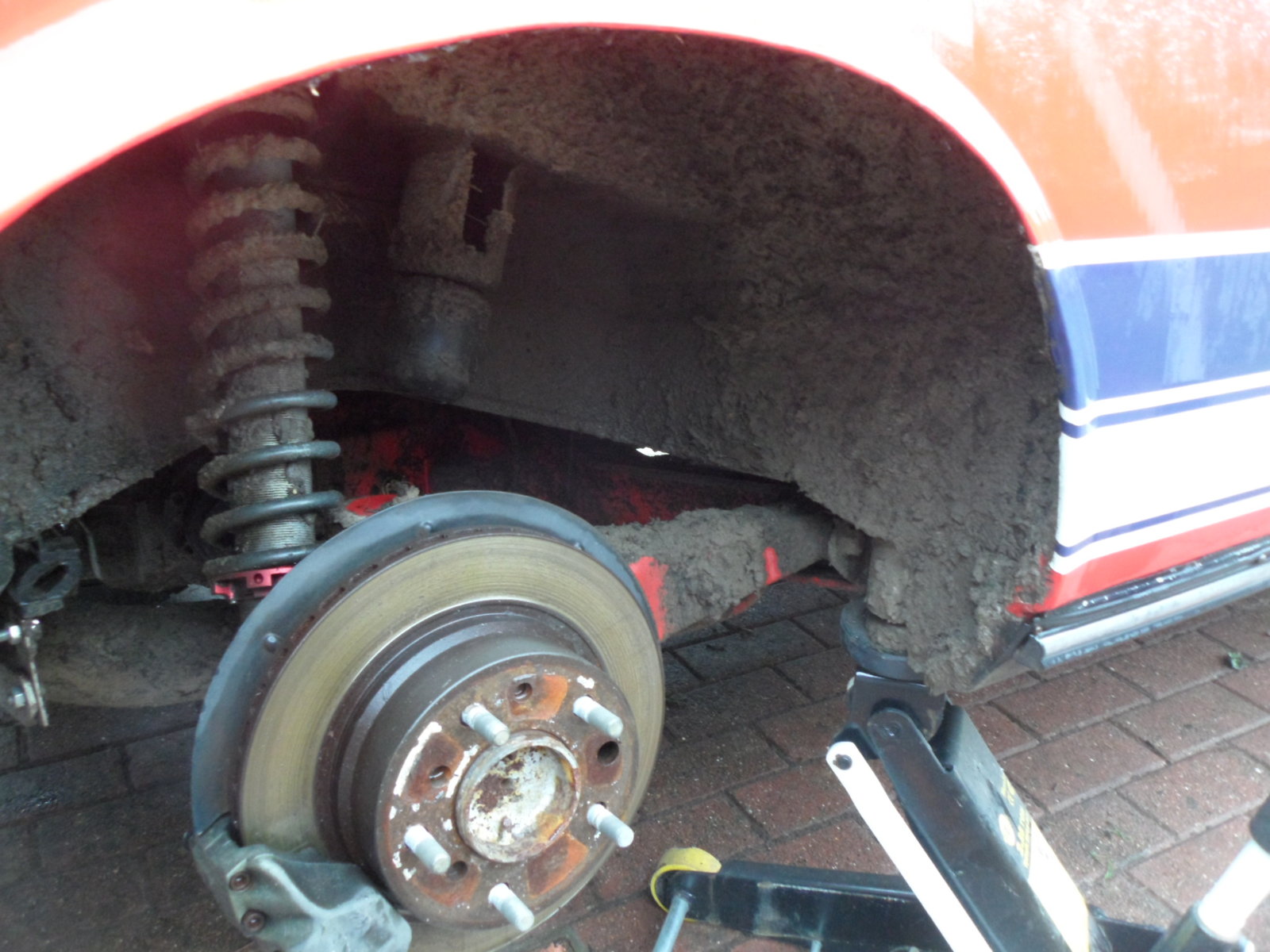

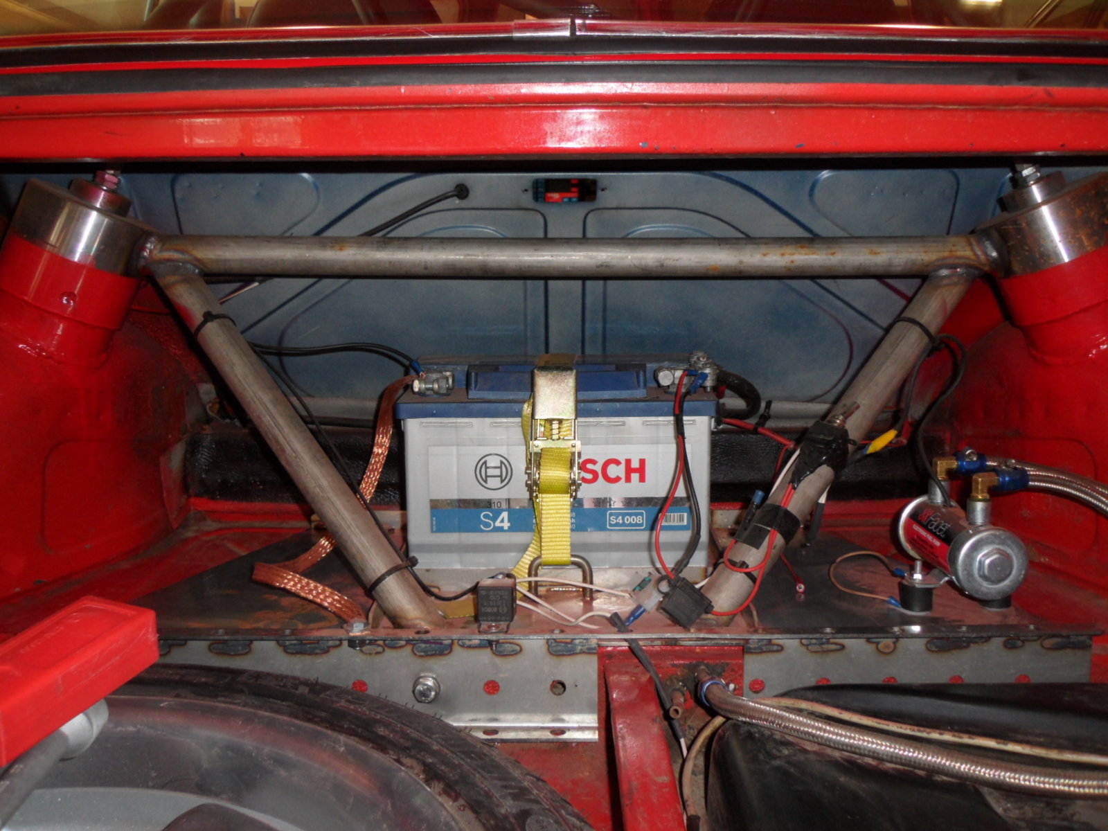

@Belgiumbarry
, very surprised about the way you lift your car
so you use that point and you lift all the way up until the front wheel can be removed ?
essentially you are putting all the stress on the rear seat frame and then on the rear wheel arch that is connected ?
is there any effort going to the rear subframe, and through it to other left part of the car ?
do you use other alternatives ?
thank you for your thoughts
Indeed deQuincey , i lift it on the rear suspension support untill i can also remove the front wheel.
I think ( hope :)) that this must be possible without harm compared to the way we drive those cars.... on offroads the bumps are harder than this "gentle" push ....
ofcourse i have some reinforcement tubes in there :D
