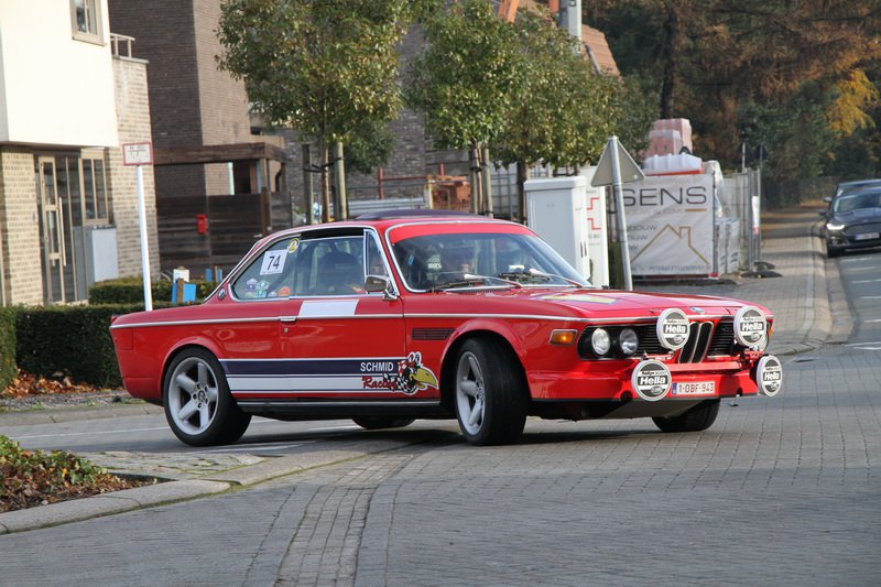

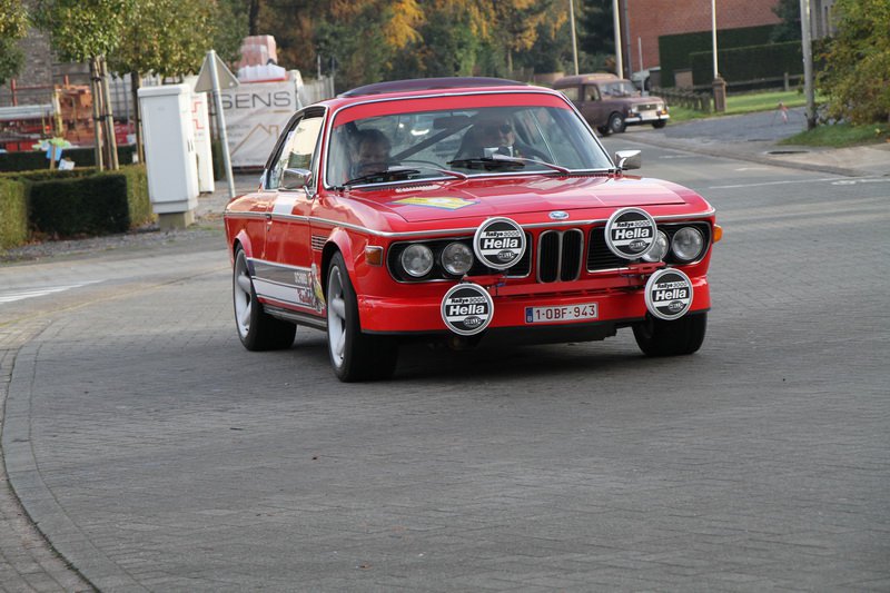

last Saturday we drove a rally in Flanders .... all went well , we ended 16 on 64 cars. Nice warm weather and a good rain shower from time to time :)
pitty the journalist took some easy ( for him ) spots for pics .... there were so many more "spectacular" off road places.... perhaps he didn't wanted to go to far from a pub.... :D
thanks Philippe.... indeed one of our best results ever. Navigation methods aren't simple and sometimes one needs some luck.
First time also i really took T's and crosses very sharp.... and indeed , we noted 3 control letters which you don't see turning in "regular"..... a bit of a game in the game :) ( also ofcourse to get the speed down for safety... most of the route is public road )

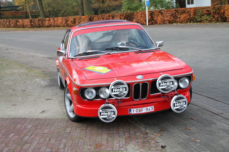

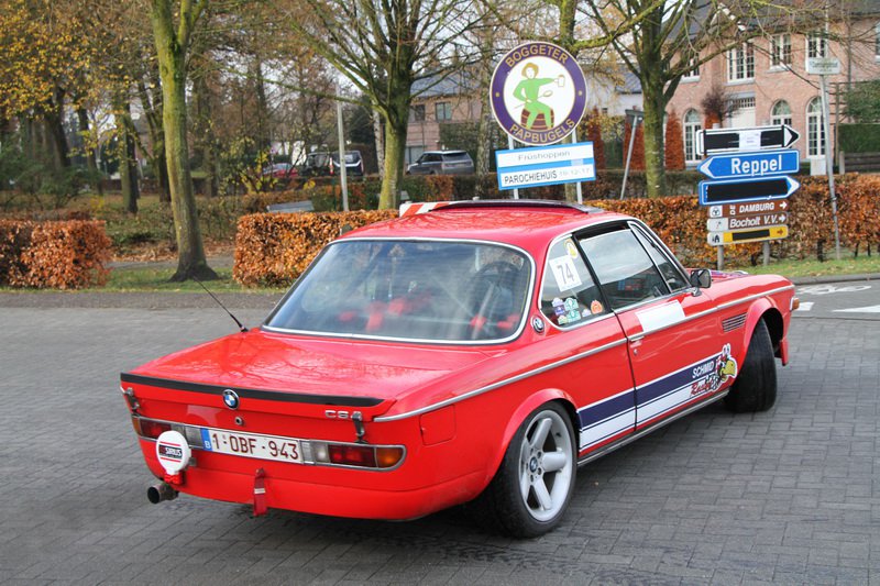

here we had to return as we had no exact distance ( copilot did not correctly tim the tripmaster at zero). We had to take a right turn at 1.85 km but there were 3 possible streets on the right side to take in not 100 meters apart.... That was just after the start of a special ... so the pics from the organisation. :oops:
It's fun but one must always be alert, those roadbooks are full of tricks....

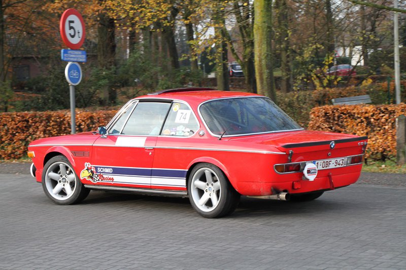

i do actually prefer my other set Schnitzers , with a polished rim outside…. just a visual "taste" , they are the same dimensions. I had Kumho semi slicks on them but as we don't drive rallys during summer , we see more often some rain or even snow and sure mud ! So i just got them also to Michelin Alpine tires changed. I will use that new set end november on the Ypres Regularity rally.
actually , those wheels were now the problem at Ypres Rally Regularity this weekend …. i broke 2 rims cutting corners.... :(
Friday night the first , lucky at the end of a special stage , so we could end it and replace during "service" time . As we had no service crew i had to be careful for the remaining specials.... as my spare wheels were at Ypres i my car and trailer.... we ended 37 on 84 cars.
Saturday morning… the same again !, had to replace on the special stage , and now we had to do still more specials without spare wheel… so no more cutting corners. We ended 51 …
Sunday , with again new spare wheel :), all went well and ended final 45. Pitty , without our wheel problems a place around "30" had been possible , was also our "goal" .
