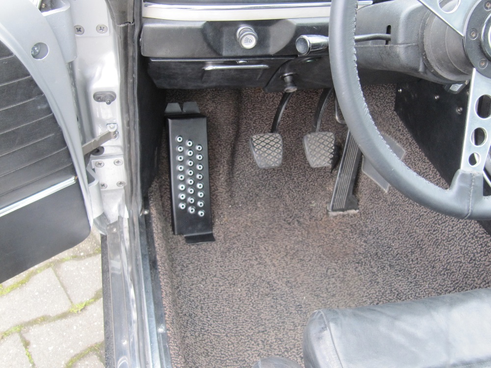

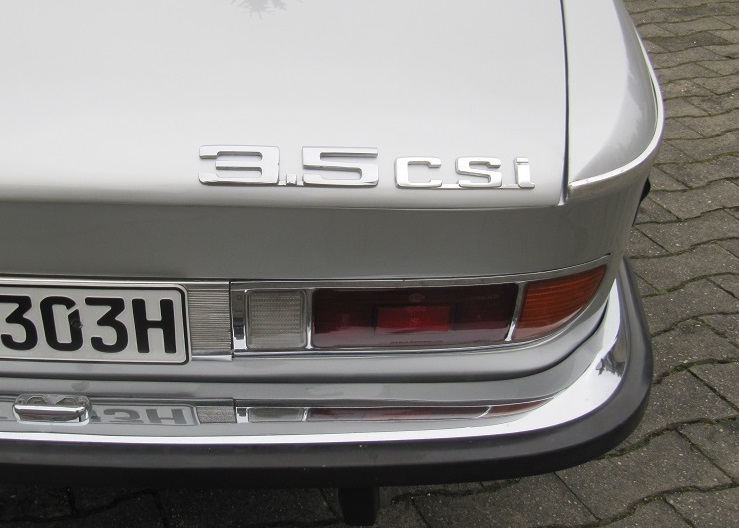

so, looking forward to the coming season after I did the first couple thousand miles on my coupe without major problems.
It's quite amazing, that people have a big smile in their faces and give me a thumbs up while recognizing this "old lady".
Even though she's driving really nice, it's time for an engine swap back to where I originally started with the B10 engine. Therefor I already did the most important preparation to the car and put on the apropriate bagde to the trunk lid.
engine will be a 3,6 litre Motronic with a "bit" more torque than the actually installed 2,8 litre LJet.
Together with a long rear axle (3,07) it'll be a hugh improvement for the cruising abilities :razz:.
And because the left foot might be not that often used with that power train, I added a ALPINA look a like foot rest.
I did it myself and like the sporty touch of it.
cheers
