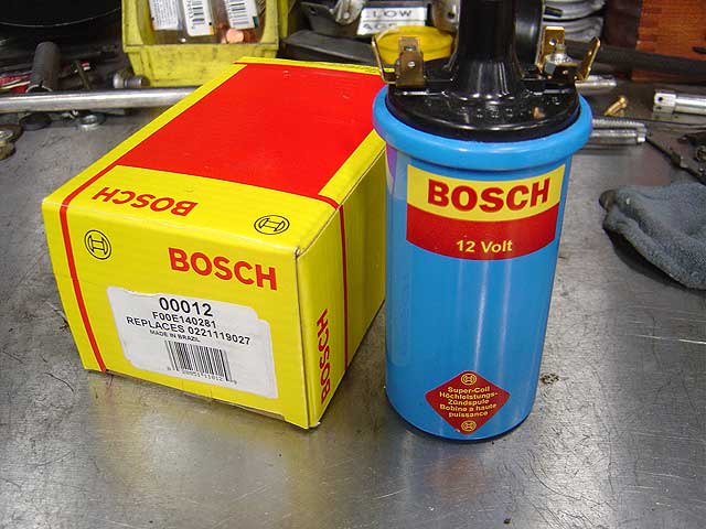

My resistor fell apart. Can I just use ANY universal one?
My recommend: Get a Bosch Blue Coil, and at the same time get rid of the ballast resistor.
Note: you can run a blue coil with the resistor but it will limit the spark, i.e. you do not need a ballast resistor with a blue coil. Since you're looking at both the resistor AND your old coil, just get a new Bosch Blue Coil and be done with it...hope this helps
