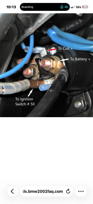

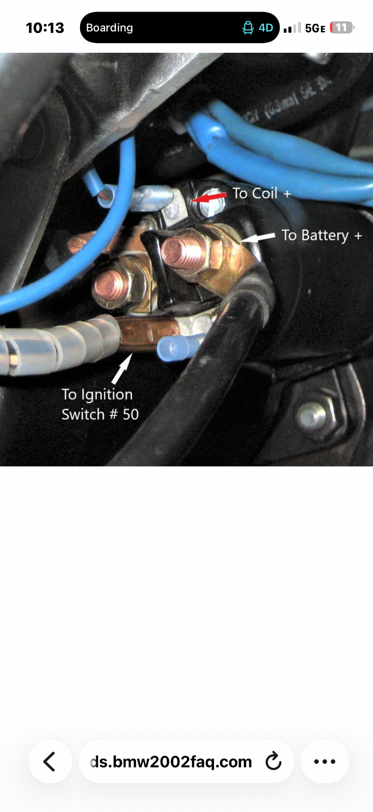

Here is a photo that someone on the 2002 forum posted with the new-style starter (SR44xx). This one shows wire to coil going from that 12:00 spot. Question I suppose is whether it’s hot truly “all of the time” or only when ignition keyed on. When I had black/red wire to ballast hooked up to that 12:00 the ballast got red when key was turned to any “on” position so I would suspect the latter. I’m also assuming that I want to run wire to coil from that spot, as shown. But again, going to confirm all of my wire colors and match up to schematic since the CSi seems to have slight variation

Trust me it is hot with ignition on! I don’t know what that terminal would be used for. On the old starter it is only energized when cranking to bypass the ballast.
Why would you run a wire from there? The green wire is in front of the radiator. The CSi is no different from a CS.
from Don’s post earlier, and confirmed when he was walking me through this a week ago via FaceTime, there does seem to be some difference in the wiring since there’s a wire running to the computer and to the cold start relay that is part of this circuit. As he noted, I need to find the djet schematic and make sure I know what goes where. Once I understand that, the question will be mapping that “original” wiring onto this new-style starter. Once I have it figured out I’ll be sure to post the solution here so the next person isn’t struggling the way I am.
as i see in the 2002 pic - the 12:00 wire is black / red ... which would go to the coil. that wire follows the same path in the harness as the green wire - along the radiator wall.

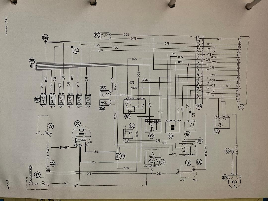

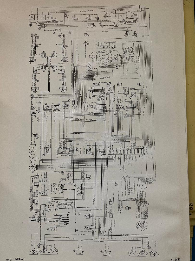

since JC wanted to look at d-jet diagrams - the blue book has a few different things.
there is an overall 3.0cs / csa / csi (61-0/42+ 43) that doesn't really show d-jet
there is 61-0/38 + 39 which shows the wiring of the d-jet
there is a d-jet blowup 61-0/45 (which follows the USA 3.0cs (with wipe + wash interval)
Need to spend a bit more time here but I already have one answer - the wire that I also have hooked up to the battery 30 is to the main relay, as shown here

The top stud is hot. It has a black/green wire going to it on later Motronic models

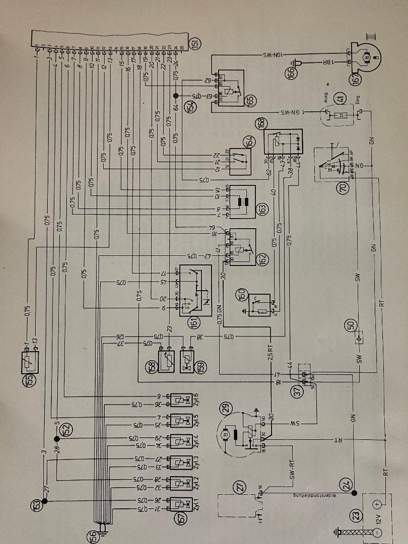

so I’ve been studying the schematics since @rsporsche was kind enough to post them. So as I understand it, turning key on to second position but not to “start the engine” activates the ballast resister along the green wire. When you twist the key to actually start the engine, the ignition circuit sends signal to post 16 of starter along black wire, from 168 (plug connector) to starter (27). Attached to starter on post 30 is battery in and black wire out to main relay (162), from which power is sent on to the fuel injection system which would appear to be an “always on” connection. Twisting the key to start position activates post 16 pulling in the solenoid and connecting battery to post 50, which then send signal directly to the ignition coil along black/red wire.
So at the moment I do NOT have any black/red wire connected to my starter. I have ignition circuit in on post 16 (6:00 position) and battery and main relay connection on the same post 30 terminal. If on the new starter that 12:00 position is hot all of the time, then what serves as the switched-on post to which the connection to the starter attaches? In other words, on these new starters what does activating the solenoid do in terms of turning on one of the contacts? I thought that turning the key activated the starter and concurrently activated the ignition coil to then go through the work of activating distributor.
In looking through some on the 2002 forum who have used the SR444x or 441x starter, they have removed that black/red wire from starter to coil and instead have run a wire from (in their case) fuse 12 to the coil. That is an ignition-activated fuse so turning key to start sends signal to starter to turn and then concurrently sends direct signal to ignition coil rather than going through starter. I suppose I could create the same setup, just need to determine what wire would correspond to that ignition-switched wire that I can run to ignition coil.

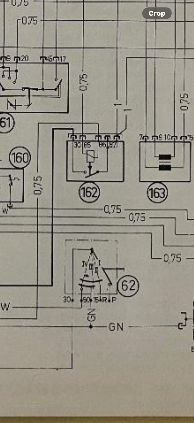

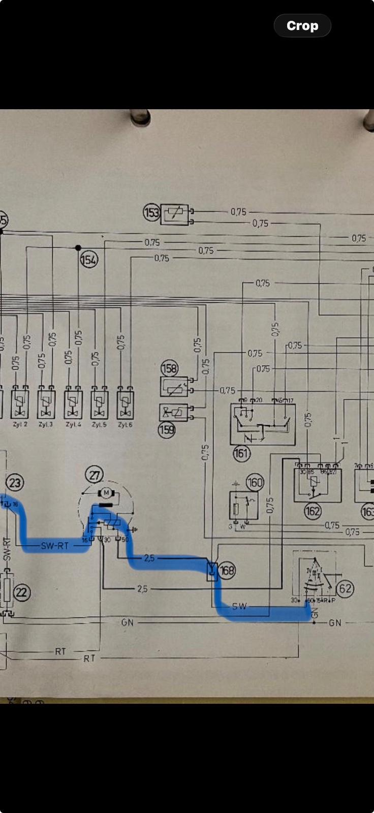

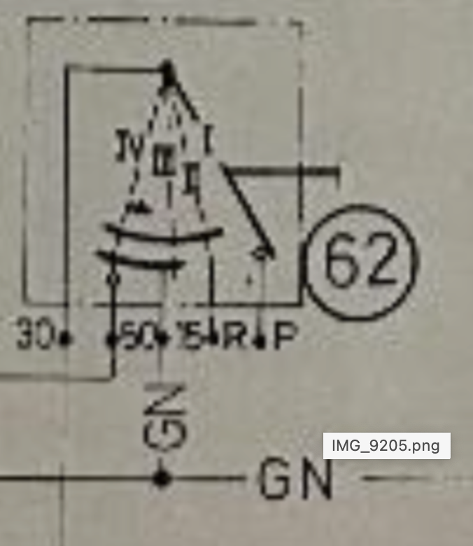

Thank you Scott, that helps for terminology. Here’s where I am having some issue understanding the schematic. In looking at the ignition switch in picture 1, I see 4 positions which I would assume from right to left are off, acc, run, start. In my reading ACC powers green wire and thus ballast and on to coil. When turning to START, I am seeing the circuit which I described above and outlined here in blue (picture 2). This is obviously all on the original E9 starter. That circuit seems to be a connection made between post 30 and 16 (12:00) by the solenoid being activated on START.
I understand your point that the coil can be powered in RUN mode by connecting the green wire directly to positive terminal of coil and leaving out the ballast since my coil doesn’t need it. Is that better/different than powering coil through black/red wire in START mode? The original starter seemed to have both connections as per the schematic. If I’m understanding your point, since the coil only needs 12v but doesn’t care how it gets it, I can leave out the black/red wire from starter to coil that would have been energized on START and just connect green wire. When I turn key to the START position, however, is that green wire still energized? This is where my reading of the schematic falls short, since I’m not sure whether the ignition circuit represents discrete independent circuits or whether they are “additive”, ie position ACC turns on some items, RUN is ACC plus more and then START is ACC plus RUN plus START. The latter makes sense intuitively, since things don’t turn off when once moves from RUN to START, but just want to confirm.

Unfortunately, this is not the clearest diagram. (Seems to have been drawn by some German guy...)
From left to right you have OFF, ACC, RUN and START. The curved dark traces represent the actual contact ts inside the switch (AMHIK - since I pulled my 635 switch apart by accident when removing it!!!)
The angled line represents the wiper inside the switch. You can see that one end is connected to BATT (wire 30). As the key rotates, that wiper moves clockwise from position I to position II it first encounters the ACC trace (pin R). I have no idea why there is no wire shown there). So in this position all of the accessories are powered. In position III it encounters the RUN trace, and energizes Pin 15, which is the GREEN wire (G=Grun). You will note that the ACC trace is still energized in position III. This is because you do not want the accessories turning off in the RUN mode*.. In position IV, the wiper encounters the tiny little START trace, and energizes pin 50 which is the BLACK wire (SW=Schwarz)), that goes to the starer solenoid via junction 168.
* These power modes OFF, ACC, RUN, START are cumulative. OFF is off, ACC powers accessories (wipers, turn signals, radio, etc), RUN powers ACC and all of the ignition related elements, and START powers ACC, RUN and the starter. This is critical because you need accessories to work when the engine is running, and starting, and you need the ignition to be on when the engine is running or starting.
The exceptions to this are big power consumers like the headlights. These get separately de-powered by the UNLOADER RELAY which turns off certain heavy loads in the START mode.
Some comments on your statements/questions (IN ALL CAPS)
"In looking at the ignition switch in picture 1, I see 4 positions which I would assume from right to left are off, acc, run, start. CORRECT.
"In my reading ACC powers green wire and thus ballast and on to coil." NO. ACC POWERS PIN R, WHICH ACCORDING TO DON IS A VIOLET WIRE.

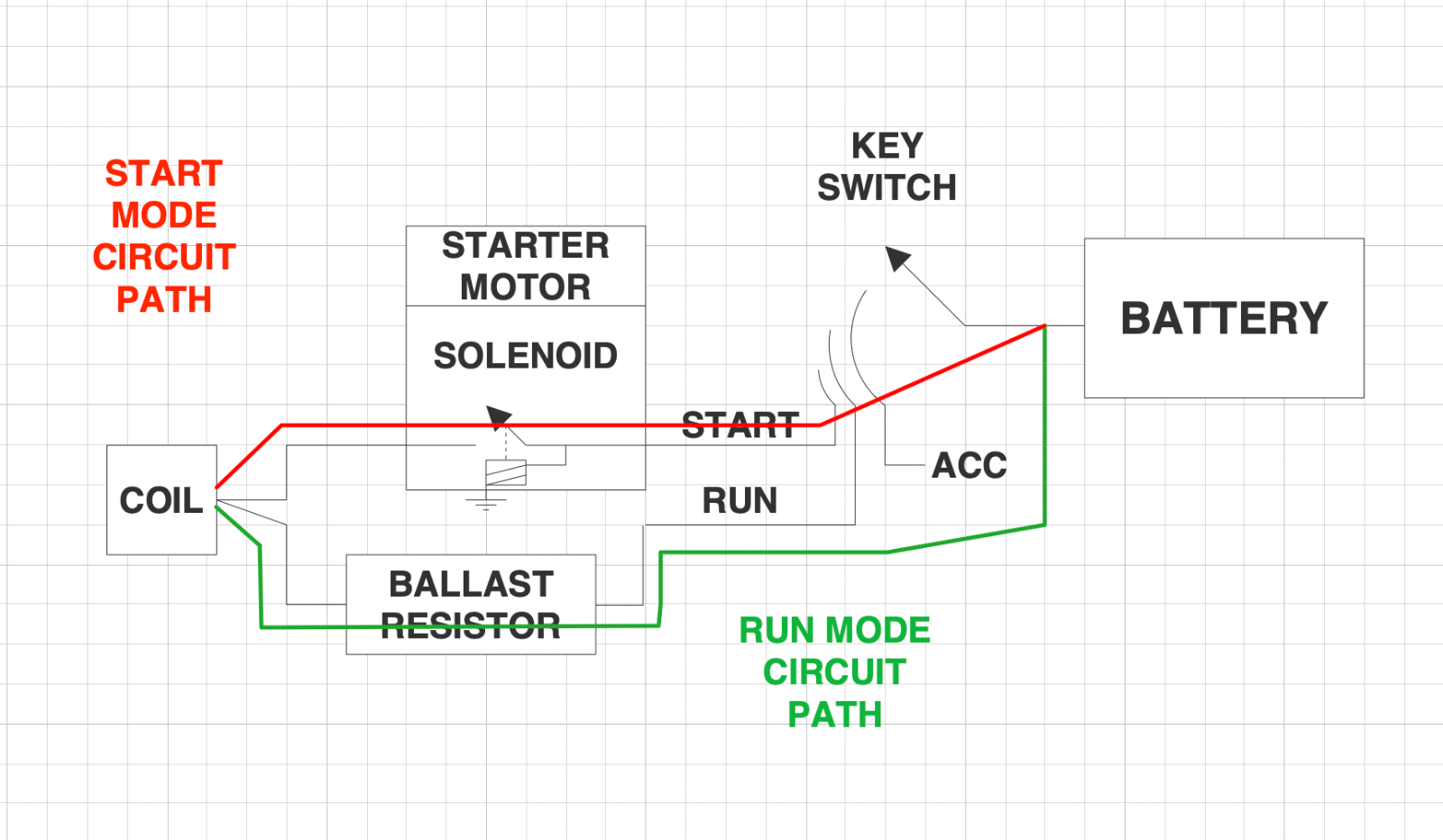

"When turning to START, I am seeing the circuit which I described above and outlined here in blue (picture 2). This is obviously all on the original E9 starter. That circuit seems to be a connection made between post 30 and 16 (12:00) by the solenoid being activated on START." CORRECT. THE START POSITION POWERS THE BLACK WIRE WHICH ENERGIZES THE SOLENOID. THIS CLOSES THE CIRCUIT TO THE STARTER MOTOR, AND IN THE DIAGRAM ALSO CLOSES THE CRICUIT FROM THE BLACK WIRE TO PIN 16 OF THE STARTER, WHICH IS CONNECTED TO THE BLACK AND RED WIRE. IN THIS CASE THAT BLACK AND RED WIRE GOES TO THE COIL DIRECTLY, EFFECTIVELY SHORT CIRCUITING THE CIRCUIT FROM THE GREEN WIRE TO THE BALLAST RESISTOR AND TO THE COIL.
"This is where my reading of the schematic falls short, since I’m not sure whether the ignition circuit represents discrete independent circuits or whether they are “additive”, ie position ACC turns on some items, RUN is ACC plus more and then START is ACC plus RUN plus START. The latter makes sense intuitively, since things don’t turn off when once moves from RUN to START, but just want to confirm." CORRECT. THEY ARE ADDITIVE.
Now in a ballast resistor case, it is important to note that the "bypassing" of the ballast resistor occurs by effectively short circuiting the resistor.
Resistors in parallel have the following resistance:
Rp=R1R2/(R1+R2), so you can see that if R1 is zero, then the total resistance is zero, regardless of what R2 is. This is what occurs when the solenoid energizes the black and red wire. In START mode the solenoid energizes the black and red wire which applies 12V to the coil. The green ignition wire is still energized, but since that passes through the resistor, which is effectively short circuited by the black and red wire, the ballast resistor is meaningless.
Here is a diagram showing the current flow in both modes. You can see that the red line is in parallel withe green line, and since the red line has zero resistance (or nearly so), the green path is effectively bypassed.
In your case, since there is no ballast resistor, you can just power the coil from the green wire, and eliminate the black/red wire. This also avoids routing the black and red wire from the starter to the coil (as @HB Chris has been saying). Just leave the odd 12:00 lug on the starter disconnected.
