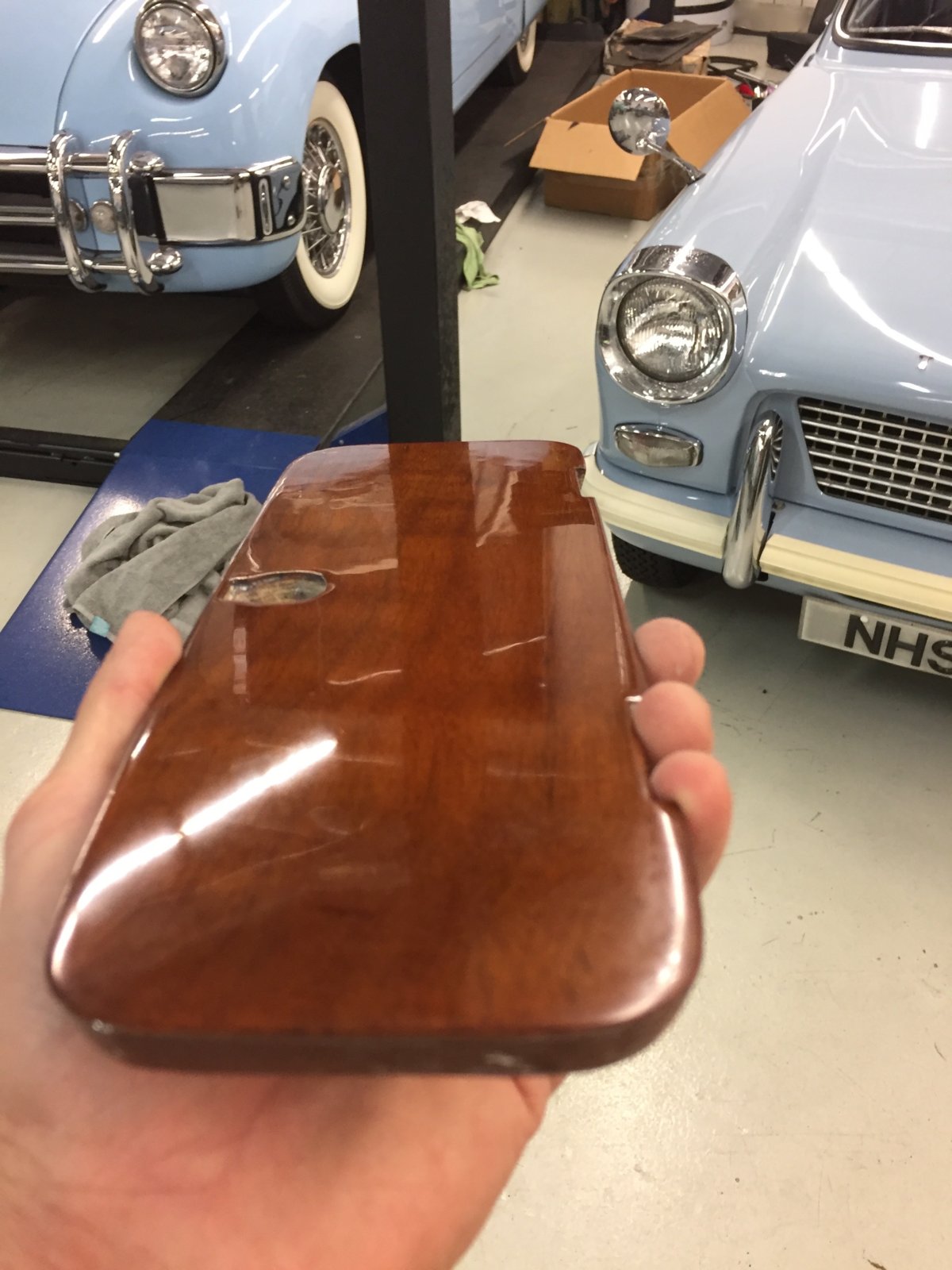

Wow...$1300 to re-veneer those few dash pieces? I need to start doing some side work..I'm a custom woodworker/furniture maker by trade...That's a tiny little veneer job.. Hmmmm....:-). Here's a little piece of that Triumph's dash I was redoing for a collector friend....(fun fact: it was on the cover of the Abbey Road album...:-) Cool! Also got to restore the engine bay and interior..

Agreed that this should not be that difficult or cost that much based upon the information I am saying. I’m going to find out if there someone local that can do this. I believe there are plenty of carpenters and Wood people here. Definitely going to clean up the engine bay. The interior doesn’t need terribly much but will be addressing that in time

PS: Don't have a 'carpenter' work on the dash and side wooden pieces, find a high quality furniture re-finisher or cabinet maker.
i redid all mine w/ a sheet of veneer
really quite easy
strip sand and coat with wood glue both side let dry overnite
and set with a steam iron over cloth
piece of cake
saves ton of money and time

As for the wood, I had my doors redone (dash was in excellent condition) at Madera Concepts in Goleta, CA, and just the four pieces were $1000 (they turned out terrific). The problem I had was that while Bela quoted almost 400 dollars less, the shipping quote I got from UPS was $850! Seems the door strips were long enough to bump them into a more pricy category. Hopefully someone has a better idea on shipping. Madera said the dash would be roughly another $1000. Since I didn't really need it, and I didn't already have the windshield out, I passed on that.
