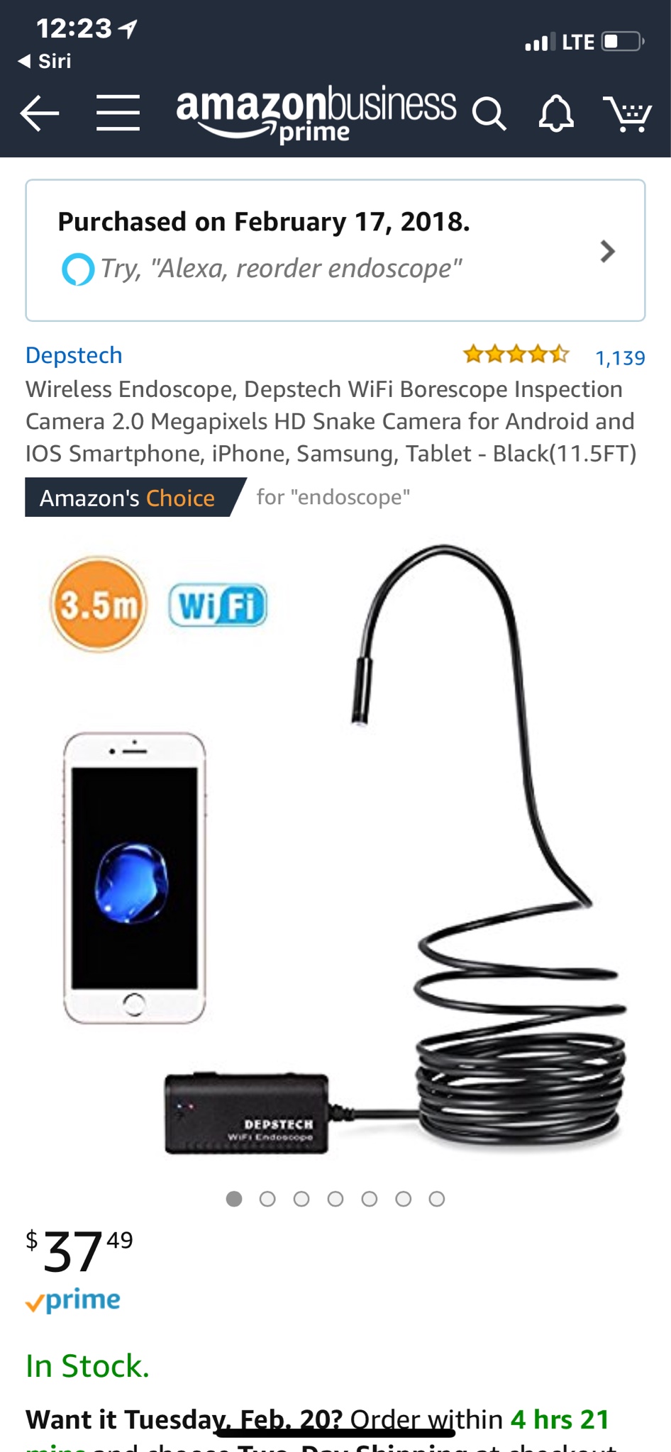

My shop wants me to order a "camera" to inspect the inside. I just ordered this.
While this seems adequate for looking inside your car, the reviews reinforce my opinion of this product. A bit dated and not the best tech and thus not a great bargain.
One drawback is that the unit doesn't record video. It's fine for seeing where stuff is if you need to pass a wire or retrieve something, but for accessing condition, I much prefer to record what's there so it can be reviewed. I can also work the captured images to get more information after the fact. Adjusting brightness and contrast can help see things clearly.
The current hot sellers in this segment are cameras that attach to your Android device. They can then take photos or video. Since you are only buying the camera and cable, not the other support hardware, they are cheap. I have both a Harbor Freight scope like this Milwaukee and an Android style camera. They don't work with iPhones because of the way Apple has their ports and OS setup. (there are ones that do, but they are wireless and cost more) The other drawback is that the cheap Chinese cameras don't have the gooseneck to make the probe stiffer, just a flexible wire making getting it down a long path tricky.
Sorry, I'm giving too much information.
Yes, it will meet your needs, no it's not the best bargain or feature set, but it's probably the best compromise easily available at this time.

Do you have a brand that you can recommend for a link on Amazon I should just buy?
Already discussed on page 6 of this thread. Go on Amazon, search for endoscope camera and Android (or Apple). Dozens of choices will come up between 10 and 50 dollars. Differences will include length of scope, and whether it is is or wireless (mine is Jan, made by Depstech). Frankly, they are all so similar - don't think you can go wrong. Best part is you can take pics and video of what you see. Handy for future reference (and posting to this forum).
Thank you. I actually went back to earlier post trying to find if there was one specific one that people recommended and then I got stuck down a rabbit hole when I went on to Amazon. I will return the one I just ordered when it arrives and get the best resolution version for my iPhone or my friends android. Thanks again for all of your help

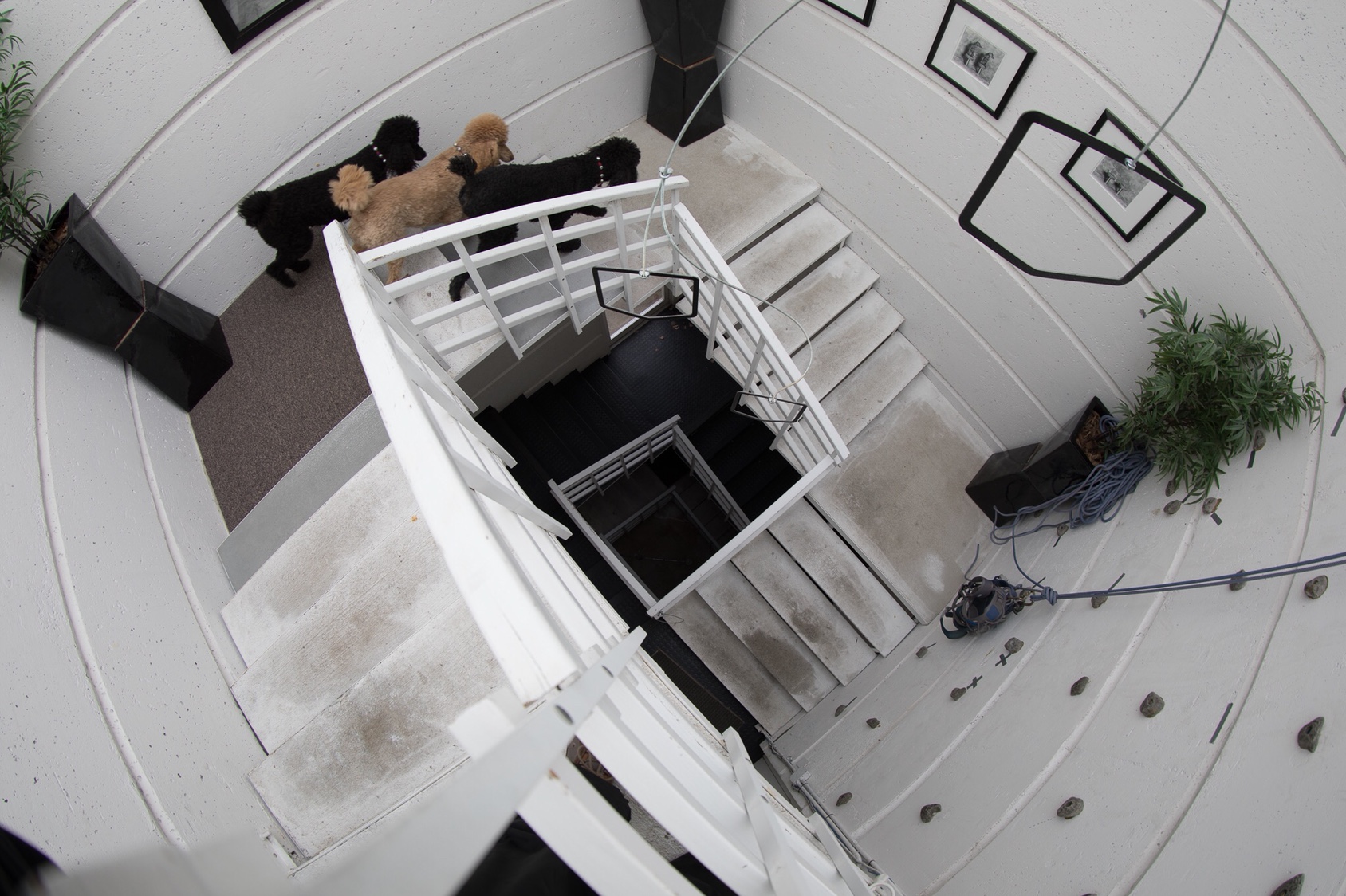

By the way here is a picture of the stairwell someone fell down the center of it and lived to talk about it
Good news for sure! You got lucky! Glad they're also taking care of the fenderwells near the trunk (where he initially stuck a screwdriver through).
how in the heck did she fall through the staircase well? WTF was she doing?
