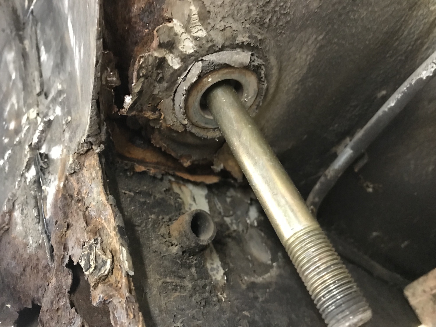

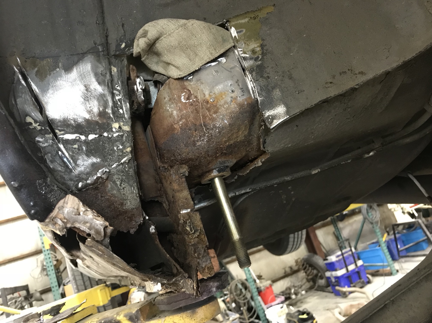

Just got this email... thoughts?
Come on down we’ve got some interesting finds to show you
That's structural and needs to be fixed. I'd ask for an invoice for work performed to date, then go from there.
Not an easy pill to swallow, yet several of us have been there and are here to offer support.
I just talked to Benny. I was panicked because the images look like crap, but he said, "You lucked out. Most of the rust is on the outside and structurally it is pretty sound, better than we thought. Come on down and take a look. We are still looking at $1500-2000 for the rust repair, plus the axel stuff shown here, but it won't be that bad. Looking too at what it will take to clean/up paint the engine compartment too, without removing the engine."
Any specific questions you think I should ask when I go down there?

Ya, when I first saw that pic, I thought it looked like surface rust too on that diff mount point. Good news for sure.
Still curious how the rest of the rockers look if the inner rocker needs replacing (of course, the outer will).
