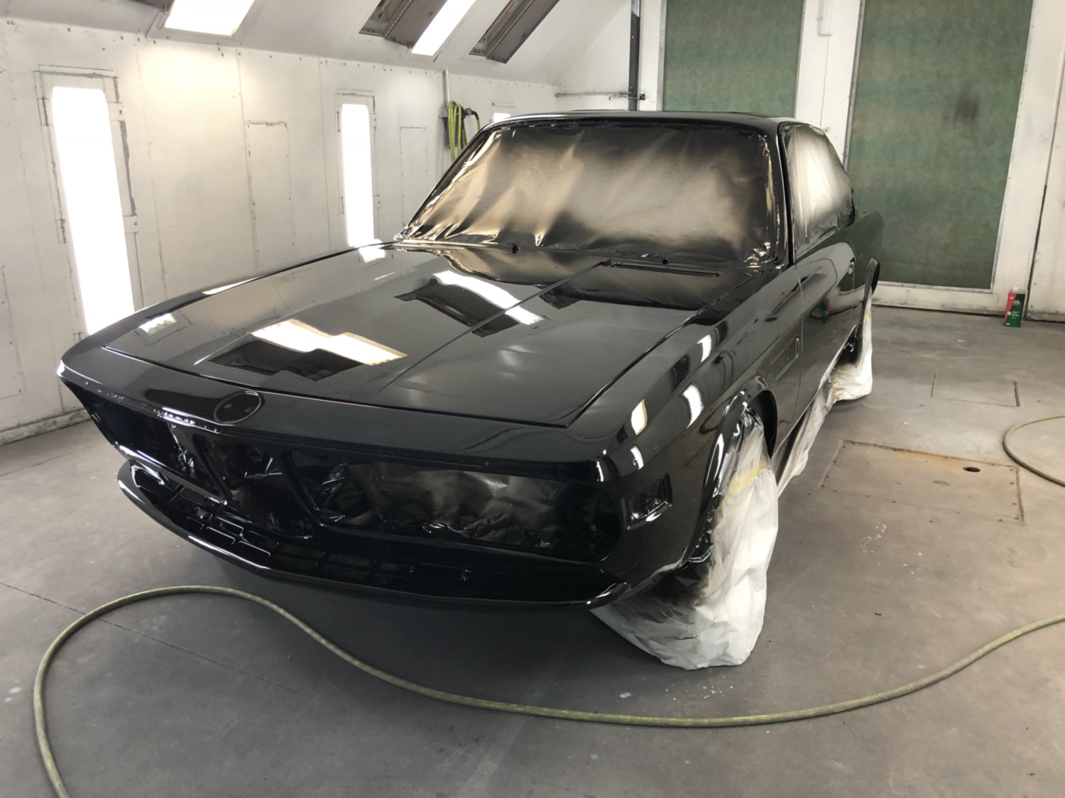

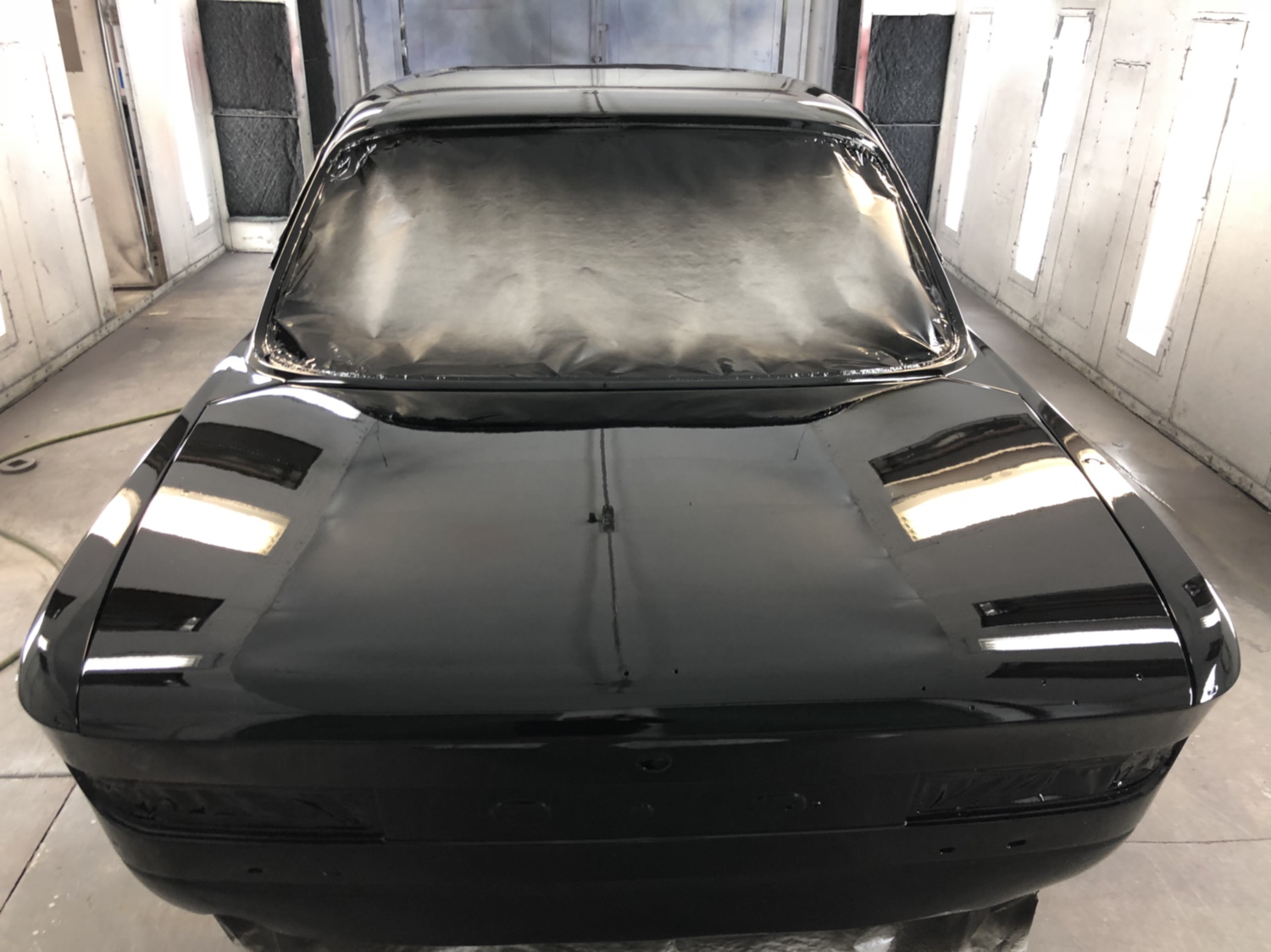

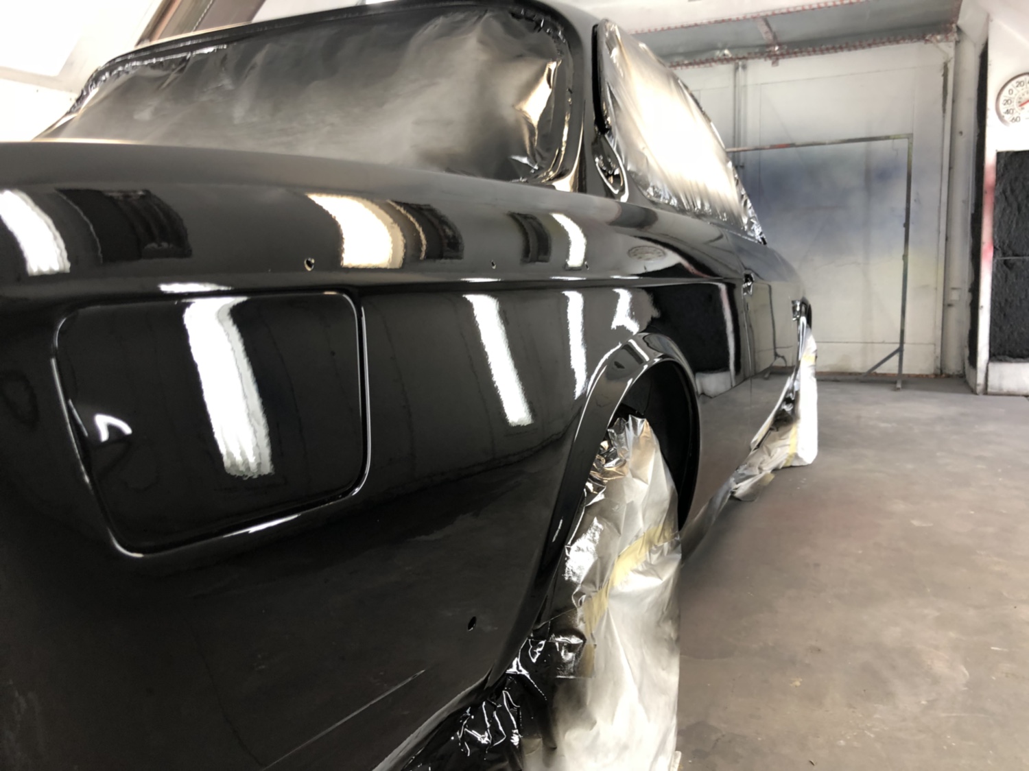

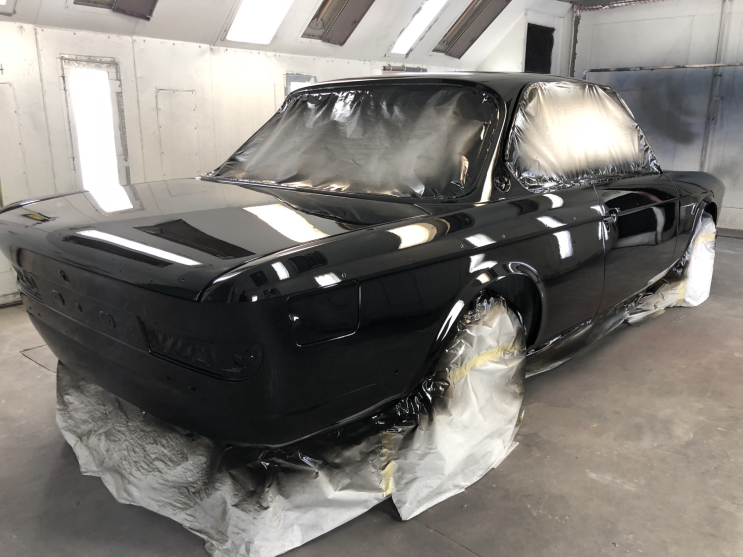

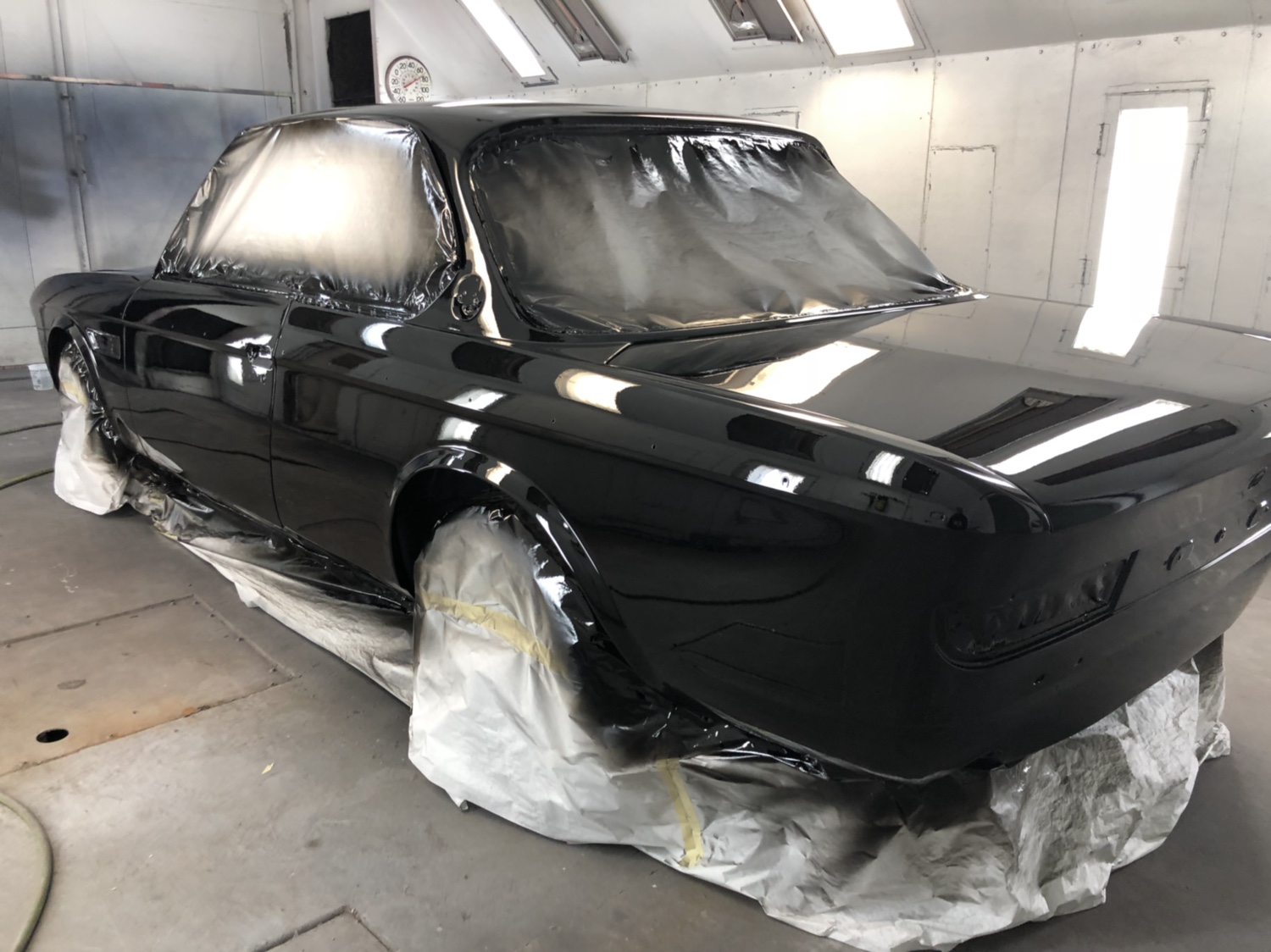

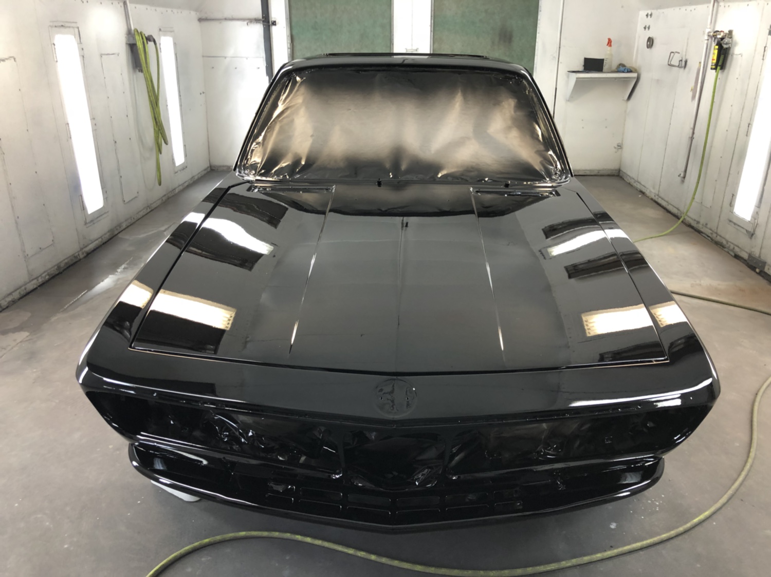

Can't believe the day is here! Painted and clear coat done. What do you think?
Short video (less than 4 min),
shot in 4k this time. Some stills as well below.
Buffing needed obviously.
I tried to push Benny on the belt trim issue, but he hadn't read his email yet. The ONLY thing he is worried about in terms of making my May 15 date is getting the wood back. The wood guy is not giving me much information/confirmation on completion. Kind of aggravating.
Thoughts?
