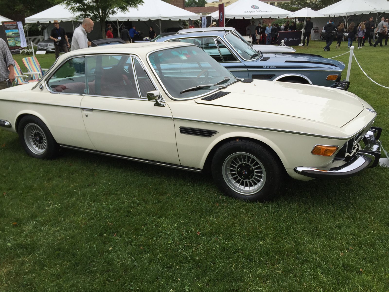

Sorry for all the questions. I agree about the bumper. Did not realize the wheels were worth only $50 each. The tires cost me more than that. Any advice on where to position the Sideview mirrors? Frankly, I found the factory position to be much too far towards me or the rear of the car and very inconvenient so I was just going to place them as far forward as they can go without interfering with stuff. I don’t see any reason why that would not work but before I do so and you guys beat me up for doing something stupid I wanted to ask. Honestly, I would much for the row versions of the food that we contemplated earlier. I think they would look cool but perhaps too out of place.
I had my mirrors moved as far forward as the space would allow. A more Euro position.
