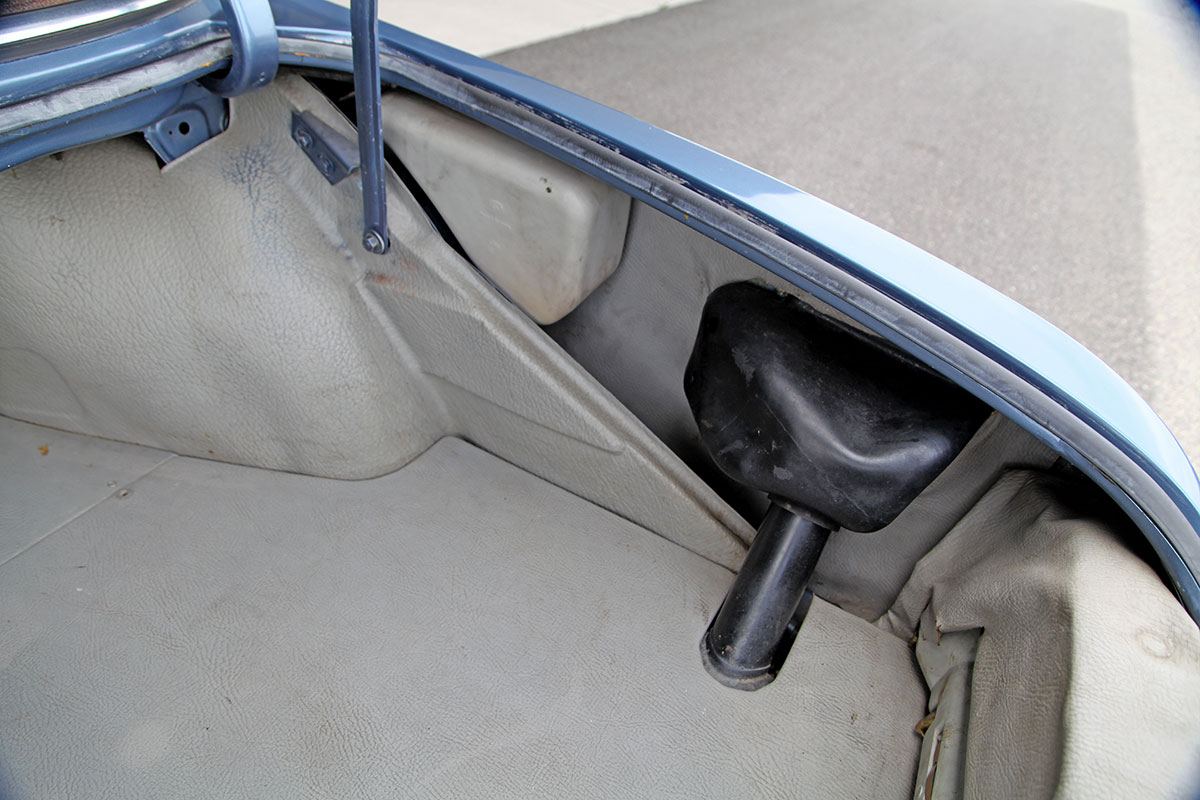

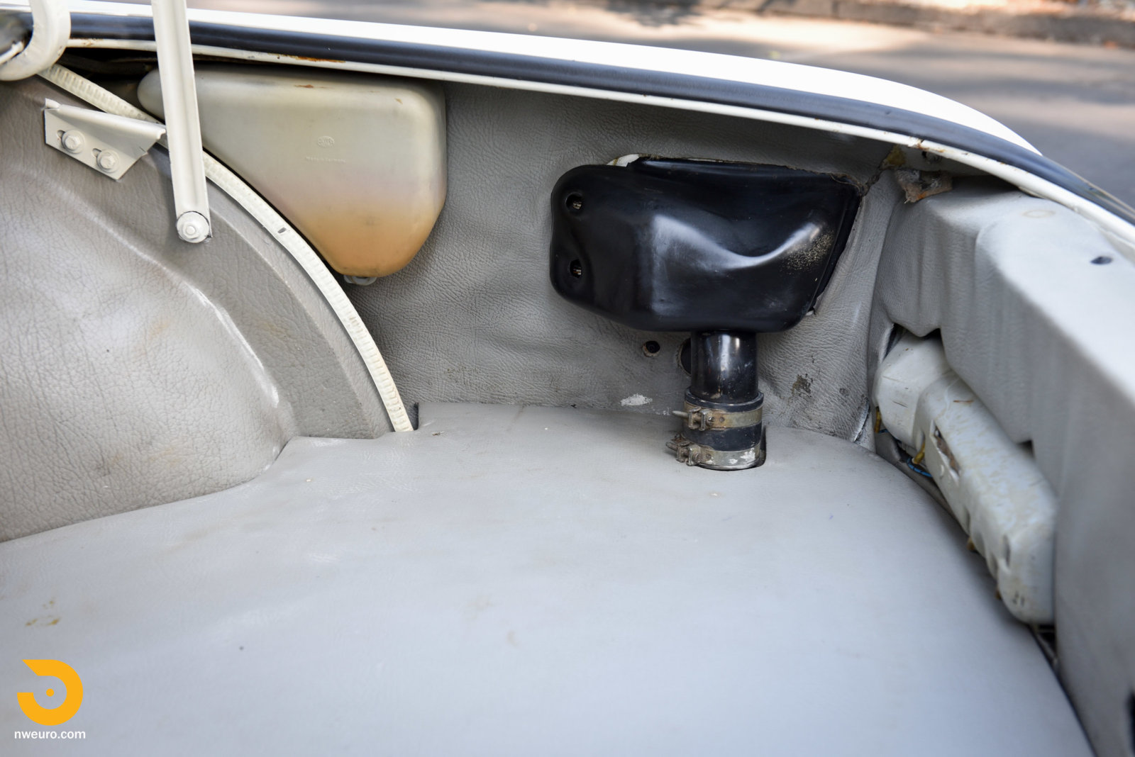

hi Scott, do you need the 'elephant skin' wheel arch covers?
I have a set of brand new BMW ones, I decided to reuse mine
But I will tell you the new ones are not like the original, the old ones are stiff, new ones are floppy
And the left and right are 2 different colors! Really BMW?
So you have to paint them, I have been told 'Storm Gray' is a very close match

I would love them, I think. Not sure if they would fit over the stabilizers we created on shock towers, or if they would fit the 74 trunk, vs. the roll of material Carl Nelson is about to get in stock. Let me know your thoughts. Ideally, I'd get the original if it would work well and not too pricey. Let me know. Thanks
The hard plastic "elephant skins" are different on the '74.
1974:
Pre-1974
right that is true, I forgot the 74 is different
But as far as I know the original style is not available
I don't know if they make the new ones as a different shape from others or not, you can look up the part number and see if they show 2 part numbers
If they only have one part number you would have to make the aft extension
You can also get the trunk material from World Upholstery
Do you have a photo of the 'stabilizers we created on shock towers', I would really like to see that
I have been thinking about how to reinforce mine
I would sell the covers for a little less than I paid for them
When they became available I jumped on them because there have not been any available
I was very worried about taking mine out and them breaking based on all the stories I read
But they were fine, you just have to be very careful
I looked up the wheel covers, BMW gives the same part number for the 72 and 74
and the left side ins NLA
You can PM me if you think you want them, or you have my email, as Mark pointed out, 72 and 74 should be different...
I can't find a photo of the new style, maybe Mark has one
