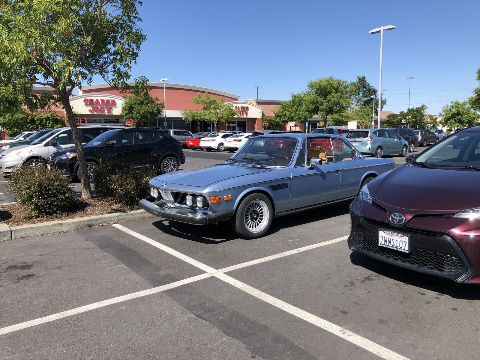

Just out running errands. Nothing beats an E9 for making a quick grocery run!
Nice looking ride. Must be fun now that it is all dialed-in.
And if it's pre-repaint, nice to be able to not worry too much about the exterior to go and get groceries.

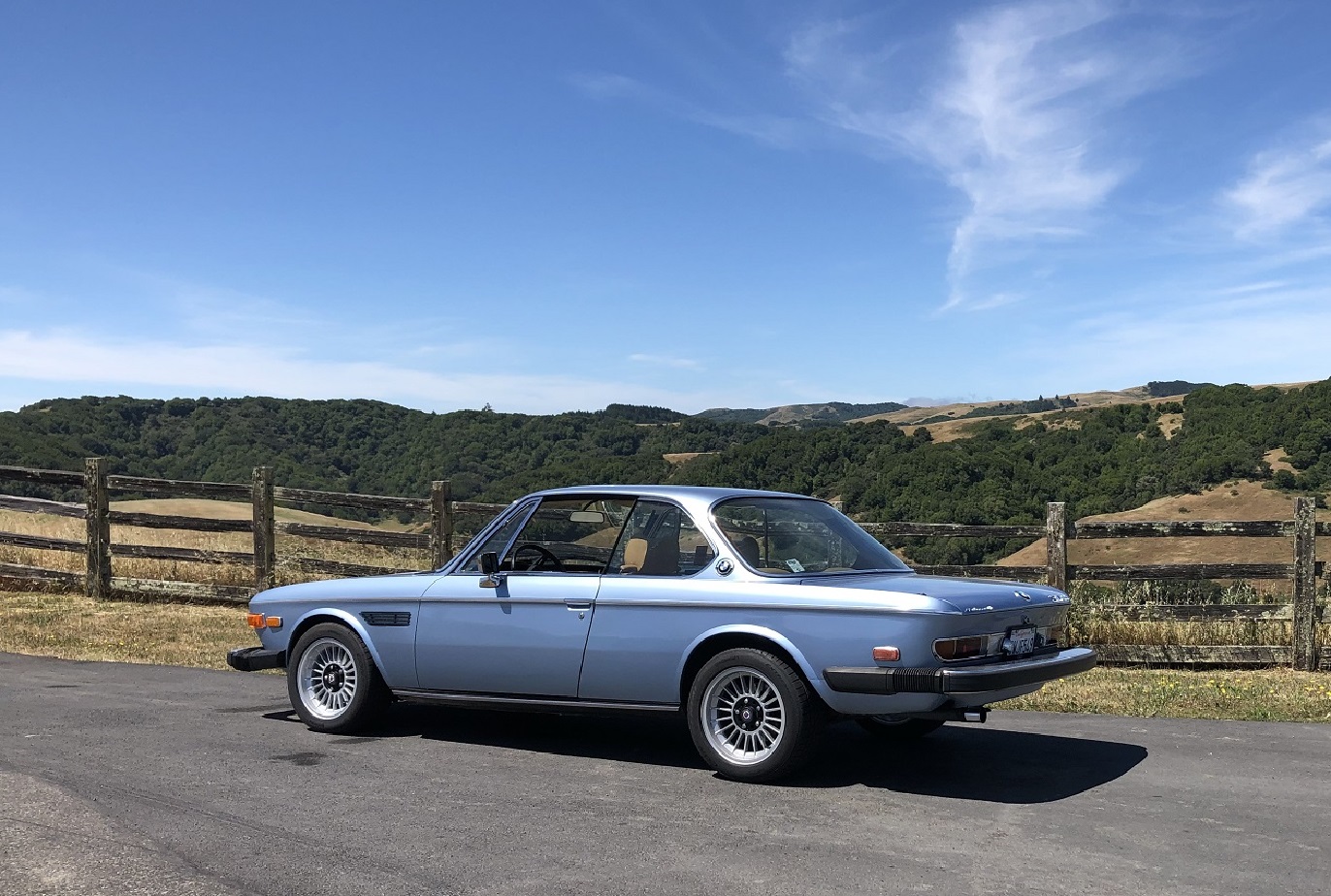

I can't stay out of this car! This morning it was a drive through west Petaluma with my lovely wife, then to brunch downtown. Where will we go next?

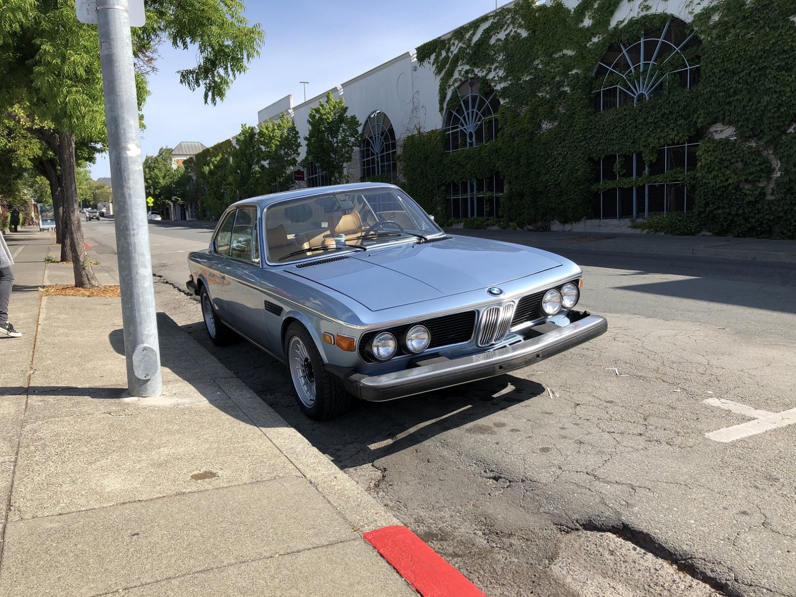

And is it any wonder we in the 914 world call our late model cars "BUBS" (Big, Ugly Bumpers)? They really are less than attractive. The euros will be on soon, I promise.

And is it any wonder we in the 914 world call our late model cars "BUBS" (Big, Ugly Bumpers)? They really are less than attractive. The euros will be on soon, I promise. View attachment 142389
I agree that generally the euro bumpers are better looking, and as it was originally designed. However, the e9 was never that terrible looking with the USA design. I think that the beautiful lines and proportioning of the body are the overwhelming focus. As such they don’t look as bad to me as others have. Most notably the e21, 3 series.

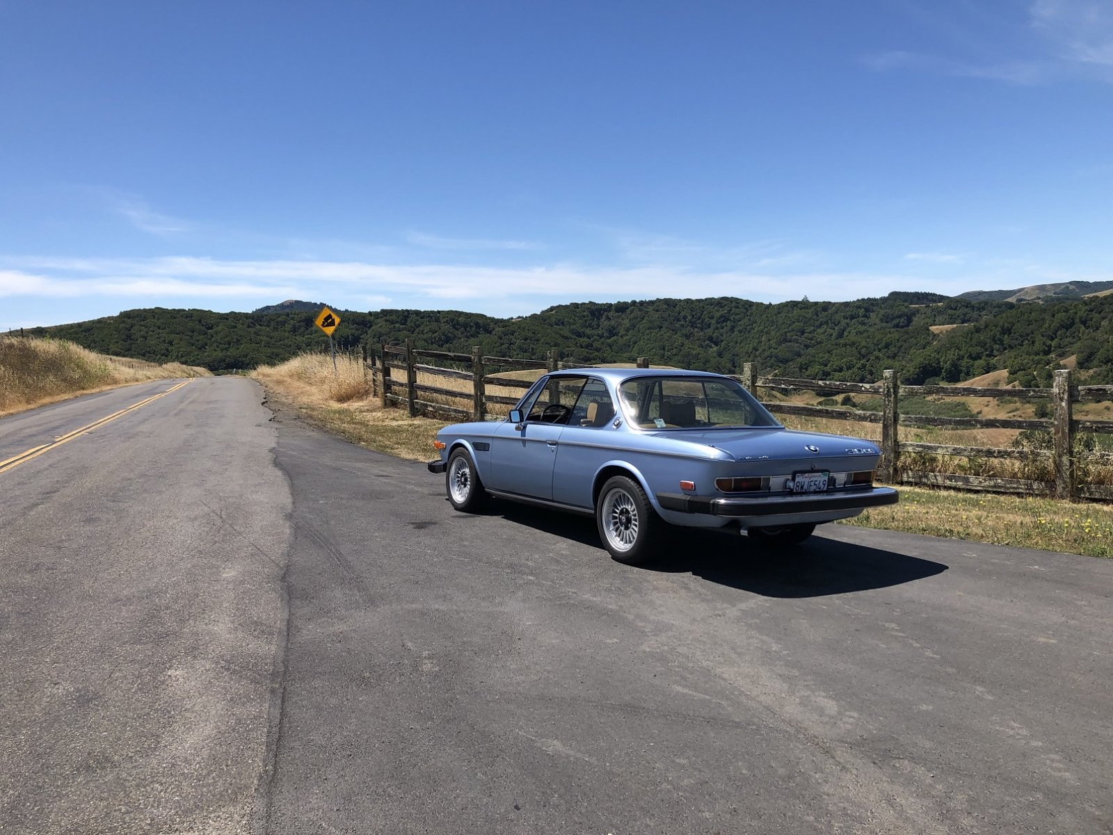

First "back road blast" drive - all under 4k RPM, per @sfdon . Petaluma, west up Wilson Hill (pics taken at the top), over the Marshall wall then up Hwy 1 to Tomales and back home. A mix of quite twisty/bumpy and smooth, more flowing. I won't do anything until I get more seat time and get to better know it, but it feels a bit soft on mid-corner bumps. Other than that? What a LOVELY car! A few little things need addressing but nothing that prevents enjoying the crap out of this beauty. Drive your coupes, my friends!
I've stopped in that exact spot more than a few times. Looks great. When that rear end settles it'll be perfect.

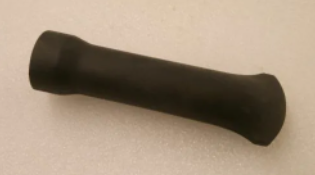

My car had quite some bad exhaust smell, and it turned out to be two things; bad sealing exhaust system and it was missing the two rubber water drain tubes in the firewall partition near the hood release hooks, just left and right of the intake of the heater. If these rubber hoses are missing, the you'll be sucking in whatever air is going through the engine compartment.
It's these ones:
It's these ones:
Thanks for the pointers. @sfdon ensured both drain tube rubbers were replaced with new so it's not that. I hardly notice the smell, but my wife has a more sensitive nose than I. I'm going to keep adding miles and see if it's just the newness of everything. I'll certainly check other potential things along the way and will update as I learn more. Thanks again for the input!
