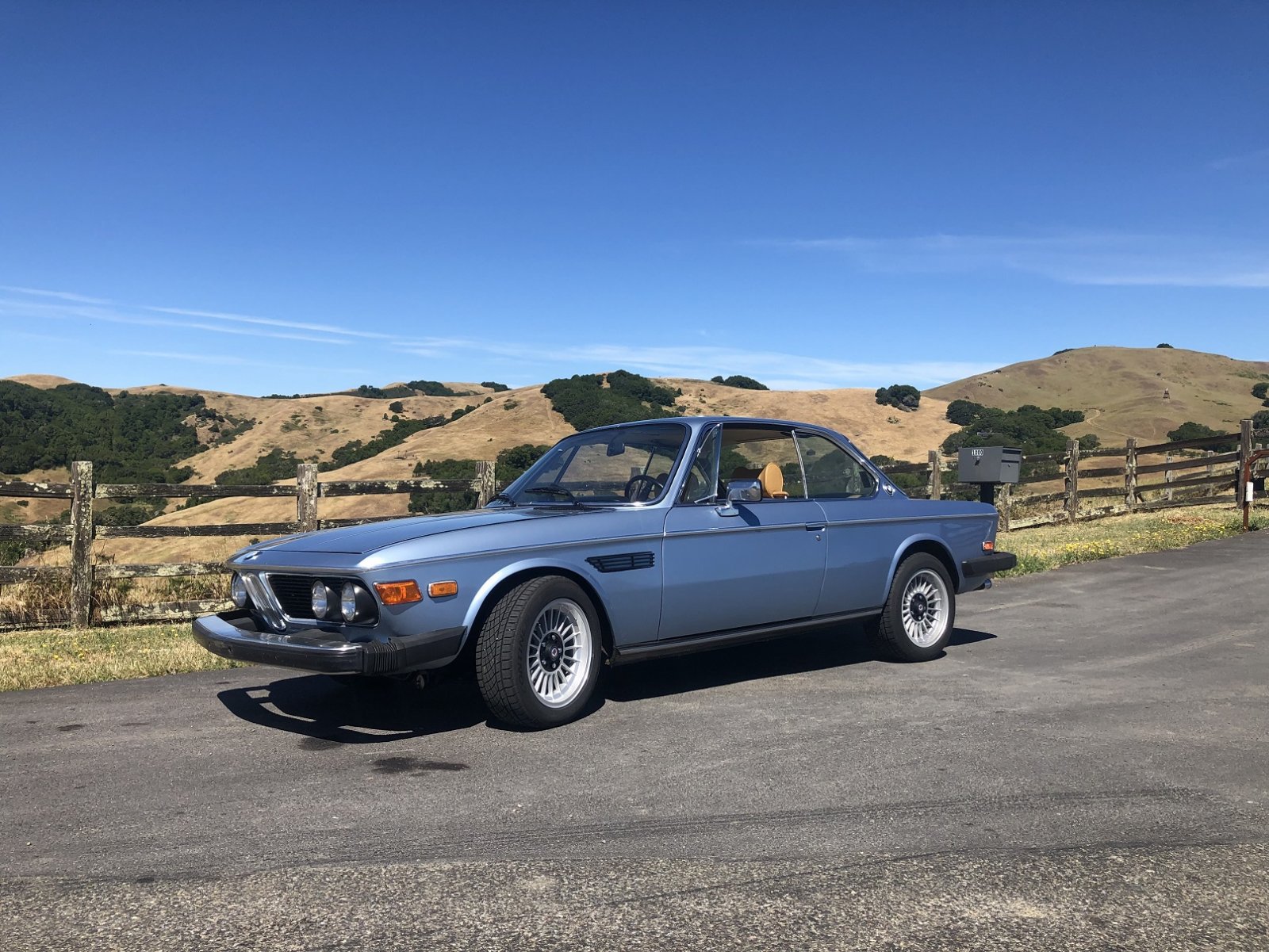

Another stop at the top of Wilson Hill on a special day: June 10th my Mom's b-day! She was raised in Petaluma and though she didn't live here past college, she always thought of it as her home. So when she died, we decided to scatter some of her ashes atop Wilson Hill, to give her a forever view of the area she so loved. It's a special place for me. So now you know why you're likely to see many pics in this location - I always stop here to say "Hi" to Mom.
