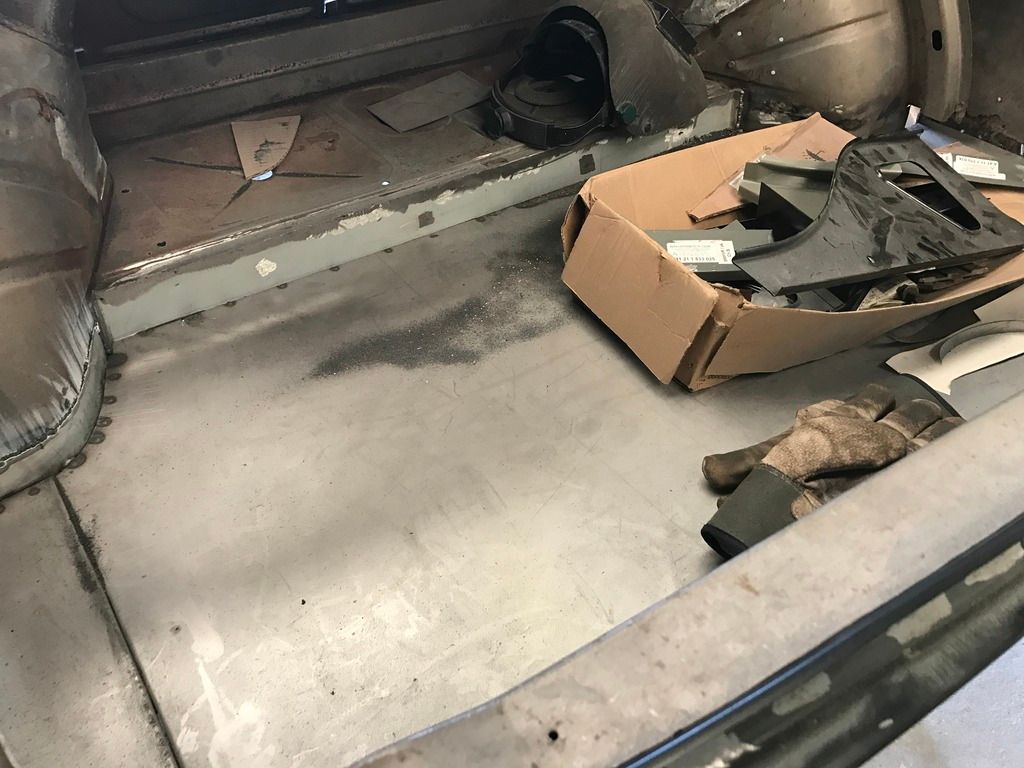

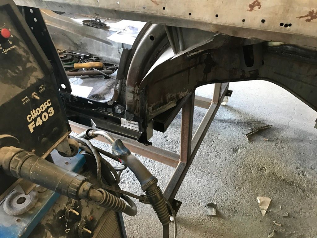

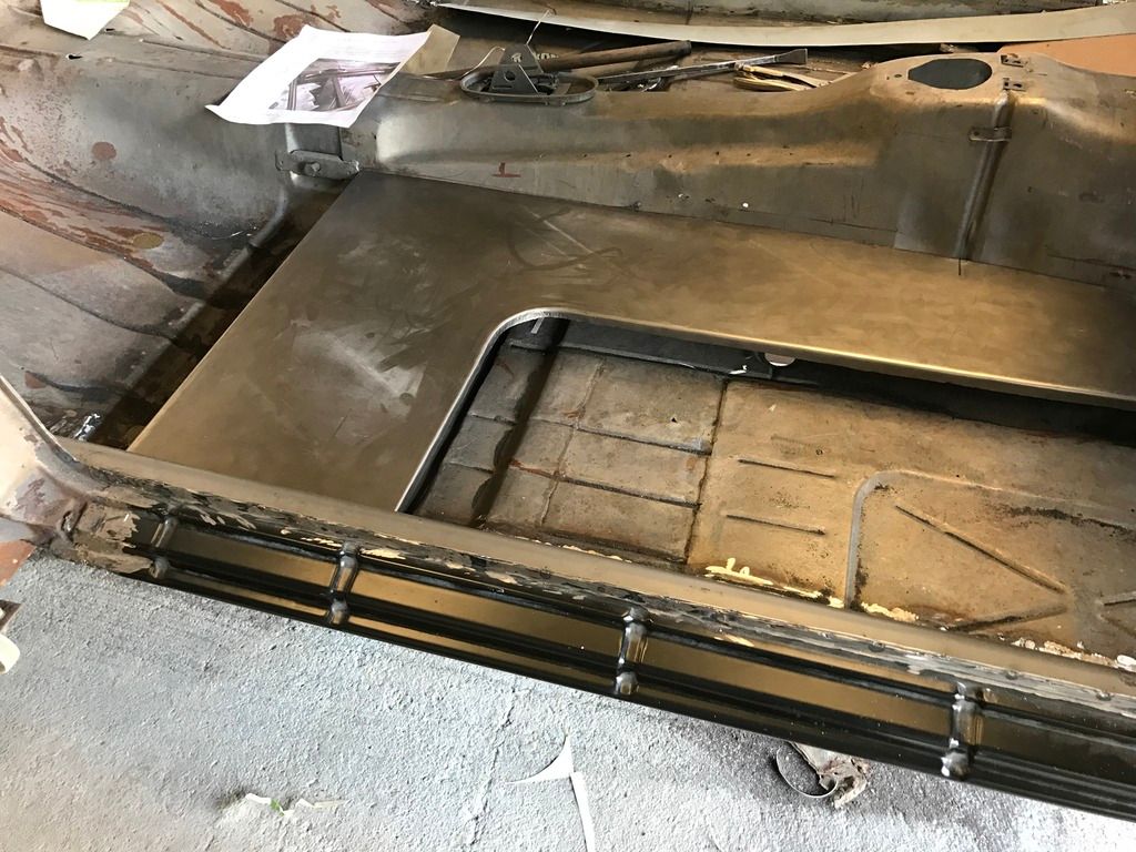

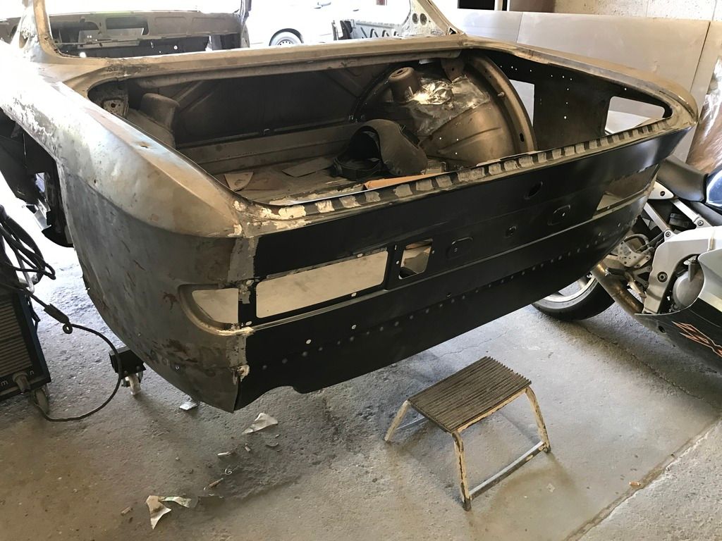

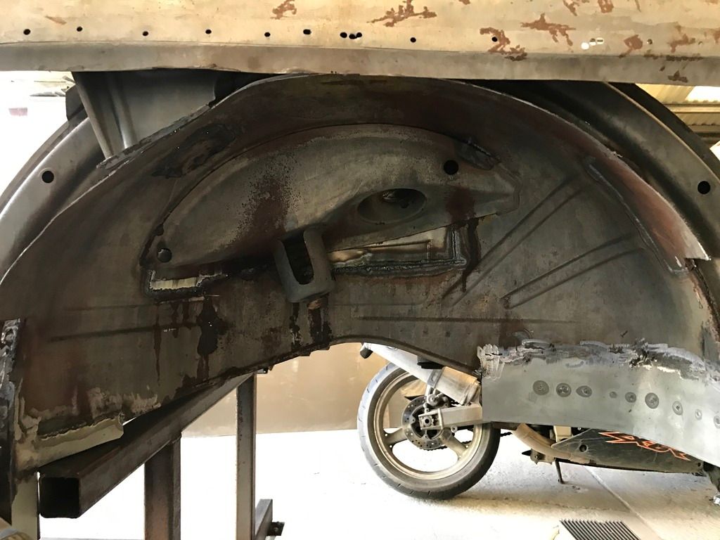

Updated vid and some pics from today's visit to the garage:-

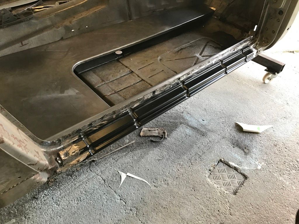

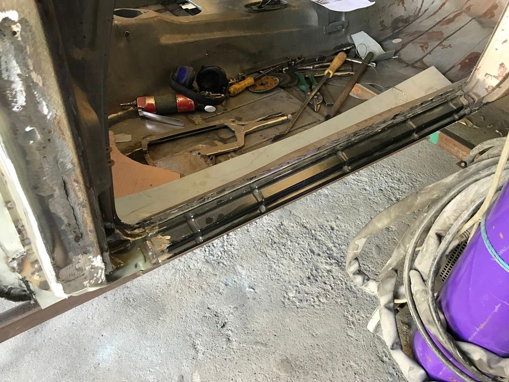

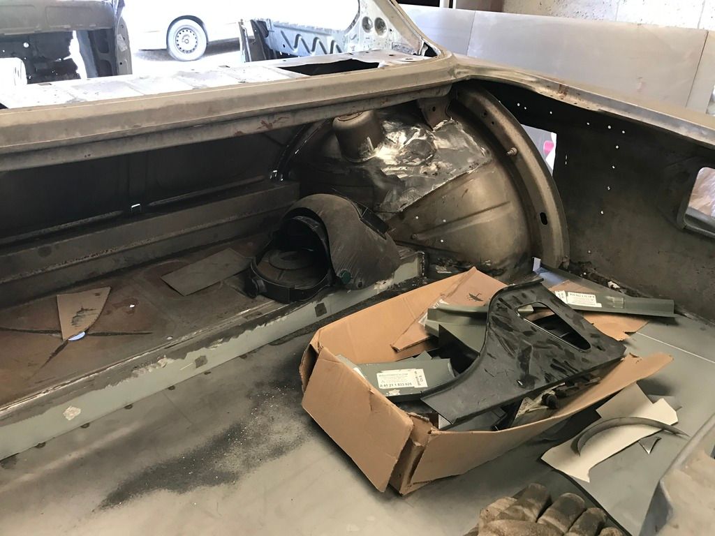

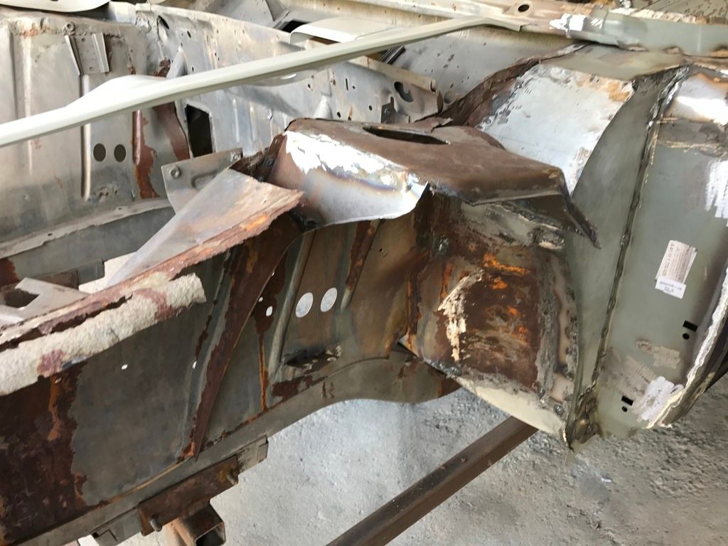

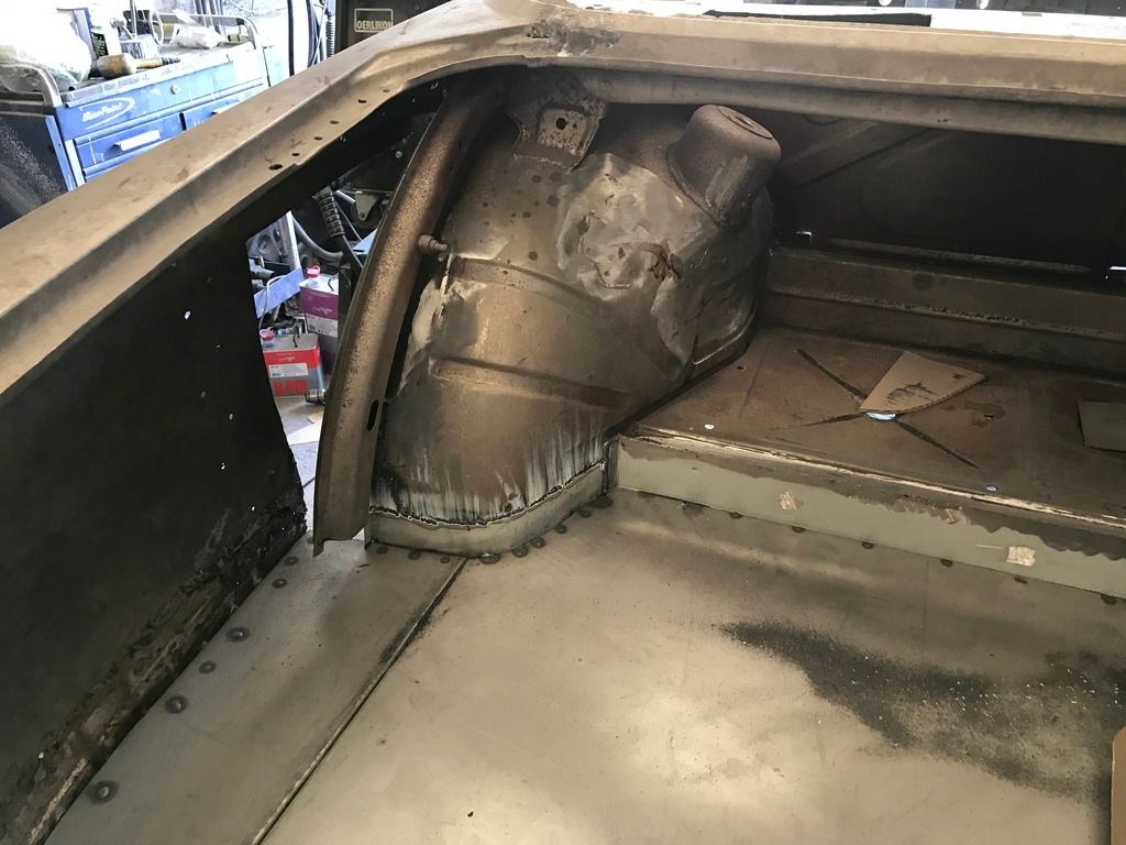

Good progress since last visit in December with a combination of BMW parts and W&N Germany parts to build strength back into the shell;-
- floor raised to accommodate a large side exit exhaust to meet track day regs just in case.
- boot floor done but will be cut out to accommodate fuel cell and other tanks/battery etc
- sills done from top to bottom on both sides with new BMW parts. Ditto for A-pillars as well as front strut top mounts etc (WIP)
