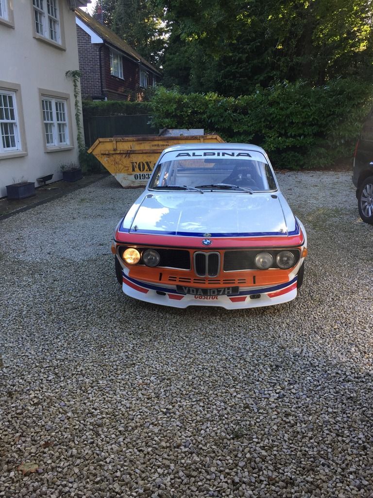

just an intro as have just embarked on a build of a group 2 CSL racer using a car that is sort of half way there already. Bought this last month and already planning the works to improve!!
Thought I'd share a pic as expect to be tapping into some knowledge here in future if that's ok ;o)

Thanks! Yes I think this is referred to as the 69 bubble arch kit. I'm looking to build something like the following. Car is heading off to have this kit fitted in a couple of weeks time:-

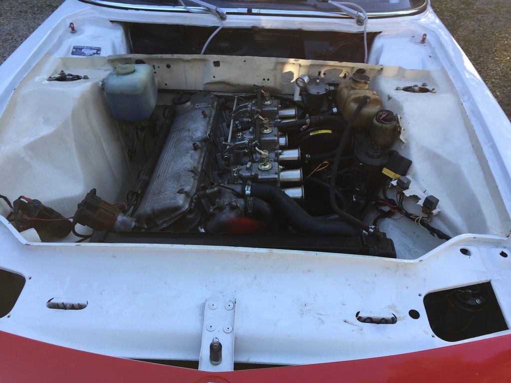

Currently an M30 3.2 on 45 Webers. Needs a rebuild as was only showing 75psi on a compression test ( I am told these should be at least 120 (?))
Am potentially looking at boring it to 3.5, then going for a semi race spec with alpina b10 cam, 6 branch etc etc. Would be aiming for ~300+hp with 300+lbft. Just looking for a decent builder in the UK.....Please share your experiences!!

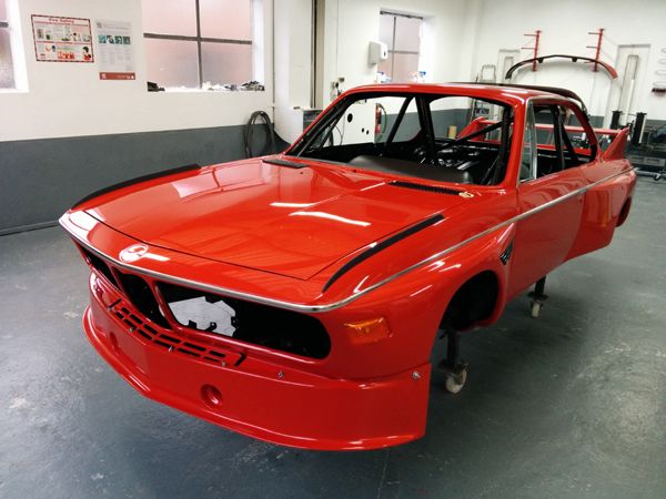

Chris and co are doing the stripdown/repair/dip and repaint for me. We agreed we'll get to a stage where the shell is pucker, then look at where we go from there.
This is one Chris shared with me when we were discussing which kit to go for:-

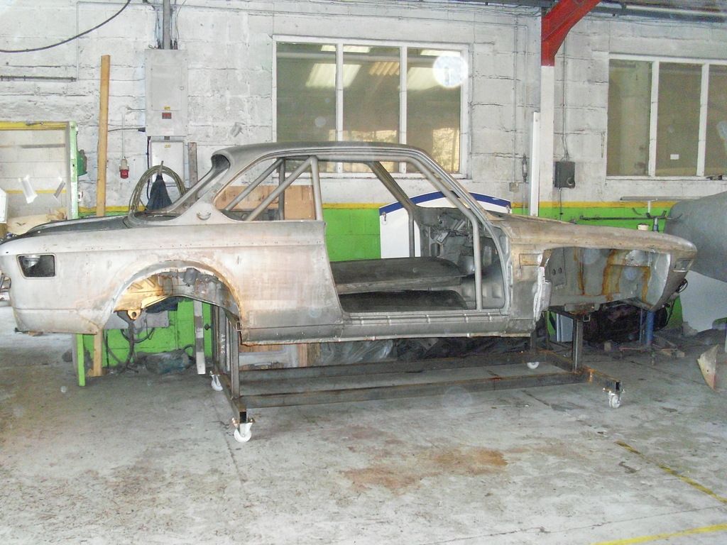

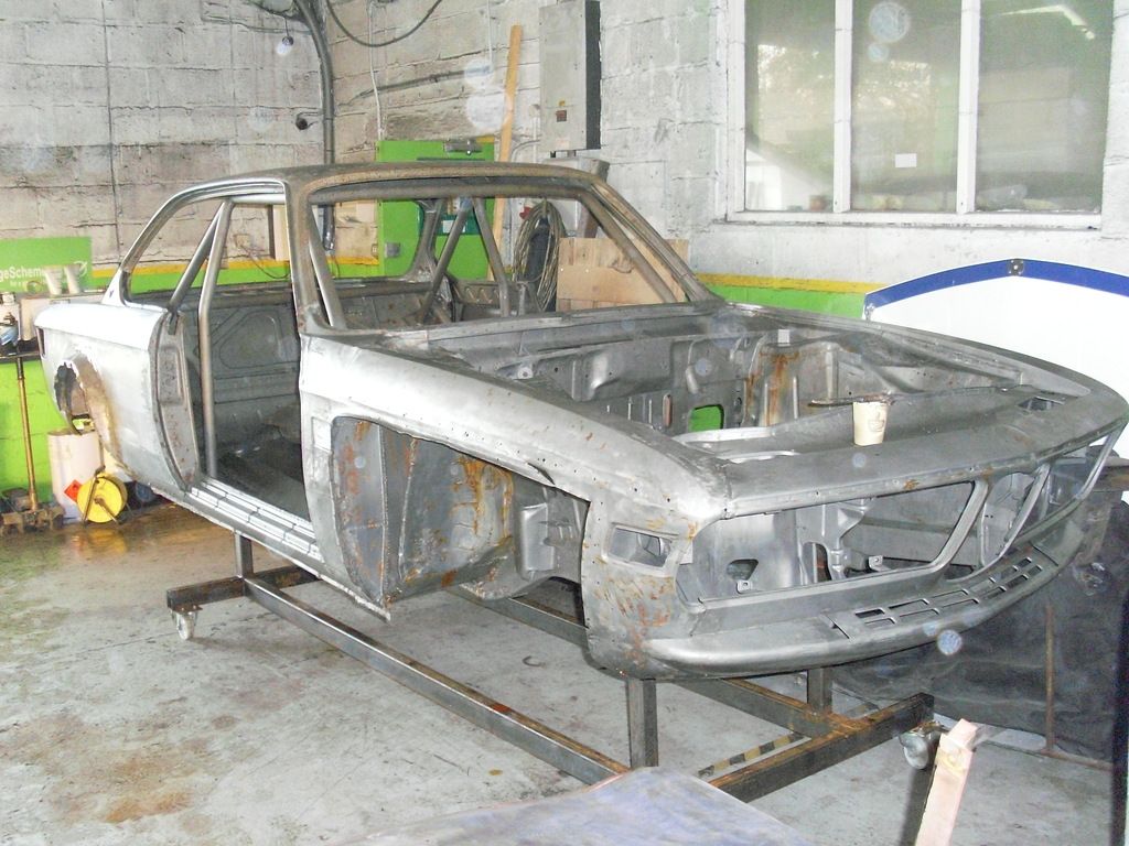

Car back from acid dipping last week and obviously needed some more repairs than initially anticipated. Some horrid previous repairs done, but hey at least I actually got a shell back (I had nightmares of them just delivering me a cardboard box of what was left of the shell!).
Good news is that a lot of the body shell parts are still available from BMW so getting those ordered up this week. What I'll spend in parts I'll ultimately save in fabrication costs so I'm hoping this is the right route to take.
A few pics for you. Thanks for reading, will keep you posted as the parts go back together.
cheers

Which kit is that red car? I like it a lot!
As far as engine building, I would seriously look into a turbo M90 engine if you want to keep it in the M30 family of engines. Lots of potential to 450hp.

Yes. The owner of the red car is following this thread and has been very helpful so far in helping me decide direction etc. Will let him comment. This is a 73 if I'm not mistaken. It's the same kit I have bought anyway. As used on the works liveried racers in 72/73.
Didn't know there was an m90 I thought all the 12 valves were called m30. Will take a look [emoji106]
