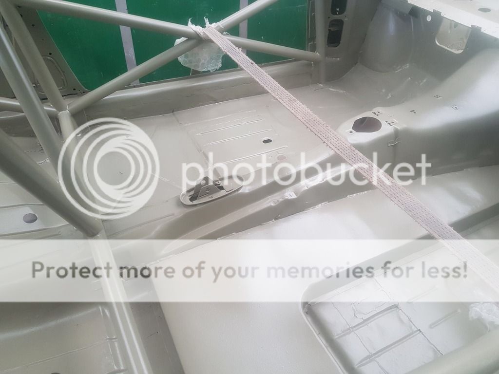

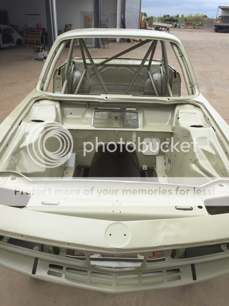

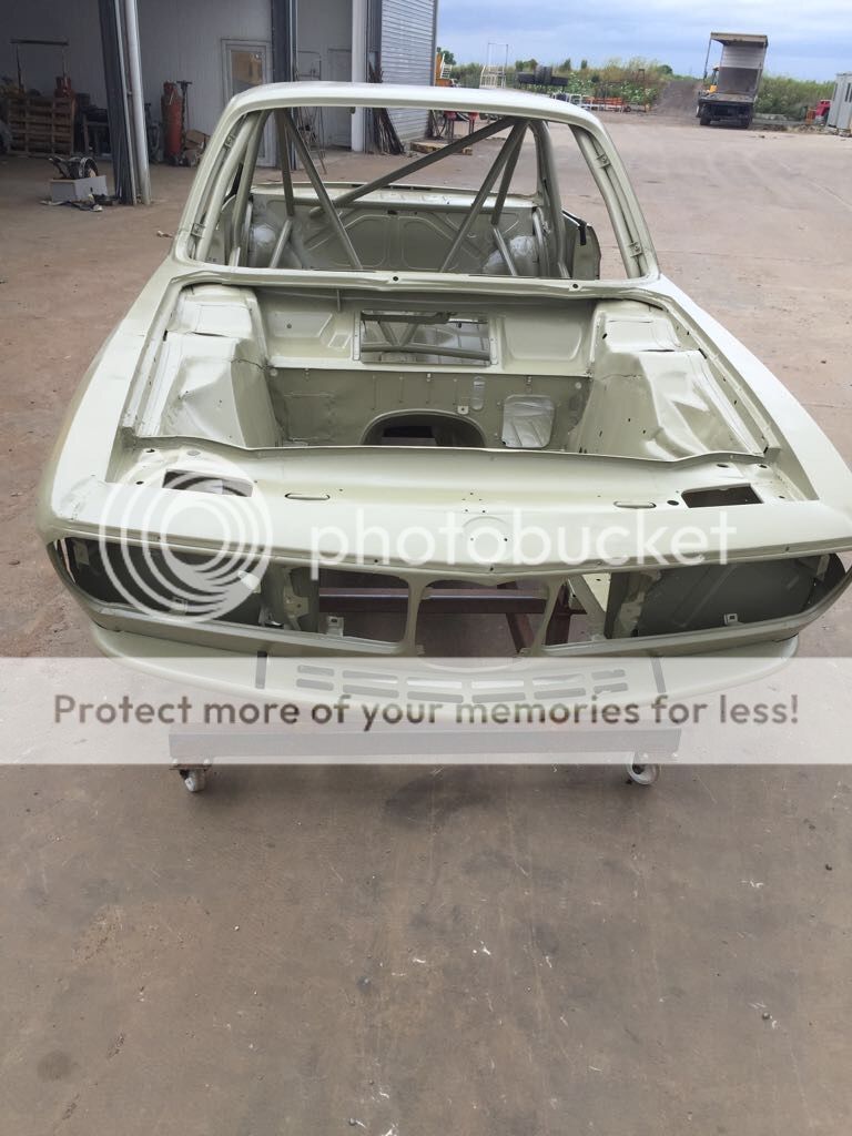

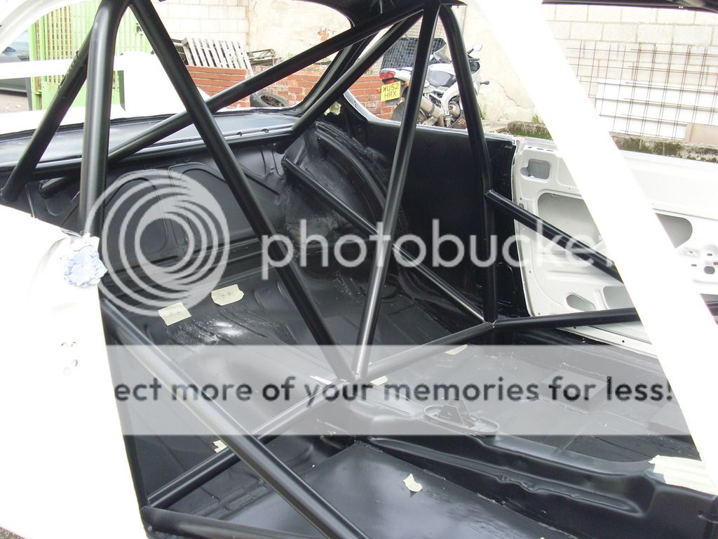

A few pics of the 99% finished cage job. Haven't seen in the flesh yet but certainly looks good from what I received in terms of pics from the guys:-
Next stop back up to Hull to the builder for some final panel work etc on the rear quarters before back down to the midlands for an SPL ecoat.

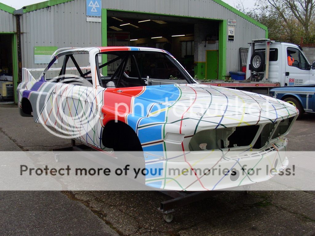

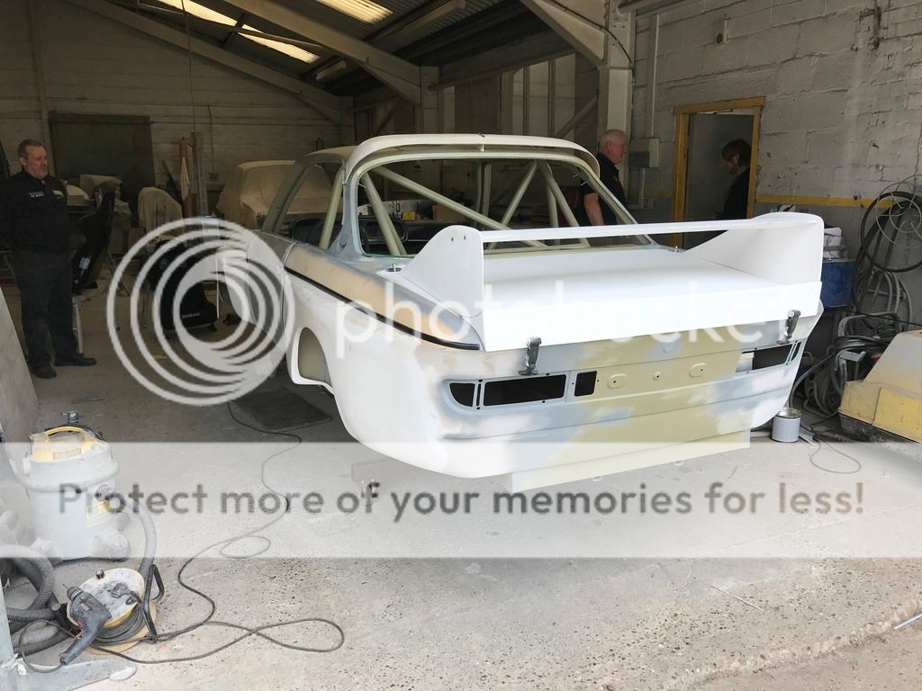

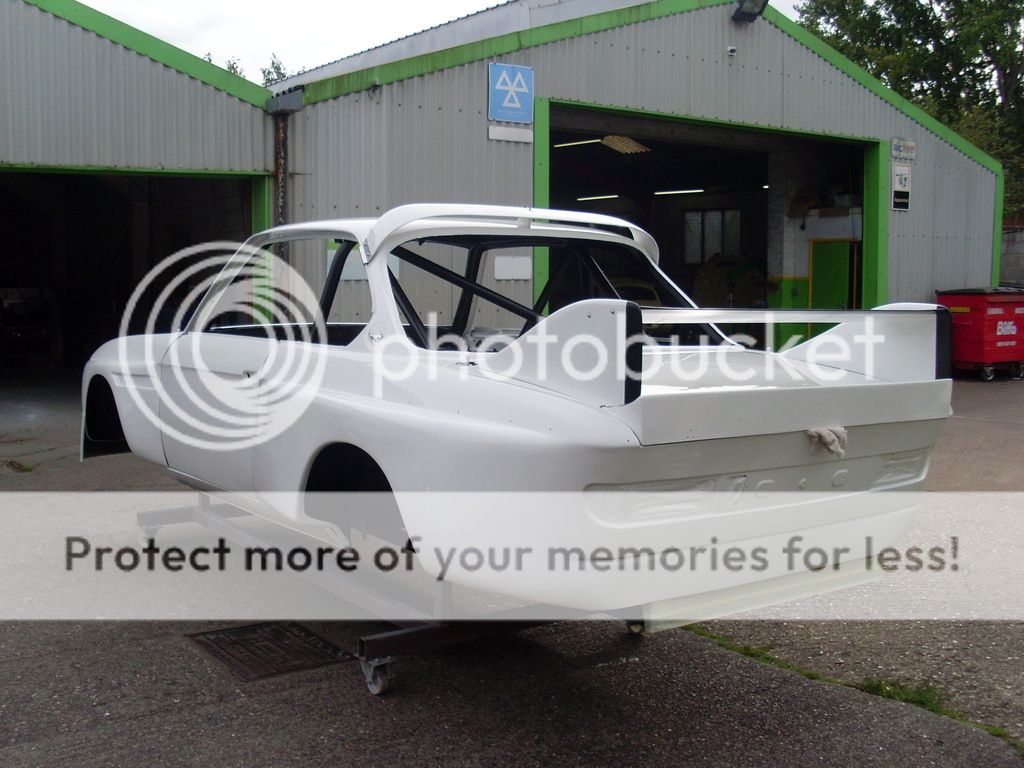

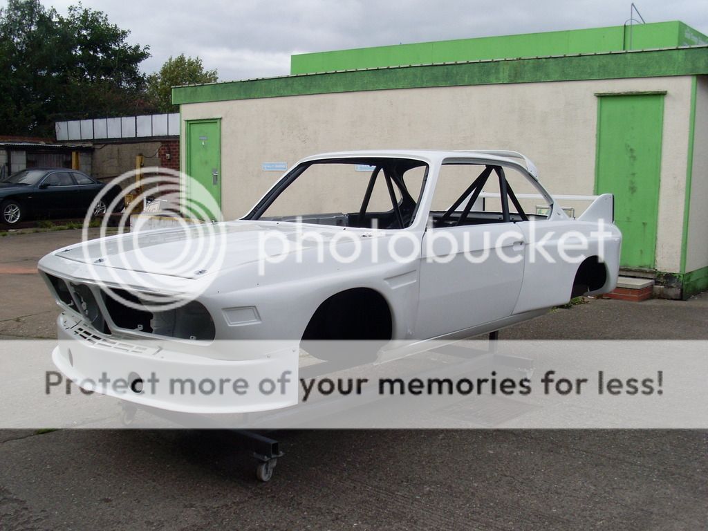

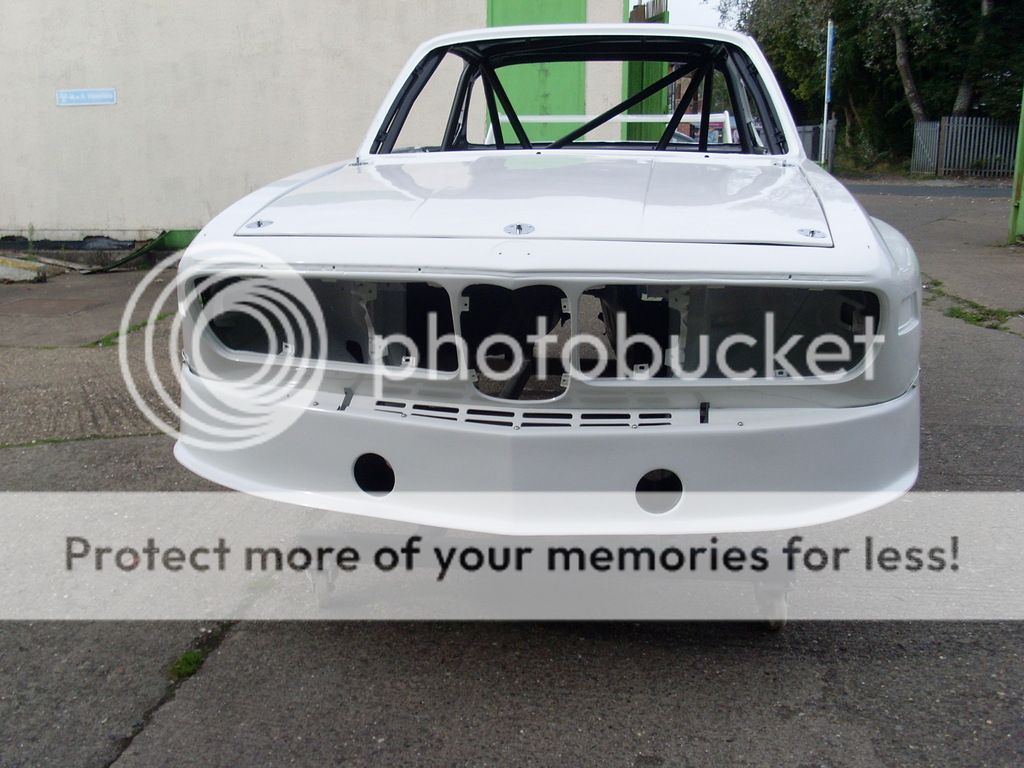

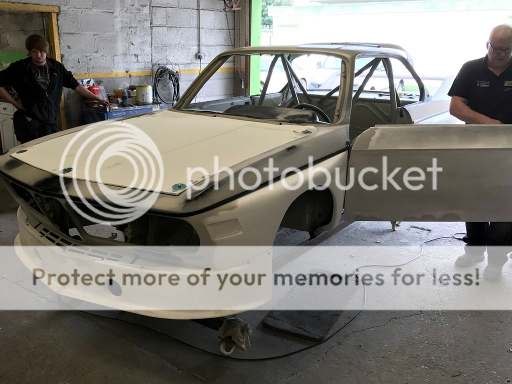

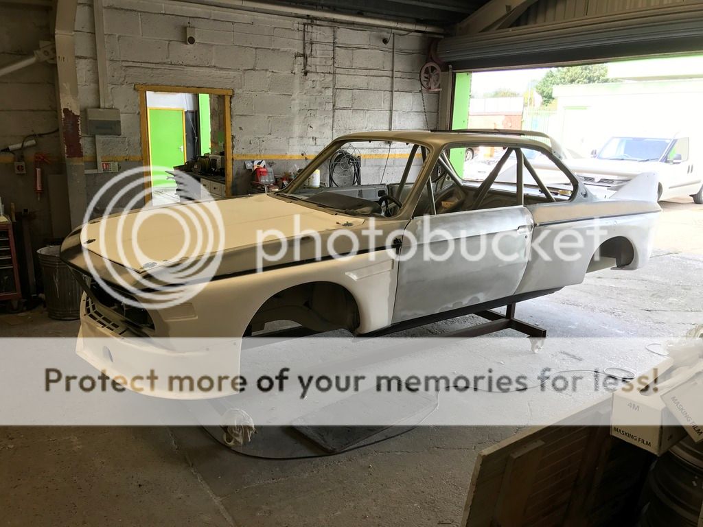

A few updates below:- Car was ecoated and returned to the builder to have the kit fitted. Starting to take shape now.
Interesting to see three of the cage tubes on each side are tied to the top of the shock towers. I assume you had those towers significantly reinforced... how so..?

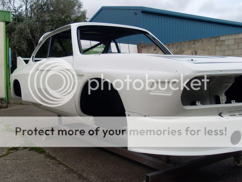

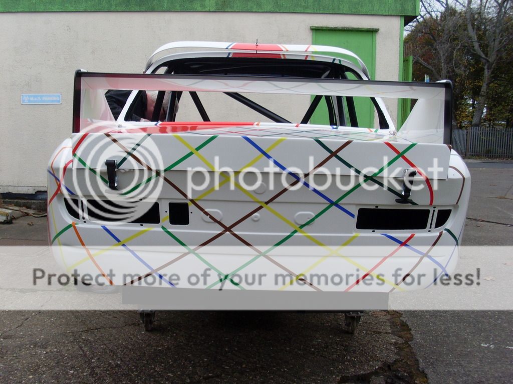

More pics and vids from August trip. Test fitting everything we need to before paint. Exciting as it starts to get very close to painting....

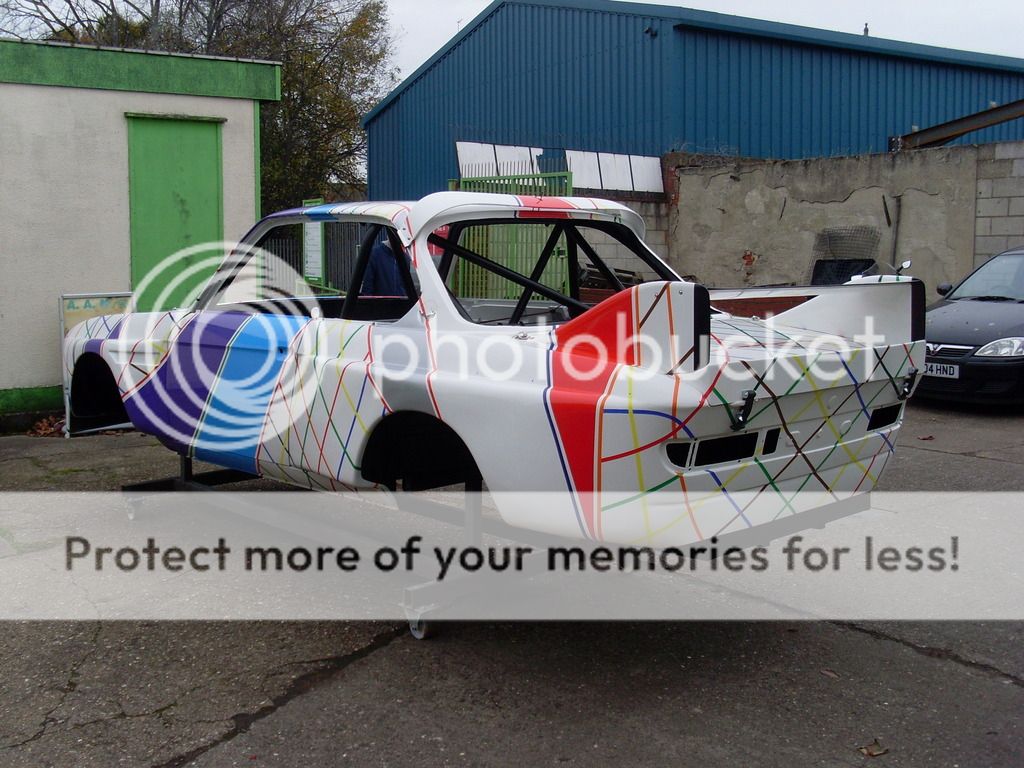

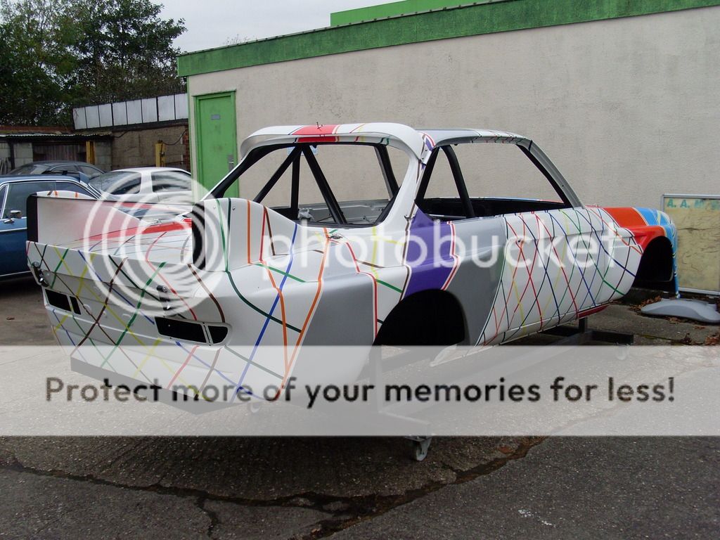

Paint will be white on the outside, black on the inside. Livery undecided. Recommendations welcome!

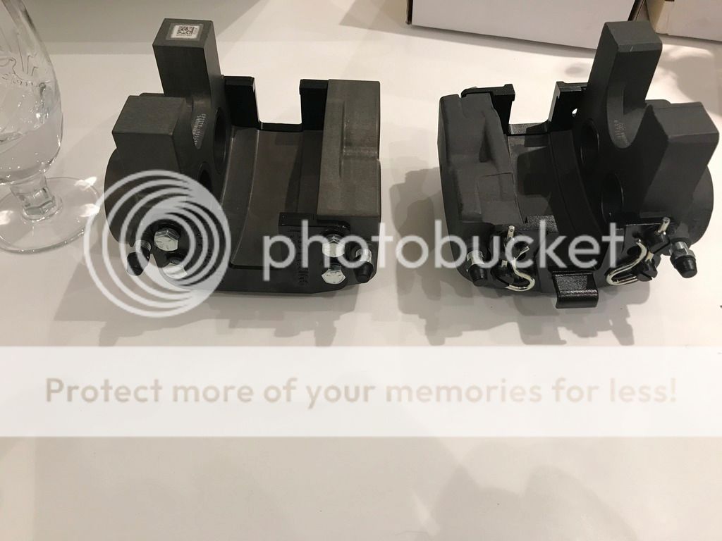

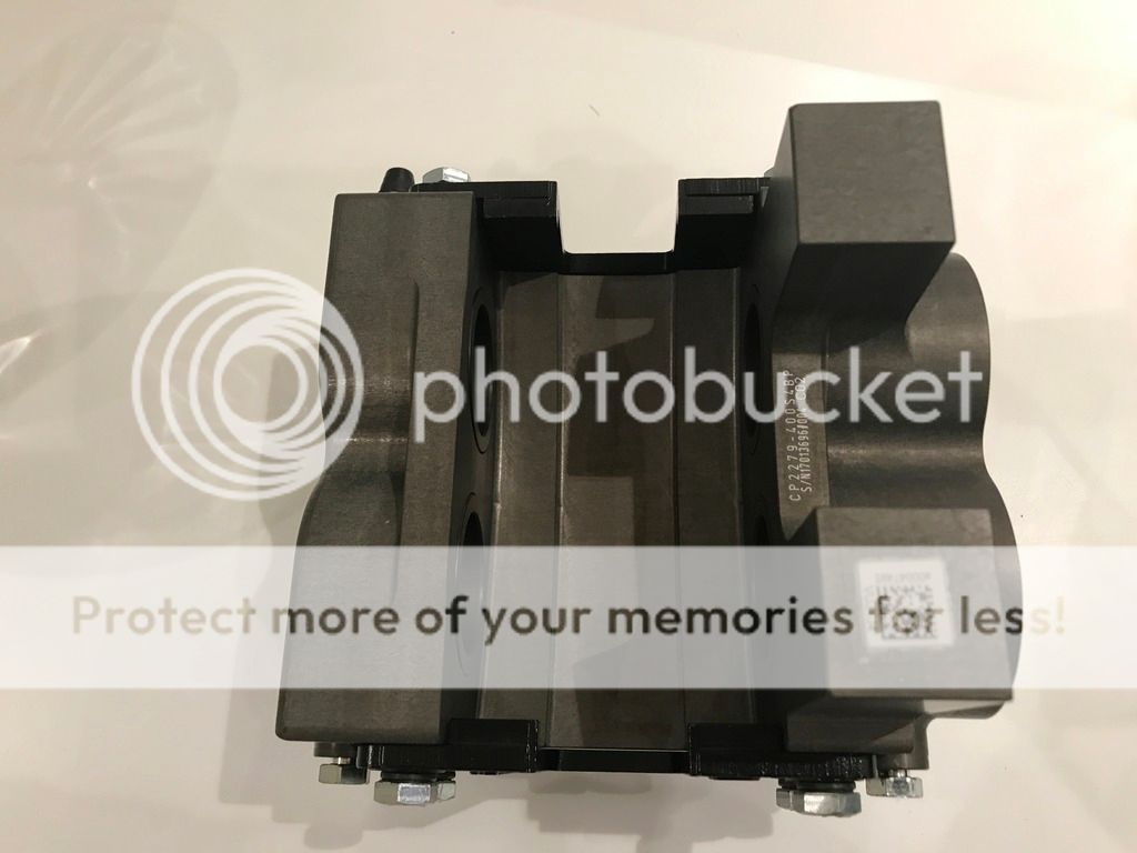

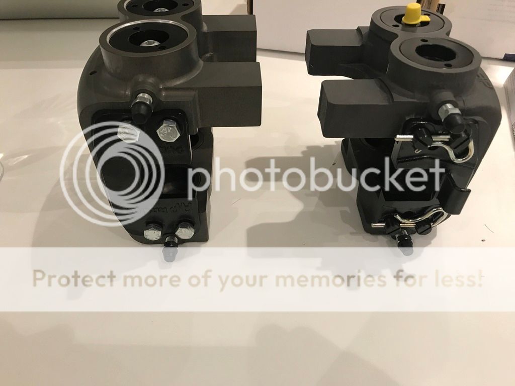

Brakes etc will be period historic AP's either 2279 or 2270 on the front and 2271 on the rear. Hoping to get Martin at Reyland to do these for me.
https://www.apracing.com/product_de...2279-closed_backed_caliper-ø44.5mm_bores.aspx

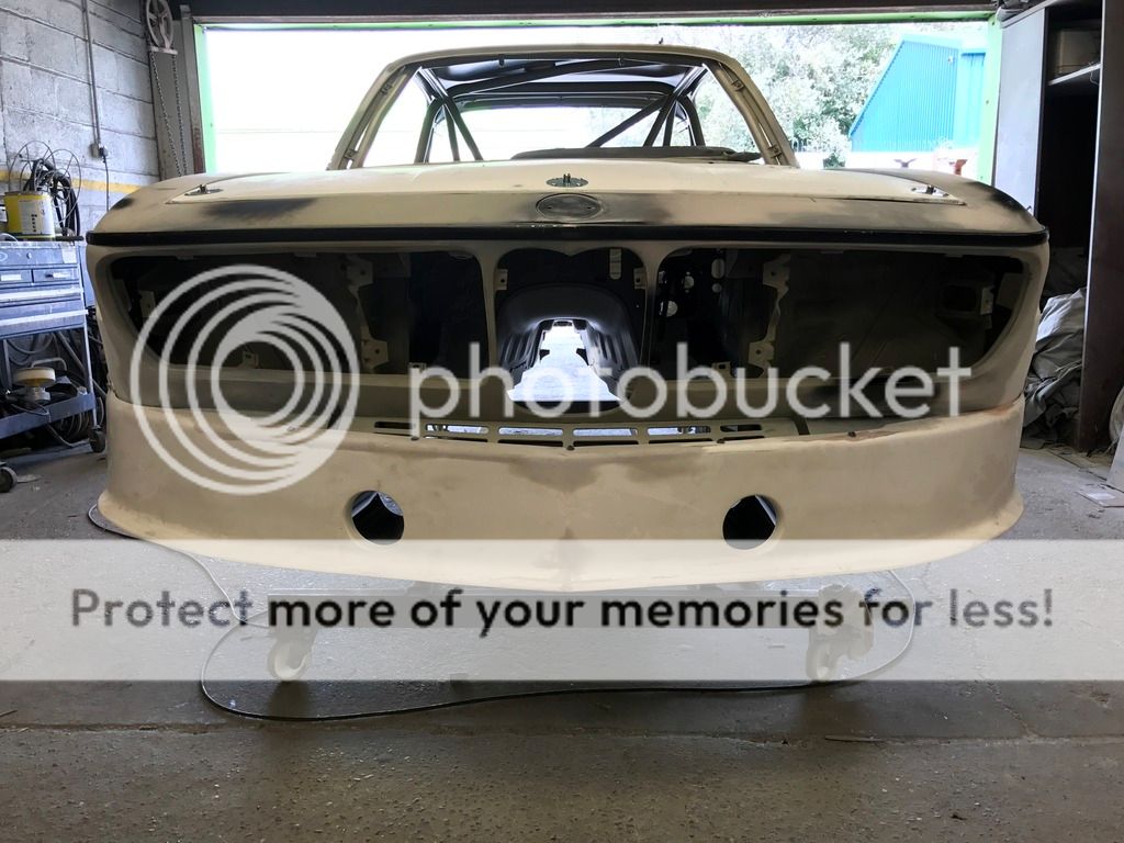

Damn that looks like top work! Congratulations.
I notice you left the holes for the front bumpers but not for the back ones... I'm guessing that is going to be for tow hooks? If so, why only in the front? You never know which way you will be pointing once stuck in those sand traps... ;)
Good point, I'll double check that - I definitely have 2 hooks, one for each end so not sure why it's not pre-cut.

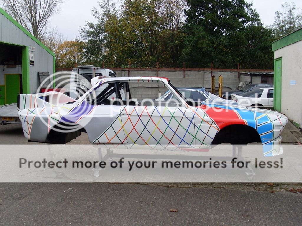

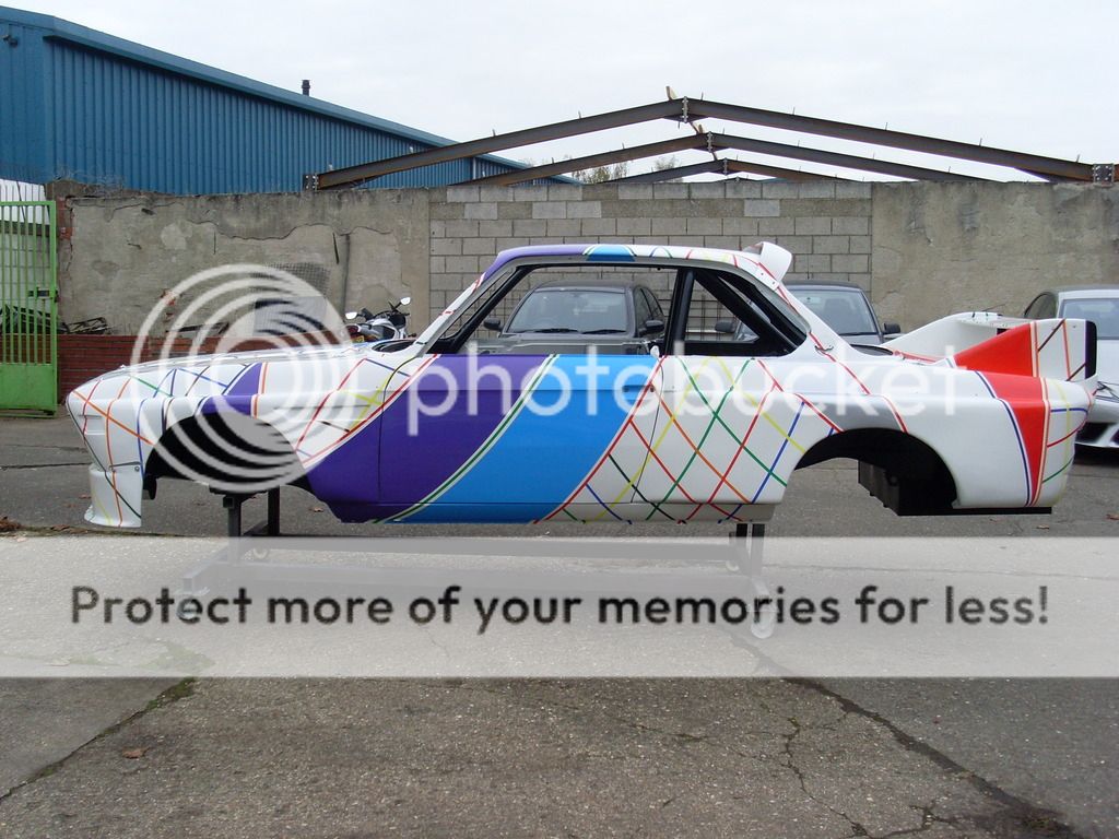

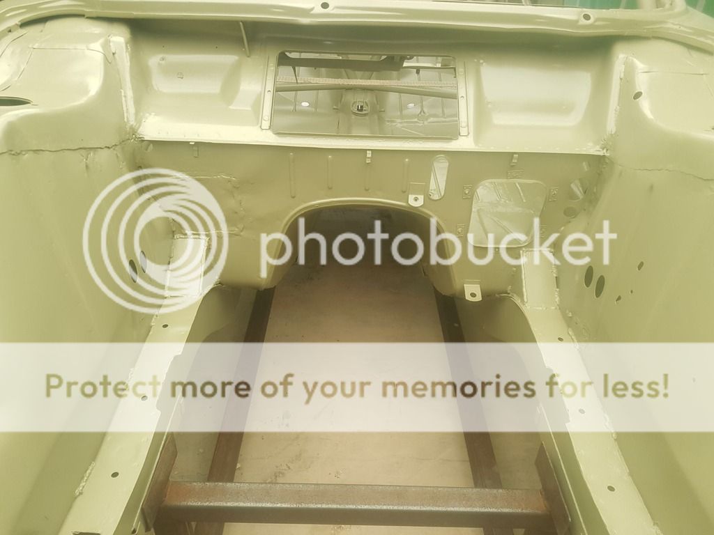

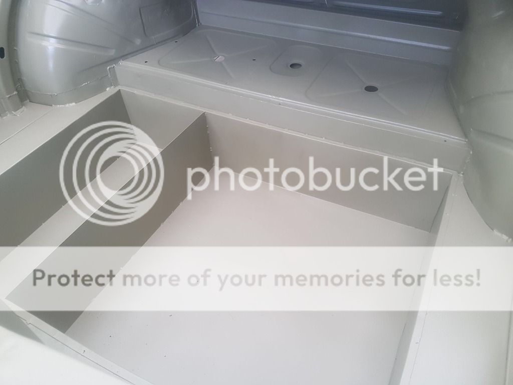

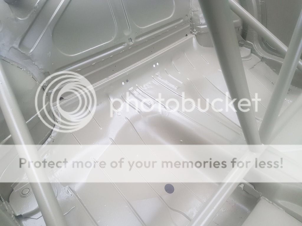

Car back from acid dipping last week and obviously needed some more repairs than initially anticipated. Some horrid previous repairs done, but hey at least I actually got a shell back (I had nightmares of them just delivering me a cardboard box of what was left of the shell!).
Good news is that a lot of the body shell parts are still available from BMW so getting those ordered up this week. What I'll spend in parts I'll ultimately save in fabrication costs so I'm hoping this is the right route to take.
A few pics for you. Thanks for reading, will keep you posted as the parts go back together.
