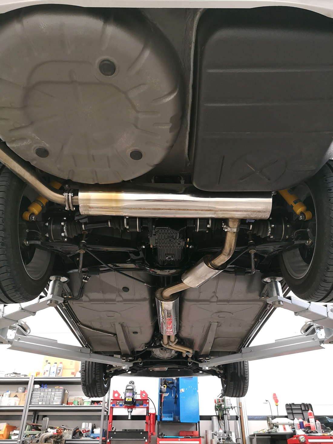

hey Robert, the underside of your coupe is looking quite excellent! we already know the topside is ...
a couple of questions, since you are going in with the 5 speed, did you get the new Coupeking mount?
whose exhaust are you using?

Thank you Scott!
The mount I'm going to use is the (supposedly on the weak side) aluminium version, part # 23711175731. Only reason is that it was included in the gearbox deal, and that a new CK mount will be north of 500€ with shipping and 24% import tax. So I have two new rubbers for the mount, then I'm going to use a swaybar-end bushing part # 31351125712 + a bolt up through the tunnel to support the rear of the shifter platform, and I still haven't decided if I'm going to make an arm (as in the CK kit) that supports the shifter platform from the gearbox itself.
The exhaust is the W&N stainless version, great fit so it's easy to install and I'm very happy with it.

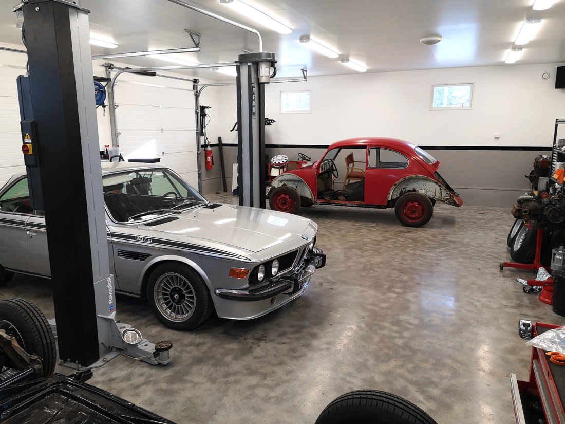

Weather allowed me to switch the coupe over to the other bay with the lift, so now it's about to get the Getrag 265/6 installed, I think (hope) I have all the parts needed for the job.
