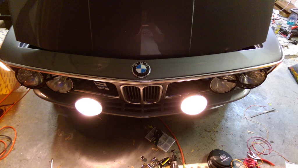

Wired the Lucas fog lights. They are brighter than i thought they'd be. Install was a snap as the units were NOS and came with original wires and connectors. I know they aren't what you'd consider period correct for the mark (Hella's would fit the that bill) but i like them regardless. Really dig the finish and black covers. Goes with the overall scheme really well.
IMAG00458 by J_Otte, on Flickr
Fogs look nice, I really like your headlight wipers. I've only seen them on Luis Arisso's Golf CS.
