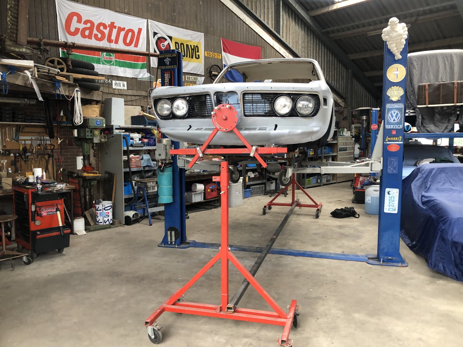

Removed the rotisserie today

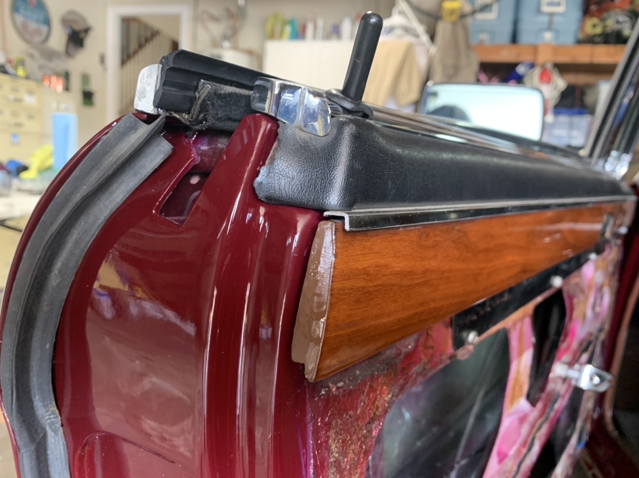

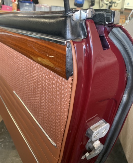

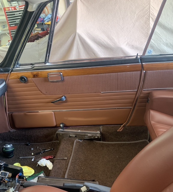

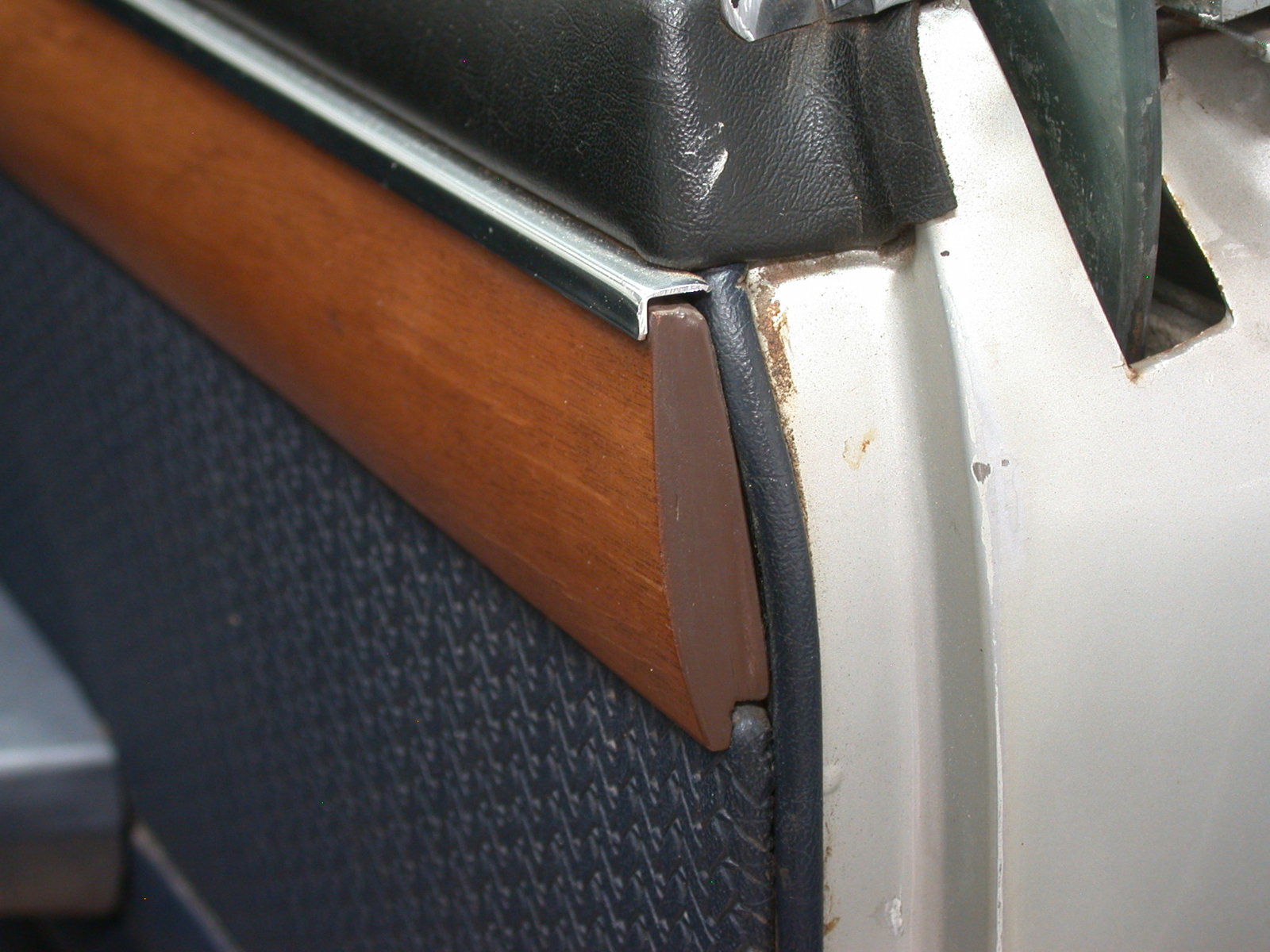

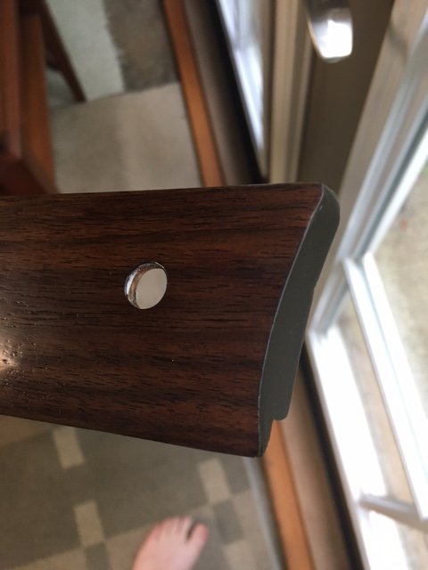

Got passenger side vapor barrier and door card installed, everything tucked in nice. I have been told end of wood should be chocolate brown, not black.
View attachment 121753View attachment 121754

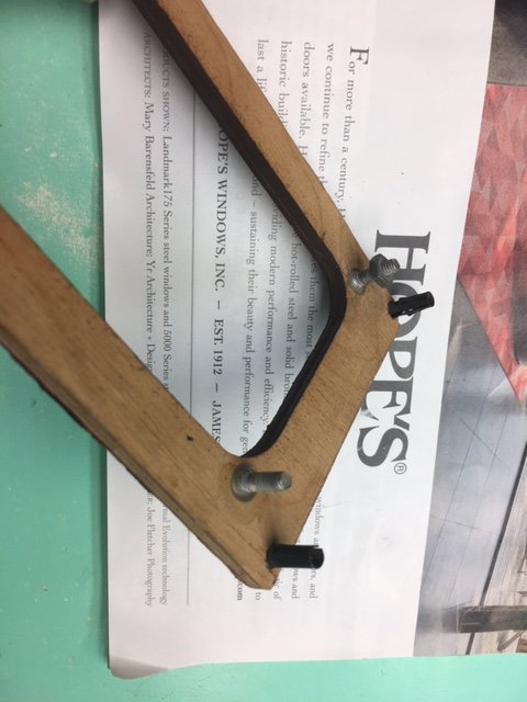

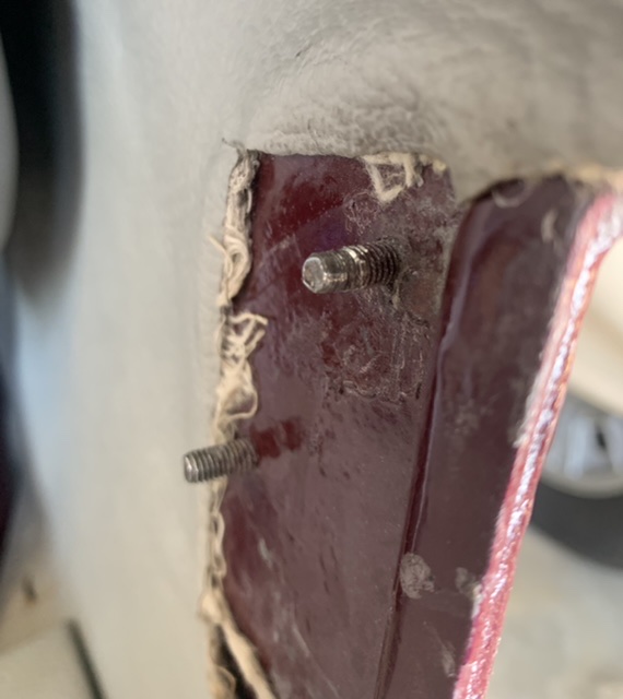

Then things got worse, upper stud is stripped for gas door.

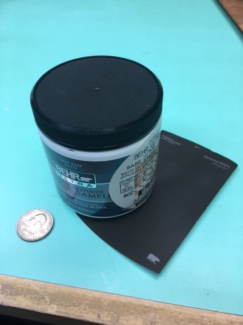

Re: Chocolate brown....Last set that I did, I used Behr Ultra... Expresso Bean satin. Lowe's mixed up a baby sample..pretty much right on the orig molding that I took with me... is plenty for many, many coupes. Around $7.00, I think. I haven't top coated with a satin poly, and don't know that I will. Touch up can be in-situ, if need be.
Other place its brown; on the inside of the speaker grille frame...and on the flip side behind/under the fabric.

Then things got worse, upper stud is stripped for the gas door.
I got lucky, I was able to tap with the original m5 thread. My bracket has been notched for the center stud so I put a nut with a captured washer on it lightly, slipped the hinge under it, tightened a bit, got the upper nut on but without a washer, tightened a bit and then got lower nut on. This lower one is the hardest as the nut has to sit on your fingertip and hope it will sit on the stud while turning with same fingertip!
I chose Behr Rave Raisin as it looks closer to Jon’s coupe. It is still wet in this pic, under $5 too at Home Depot.

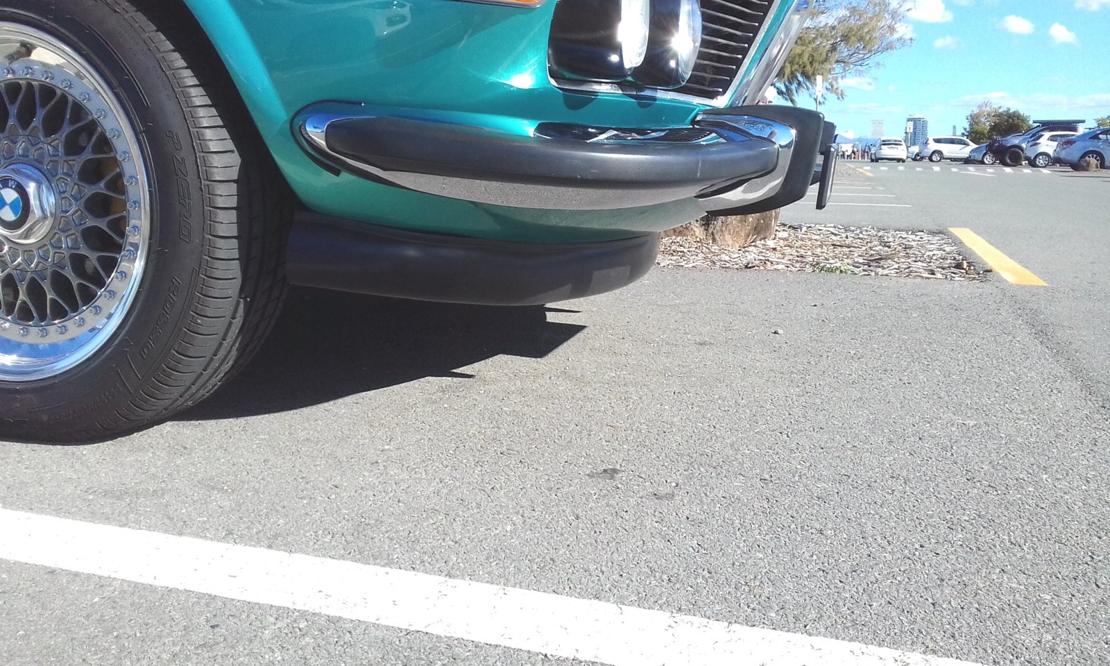

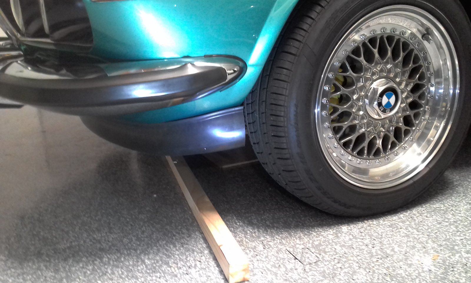

Well I have never been a big fan of the air dams on these cars....seems to detract from the natural lines (it's only my opinion) SO.....I made up my own rubber spoiler for the front......just to give it a bit of a mean look. Also if I have any problems with speed bumps etc etc......its rubber and bends ;) I need to do a little bit of adjustment on the ends....to get a perfect fit.

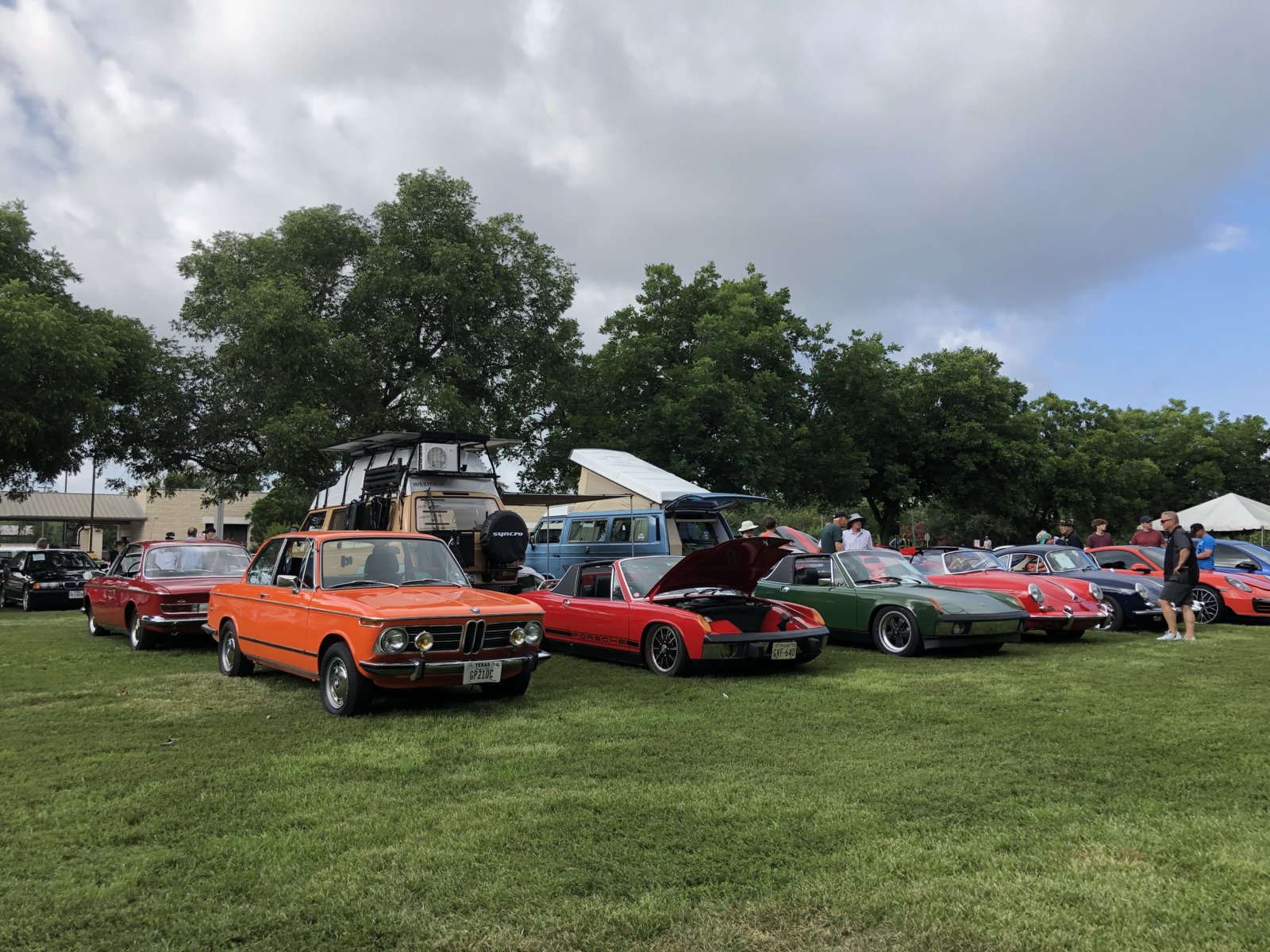

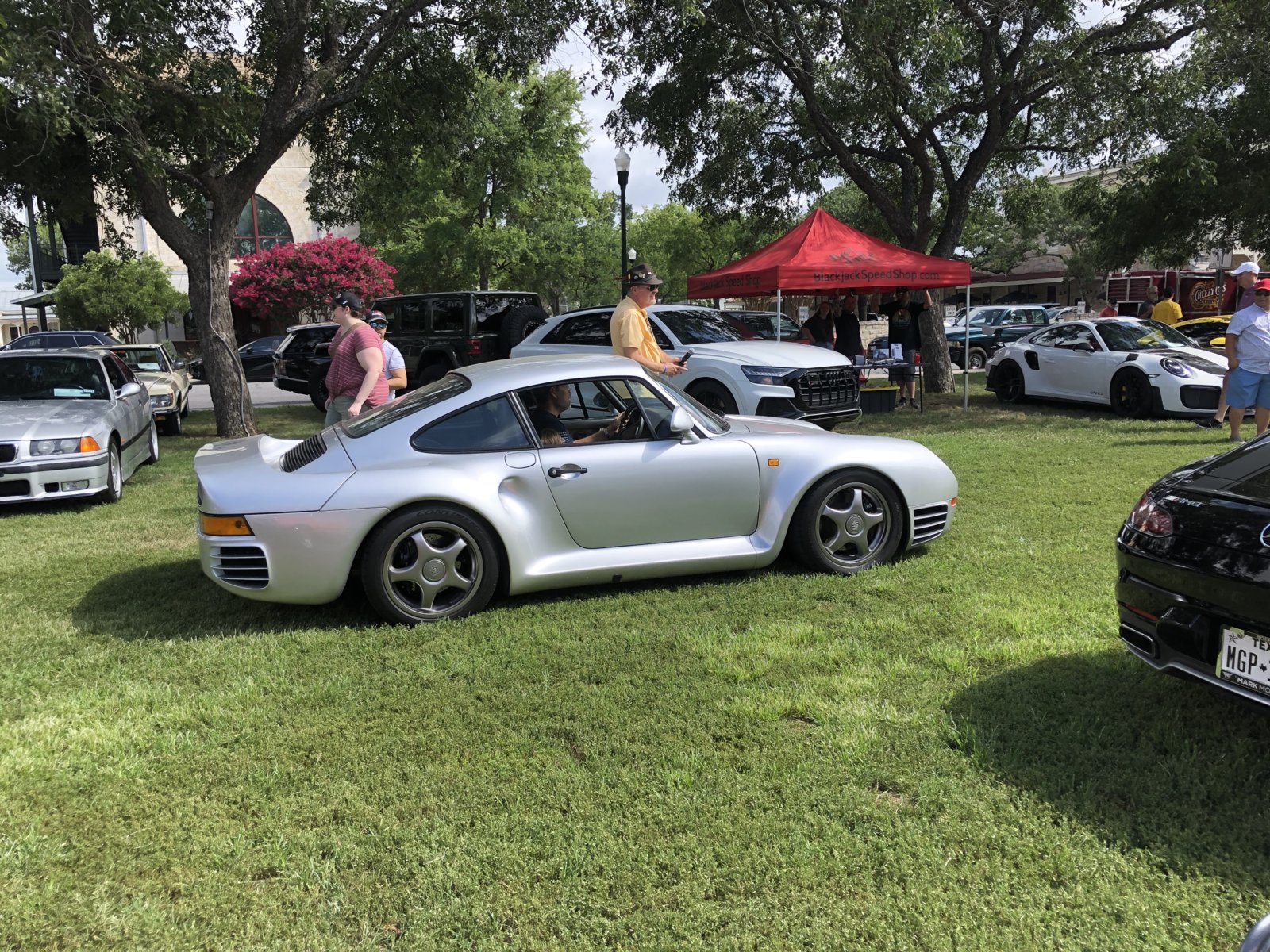

Barney and I attended a German car event in Boerne, Texas ( just north of San Antonio). We both came away with some bling from the judges.
That Porsche 959 was amazing....such a cool machine.

Well I have never been a big fan of the air dams on these cars....seems to detract from the natural lines (it's only my opinion) SO.....I made up my own rubber spoiler for the front......just to give it a bit of a mean look. Also if I have any problems with speed bumps etc etc......its rubber and bends ;) I need to do a little bit of adjustment on the ends....to get a perfect fit.View attachment 122006View attachment 122007View attachment 122008
Paul-I thought you had that special Kooglewerks air dam under the bumper. --Drew

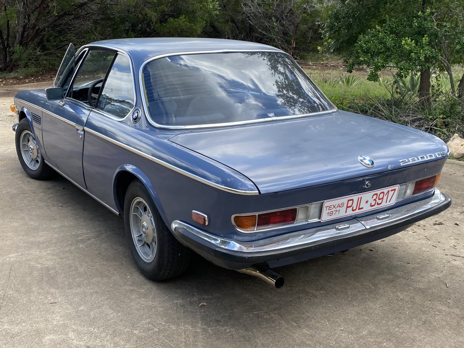

Drove a 100 plus miles today in coupe / 125 yesterday over 1600 miles since purchasing Equal to the amount of miles put on it in the last 12 years got out on highway for some 80mph action really like the way it pulls at 70/75…
Is that a legit TX license plate?
