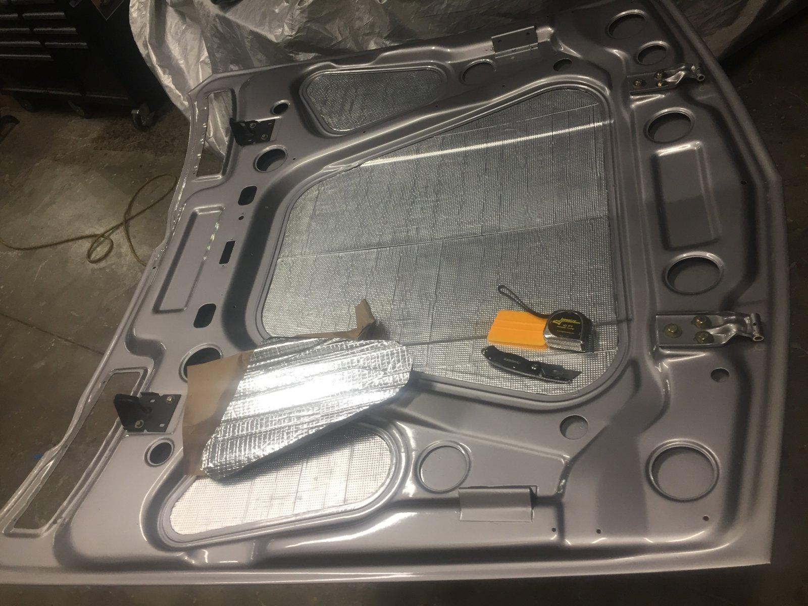

I gave up on the foam-crap. It seems I can’t cut the foam in a straight line.
I added the perforated look, B-quiet sounding the material to the under hood area. I I I used a lot of Bondo to cover those seams up on the outside edges of the hood.
It goes on the car tomorrow.

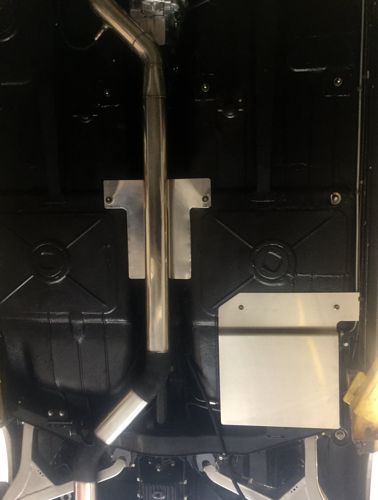

Paul: Two 2" pipes from the exhaust headers into a 3" oval, into a 3" muffler/final exhaust.
The pictures don't do the system justice, the welds are artwork. Great vendor, Bluemaxx here in Cumming GA.

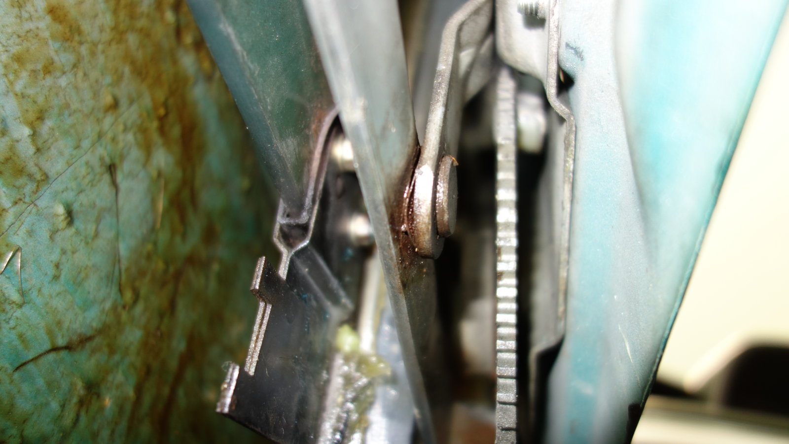

My passenger door was giving me fits to latch fully. Unless I closed it with firm, but not hard constant pressure, it would bounce out of the latch receiver. I could latch it from the outside, but even I couldn't finesse it to close by pulling the handle from the inside. I looked like such a gentleman every time I helped my wife to get seated, and gallantly closed the door for her!;)
So I took the opportunity to address that latch, do a bit of refurb on the door, and get my window moving a little faster.
After much effort I learned that adjusting the latch receiver was not getting me anywhere. Thanks to a passing comment in someone's build blog, he mentioned adjusting the door handle mechanism... Eureka!:D This door handle mechanism was adjusted such that it was so tight on closure that just a touch of the door handle would trigger it open, thus explaining why my door would "bounce" out of the latch. I cleaned it up and replaced the felt. With adjustment, the door now latches well.

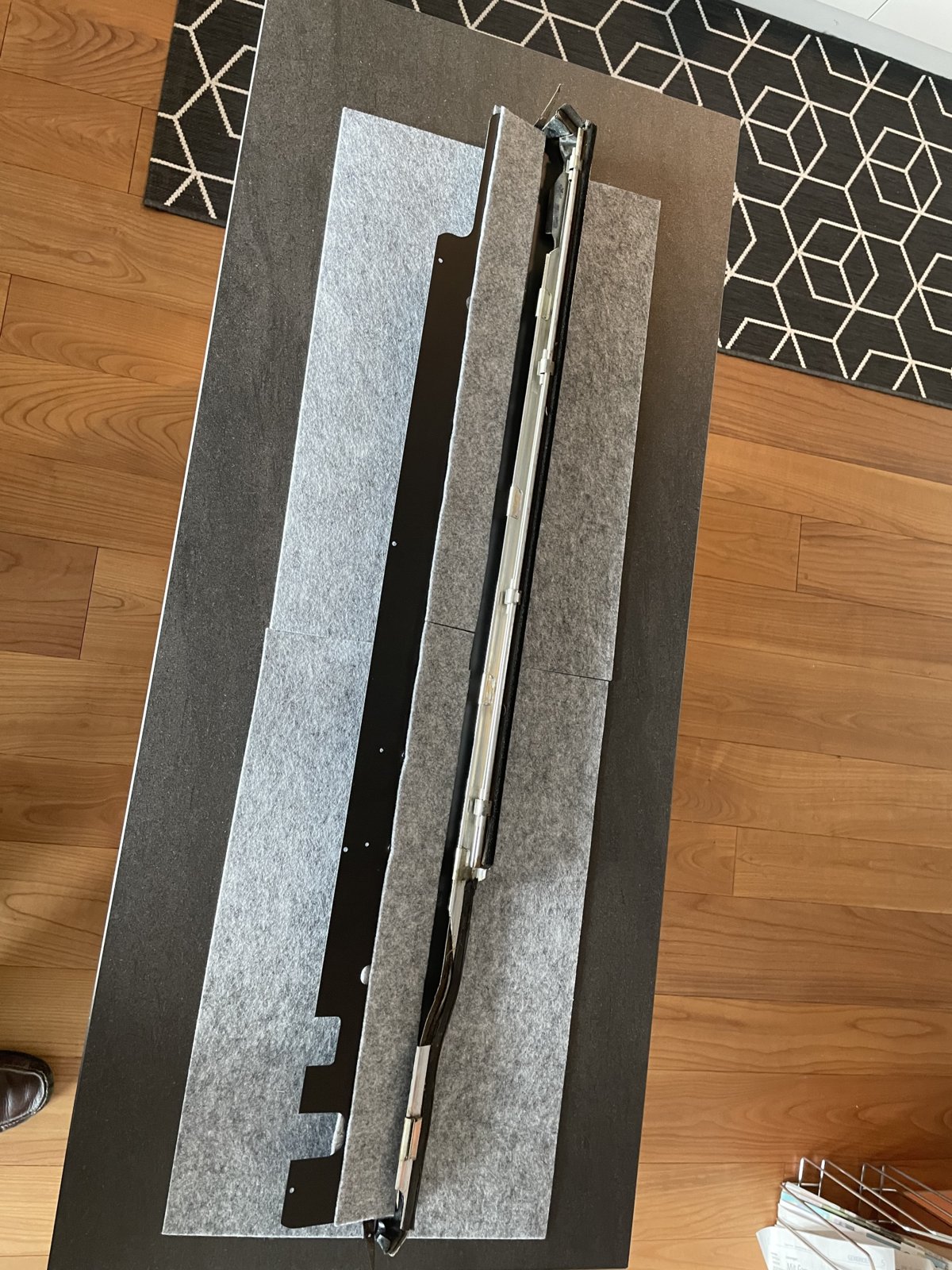

The felt on the door trim was toast, so i stripped, sanded, painted, and installed new felt.

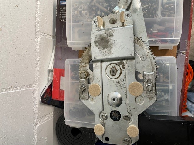

My window was taking almost 11 seconds in both directions, up and down. On inspection, the grease was actually OK, clearly all cleaned and lubed as part of Oldenzaal's renovation process.
I cleaned out all of the tracks and re-lubed everything.
I removed the bearing slide and rail for cleaning and lubrication.
On reinstallation, I confess to over-torqueing the studs at the top of the rail. I pulled them loose from the bracket they are braised into. I drilled out the two stud seats and replaced them with M6 bolts. My friendly local mechanic tack-welded them in place for me (at no charge! :)).

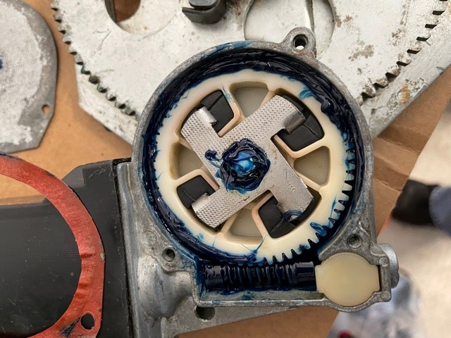

Removed the regulator motor and replaced the grease with Kroll wheel bearing grease. This is the original Series II motor. With the motor mounted to the regulator, the time to travel lock-to-lock was 7.8 seconds.
After reinstalling everything and getting the window tracking smoothly without the regulator in place, I re-installed the regulator. I was able to get the window speed up and down to the same 7.8 seconds I had with the regulator free-wheeling, so without an E28 motor change, I figure that's as good as it gets!
All of my windows are now at about 8-9 seconds up and down, so until I am ready for the big E28 motor project (assuming I can find motors) , I am happy with the result.

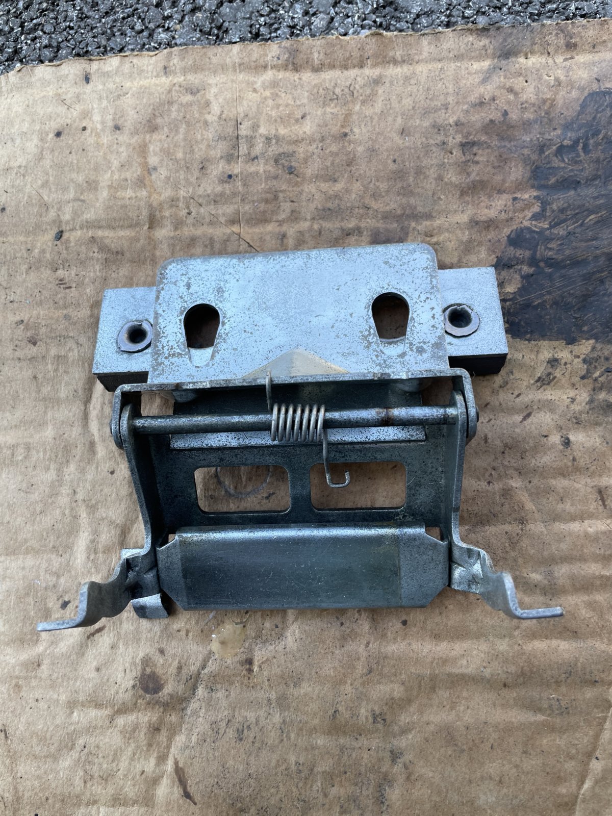

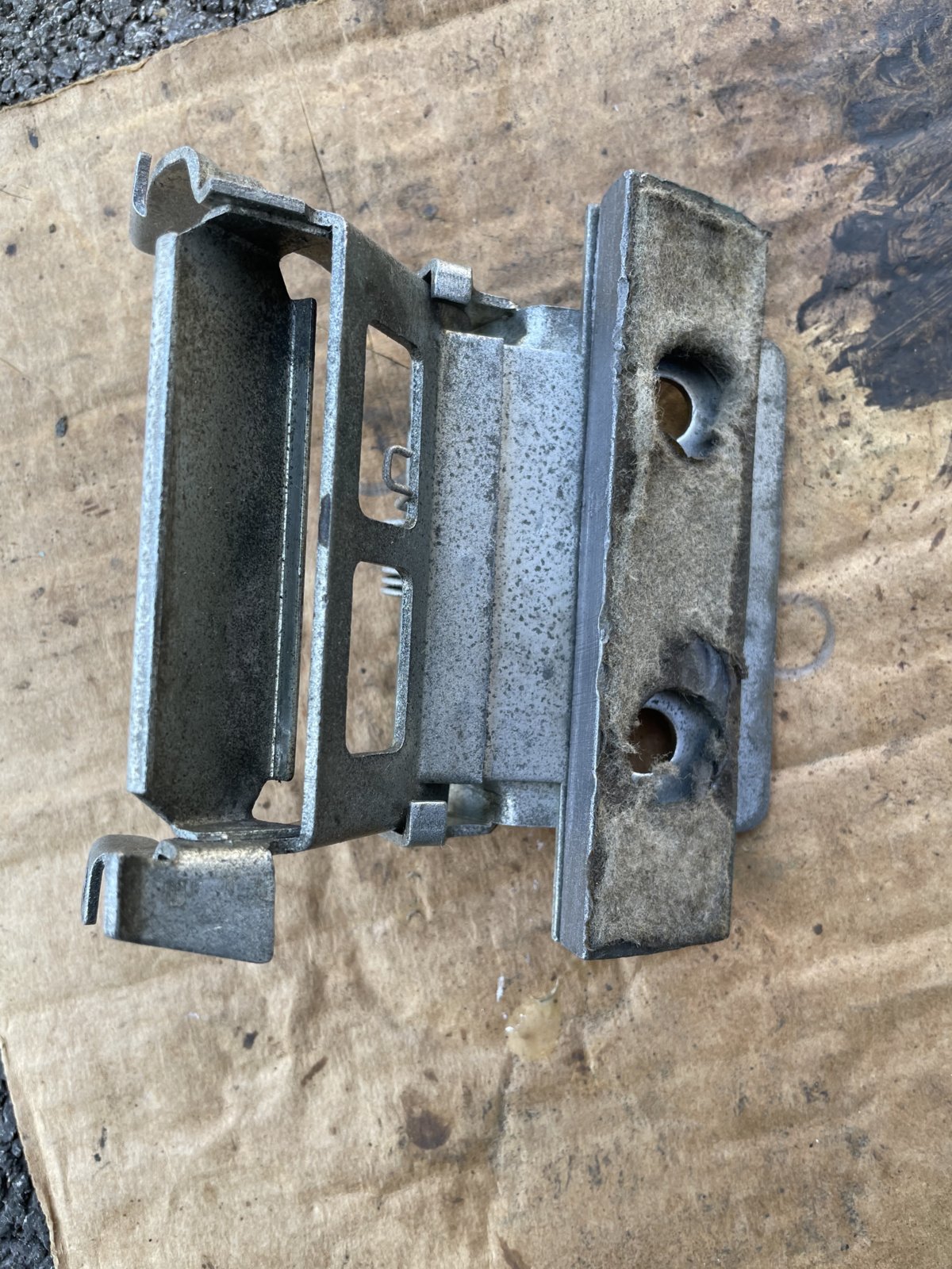

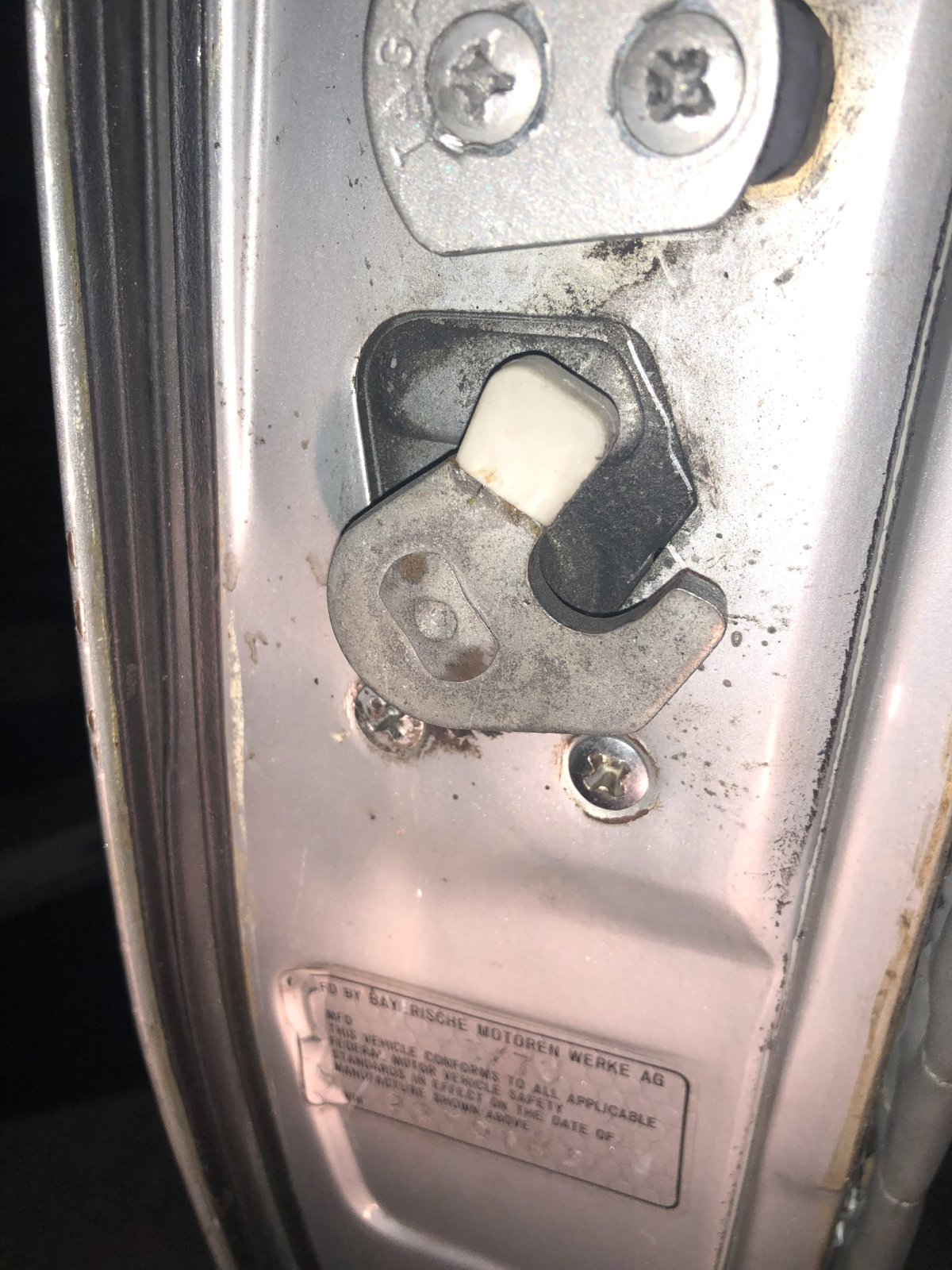

I fought with mine for years and found out I was missing a part of the lock mechanism.
in the pic it is the bright grey part that fits on the flip lever. It takes up the slack and aligns the door closure.
That part was given to me by a previous member of our forum RANMAN.
Only the old timers on the site will remember him.
You will still have to close with authority (it is 50 years old). But door reveal and lock will be tight.
Just my experience and hope that it might help.
I have no idea of part # or description.
