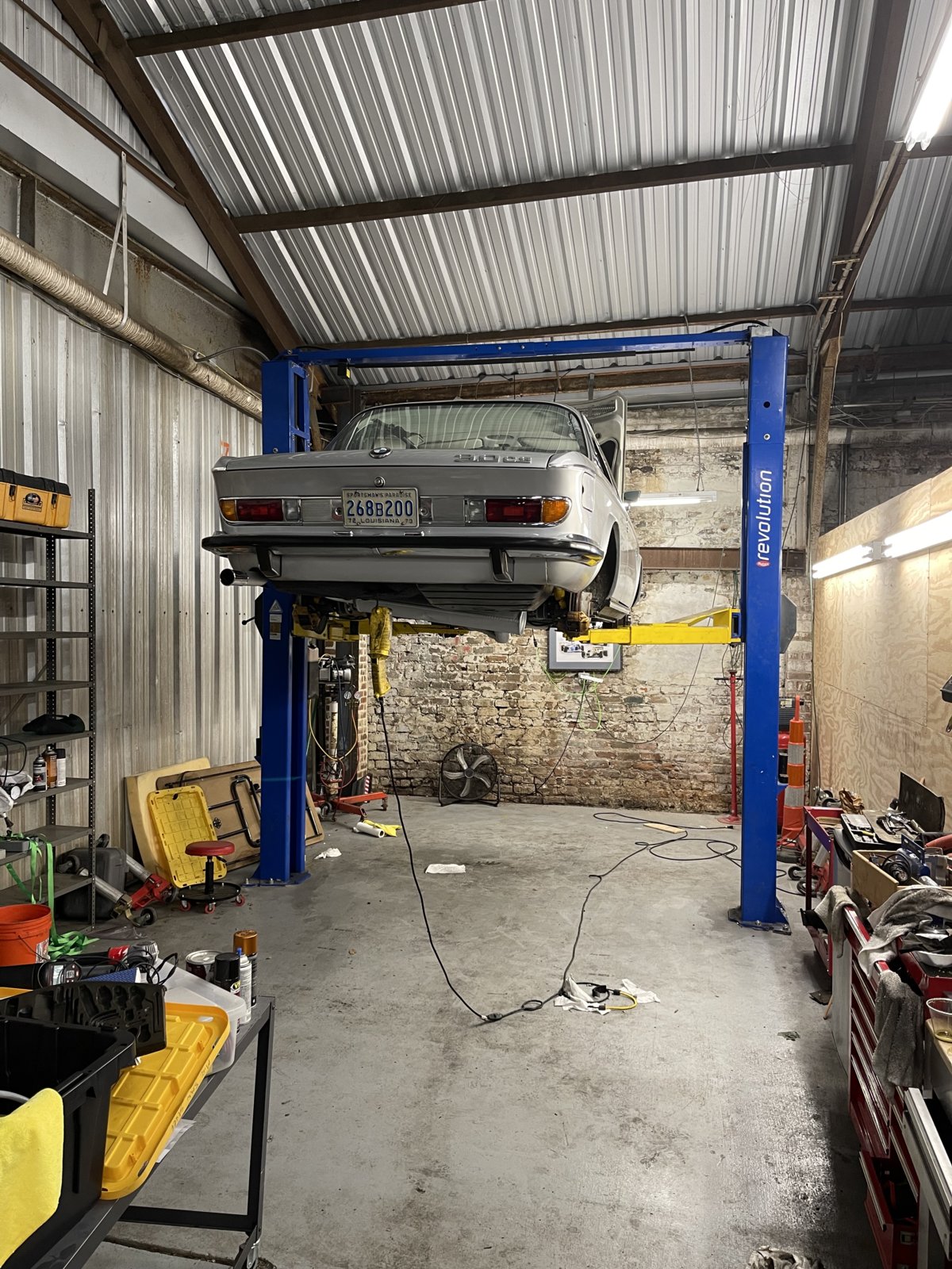

Last weekend I put the car on a lift to replace the blue brake and clutch reservoir hoses with new ones. These look good but are not the right size, however if you hit the end with a heat gun to soften it up a little and lube the plastic inserts with a touch of brake fluid they will go on. This led to:
-new slave cylinder which crapped its guts during bleeding. While waiting for the part I went on to:
-fabricate a new rear exhaust hanger I noticed was failing
-loosened all the exhaust system connections so I could manipulate the rear muffler back level, hanging low at one end has been bothering me for years
-jb weld some holes and repaint said exhaust system with por15 hi temp paint
-touched up peeling paint on driveshaft
-touched up peeling undercoating
-noticed my ac compressor bracket was just touching the sway bar so I took that all apart and ground down some pieces to make clearance
-touched up paint on front suspension components
-cleaned the calipers
-fixed curb rash and repainted my rims (3 day job “while they’re off the car for brake bleeding”)
Moral of the story: don’t change your brake reservoir hoses!
Steve, Where did you do this since you have moved?
My friends own a collector car storage facility where I now keep my car. It has a 2 post lift which opens a world of maintenance and scope creep possibilities. It’s where I put my csi piano top pistons in as well.

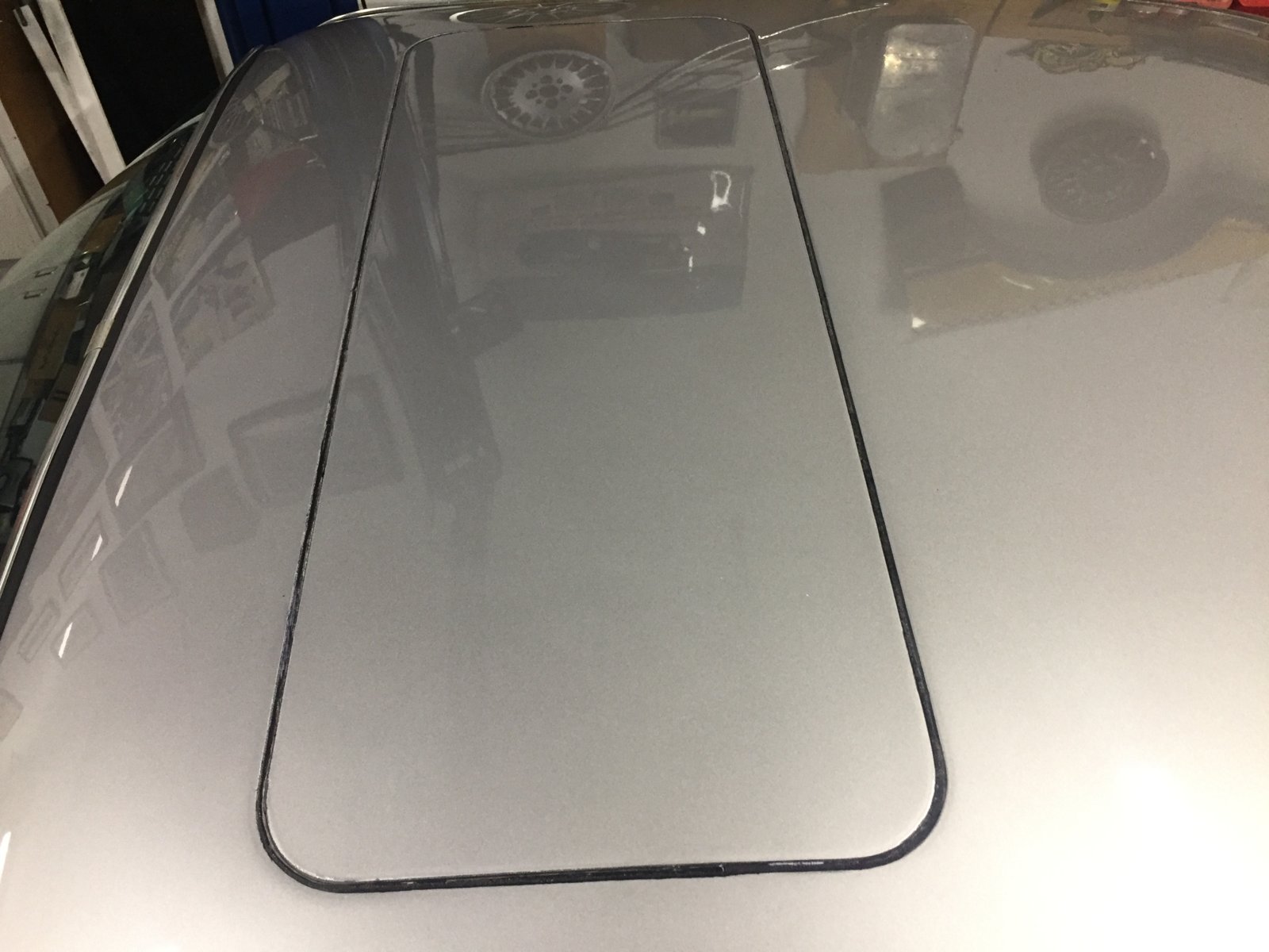

Painted the sunroof trim that was painted silver by the paint guy ‘cause I was too lazy to remove it or cover it with tape.
Geez.

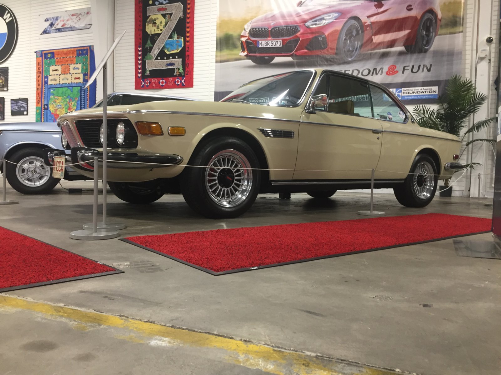

View attachment 128247Didn’t do any work on my car , but had a chance to see this 2800 at the BMWCCA foundation.
Nice.
Inspiration for the weekend.
RP
Parker Spooner's coupe. Don't know his whole story, just that he was one of the founding members of CCA. Maybe the president or editor of Roundel, maybe both. Chris or Stan probably know his details. Lonnie and Lou Ann Shirk owned it for a few years. There's a Parker Spooner Award every year at OctoberFest awarded to an E9. Mine won in 2016, it was a very pleasant surprise.
Parker Spooner-Michael Izor-Lonny & Lou Ann Shirk Coupe. Was donated to The Foundation in 2020. This & Take Rachlin's 1974 2002Tii are the two most significant cars to the history of the BMW CCA. Athena & I won The Parker Spooner & Best of Show in 2017 at O'Fest in New Orleans LA.
