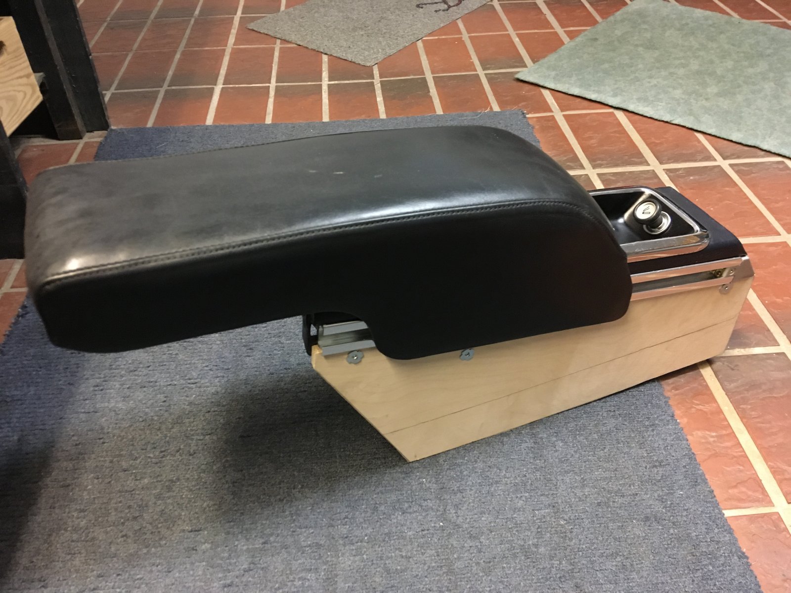

OK, so I put the E3 armrest in the E9. My car has Recaro seats and width between the seats is 18 cm. E3 Armrest is 15,5 cm width. I think it works and looks ok even if the middle armrest is pushed back. See fotos. Maybe a bit massive? Even the leather fits nearly. Main problem : it is too low about 6 cm and I have to think about the fixing problem which is a even bigger problem when I have to lift the armrest about 6 cm. And I have to drill holes in the E9 body 100%. Also I can´t use and see the back ashtray anymore (ok it is not allowed to use it also) :(
View attachment 175012View attachment 175013View attachment 175014View attachment 175015View attachment 175016

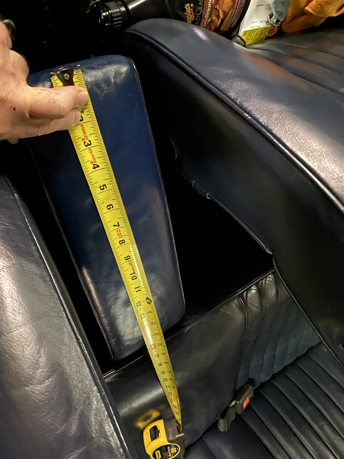

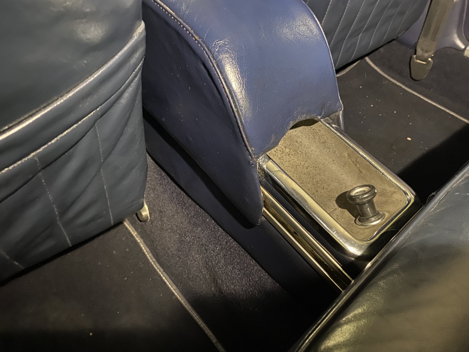

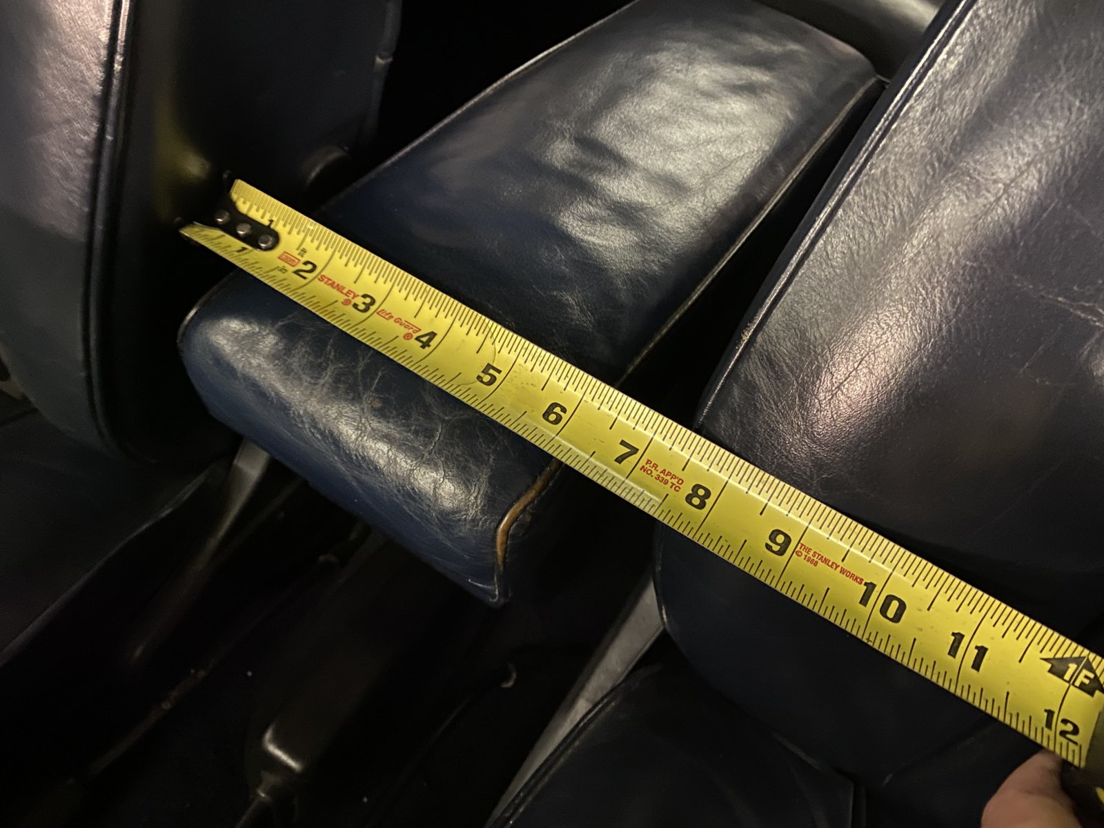

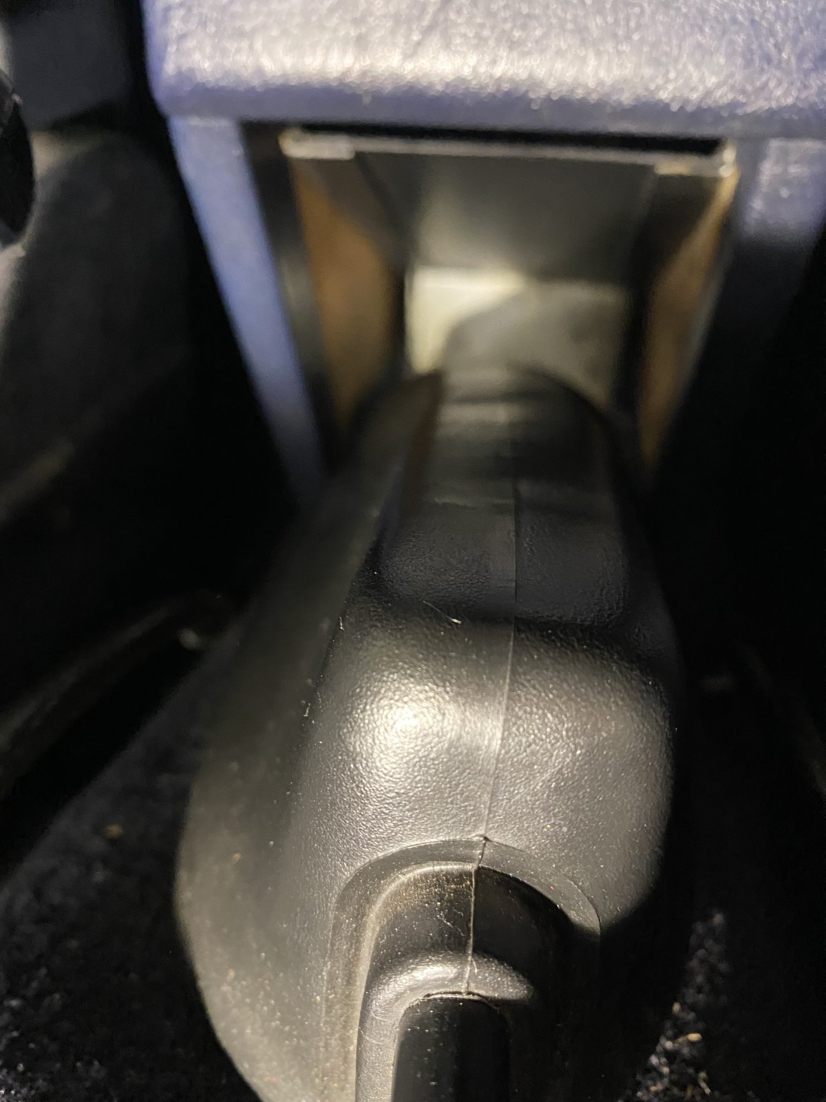

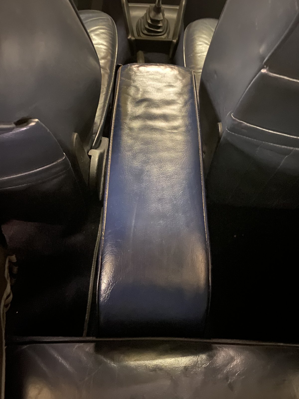

@adawil2002 ...... @Dick Steinkamp ......... @rsporsche and others .......Ok gents, on the 3.3li - I have tried to get as much as I can and hope pictures turn out - see below for comments and let me know if you need anything else
Pete
width between seats
Underside, looking back from hand brake - wood structure with metal for sliding mechanism is roof of cubby hole
armrest extended fully forward sitting on back seat
Actually decent structure down to floor in rear and sliding mechanism can be seen here - sitting in rear seat
Under armrest at front again behind hand brake
armrest all the way back - meets rear seat perfectly
Width of armrest
The full length of everything on the armrest is 18 1/2 inches
