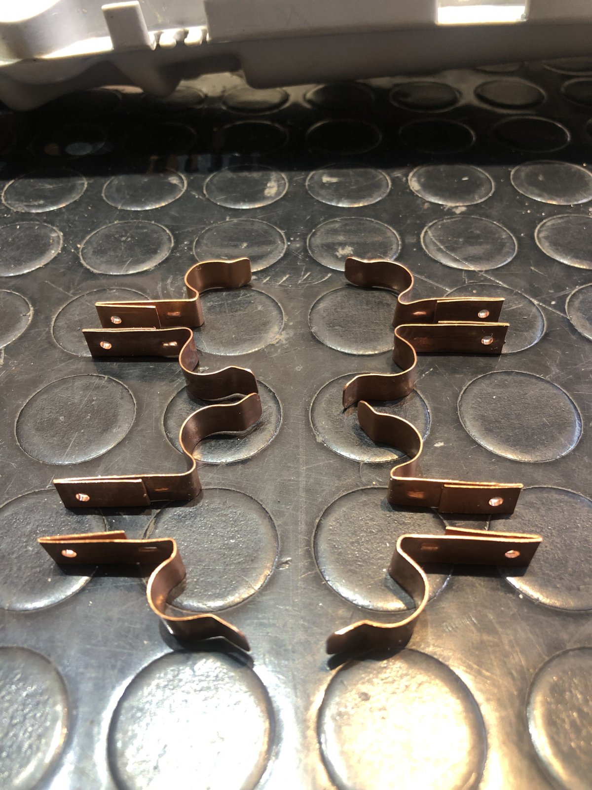

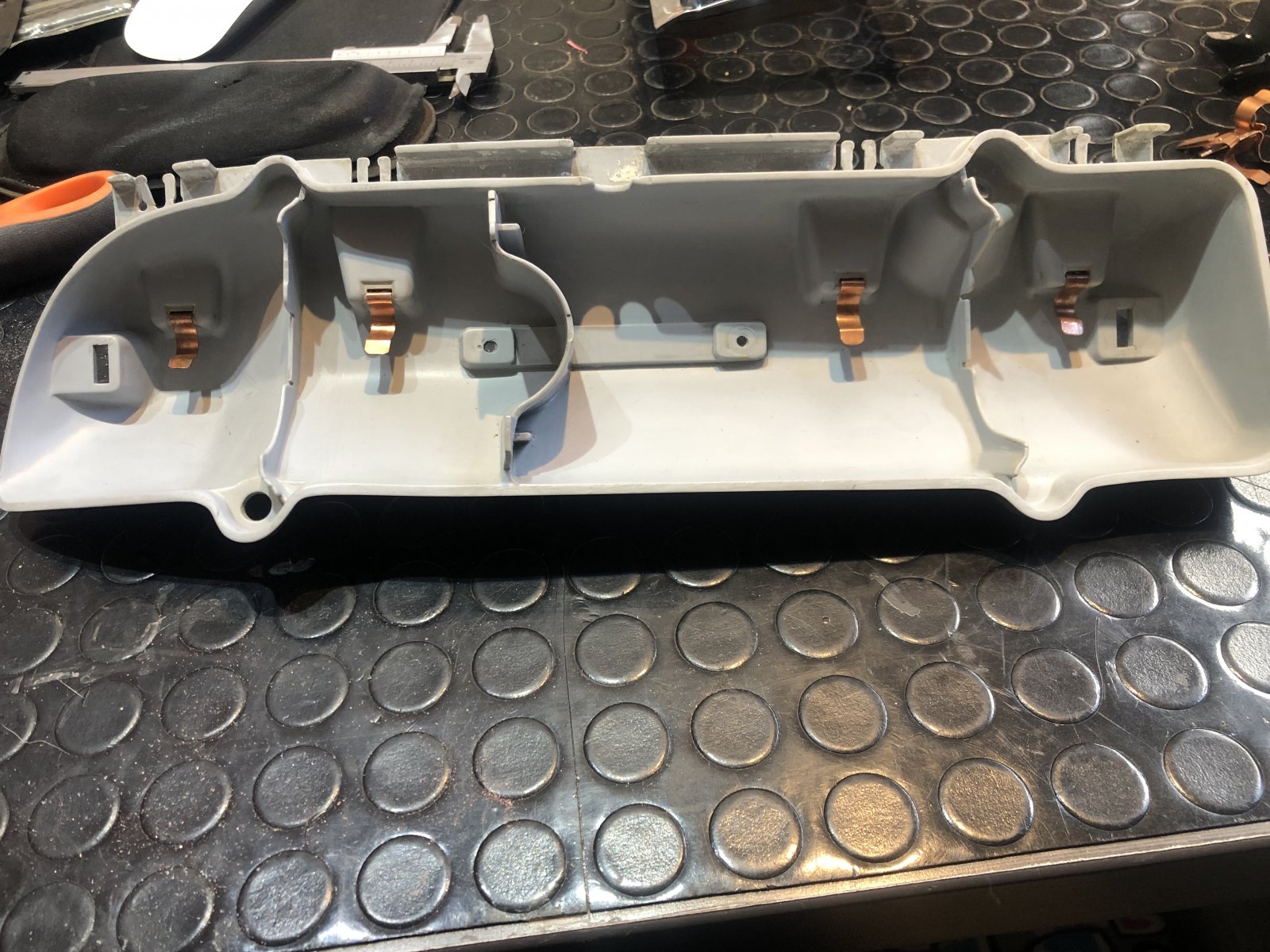

New tail lights connectors

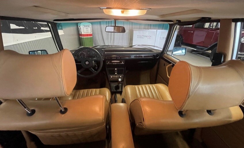

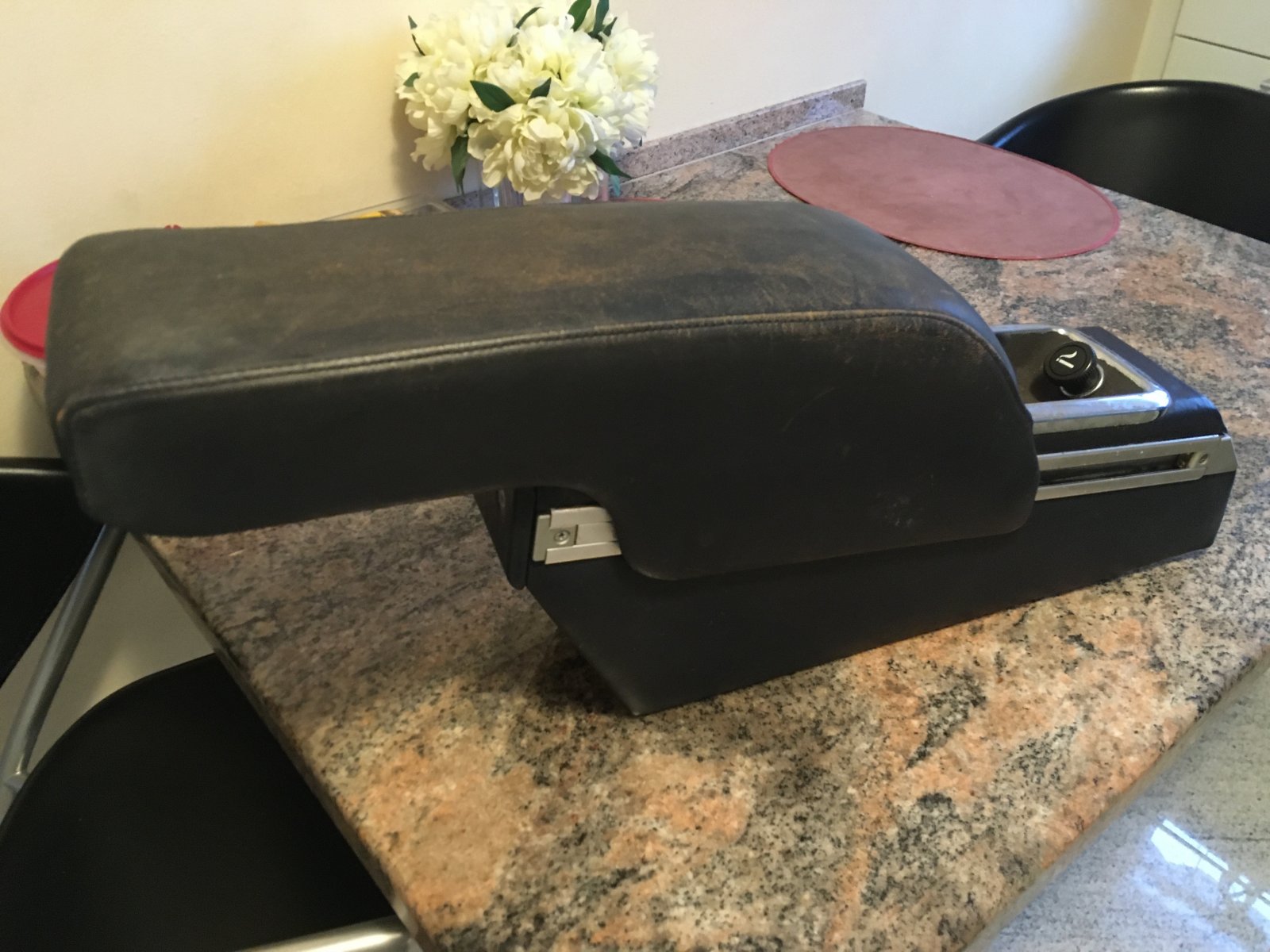

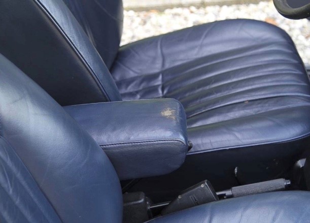

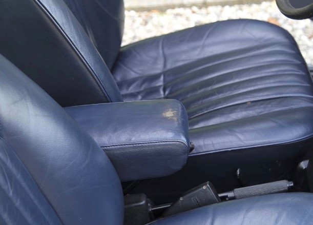

The E3 3.3 Li had this front-middle-armrest only. Rare item i think. It will fit the space between the E9 seats. Main problem is fixing it safe to the floor.View attachment 174975View attachment 174978View attachment 174977

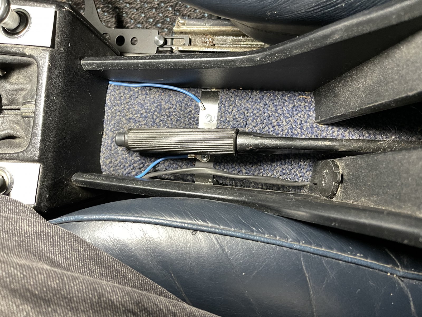

Someone on here must have a 3.3Li. @OCCoupe owned one for a few years, he may have reference photos. @Dirk has a Taiga 3.3Li & may also have a few reference photos too.

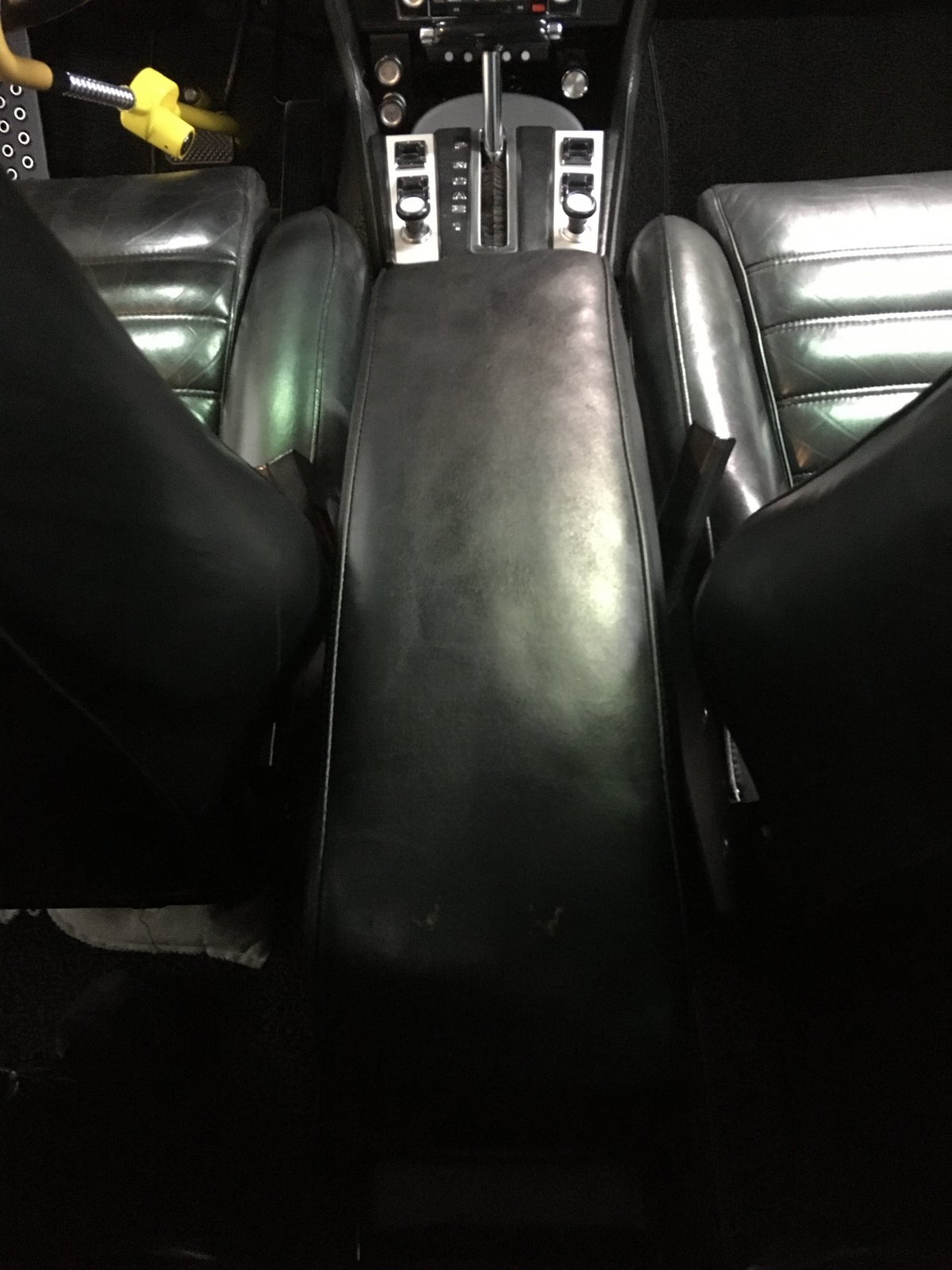

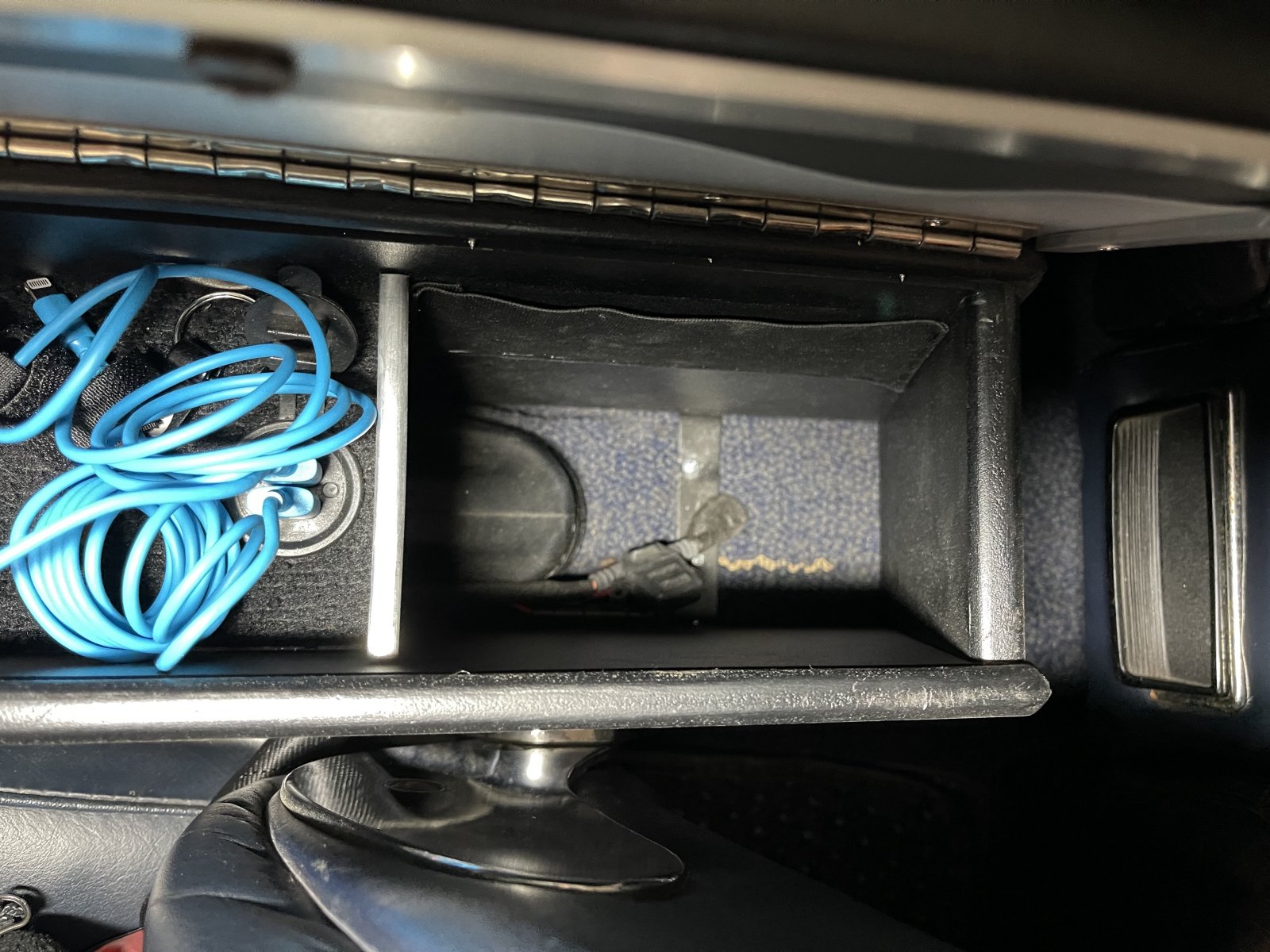

This is the center armrest console Eric Anton sold many years ago. It screws to the transmission tunnel with 4 stainless screws 2 a few inches from the shift console & 2 in the rear under the folding arm rest. There's a small piece of black speaker cloth that covers the front bracket.

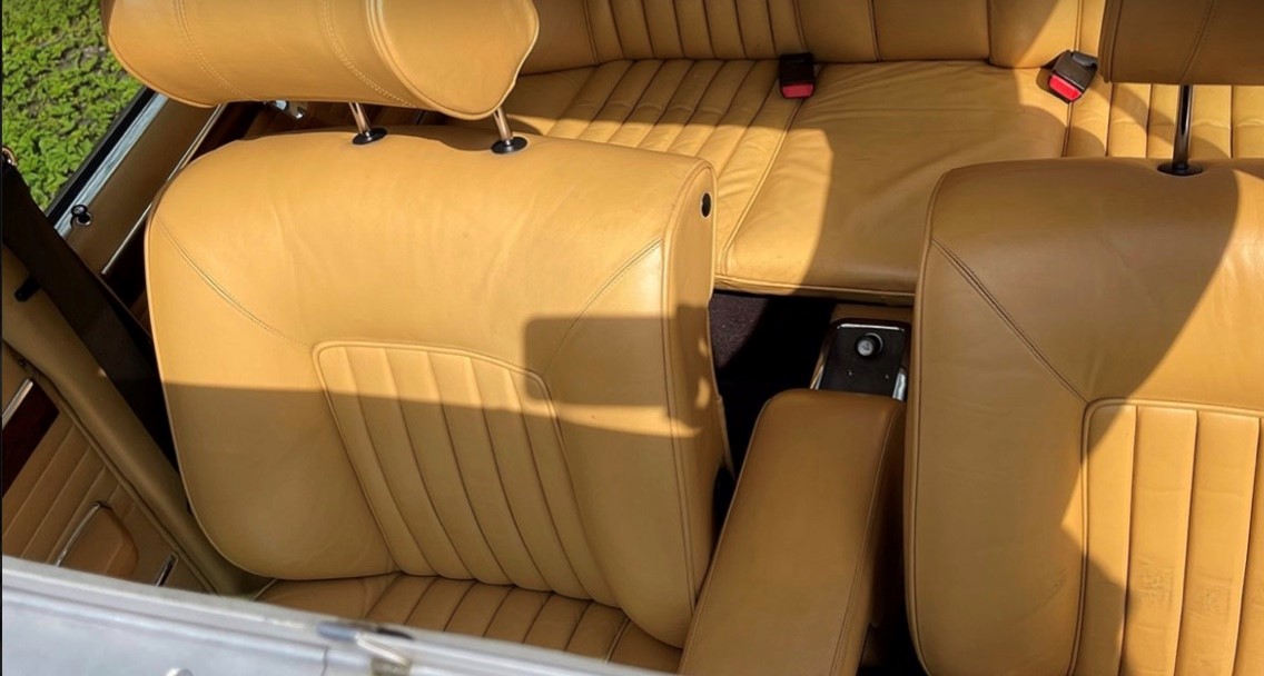

nice looking piece. never seen one. i also have the Eric Anton piece but have been toying with the idea of designing / building a nicer piece that integrates with the shift / ac console. who knows, might just cover the Anton piece with leather on all sides and just dress it up a bit.

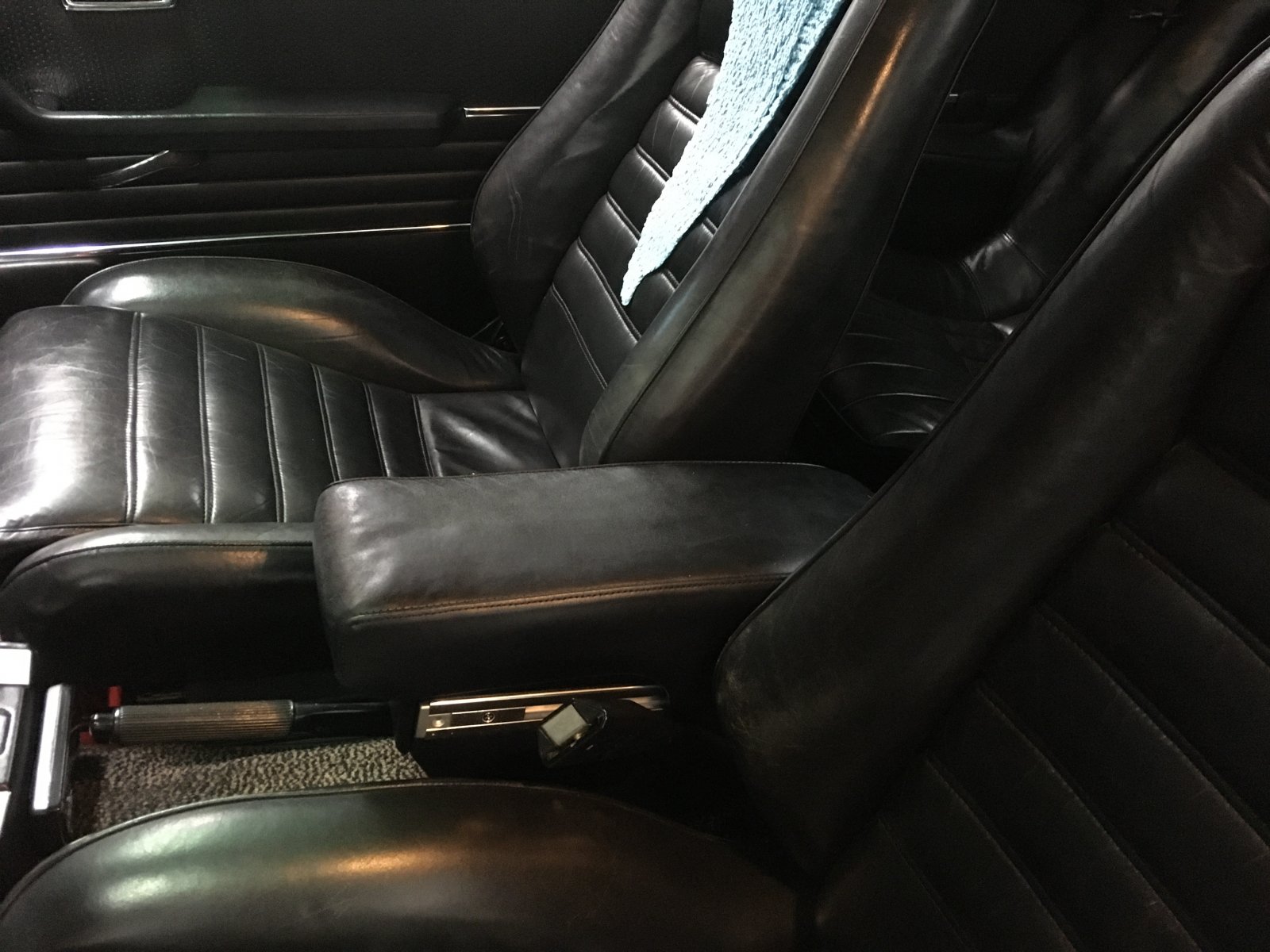

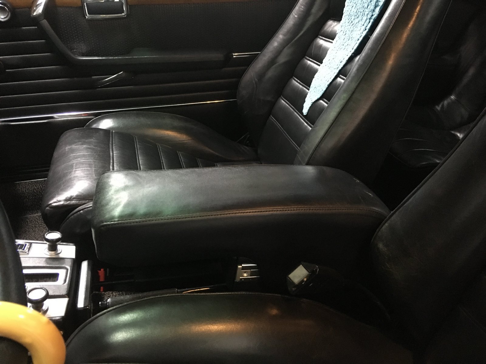

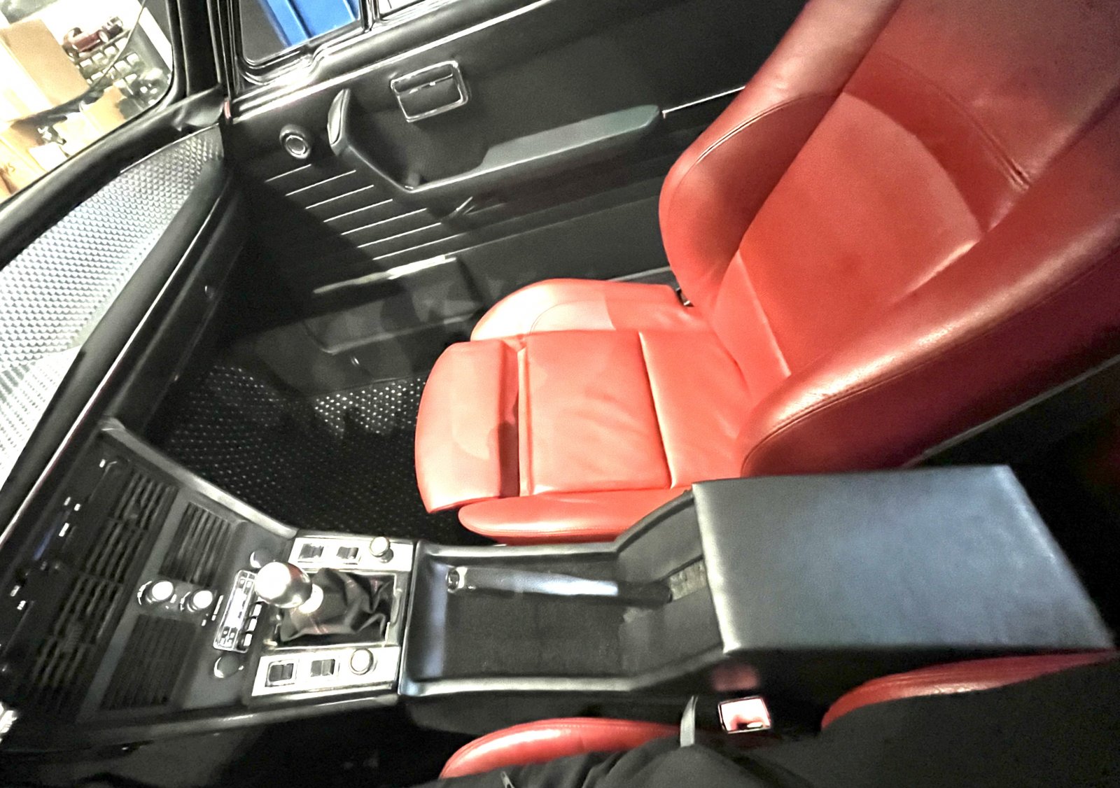

Console idea from member Bmachine, thanks B.
Adapted with some small,easy modifications from an e23 car. The parts were found on eBay.
RP
PS The “Restomod“ seats are from a e93 convertible with the belt in the seat/shoulder.
its a nice start ... there is a thing called a cup holder that needs to figure in to the conversation. Anton had a sliding metal one that might be something that gets incorporated.
i wonder if i need to remake the console sides and continue on for the arm rest ... or extend from the shifter platform. i do like the curve from your platform under the end of the handbrake. will have to sit in yours one day and check out the ergonomics - does my elbow fit on the armrest, is it high enough? should the armrest slide forward (like the one in my TTS).

Will the E3 Armrest fit to the E9? I think it is worth trying
Thanks @BMW Pete, @Ulrich 3.0 CSA in Germany could use width measurements & attachment photos if possible.
Appreciate the help.

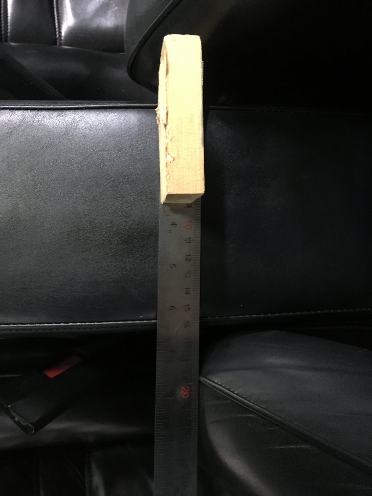

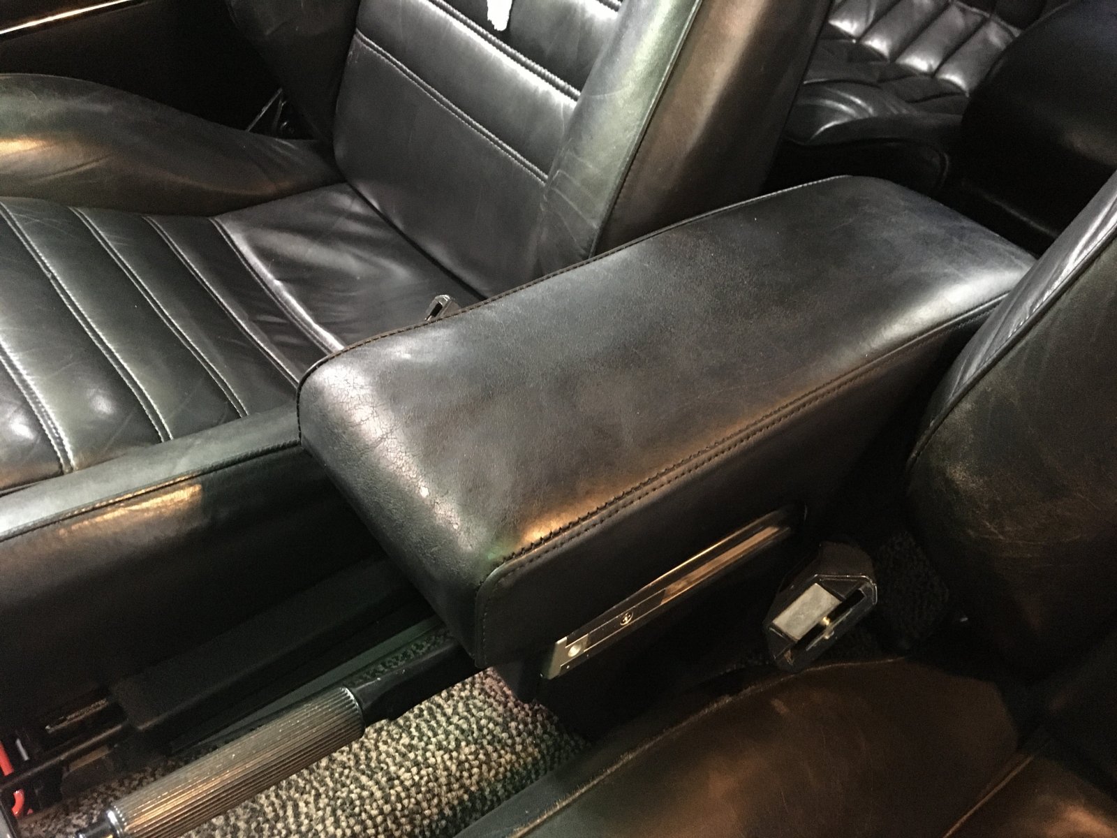

OK, so I put the E3 armrest in the E9. My car has Recaro seats and width between the seats is 18 cm. E3 Armrest is 15,5 cm width. I think it works and looks ok even if the middle armrest is pushed back. See fotos. Maybe a bit massive? Even the leather fits nearly. Main problem : it is too low about 6 cm and I have to think about the fixing problem which is a even bigger problem when I have to lift the armrest about 6 cm. And I have to drill holes in the E9 body 100%. Also I can´t use and see the back ashtray anymore (ok it is not allowed to use it also) :(
