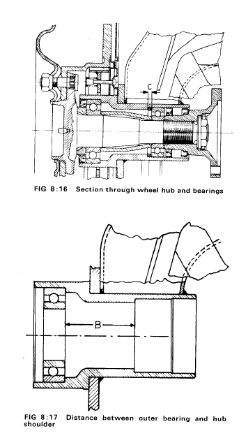

OK, well after discussion with Mesa Performance they have rear wheel bearing kits available, $70 per side. JJ at Mesa suggested the job is obnoxious but not overly difficult and could be done without removing the trailing arm, which it appears is how some of you have done it as well. So another thing added to my list...
Don tells me he has never seen rears that needed replacing. And apparently the job is a bear.. I think I may just re-pack mine.
How do you remove the backing plates without disassembling the hubs?
Yes, well, you were one step ahead of me. I guess you can't. When I was inspecting the area last week it looked like the setup could be removed like the front, in which you can pull the hub off with the rotor to access the plate, but then could decide not to actually rebuild the full hub. Upon further review, yes, looks like that isn't the case.
I'll inspect the hub/plate area a bit more tonight and read through some of the threads to decide how I want to go. What I have discovered thus far is that some jobs sounds very intimidating to me, like dropping the subframe a bit to add the sway bar, but then in practice are annoying and slightly back-breaking but are not overly technical. Hoping that this is the same...what I am reading in threads is that this is the PITA but fairly straightforward. We shall see - I'll post results here. Thanks to all before me who have posted very thorough pictures which I can follow.
And yeah, I saw Don's comment and he would be the guy that knows. I'll see if he calls me in the next week to tell me not to do it - that's how my brake calipers went from home rebuild to professional rebuild :)

As I understand it, the axles are held on with a massive nut that cannot easily be undone. Then you have to press the old bearings out and press new ones in without ruining them.
In anticipation of doing this (and the fronts), I actually bought an arbor press (the relatively inexpensive one-time-use kind from Harbor Fright...) And I may still go there... with Don's avatar laughing in my ear while prodding me with a little pitchfork..

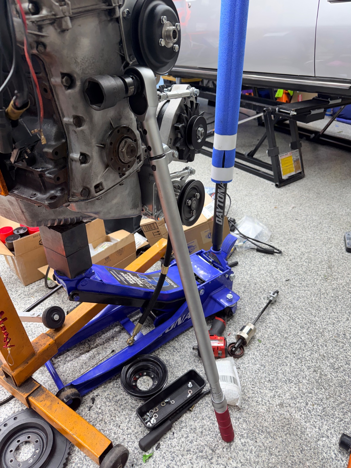

Well, it wasn’t Don but another one of my car buddies who was over last night and told me “yeah, don’t do that”. As he noted, the bearings in the rear weren’t making noise and if I do need to do the job at some point it’s as easy/hard then as it is now. So I pulled the handbrake shoes off, will wire wheel the protection plate (in place) and then rustproof/paint it with some POR15 but forgo the full bearing removal. So sorry that those of you who wanted to watch the struggle will have to go away disappointed - nothing to see here!

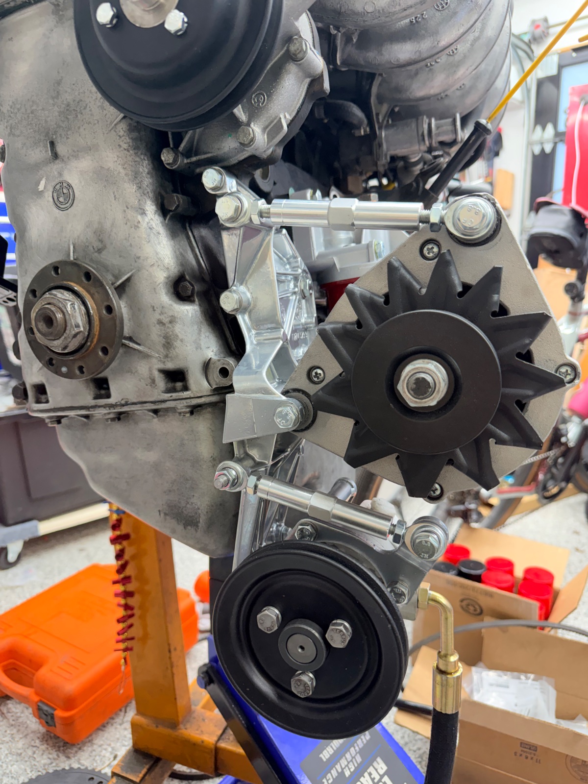

I did put on harmonic balanced and front double pulley sourced from Don so that I can do the newer-style belt routing with my new alternator, water pump and power steering pump. Also will hopefully allow for AC belt add if I go that route in the future. Tightened that thing with a 400-lbs torque wrench borrowed from Autozone and a jack supporting the engine underneath. And even though I know these aren’t OEM, I am loving the adjuster arm-belt tensioner from Ireland engineering. Very easily to install and exceedingly easy to adjust for tensioning and loosening; far easier than the castellated nut moving along its cogwheel path.

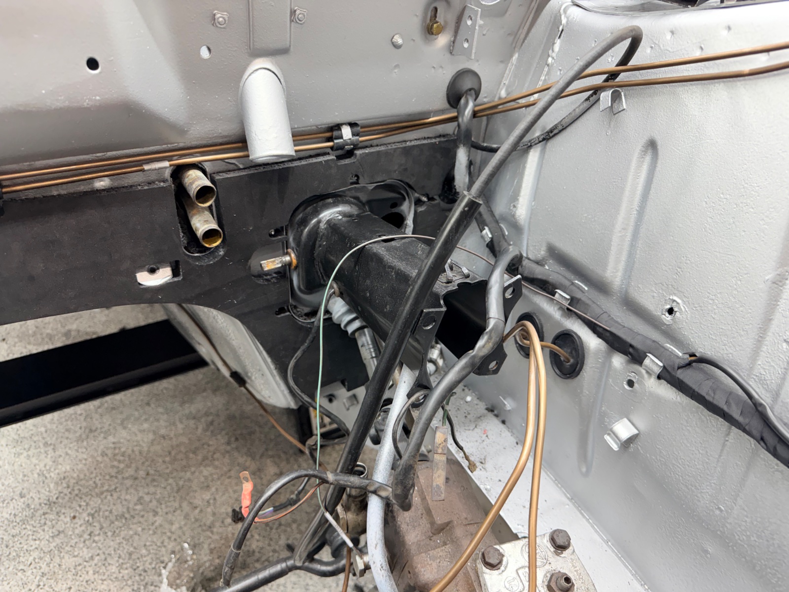

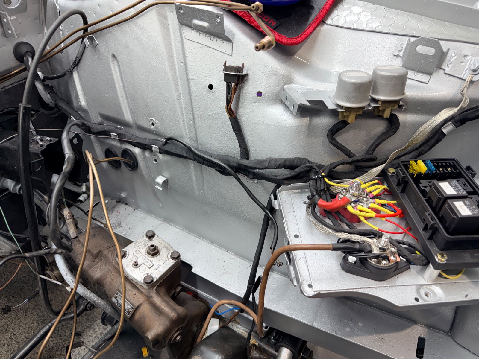

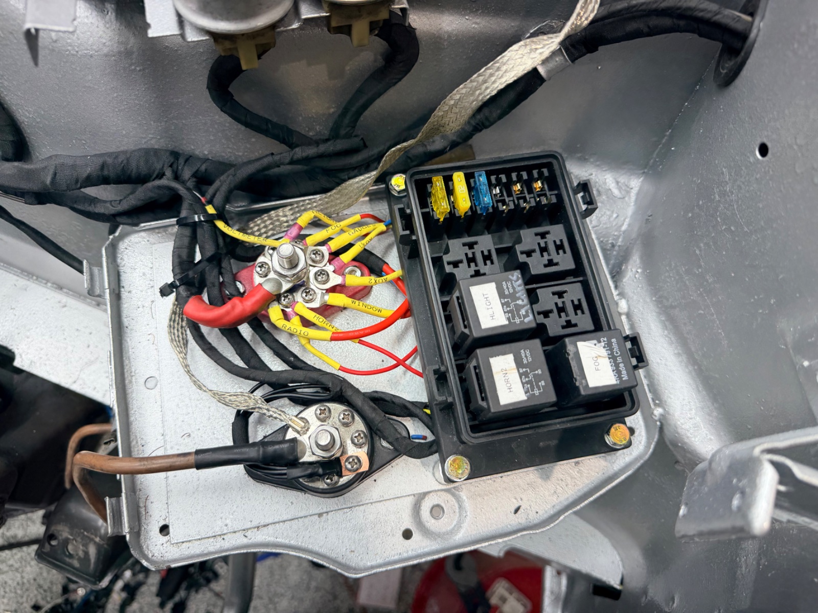

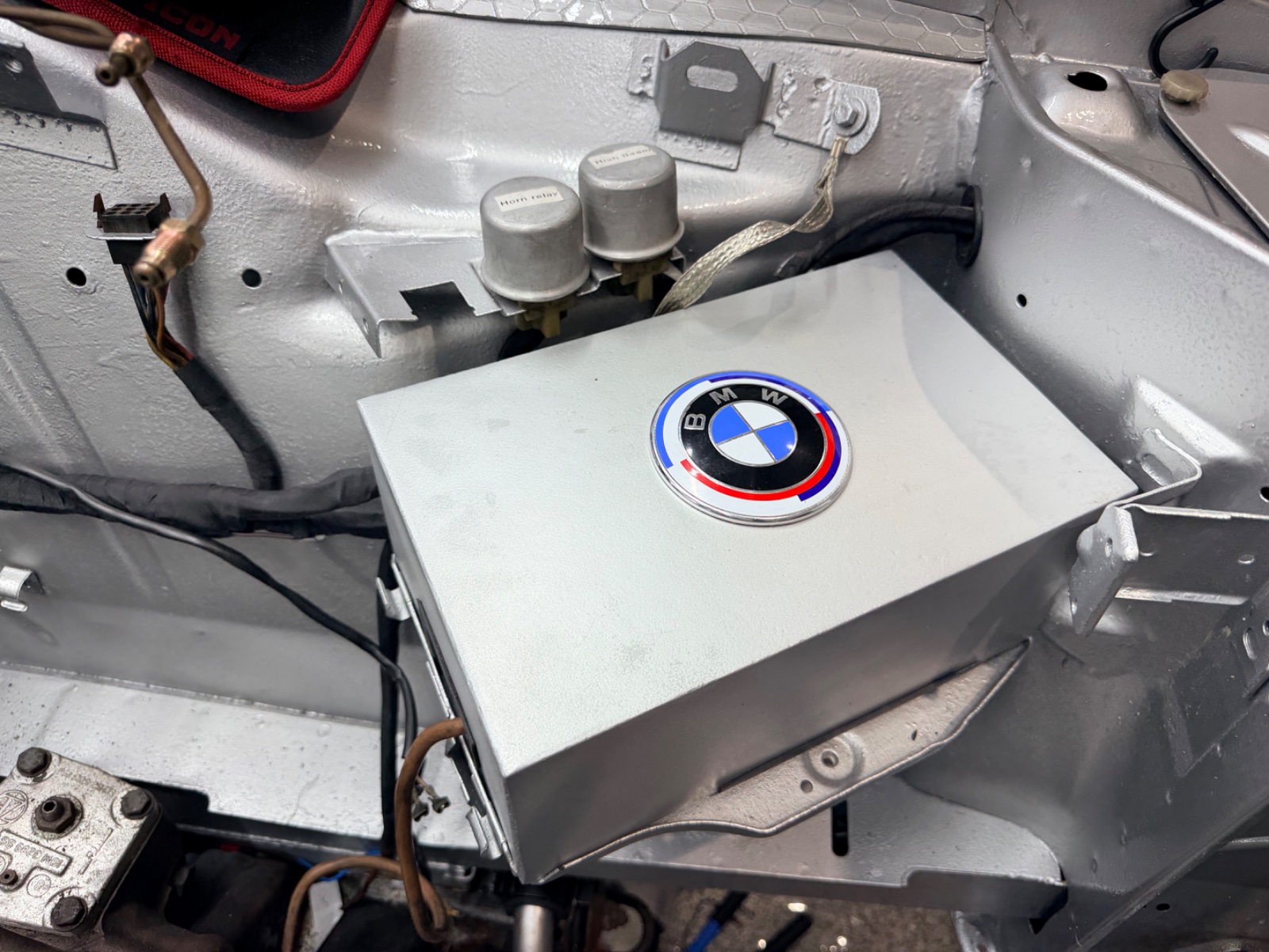

Spent a fair amount of the weekend doing some rewiring. I undid all of the tape in the main loom heading from the under dash area into the firewall and retaped, adding 4 new wiring circuits hooked up to my supplemental fusebox. As per a previous thread, some of these are for future proofing. One is for powering the oil pressure/voltmeter/water temp gauges I plan to add to the console, the others are for anything else I might need in the future. I’ll probably terminate one under the rear seat area (seat heater?) and the other under the center console.
I had previously moved the battery to the trunk and used the battery tray to mount my distribution block. I know that this will probably be heresy to some, but I just didn’t like the look of all of these additional wires on the bsttery and the trunk is large enough to hold a medium Optimum battery easily with a 100-Amp breaker in one of its terminals. The distribution block is covered with a metal box that I fabricated just so it looks clean. I used the new labeler that @ScottAndrews had mentioned in a previous thread, very slick and labeling the shrink wrap was a nice touch in my mind.

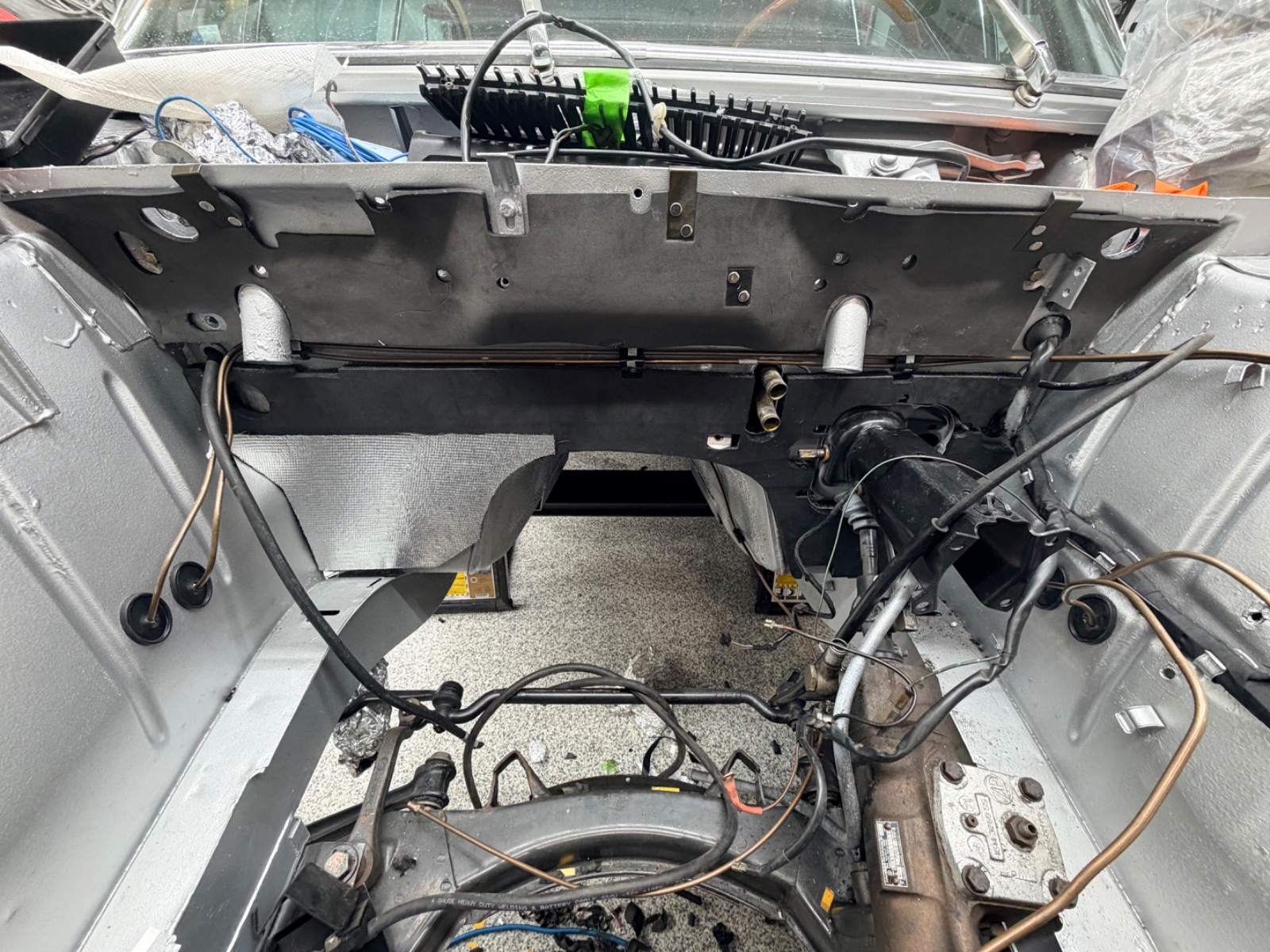

I also installed the last of the firewall insulation. Slowly heading towards engine re-insertion.
Nice! Whilst you're in there - have you considered upgrading your fuse box to the blade fuses with the mod some folks on the forum have provided to us?
