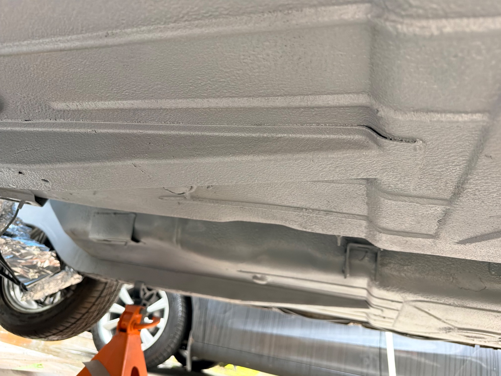

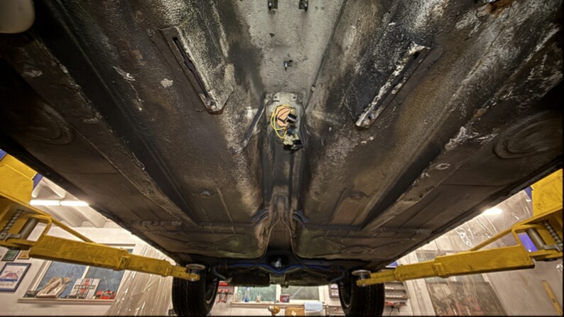

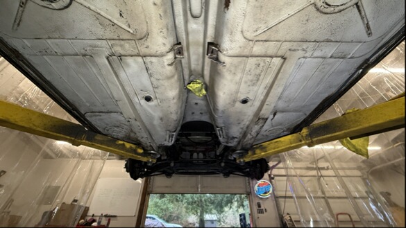

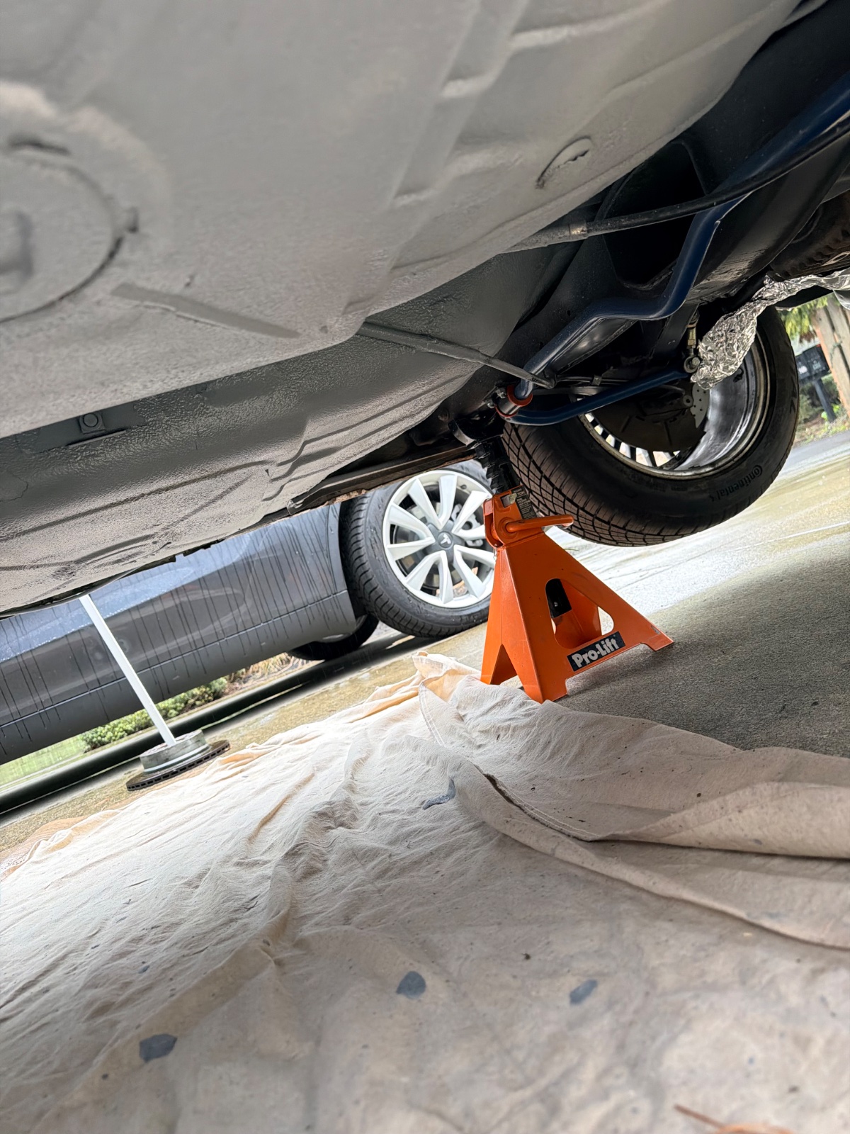

Painted the underside. Used Seymour dark gray (which is surprisingly a silver color rather than dark gray) on the transmission tunnel and then Wurth Porsche Stoneguard Gray on the bottom of the floor panels. I know that the original color is more of a khaki but that was hard to find in a stone guard and this color is actually fairly close to my Polaris Silver so I’ll say that I’m breaking with the bible here. Quite a change from how I got the car - pics from original to post-dry-ice-blasting to post- painting
Wow! Really nice work!

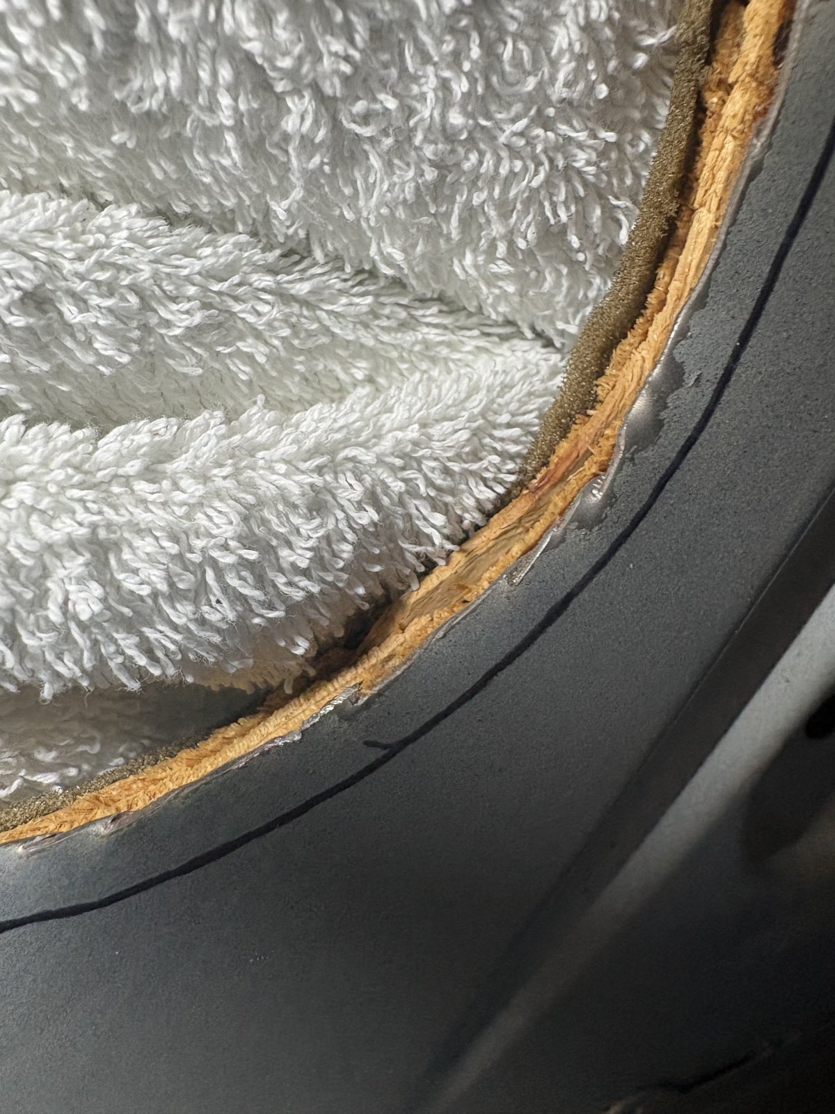

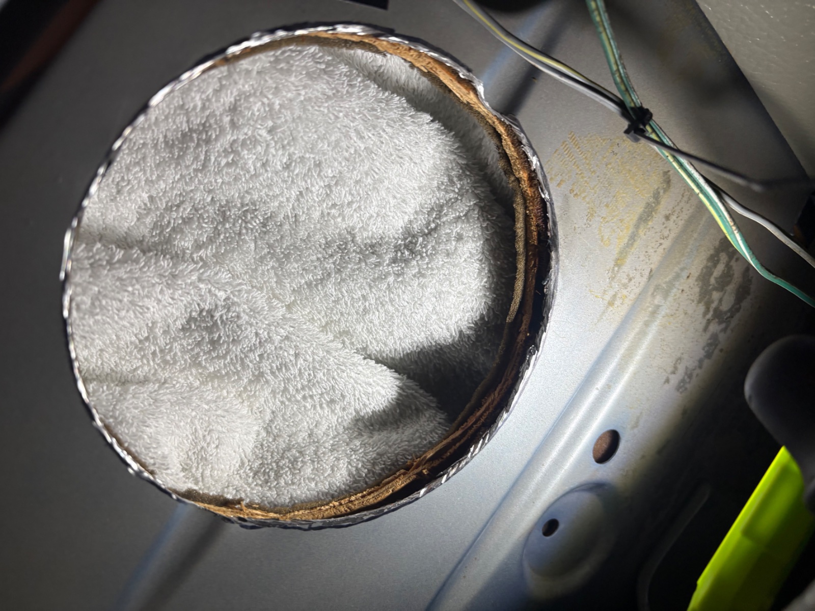

I am replacing the derelict speakers on my package shelf and discovered a horrible job previously done in creating the hole. Plus the new speakers are a bit broader at the base, so hole needed enlarging anyway. After grinding the edges smooth I will apply primer and some touch-up fjord paint to keep corrosion at bay.

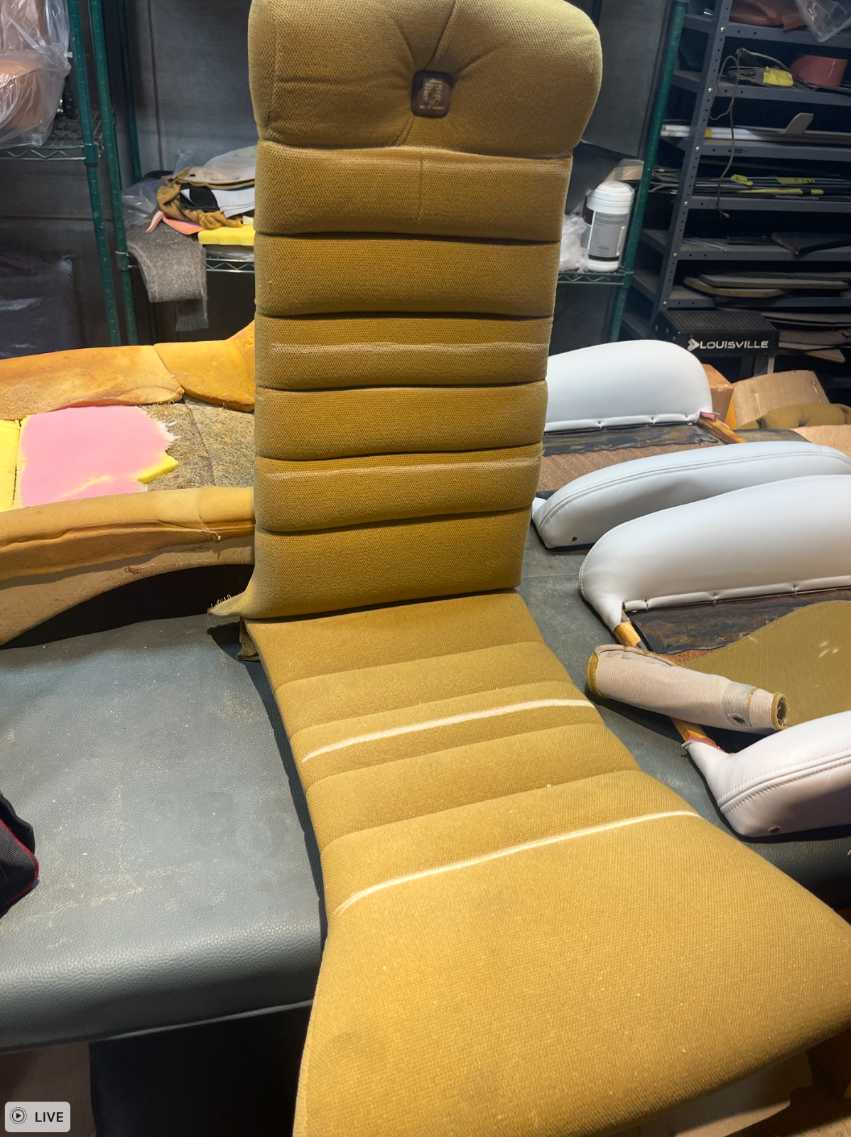

Currently having a great time communicating with Erik at Coupe King as they restore my Scheel seats. We have worked out how to slightly update them, and also to get them to play nice with the rear seats. Loving watching the progress. They are a real pleasure to work with.

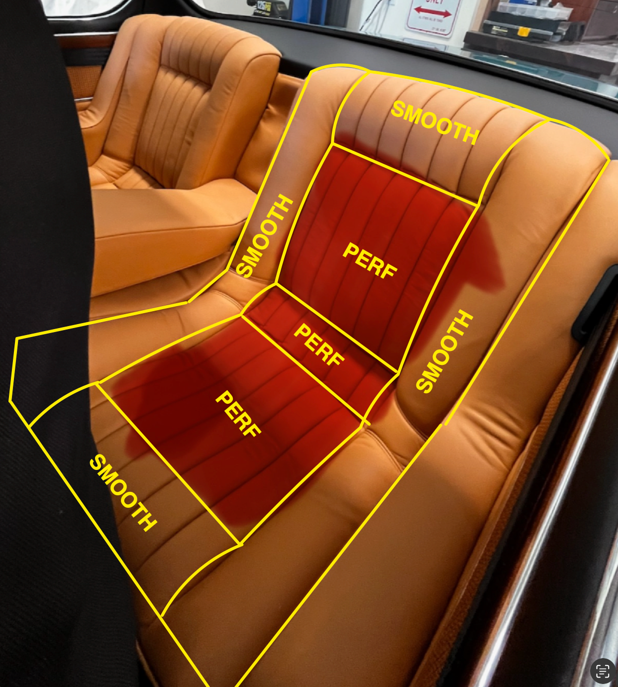

Used a photo of @Ives car as a base for designing the revision of the rear seats so they are esthetically related to the new front seats. Using grey/white leather. the center sections will be perforated using a Porsche perforation pattern.
Then reconfiguring the Schools to be slightly more updated, with fewer lateral pleats (see chalk marks), and the same perforated centers. You can see the re-covered bottom bolsters in the pic below. Top and front will be solid like the bolsters.
i tend to think that the pattern used on the rear CSL seats makes a lot of sense for the inset of perforated leather.
