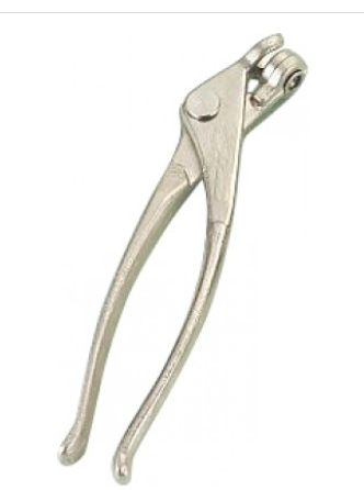

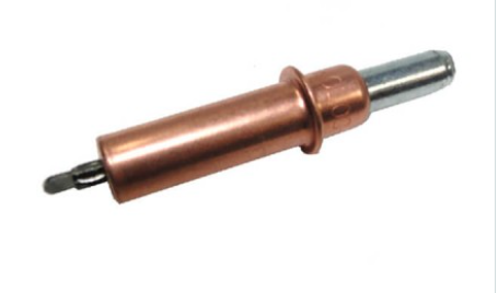

1/8 inch Clecos will also work and hold the hinges and hood together

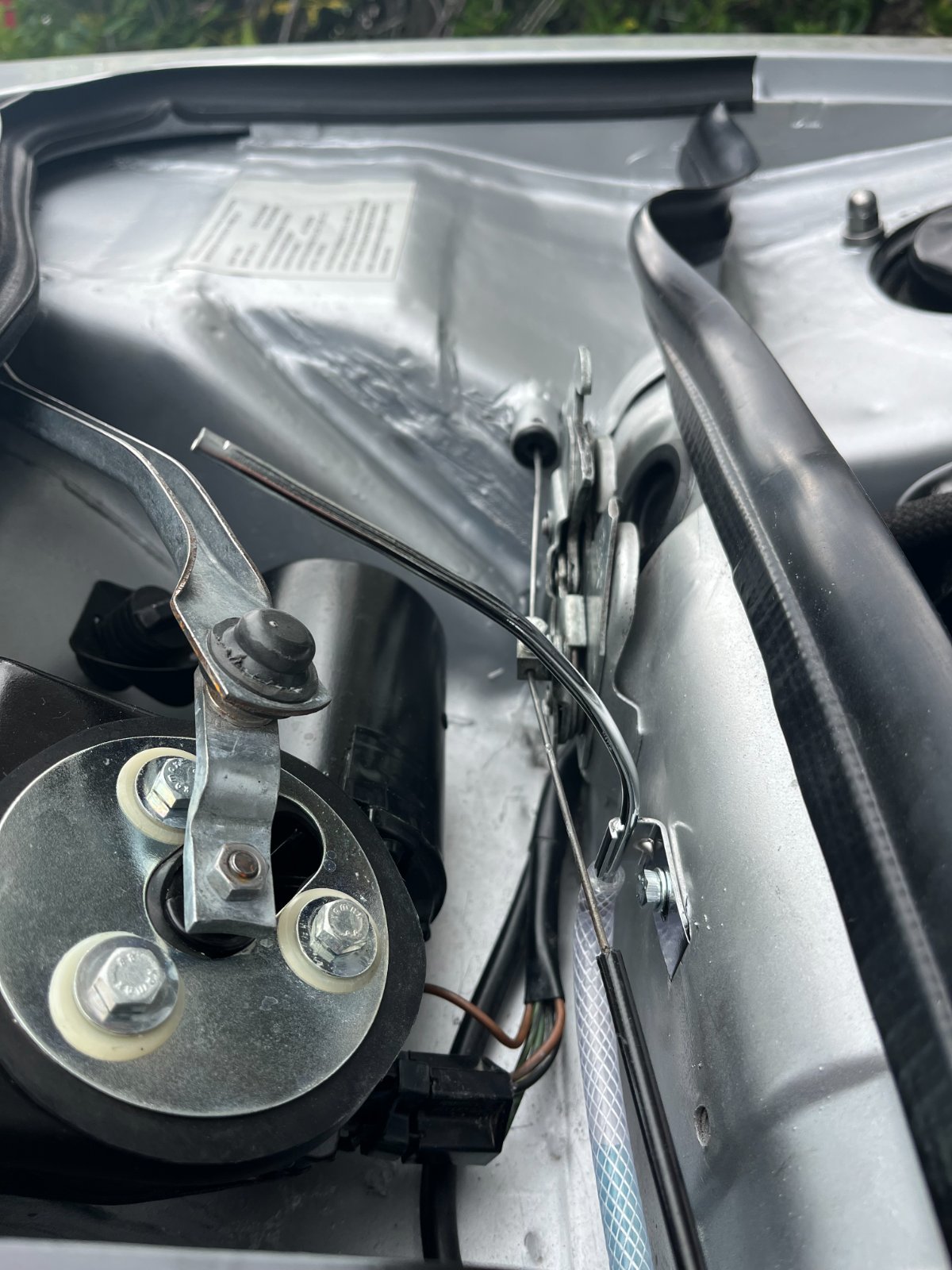

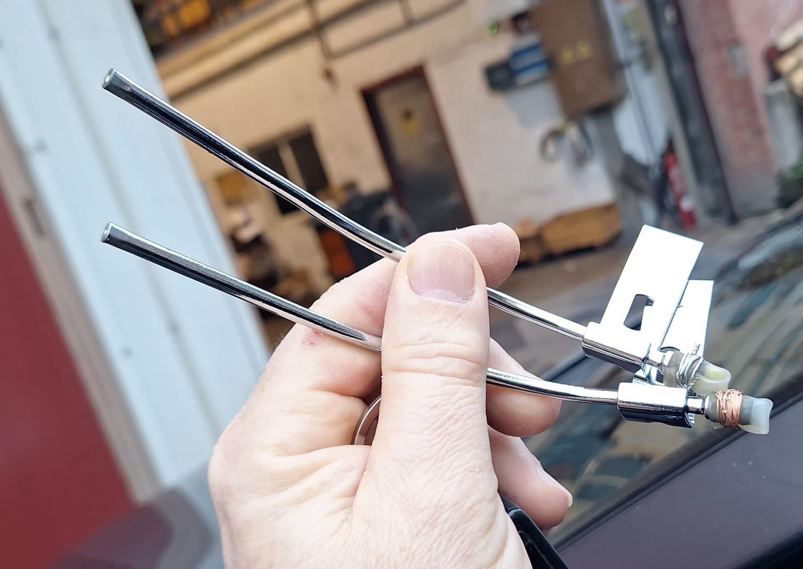

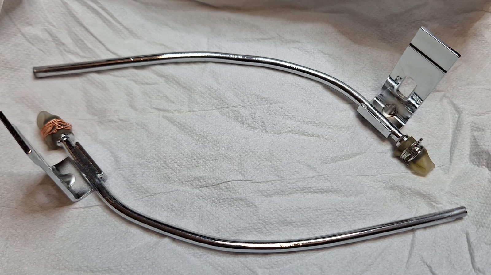

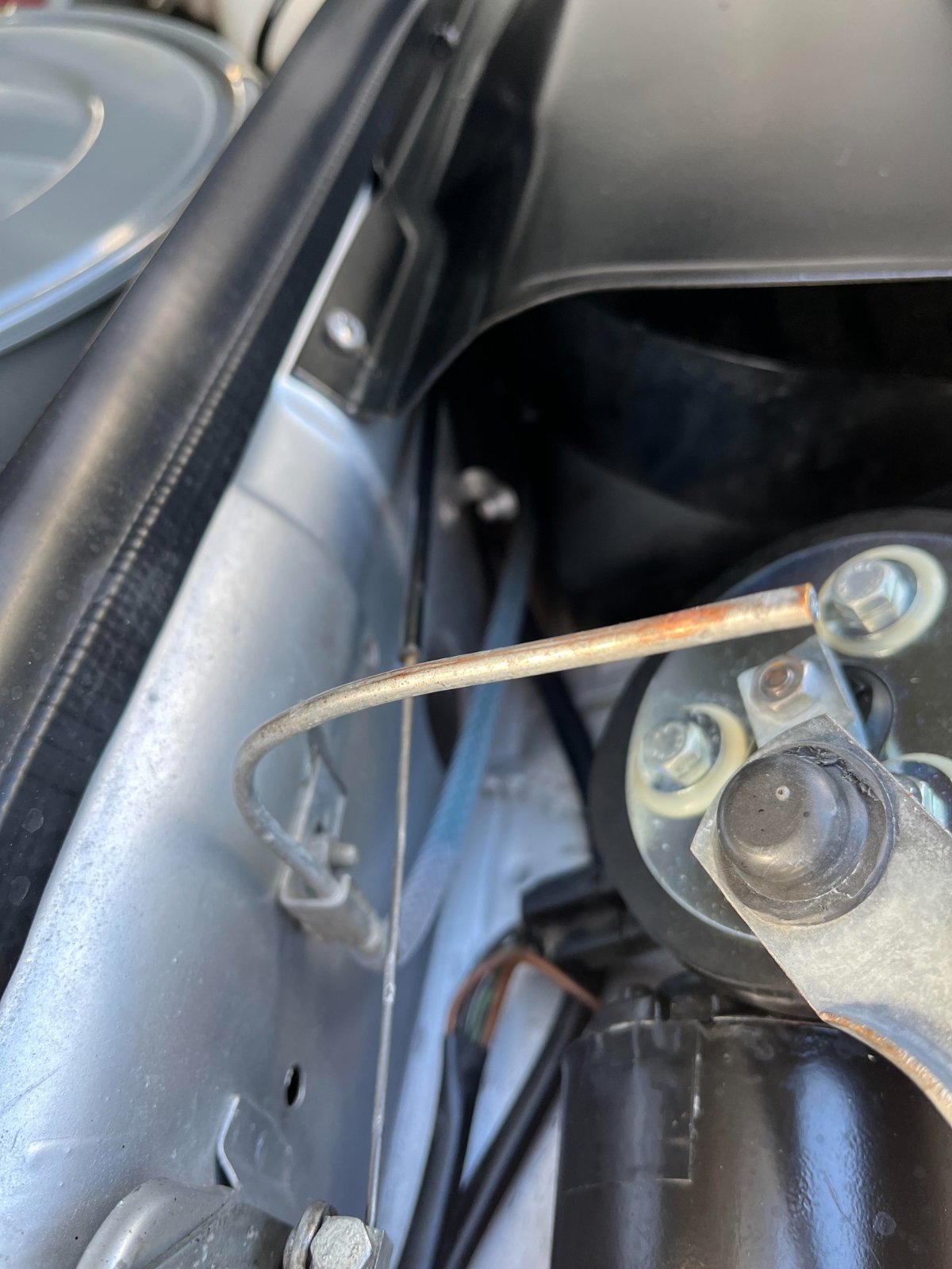

Installed chromed washer nozzels. Big thanks @deQuincey for chroming them for me. This was one of the things in the engine bay that bothered me. Big improvment you can see before and after pictures

View attachment 2157871/8 inch Clecos will also work and hold the hinges and hood together View attachment 215788
I like that idea, I've picked up a bunch of Clecos at estate sales but haven't needed them yet.
Is there clearance for them against the upper part of the hinge/hood?
Ah, I see that they make a smaller version, the PMIN series if clearance is a problem.

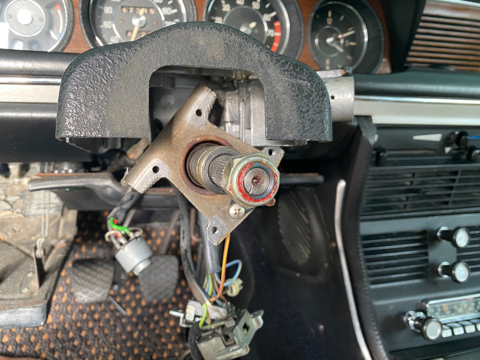

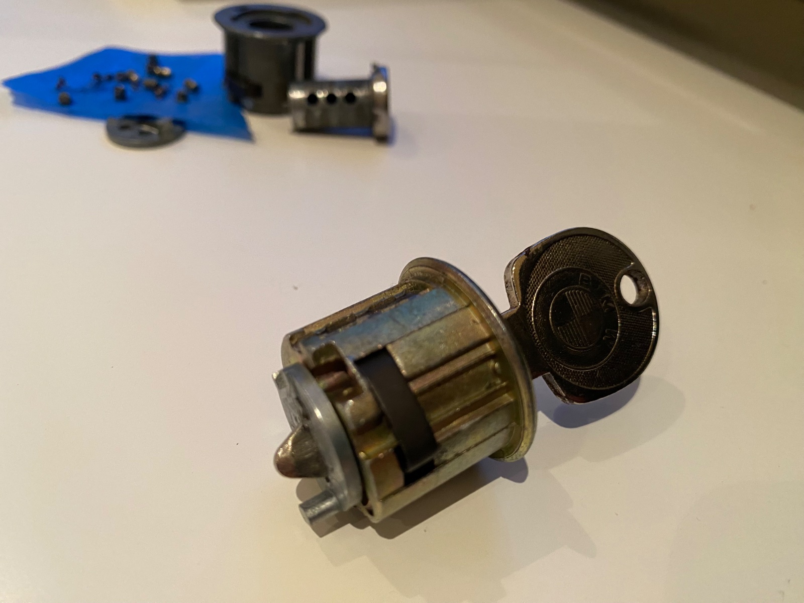

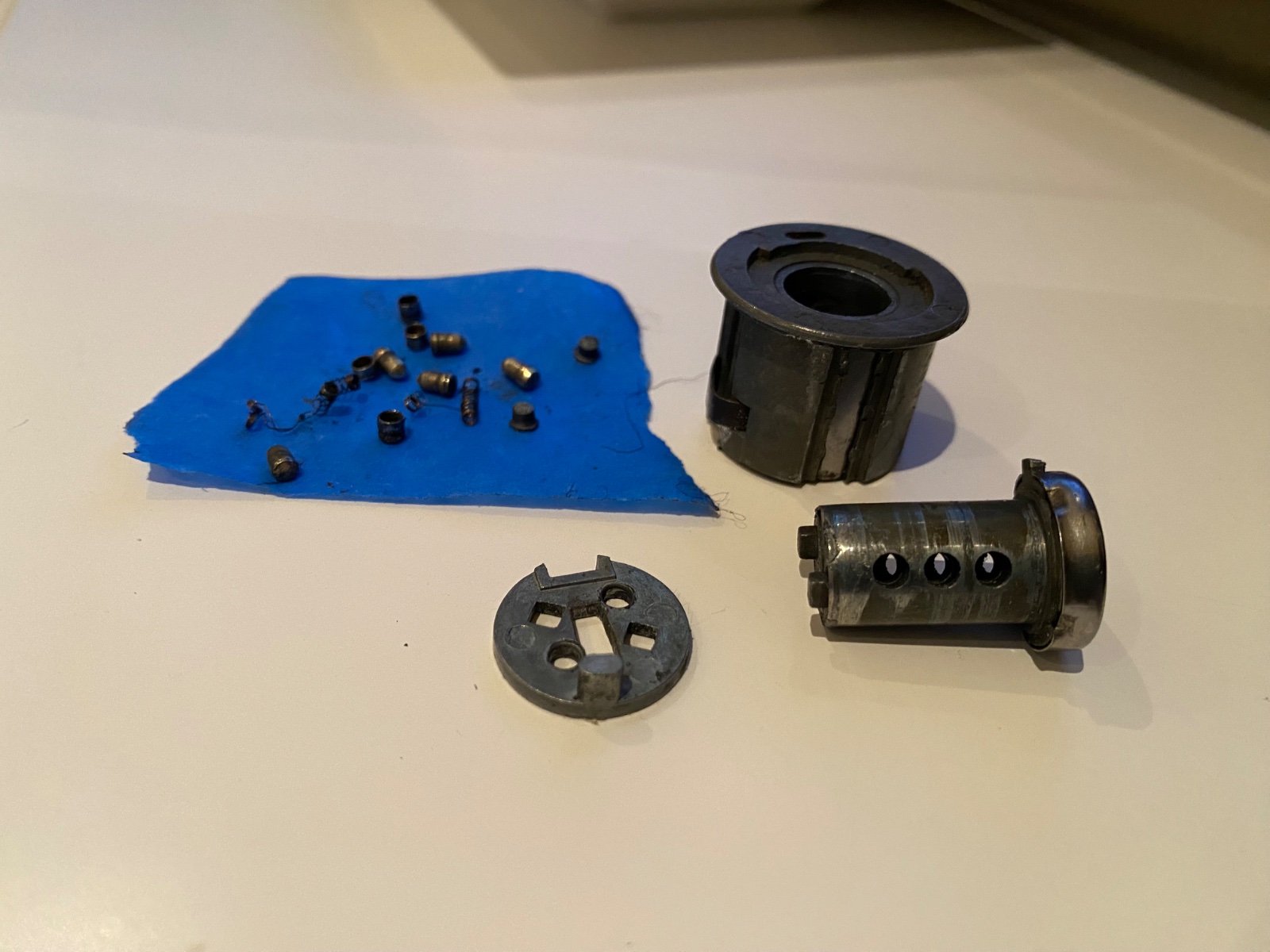

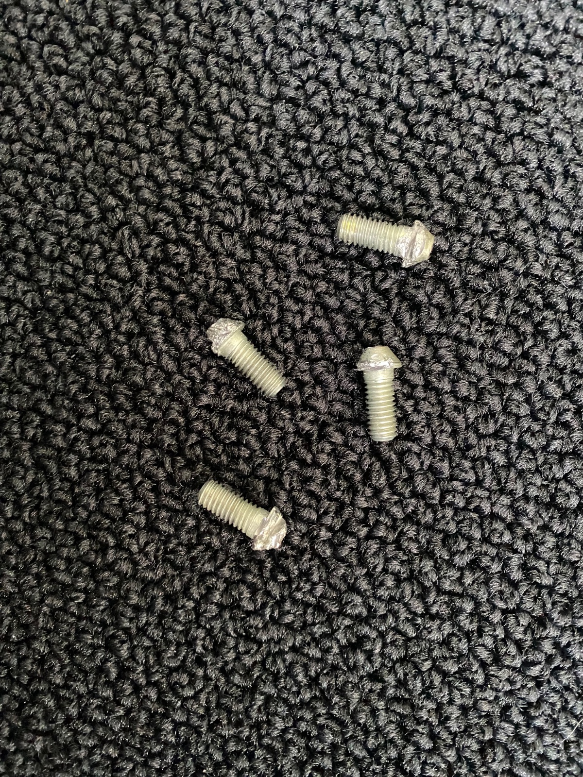

My ignition key cylinder broke apart the other week.There are lots of good threads on the forum about how to remove it but I can confirm it is VERY hard to remove the 4 shear bolts that secure the steering column shaft which needs to be lowered in order to extract the steering lock middle cylinder. It took me 2 frustrating days using a dremel and than whacking them extremely hard with a hammer and screwdriver to break them loose enough to remove with a small long nose vise grip locking plier.
Bought a new key cylinder which by chance just become available again at W&N. I am sending it off to Blaine at Santa Monica Lock as recommended by others to be repinned to my original key,
Bought a new key cylinder which by chance just become available again at W&N. I am sending it off to Blaine at Santa Monica Lock as recommended by others to be repinned to my original key,View attachment 216026View attachment 216027View attachment 216028View attachment 216029
I went through removing the whole ignition key shaft thing a couple of years ago. What a PITA! It's one of the jobs you almost have to figure out yourself, otherwise, you are going to pay someone a small fortune in shop hours learning how to do it themselves.
My shaft was fine but the microscopis size of the grub screw which holds the shaft in place meant I had to use a rare earth magnet to track it down when I failed to catch it.

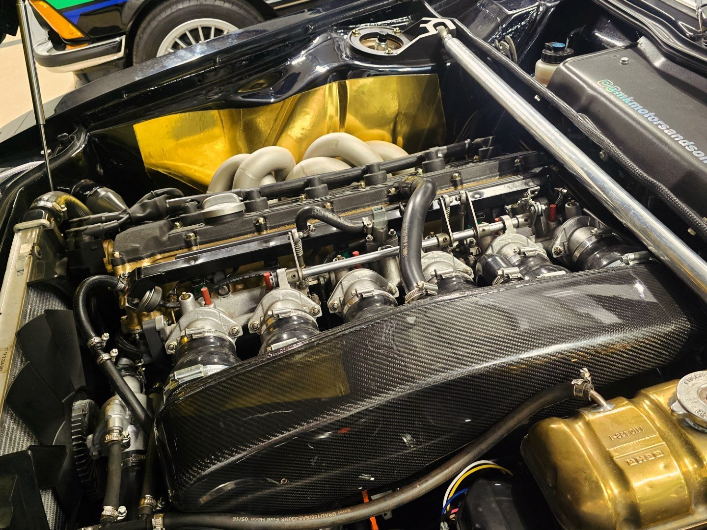

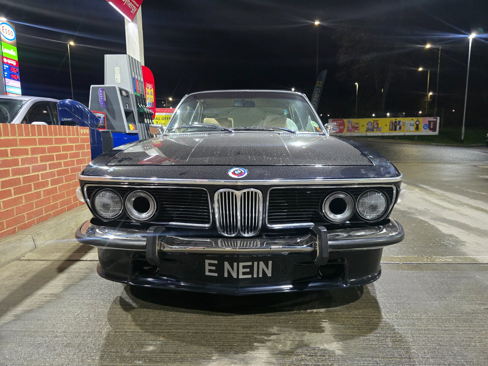

Replaced the leaking remote brake reservoir grommets on the top of the master, bled the brakes and took her out for the first time since getting the new ecu and airbox fitted.
Camera doesn't pick up the guttural induction noise, sounds divine.
