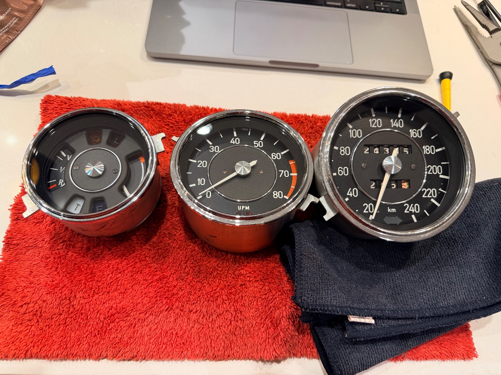

Took out all of the gauges and removed bezels, polished glass and reassembled in preparation for adding some LED lightbulbs. A bit of a job but there is a nice write up on the forum and the end result is well worth it. I think getting all four of the gauges out without dash removal was the most challenging part

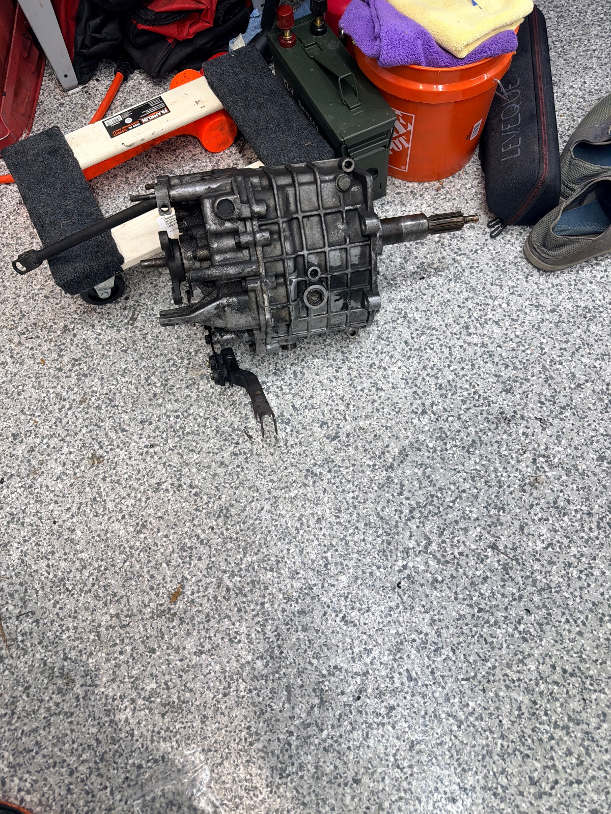

Took out my ancient starter and replaced it with a new one. Along the way removed a bunch of hoses, which will be changed as well. Boy, taking out that starter is a job I don’t envy anyone having to do. That thing is way down in there and those bolts are quite difficult to remove. The new starter is thankfully a little bit more svelte so if anyone ever needs to go here again, it should be an easier job.
Bought another to keep myself busy.

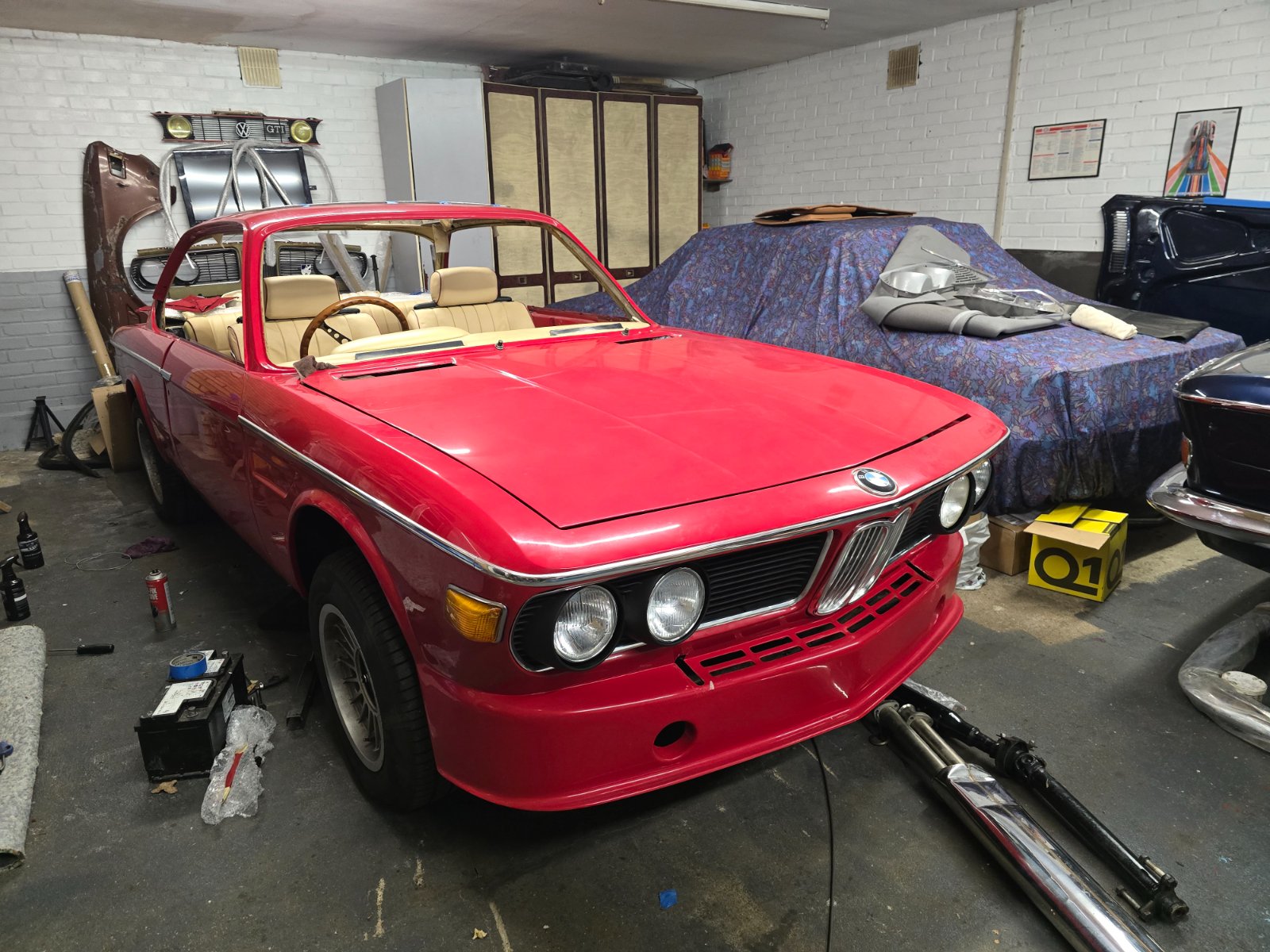

Lots of fresh parts to go back on, but some cool bits. Csl panels, dogleg, bilsteins and all the hard stuff has been done. Keeping this quite simple with a B35 swap. Now to build up in between customer jobs.
Nice color. Do the fresh parts to go back on include a Webasto folding sunroof? Or is what appears to be an open top just an illusion?
Yep, webasto really isn't my first choice but didn't really have much of a say in the matter. At least fitting of it was done correctly at the time. Too much hassle to weld the skin back on etc

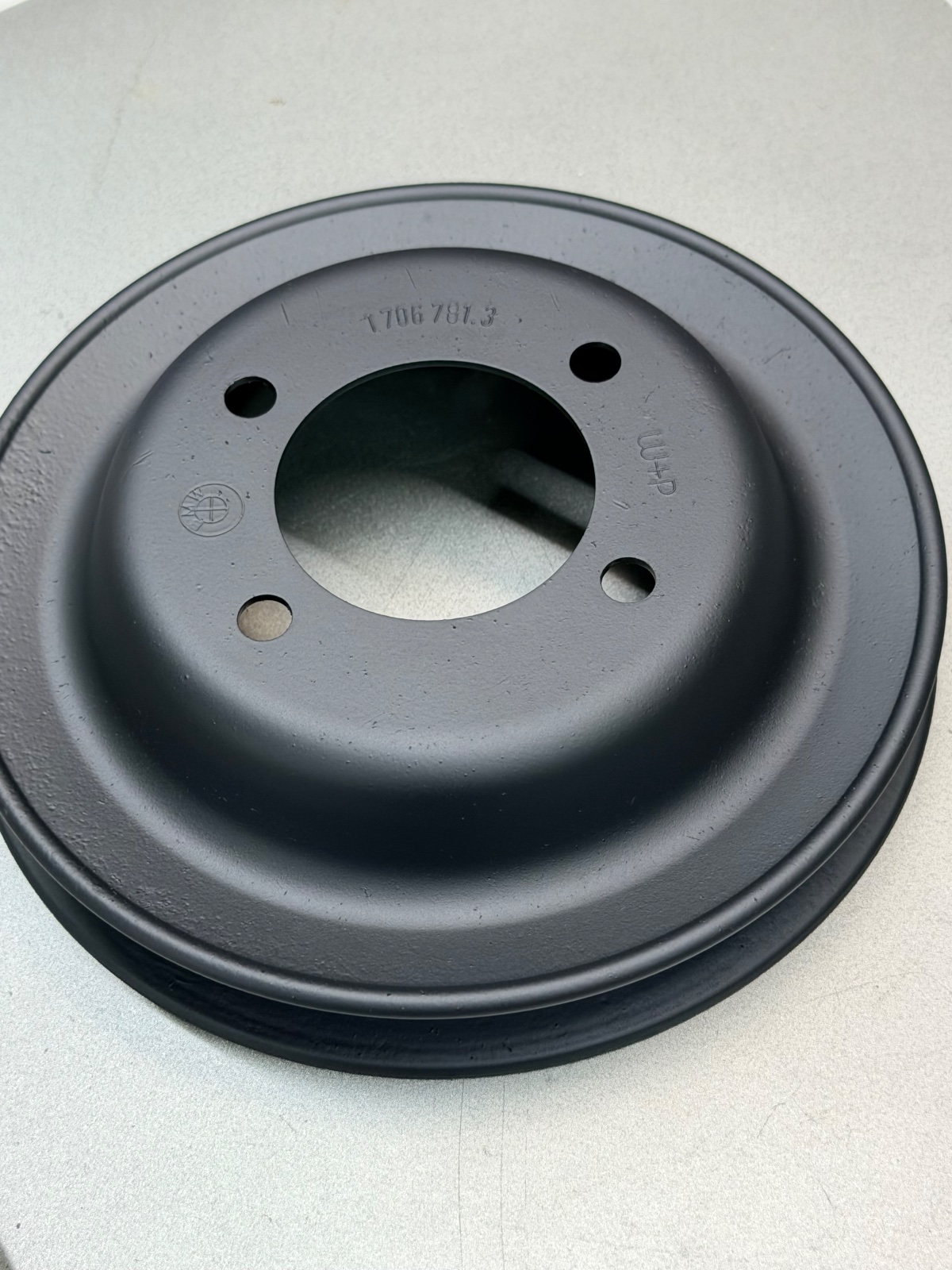

Also took a foray into media blasting and powder coating. Not bad for $200 of supplies and my first attempt, I’d say
