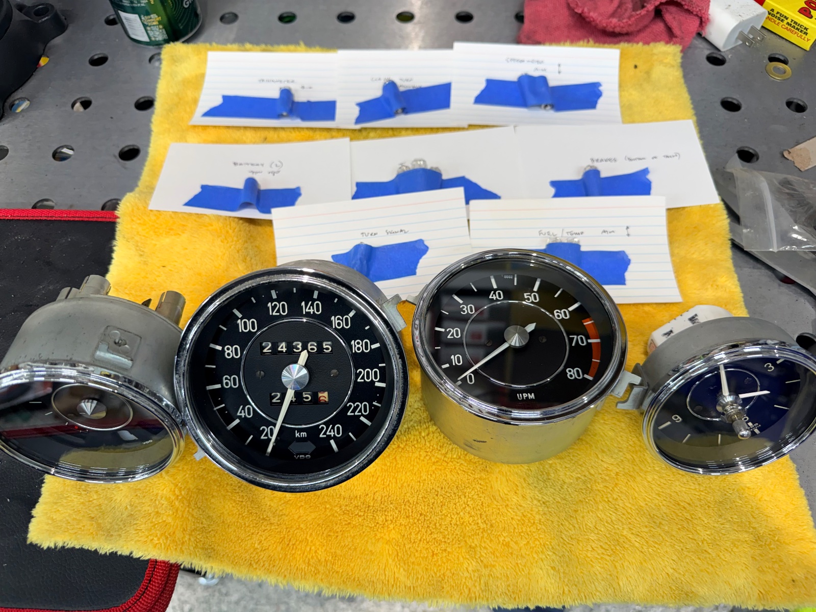

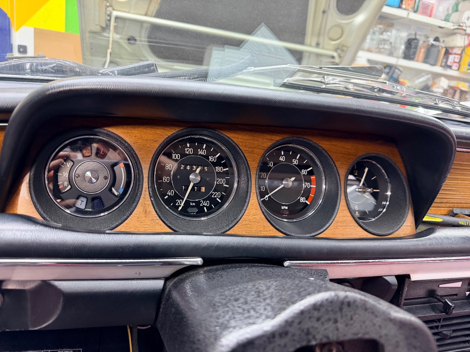

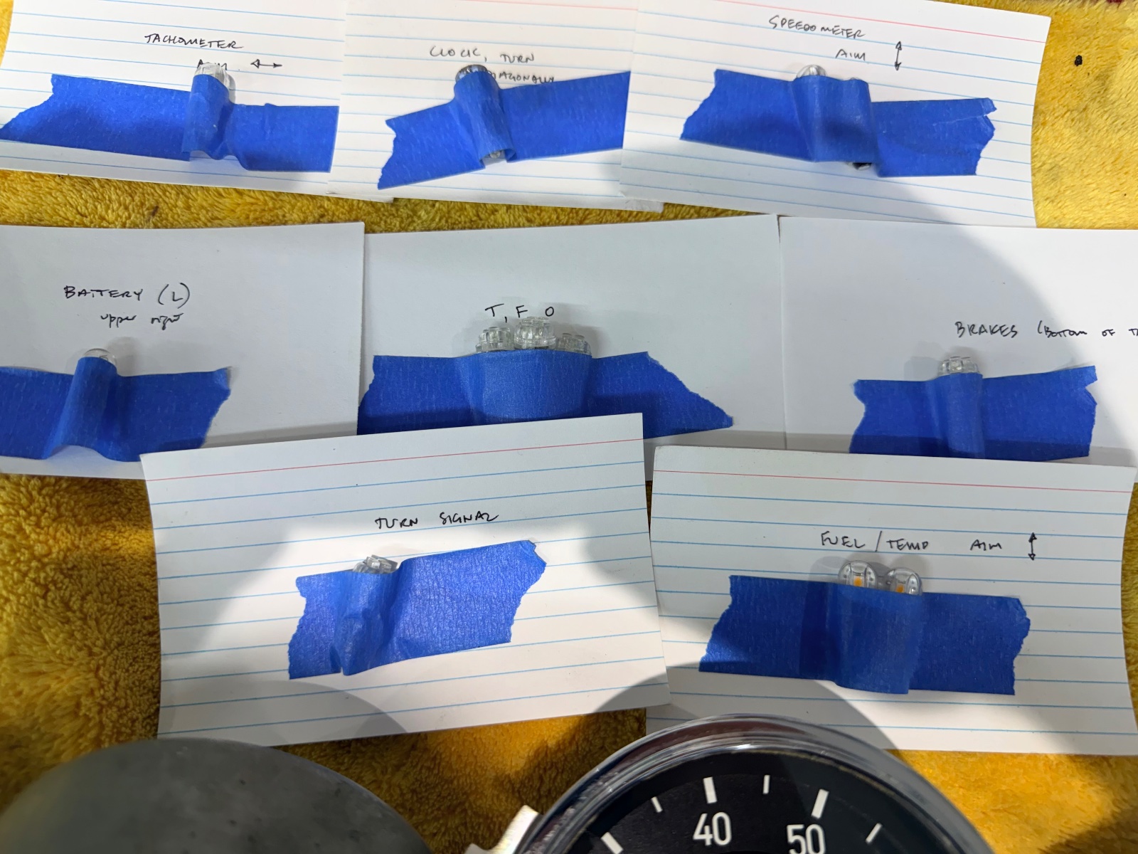

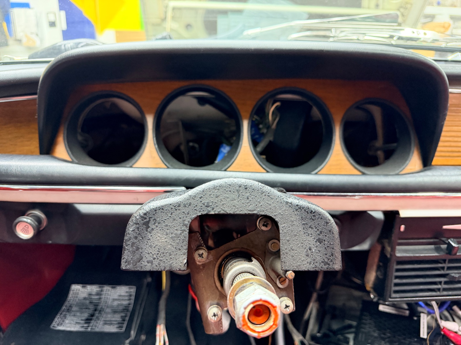

Put all of the instrument cluster back in after having cleaned all of the glass internally a few weeks ago. I installed LED lights per the really nice write up @coupesport did over the last few weeks (see https://e9coupe.com/forum/threads/a...tion-now-with-photos.49230/page-2#post-434095 . Hopefully looks good when I power it all up - right now battery isn’t fully installed. Took a while, and one tip is to replace the odometer reset cable BEFORE putting the speedometer back in - it’s near impossible to do once it is in.

+1 to the Reset Cable!
Yes, the car had been delivered to me with this cable disconnected, so good to have it back in commission. That reassembly just took longer than expected. Another tip - masking tape over the front glass of each dial so that you can flip them back and forth around the various obstacles back there without worrying about causing scratches

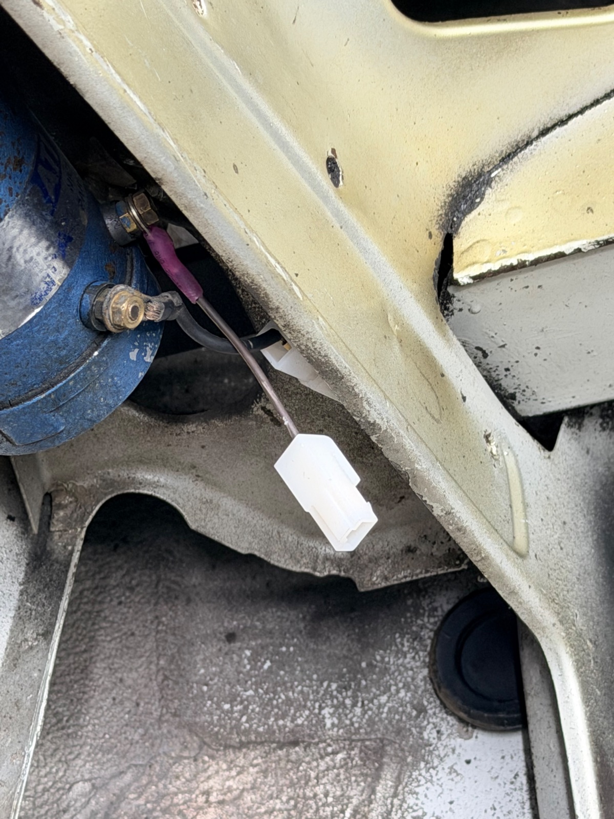

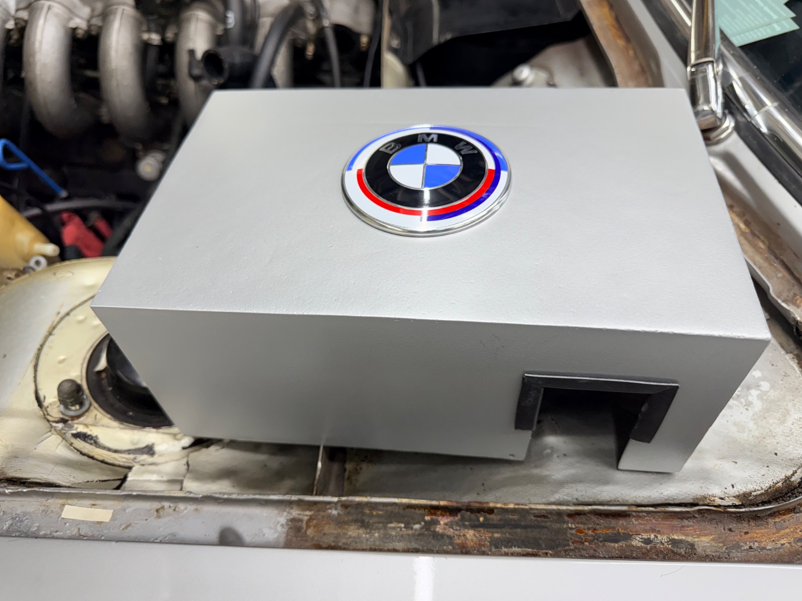

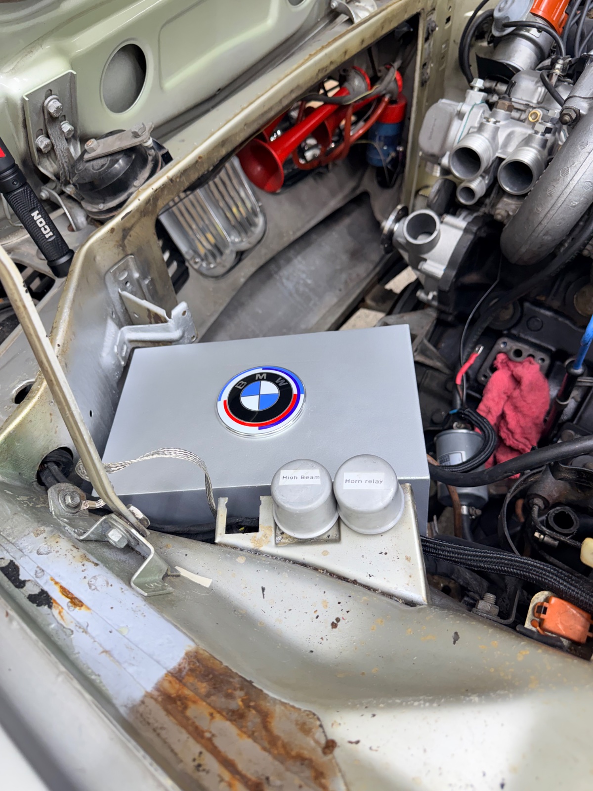

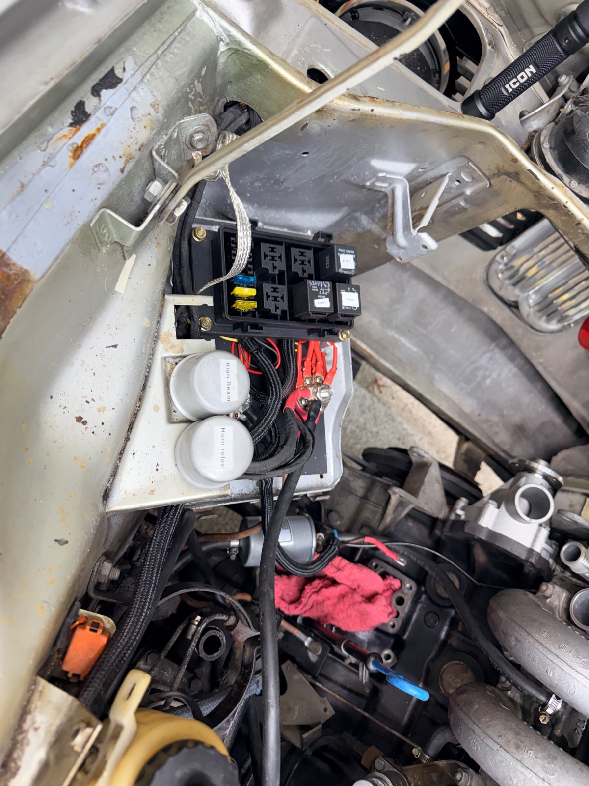

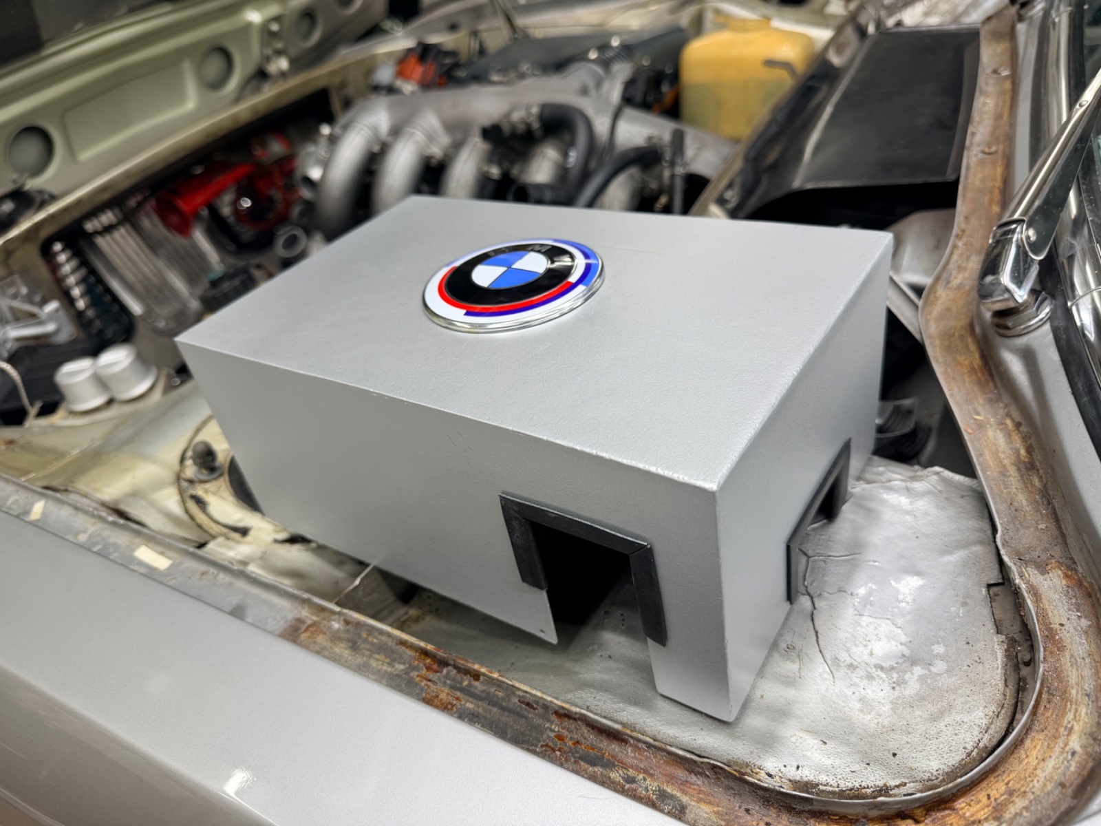

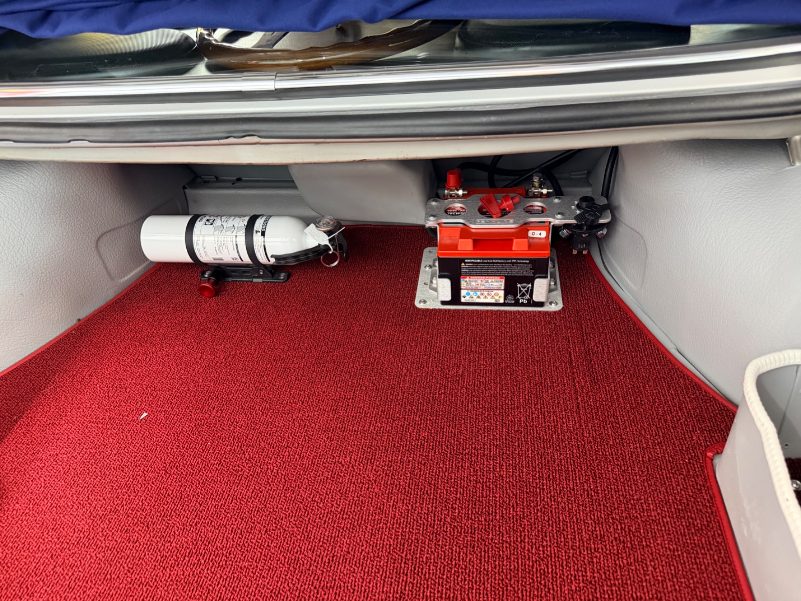

I guess this is more than just one day, but completed the move of battery to trunk. After adding relays for fog lights, primary headlights, the second set of horns that previous owner had installed and I decided to keep, along with running a power cable for amp and stereo, the battery area was looking too much like Medusa in the original Clash of the Titans. So I moved the battery to the trunk using some useful info other members had posted here. In an effort to keep that battery area looking clean, however, I used my rudimentary welding skills to weld a small box to cover it up. Someone at one point suggested (@Mike Goble perhaps) using an empty battery box to hold all of this stuff. I didn’t have access to an original white battery so decided to mimic that. Welded this, powder coated it, and decided to add an emblem on top just for a little pizzazz. I’m pleased with how it looks and it makes accessing the oil filter a bit easier. Please ignore the state of the engine and bay - it’s in preparation for removal prior to repainting and refurbishing.

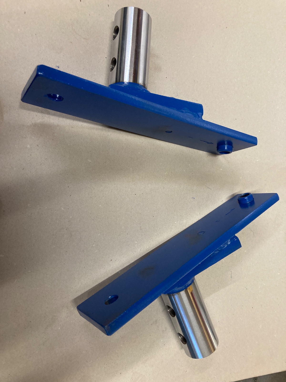

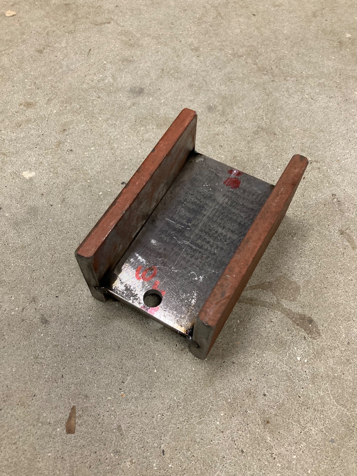

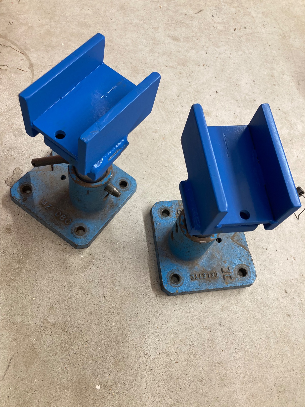

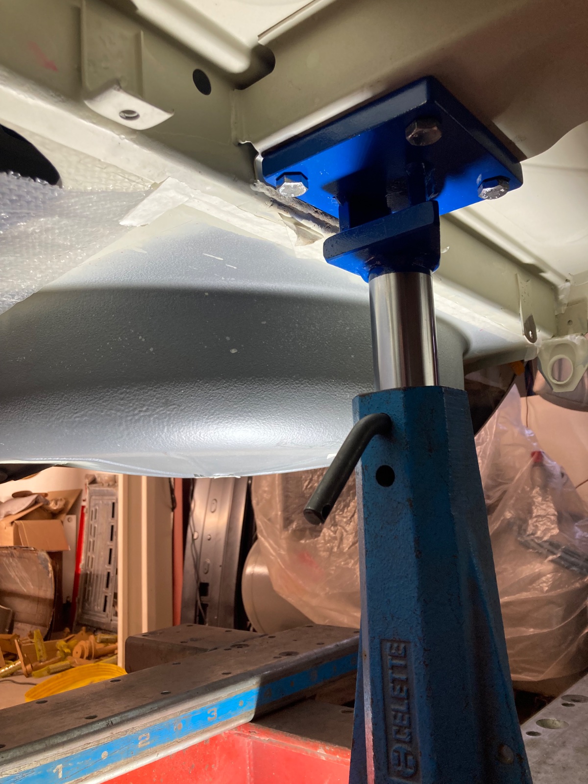

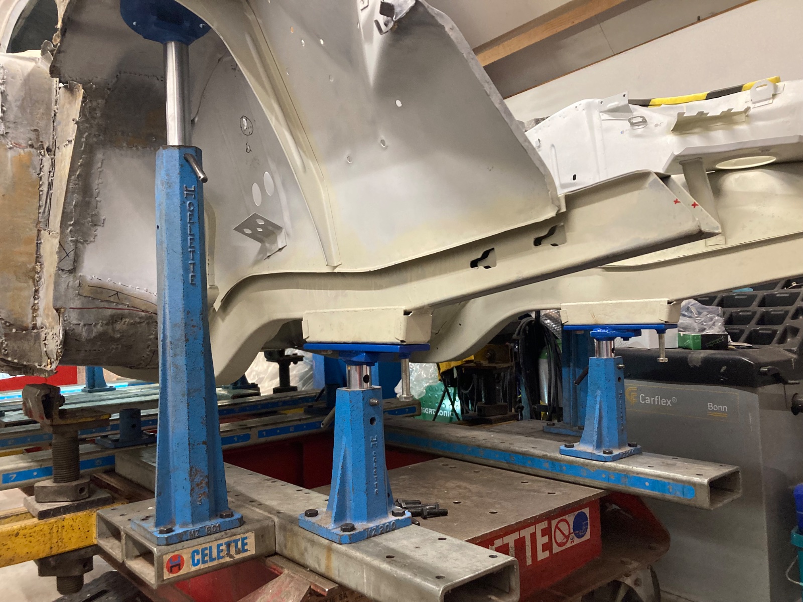

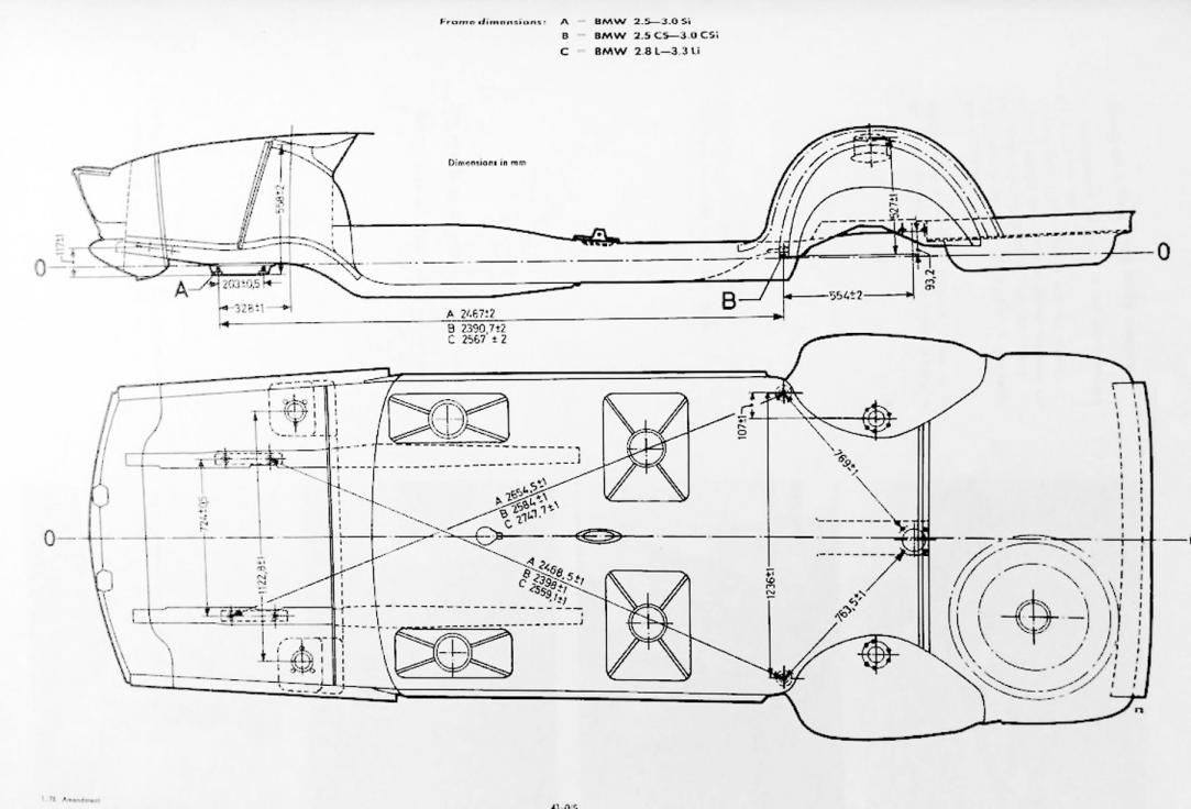

Building my own Celette bench that supports and anchors my BMW e9 on factory measurements and secure undamaged sections to stay in place during the restoration. Took a lot of time to build and measure !! (Not only this day).
The blue painted adopters I made by myself. The towers are the Celette MZ 22 towers on top of a Celette type 7 bench.
Surprising to see how some parts match.
Today some extra floor beam supports.

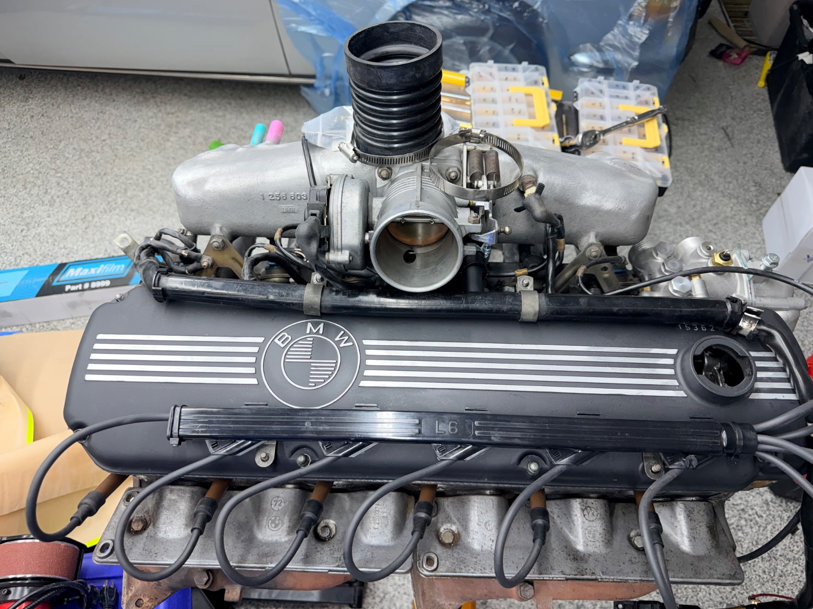

Pulled the engine in prep for repainting/refresh. Thanks to those of you who helped out by answering questions in my “thoughts on engine removal” thread. Your advice came in handy

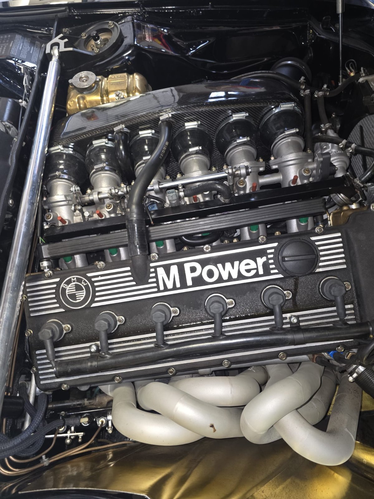

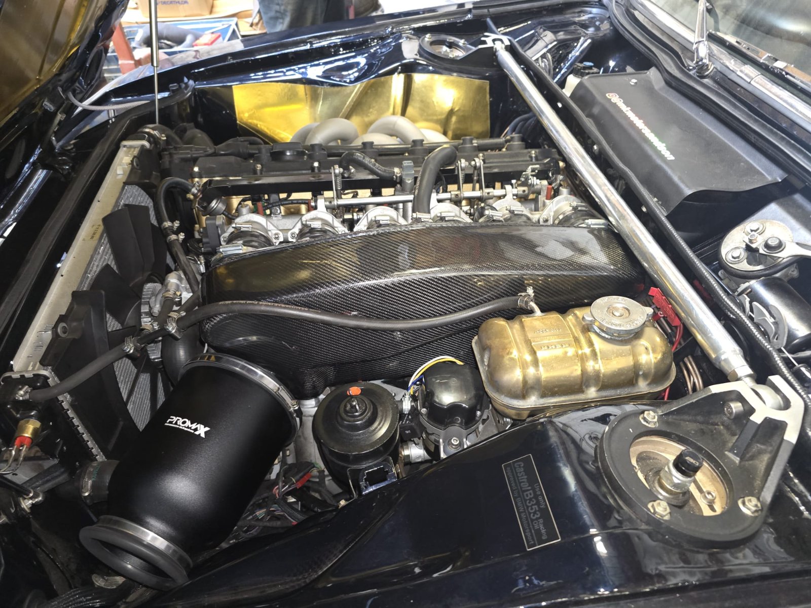

Picked up that main important thing for my project car which you can call the hart of your coupe, it comes with 6 and they really like drinking and producing some noise when they are thirsty! On average they like 3.6 liters of mix drink per round, they disguise themselves as one, mainly in alu/black and calls itself M
It gives you a big smile after waiting for 1.5year, mister M is really staring at you when you see it again in this shape after so long.
Yep, it was a great day to meet again with mister M!

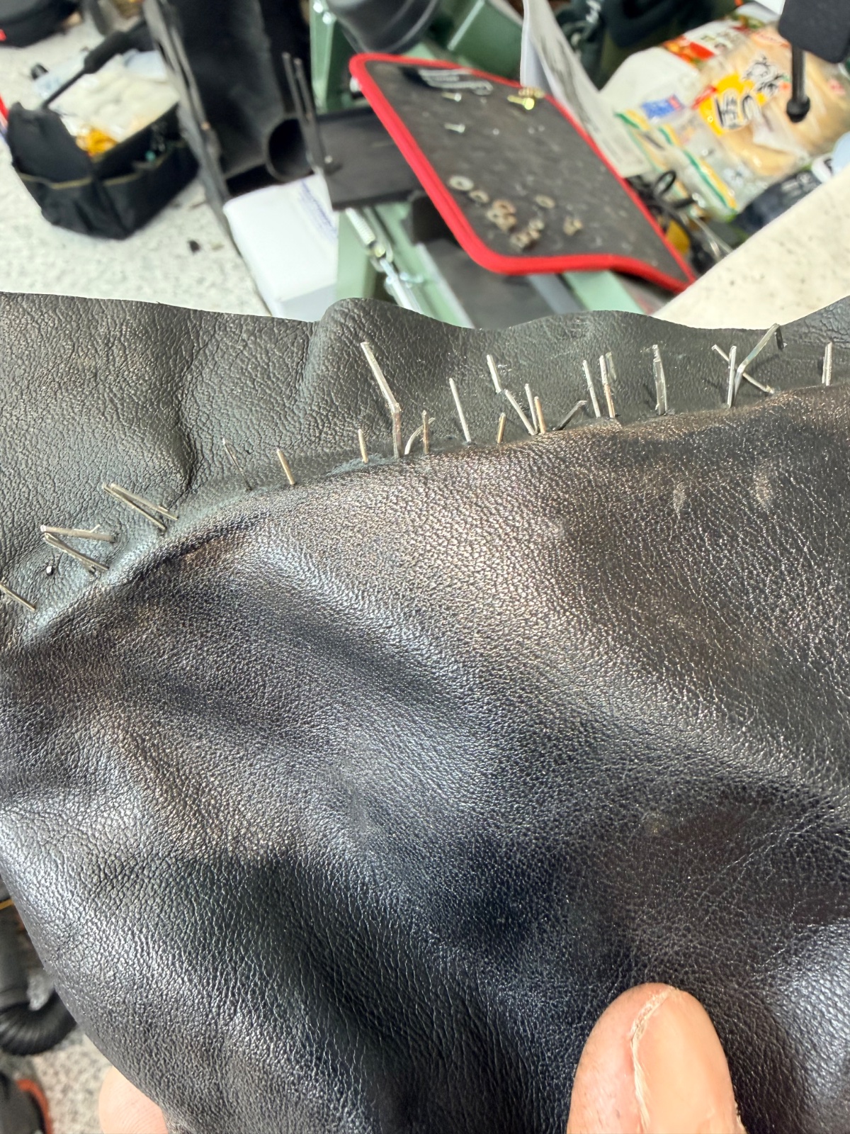

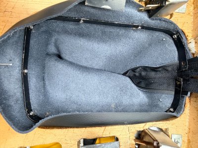

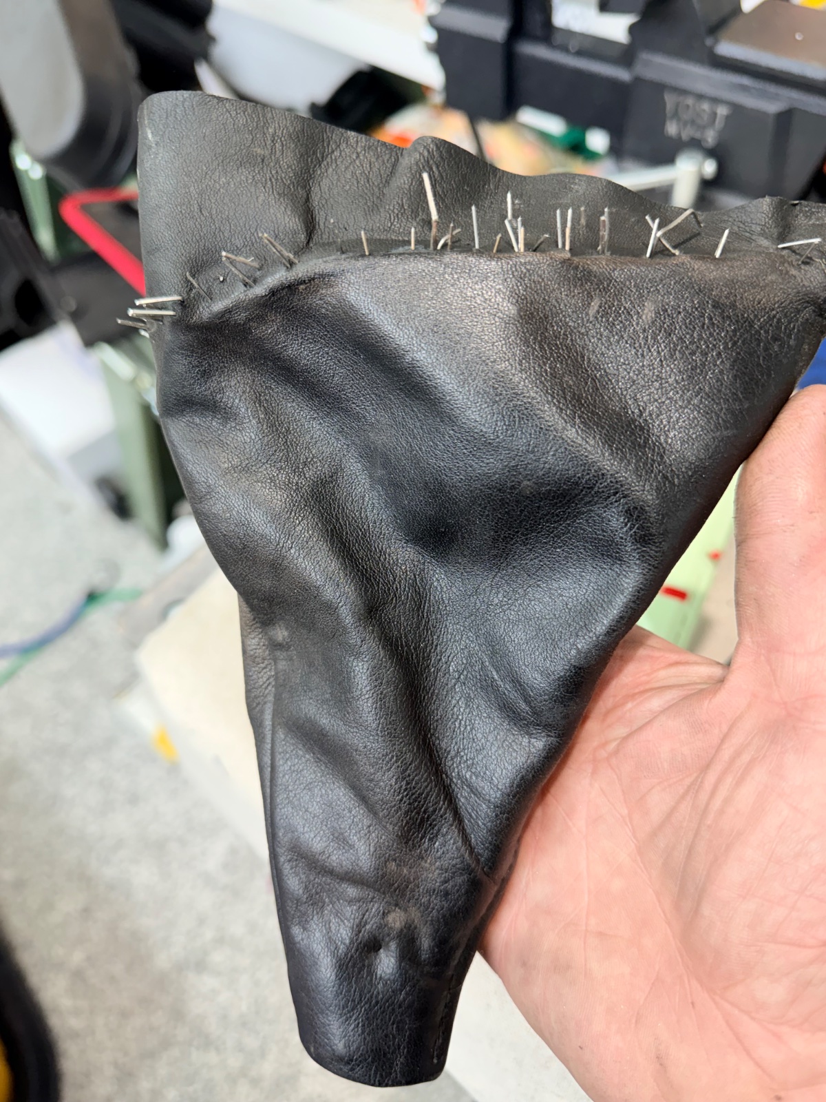

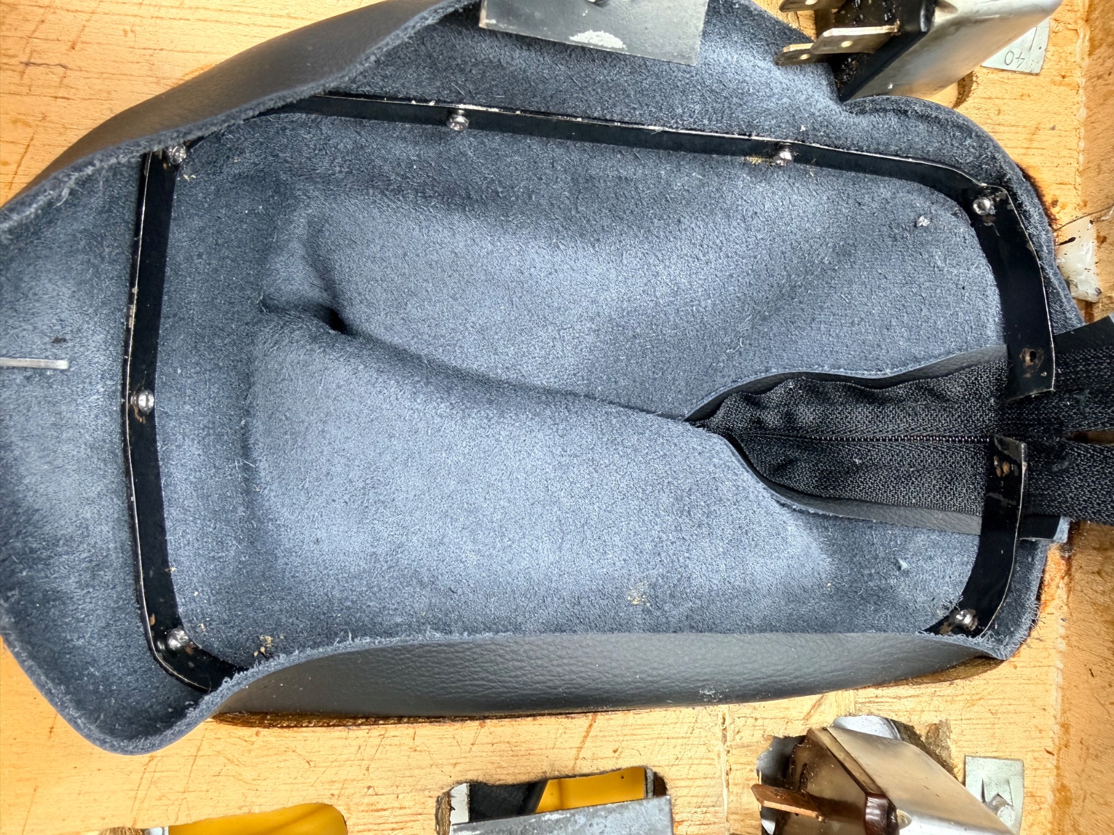

Cleaned up garage a bit so I can have the car and the engine (out of the car) both in there at the same time. Took a bit of a break to install the new shifter surround that arrived from CS-werk. The old one looked like something out of Hellraiser, it’s like someone was being paid by the staple. New one installed with the correct metal bracket courtesy of Don

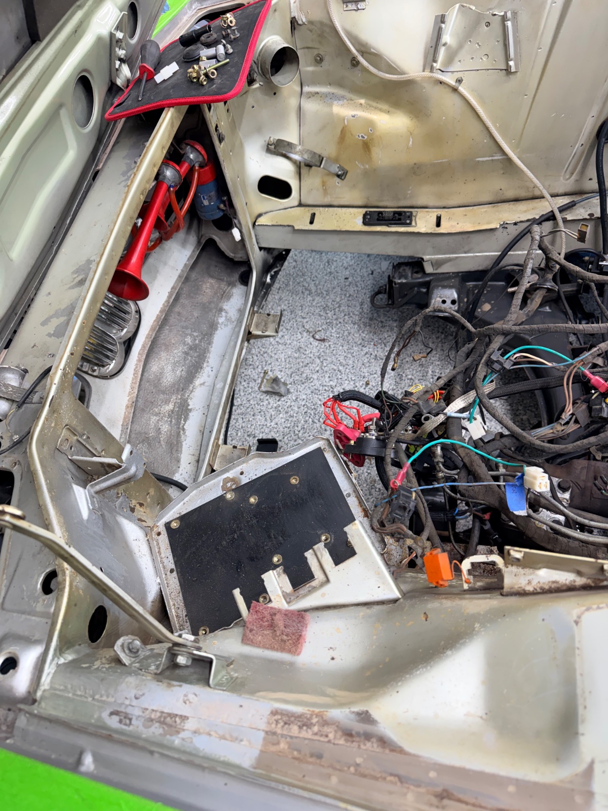

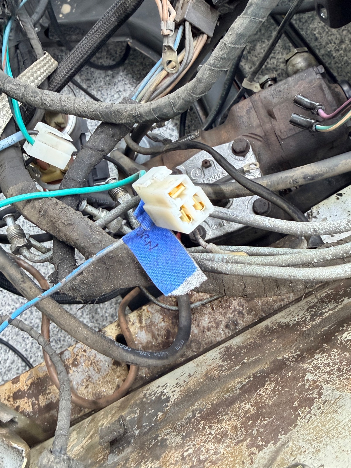

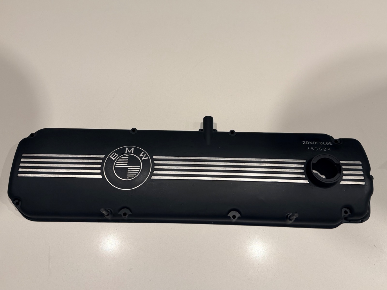

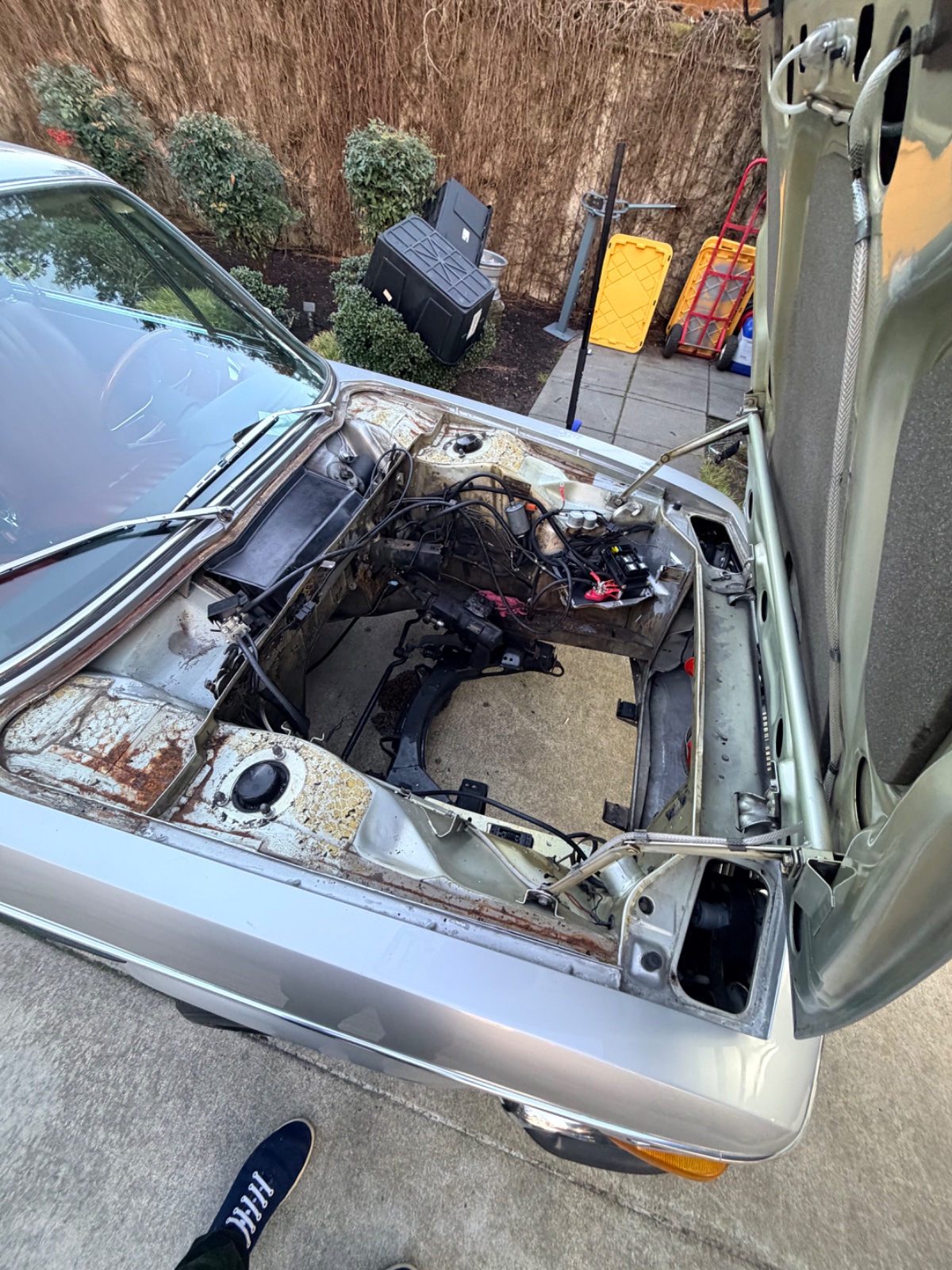

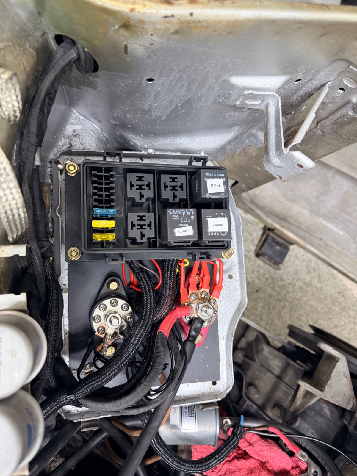

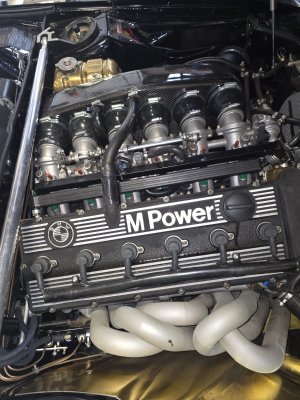

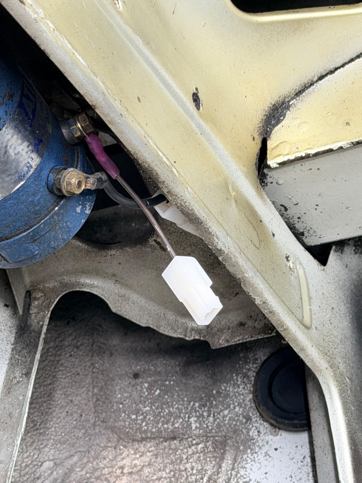

Pulled the wires from the whole front end into the engine bay after a discussion with @boonies. I was originally going to leave them and then perhaps paint the hood by taking it off the car, sounds as if that is not a fun task to realign. So I’ll clear the wiring, leave the hood in place for painting and in the process make some future upgrades - will run a few extra wires to the car interior and also made the side lights and extra horn modular with plastic couplings so they are easy to deal with in the future. This will also inspire me to rewrap the wiring when I put it all back. I also powder coated my valve cover head. I used a satin black which looks nice but if I were to do it again I would use a wrinkle black which probably has a bit more leeway in terms of any small imperfections.
