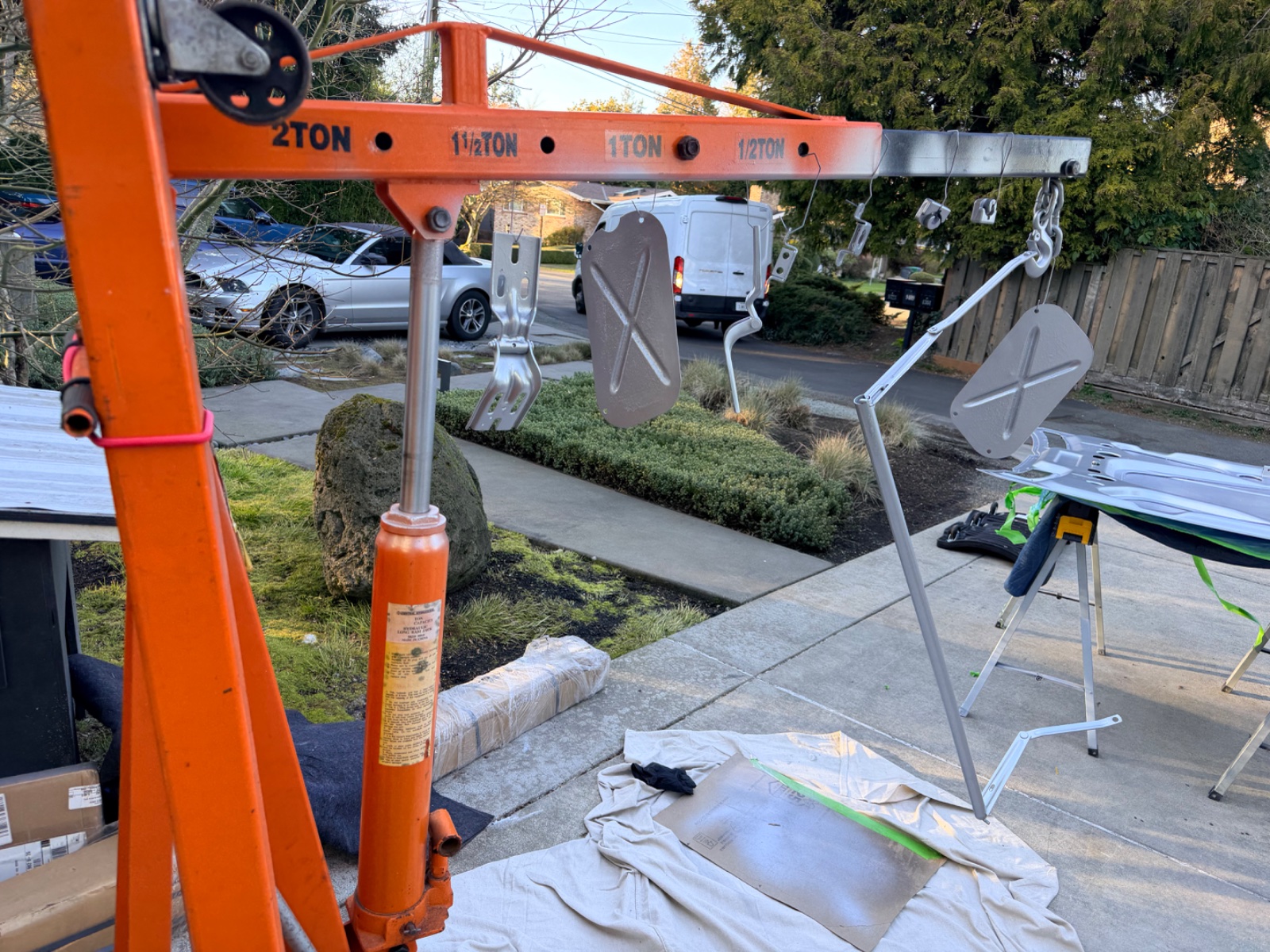

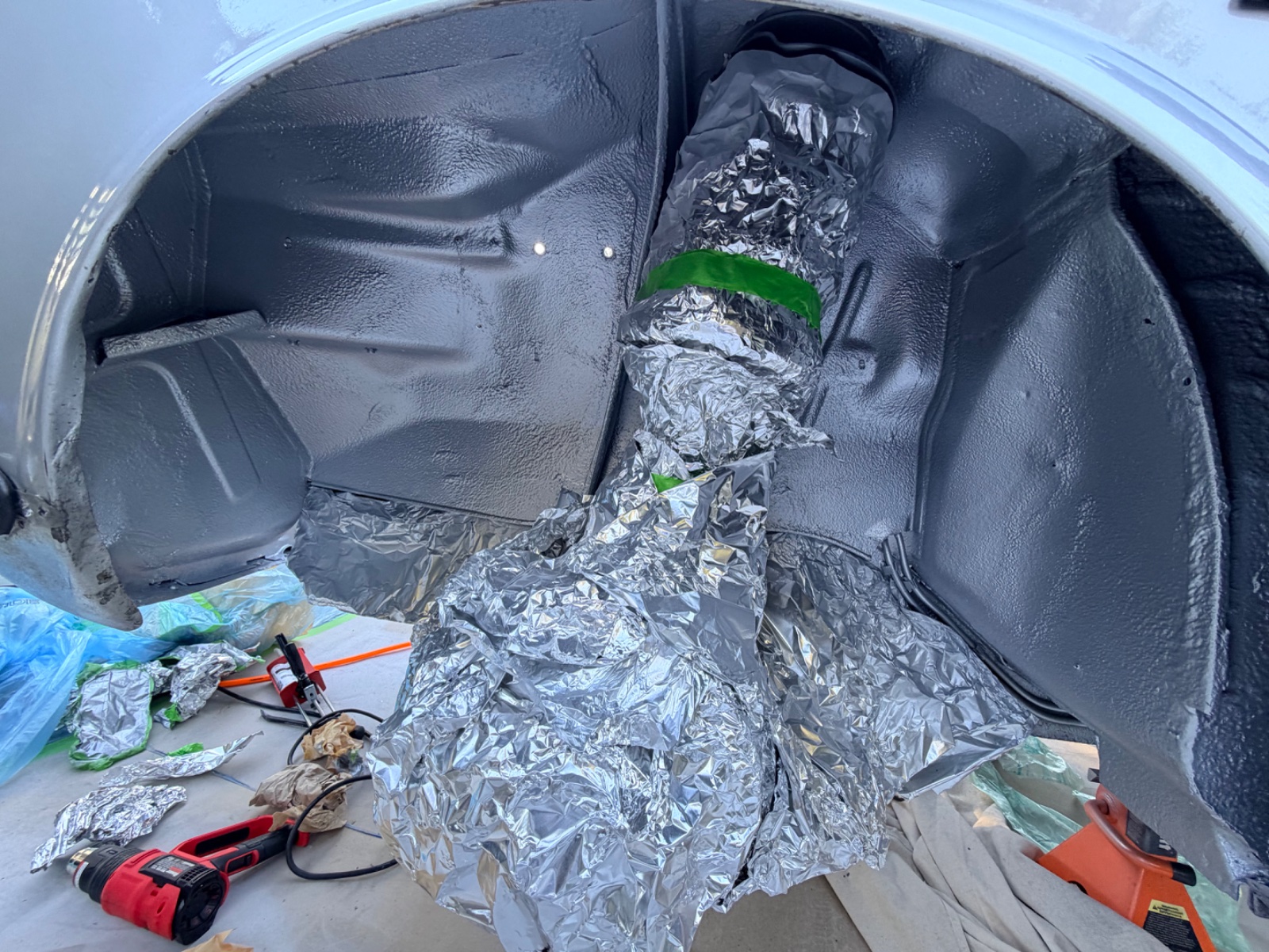

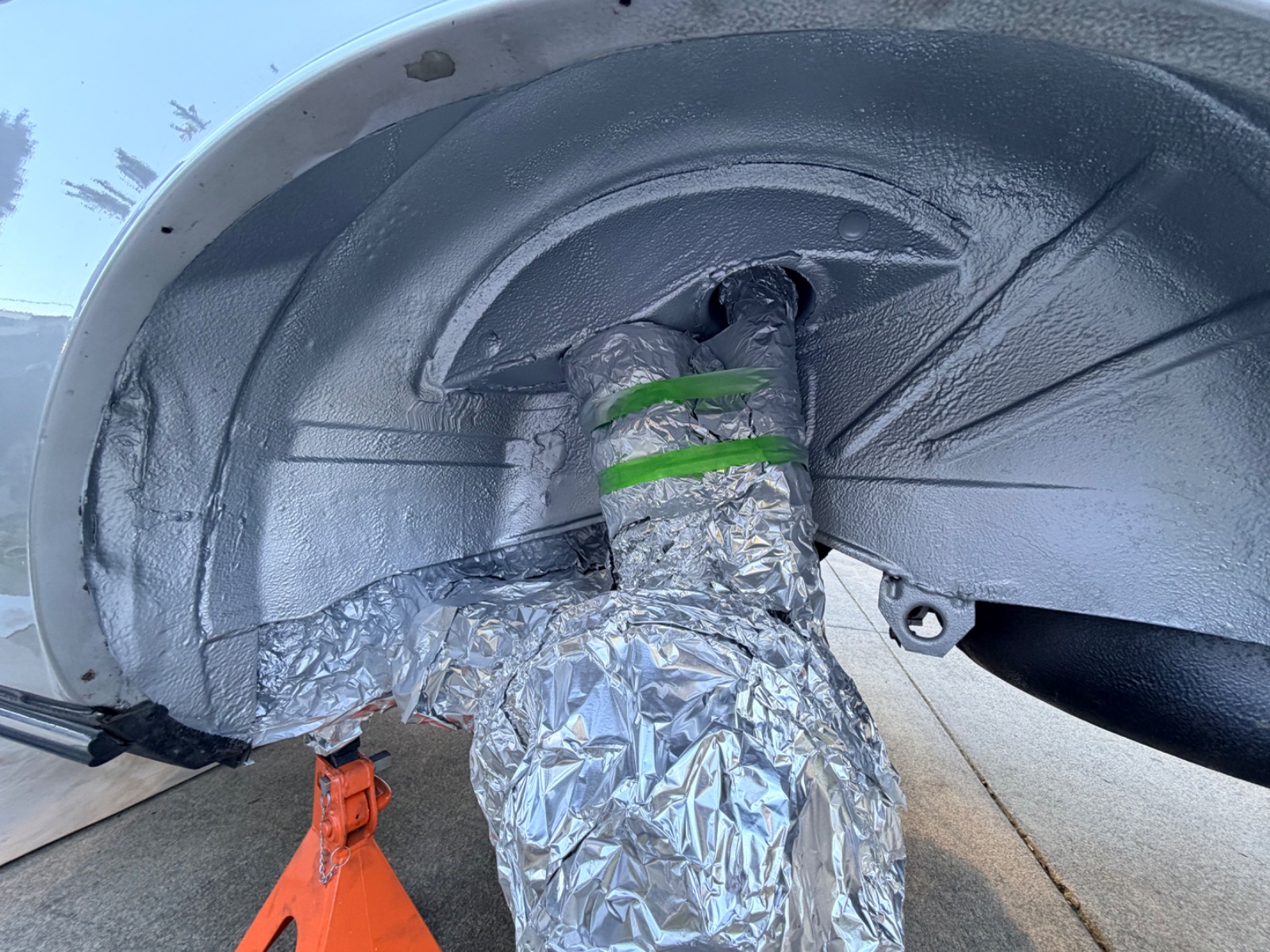

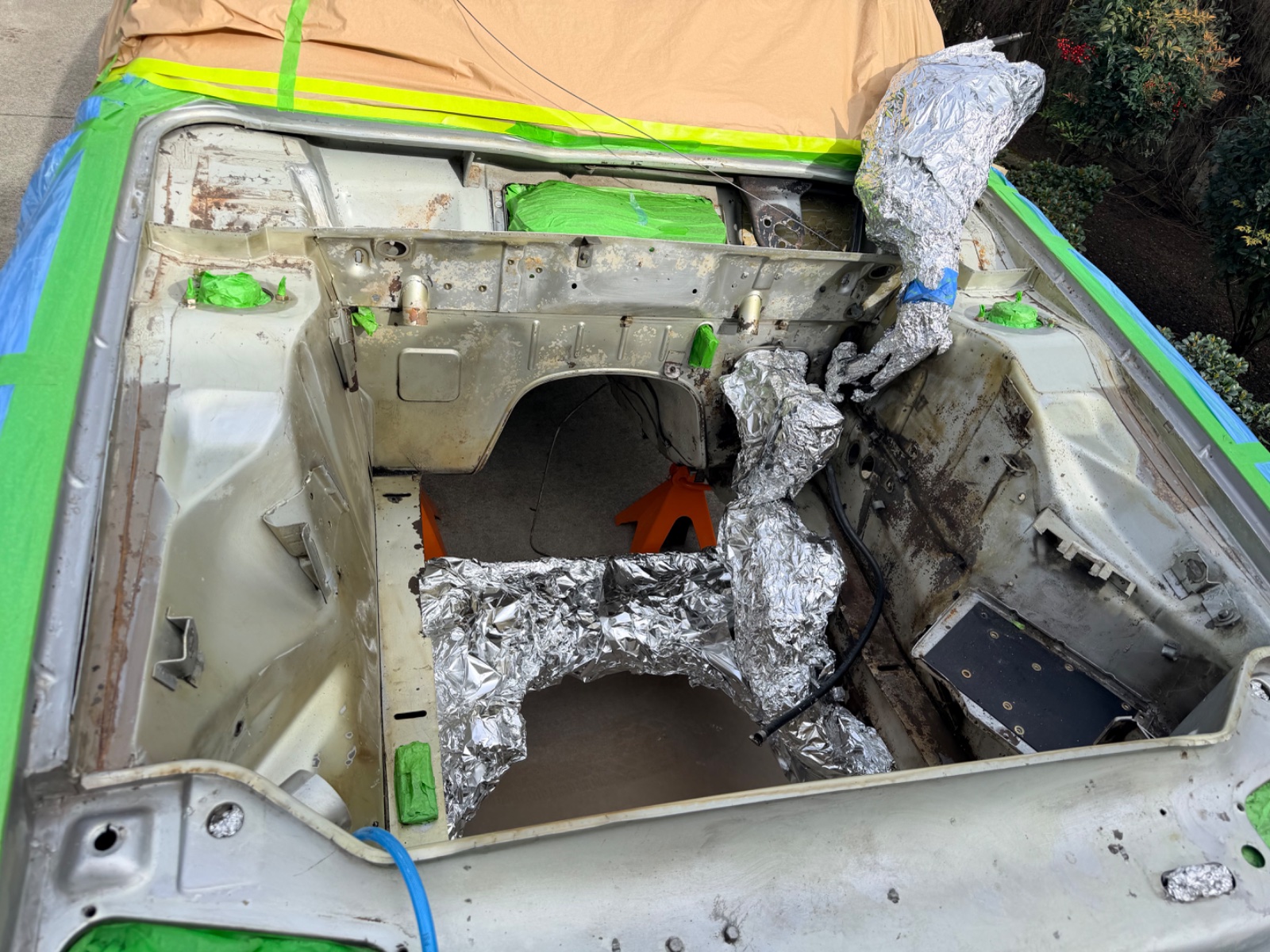

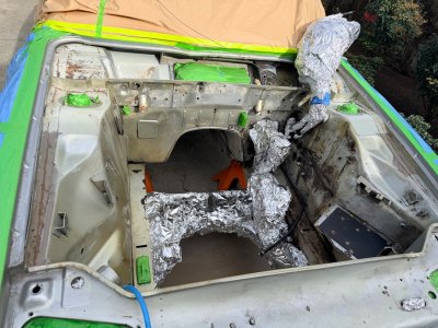

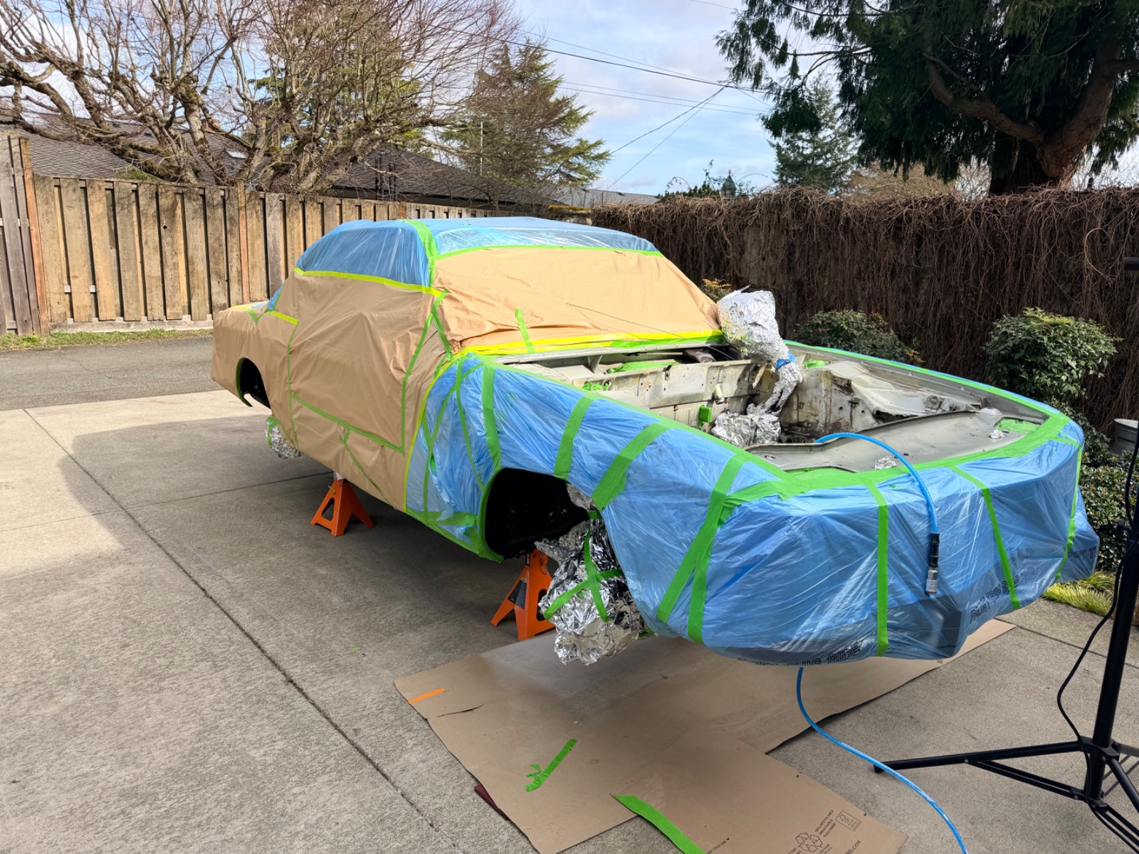

Started the painting of my engine bay (as detailed in another thread). Laid down two coats of RustBullet to counteract the rust areas that were present and hopefully prevent future rust. Tomorrow is priming, seam sealing and topcoat of engine bay and wheel wells
Very clean looking. That dry ice work really has provided a nice surface for this painting project. Being end of February, I note BC and the PNW can still rain pretty well at this time of year, but I see you have a window. Plus, even at the prevailing temperatures, that RustBullet will work. Great timing! It is tough to wait until June to do painting touchups. ;)

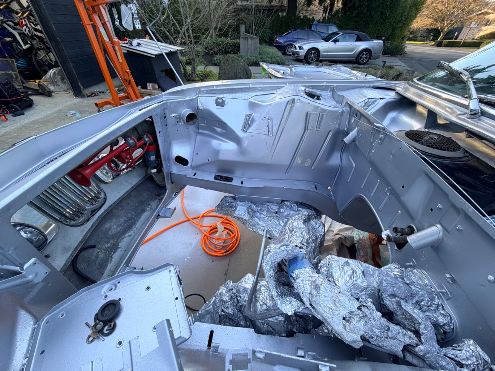

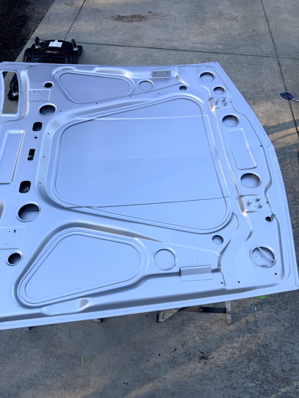

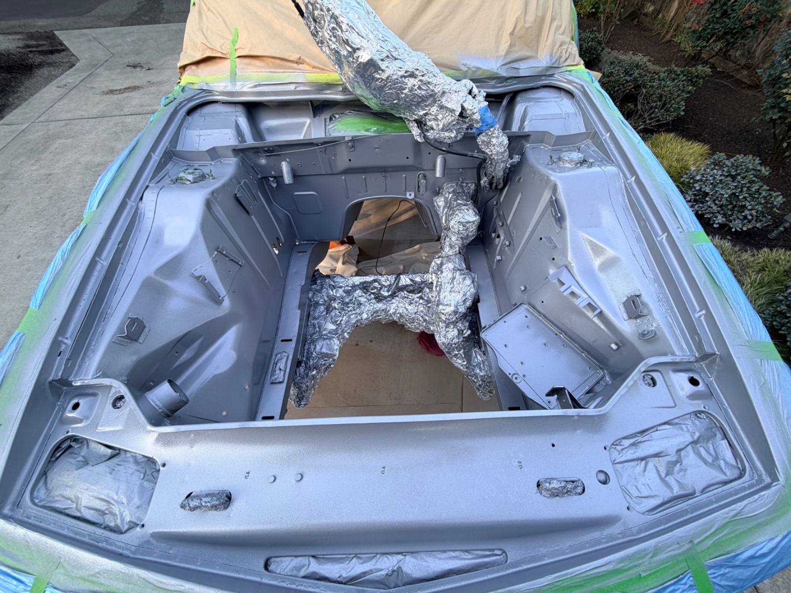

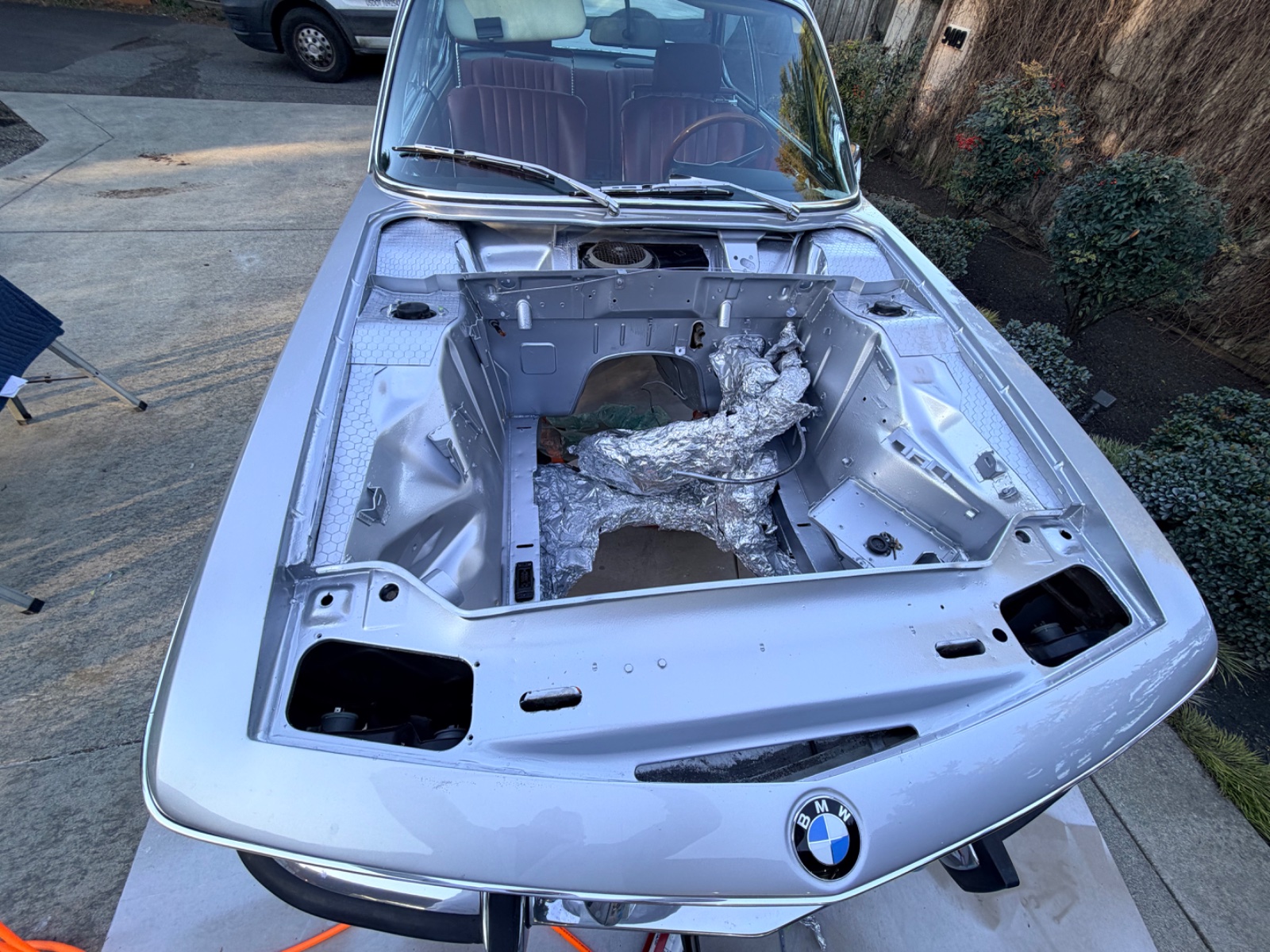

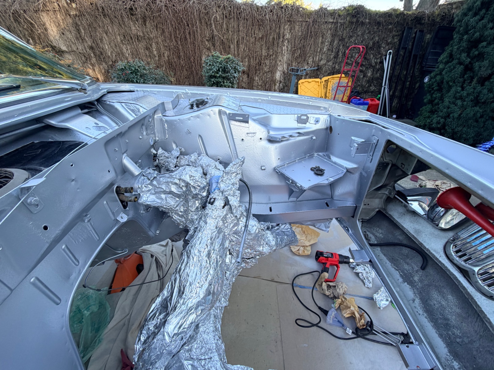

Finished painting the engine bay, the wheel wells, the hood underside and all of the various hood bits and pieces. Quite a job but moved quickly once I got going. Peeling off the tape was a bit nerve-wracking - I wish I had thought to soften it with heat gun before I started pulling as I had one area where the tape pulled off a bit of the exterior paint, which suggests maybe whomever had painted it last hadn’t necessary done the most top-notch job. Anyways, all good and now the reassembly begins!

Pulled the engine in prep for repainting/refresh. Thanks to those of you who helped out by answering questions in my “thoughts on engine removal” thread. Your advice came in handy
Is this going to be a complete respray? Or just tidying up the engine bay?
Just repainting the engine bay, wheel wells and hood underside. The exterior of the car is fairly good - some small chips etc but I don’t have the skill to do the exterior myself and don’t have the funds currently to have someone else do it. At least now the car looks fairly uniform. It’s not perfect, there is a slight color difference between the 15-20 year old exterior paint and the engine bay Polaris silver but again, you would have to look carefully to see it.
I'm impressed that you are tackling all that yourself. Yeah, I don't think that minor paint color difference between exterior and engine bay will matter.
I had my coupe down to sfdon's shop a year ago for engine bay refurbishment (and many other mechanical fixes). What a transformation!
You will love the result, I predict. Best of success with the project!

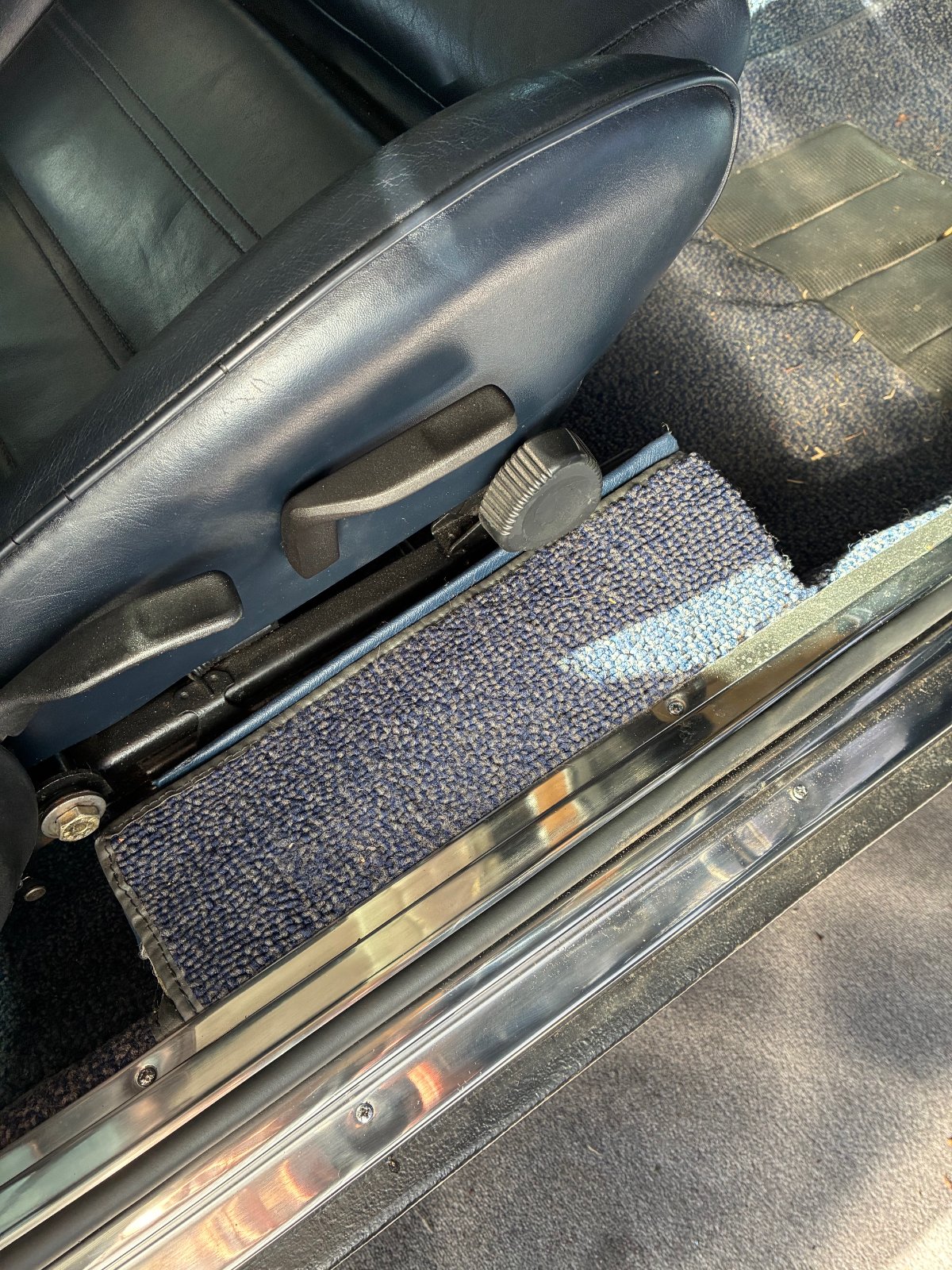

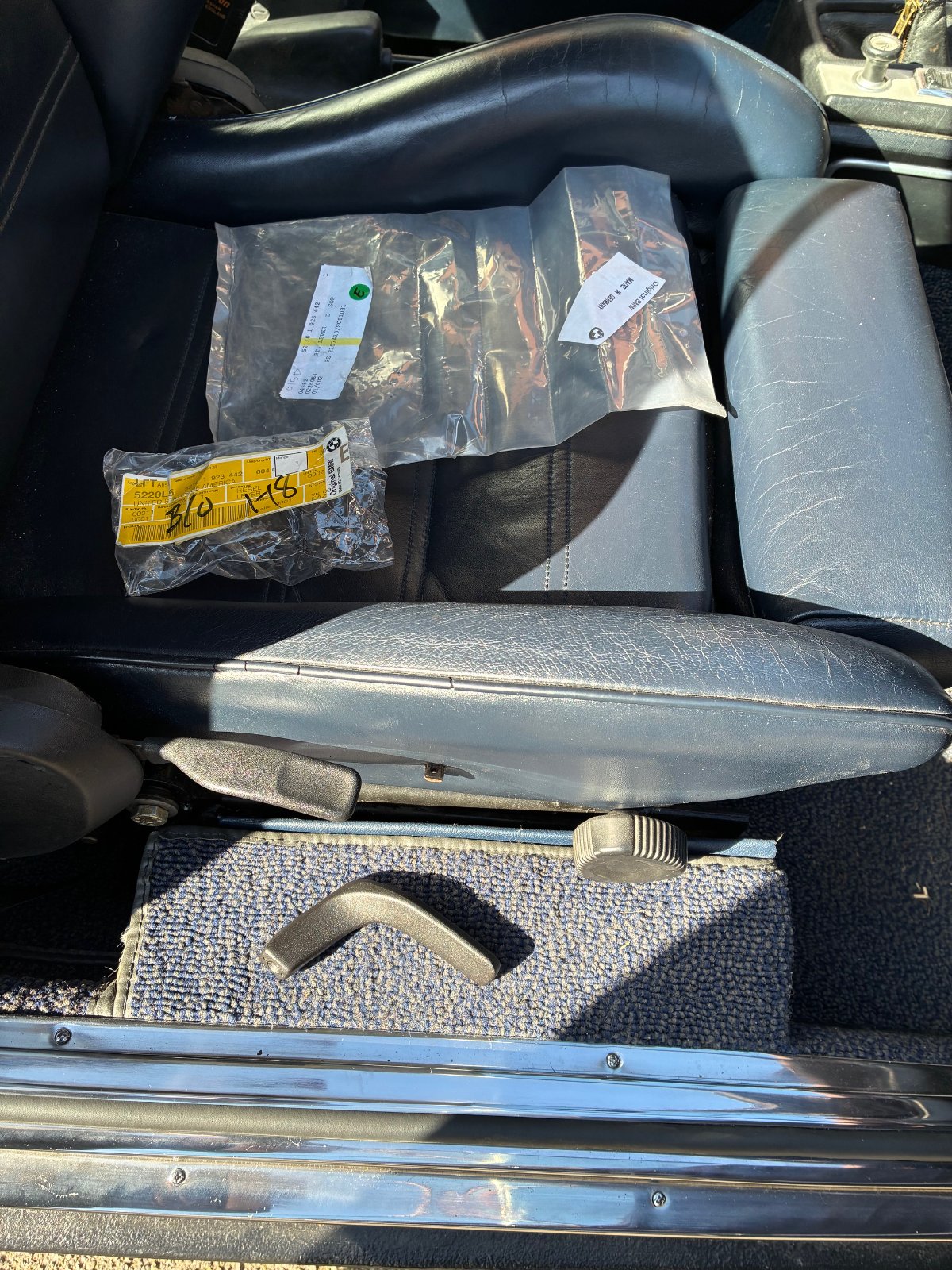

After a 12 month search I recently found the lever I was missing for the E24 seats I am using, so finally fitted that. Came all the way from Las Vegas, so it's travelled a bit - Germany, Las Vegas, Manchester ....

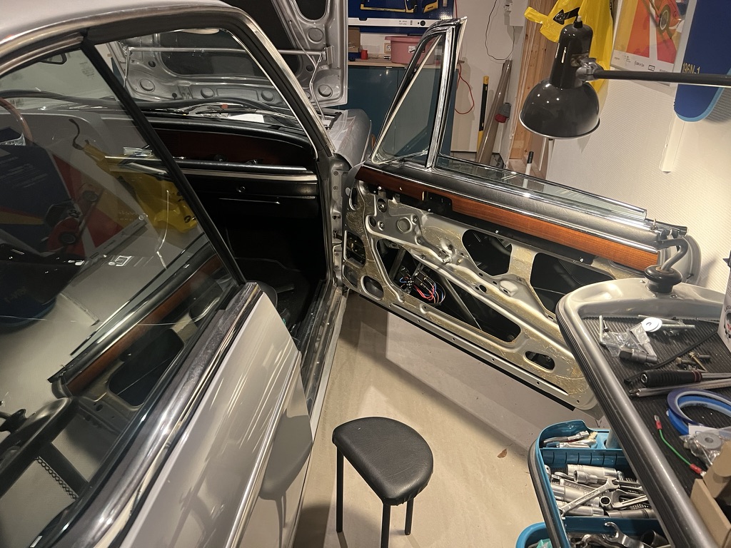

Next up is a bit of fiddling with the right hand front window.

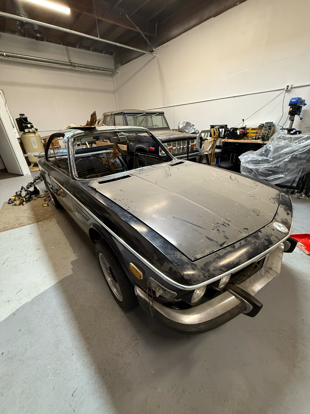

Got the engine, trans and diff out of the car in preparation for moving to the body shop. The diff was a bear to remove...That was TODAY'S project... I don't think it, or the half shafts have ever been out of the car.

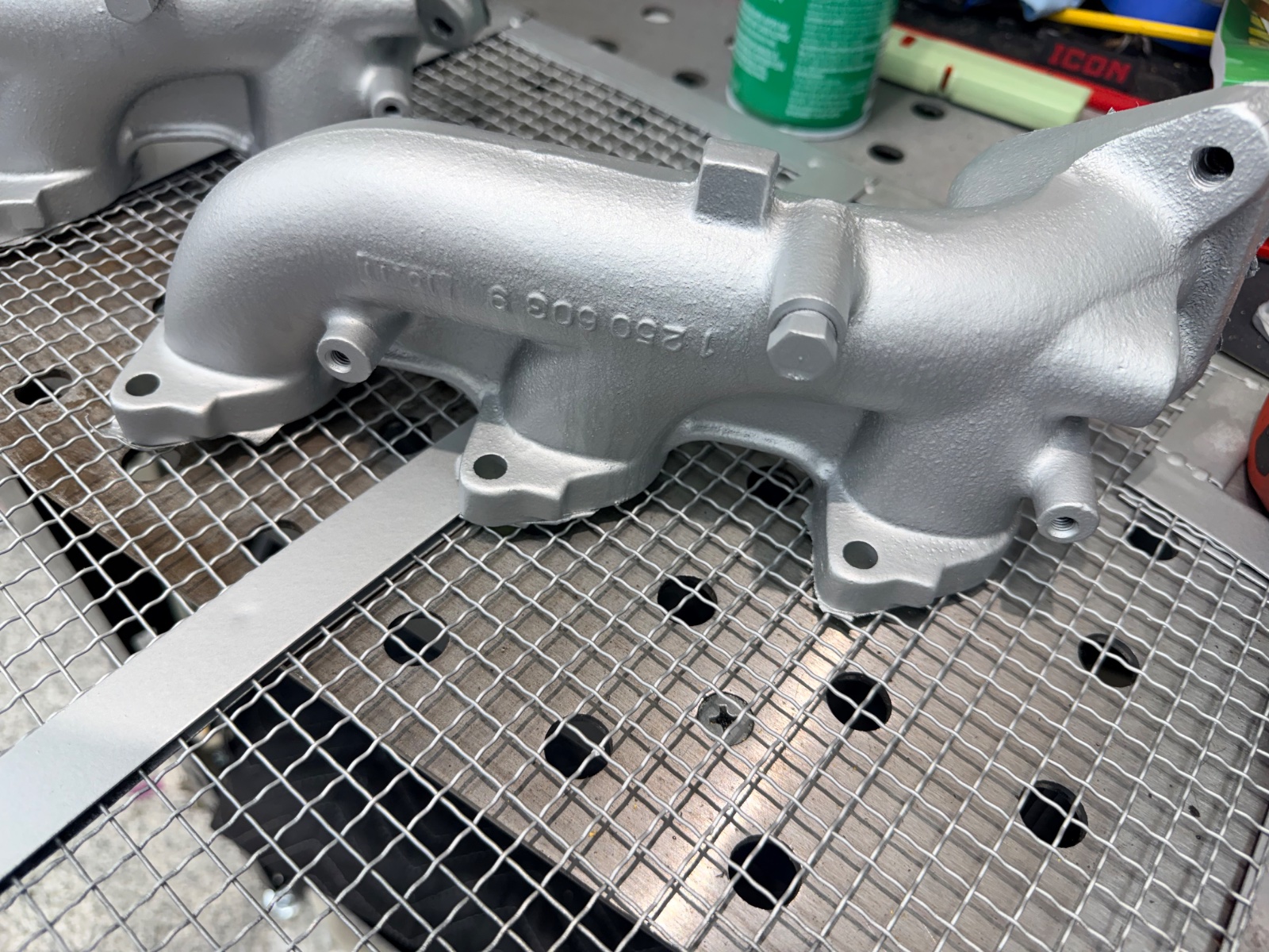

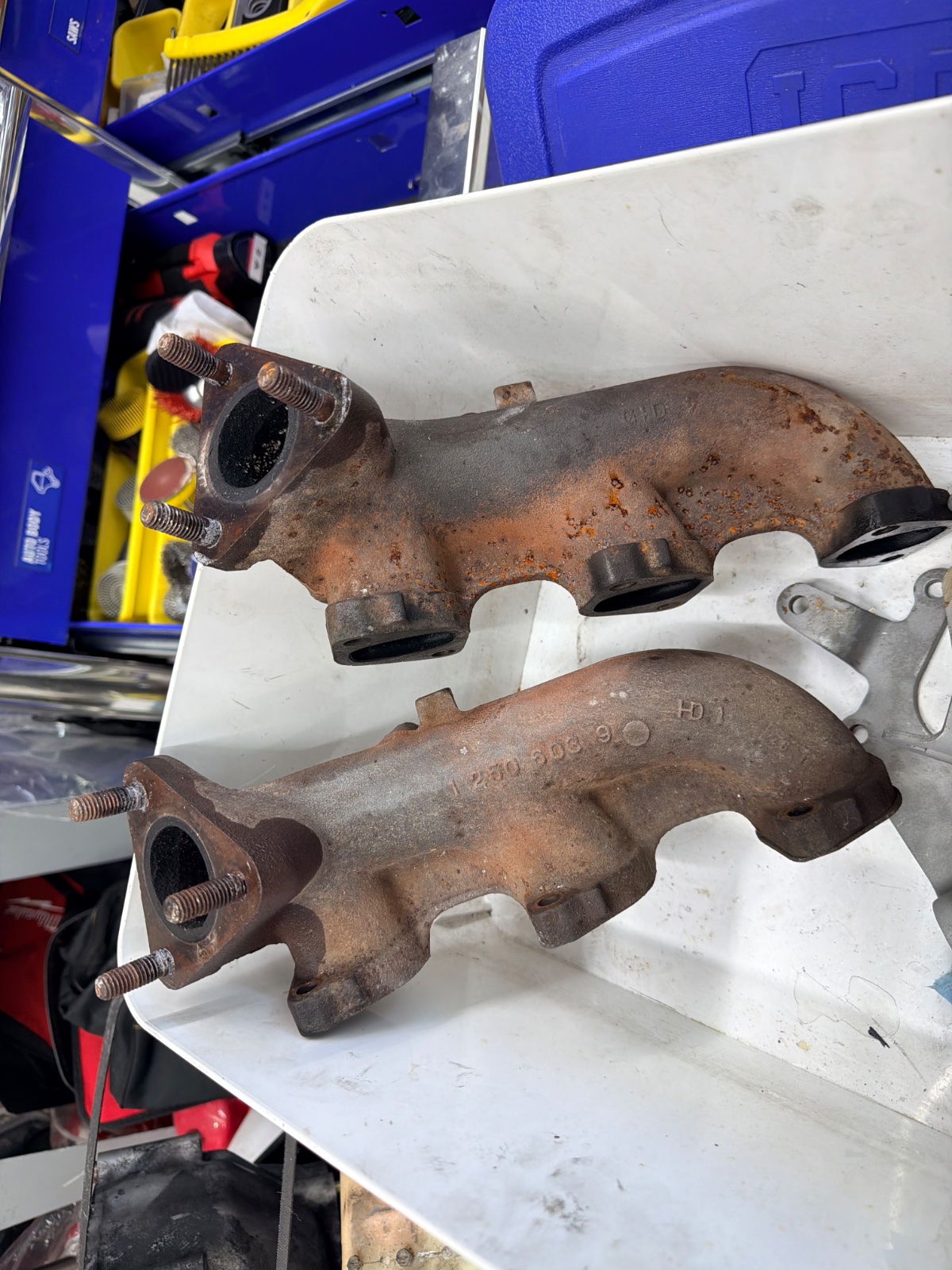

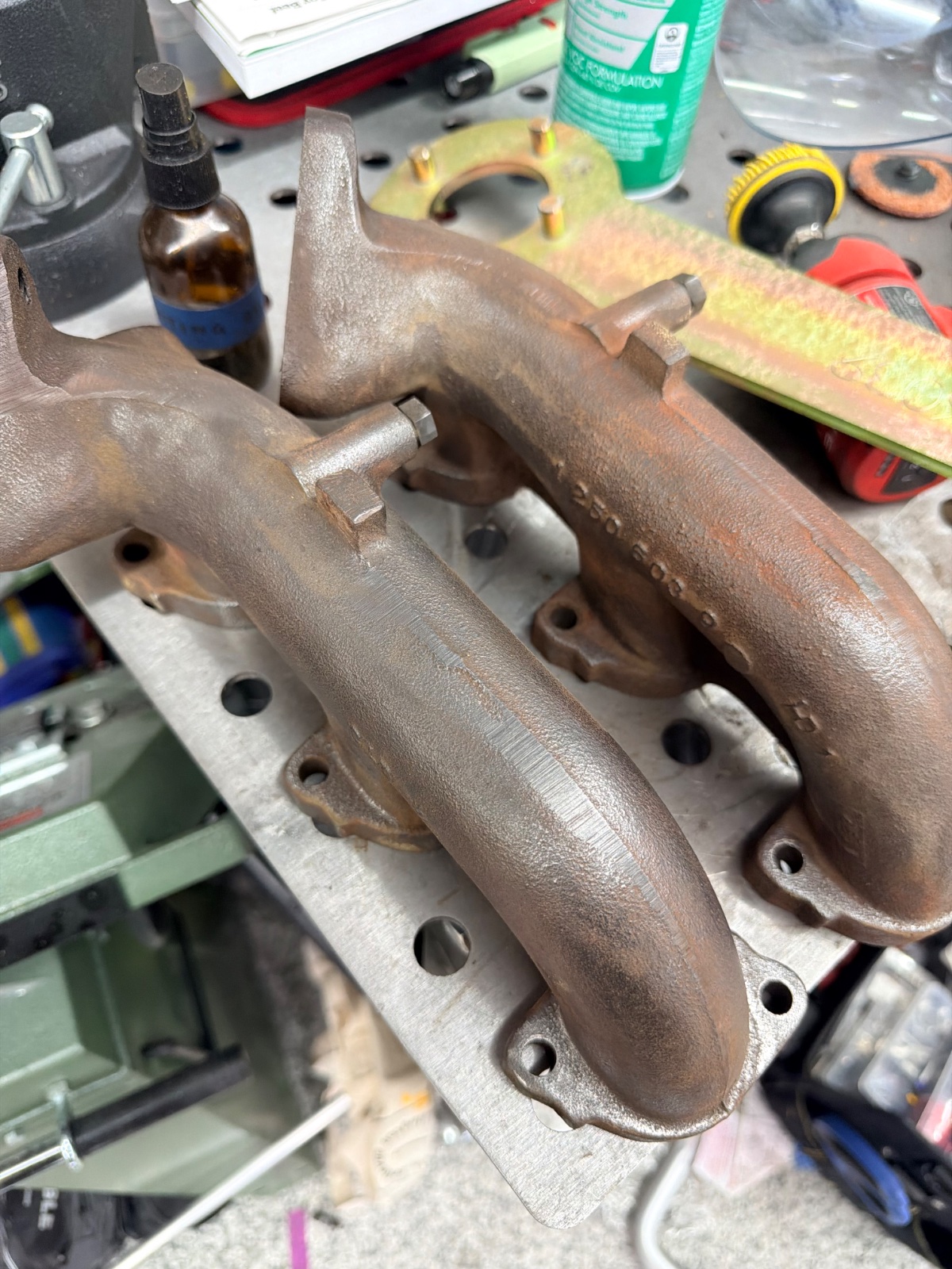

I removed front calipers and rotors in preparation for rebuilding the calipers and putting in new rotors and pads. I think the PO had more recently replaced the pads but the calipers were really gummed up and the rubber just completely tore away as I removed the pistons. Will sandblast, zinc plate and then powder coat while I wait for seal kits to arrive this week.
Also cerakoted my exhaust manifolds after sandblasting them this morning since they were looking fairly rusted over. Since the engine is on the stand I’ve have been cleaning up parts of it, essentially everything short of taking it apart. Front/rear main seals, valve cover refresh and new gasket, etc. The manifolds are looking good and are now extra-protected.
