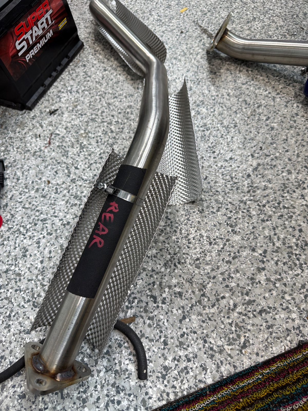

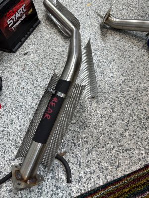

Meanwhile have been fashioning the heat shielding for the exhaust this evening, will be bolting this back on in the next few days. One test bracket on there, each piece will have two to secure it.

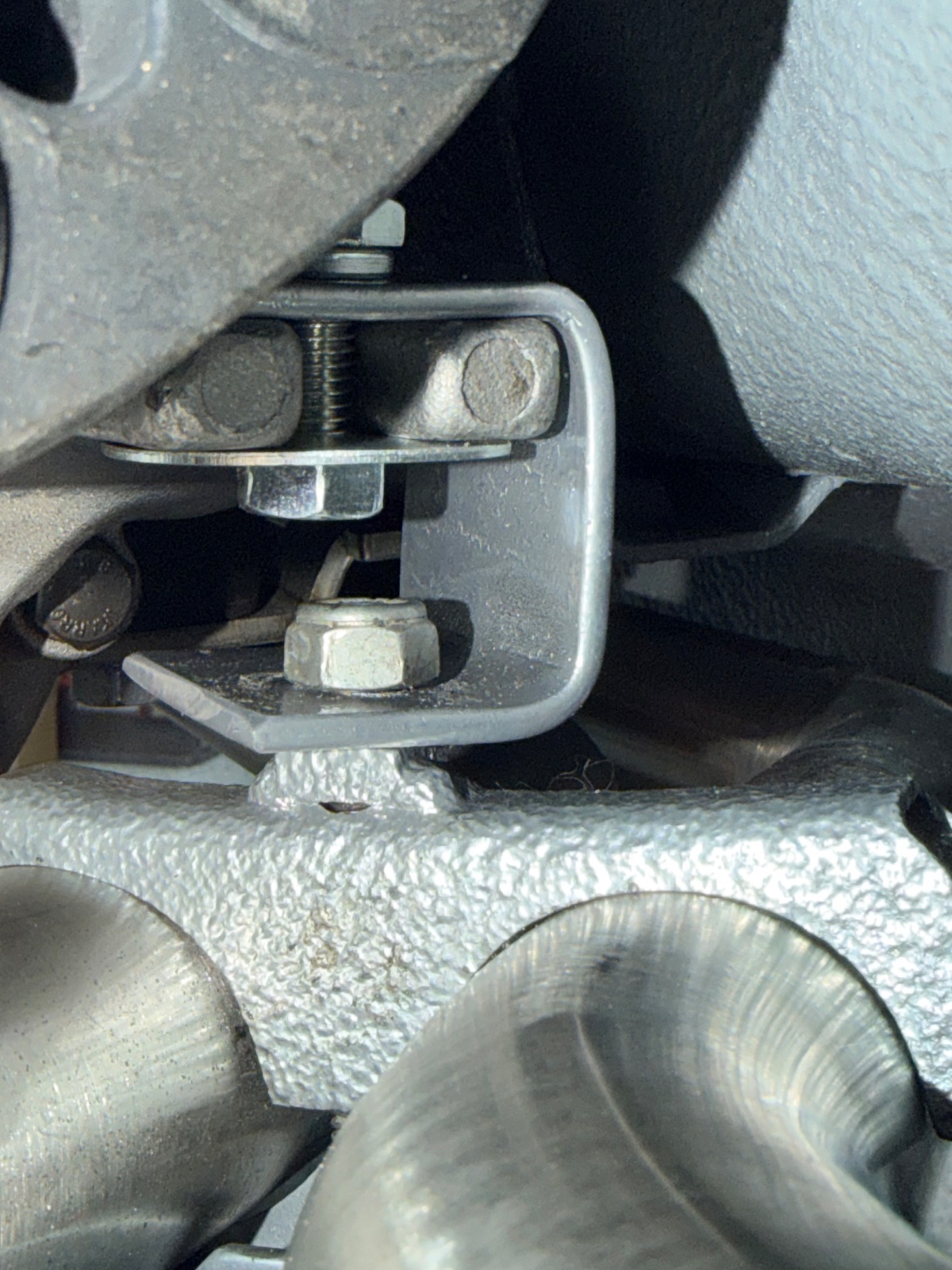

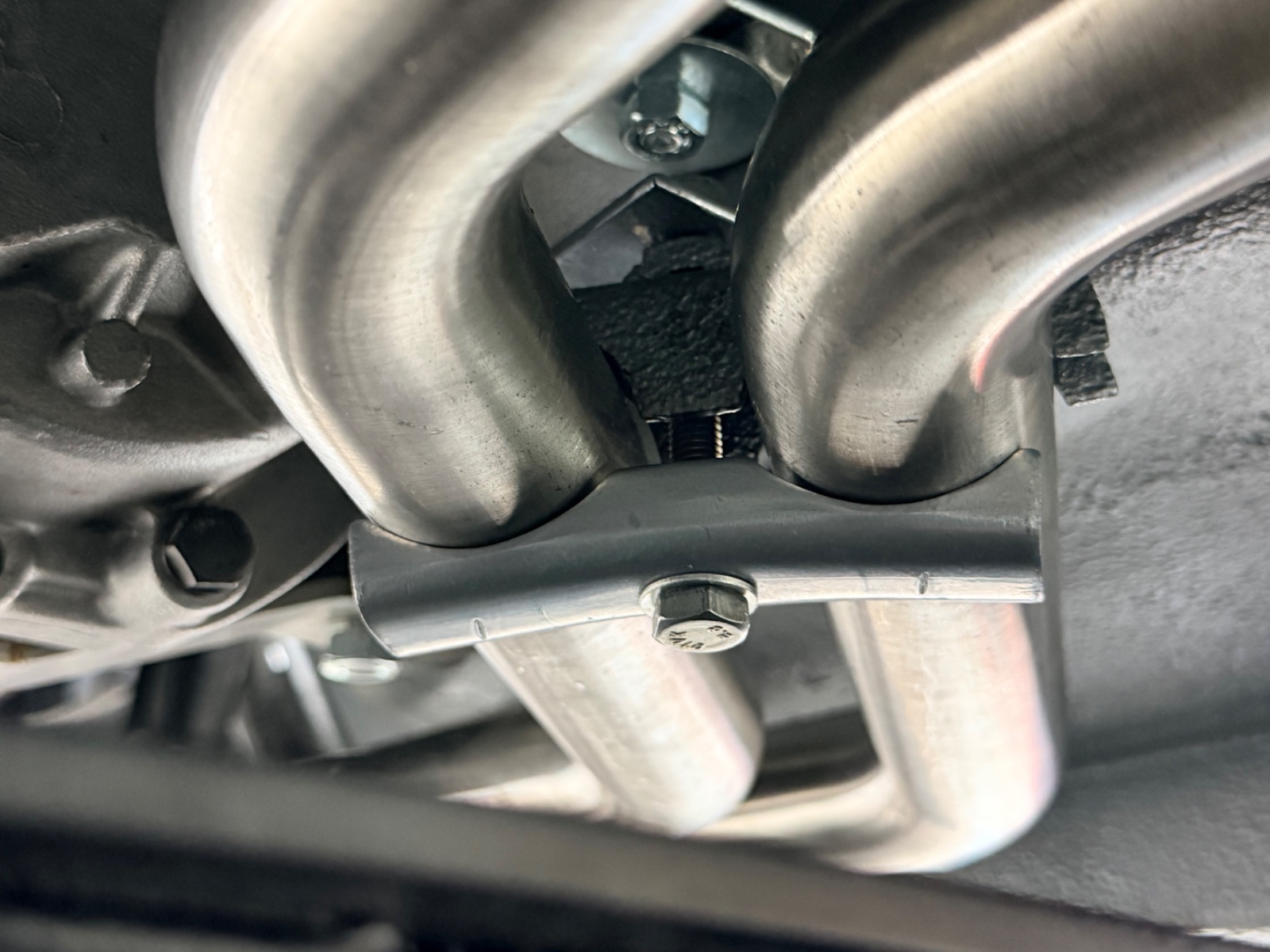

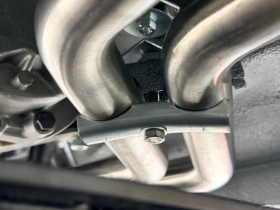

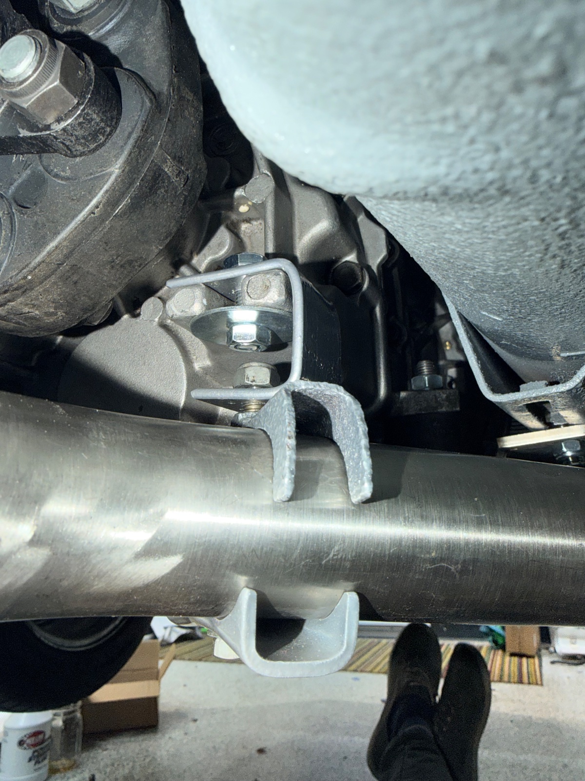

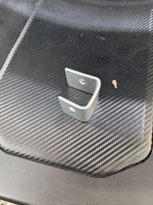

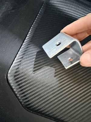

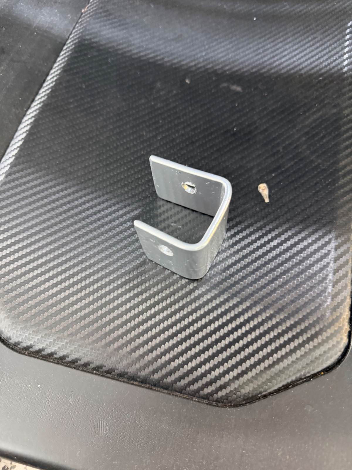

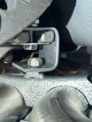

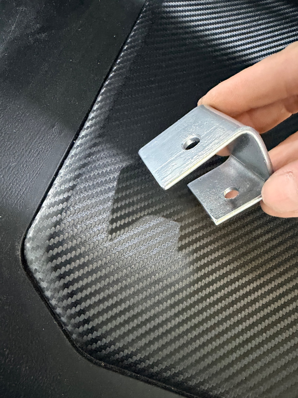

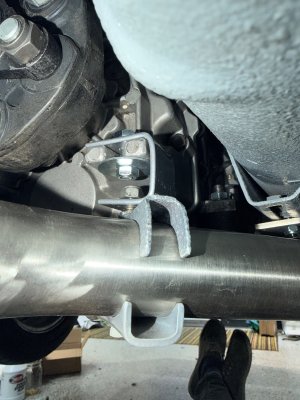

Exhaust is in. I manufactured a bracket to hold the exhaust onto the 5-speed transmission. This involved bending a piece of metal into a U-shape, powder coating it so it won’t rust, securing one half of the U to the fork on the tranny that isn’t being used and then the other onto the original bracket which I trimmed down to fit. Works well and is very solid. Heat shielding will go on tomorrow. Is there some other bracket that sits under the muffler portion and secures on to the bottom of the transmission tunnel? There seem to be two bracket receptacles there but my car didn’t seem to come with anything holding up that part.

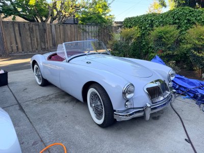

Not as much with the E9 this weekend, just got the MGA back from the painter so had to reassemble a lot of it. But got that done and it drives beautifully now - 5-speed and rebuilt engine done over the last year, painting and interior was this spring’s project.
Did get the hood back on the E9 so it’s looking more like a car getting a tune-up rather than a project. Waiting on a hose and an o-ring, hoping to have it running by next weekend after 4 months of refurbishing

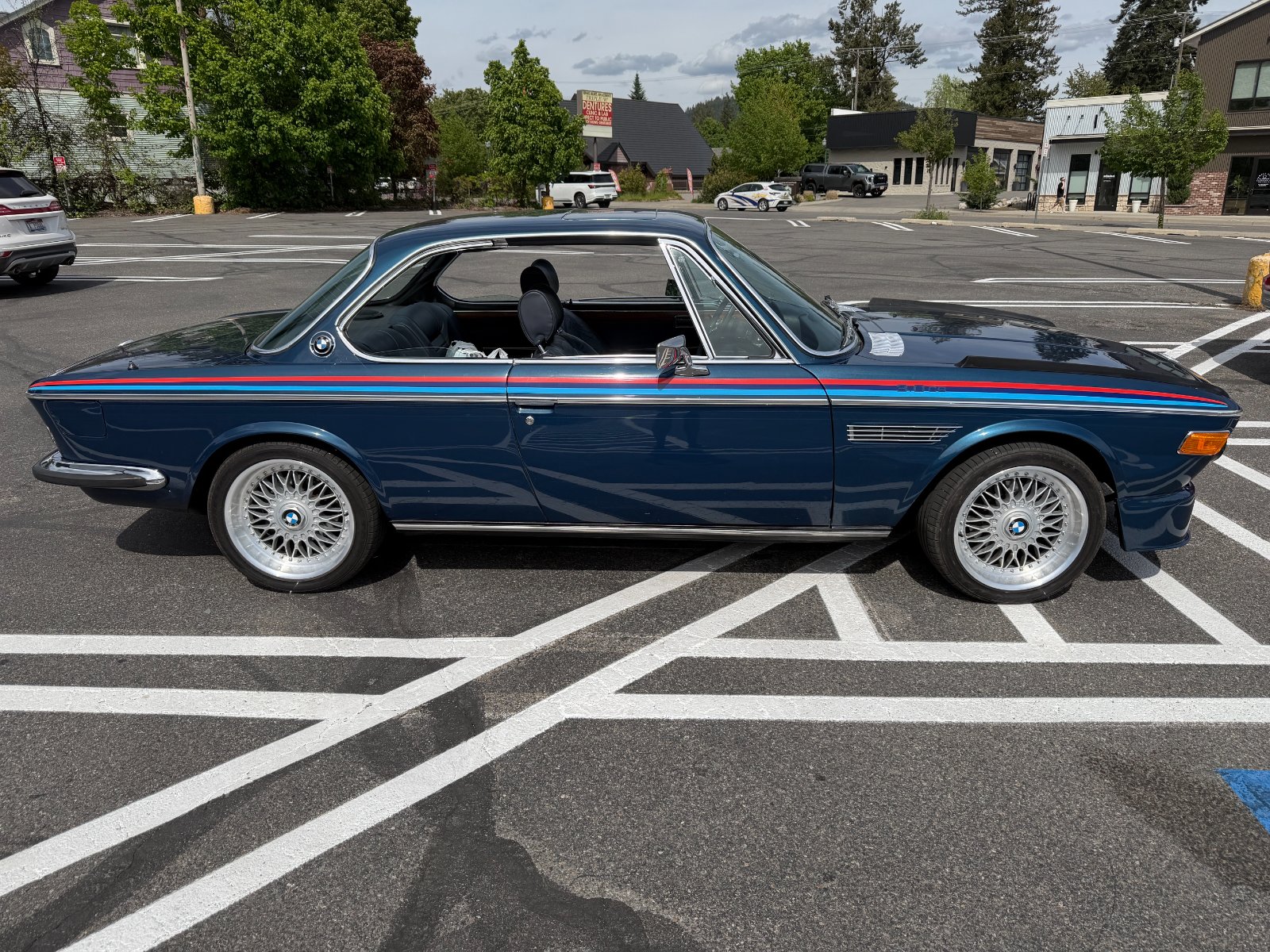

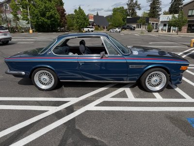

Is going grocery shopping in a coupe considered sacrilege? These cars are amazingly practical cars. I'm trying to drive it as much as possible as a daily this Summer, our driving season here is so short. It loves to get out and is running great w/ fresh tune, valve job, new seals everywhere, tie-rods, etc.
And is it only me, or when you purposely park a mile away from any car in a huge parking lot, that when you get done with whatever you were doing, there is the biggest POS parked 2" from your driver door when you get back? I am beginning to think people do this on purpose to piss people off. It didn't happen here, but has certainly happened many times in the past and it can't be coincidence. One time I had to get in through the passenger door. Drives me absolutely crazy!
It's not just the paint I worry about, it's the door dings in the aluminum trim. Luckily nothing major in that regard has happened....YET. Knock on the wooden dash!

Not sacrilege....
But yes, parking well is an art - a necessary one if you have a nice paint job.
But if your strategic vehicle-avoidance-pattern of parking still finds you cozying up to the derelict RAV4, then most assuredly that was an intentional act from the other party.
Irritating, isn't it?

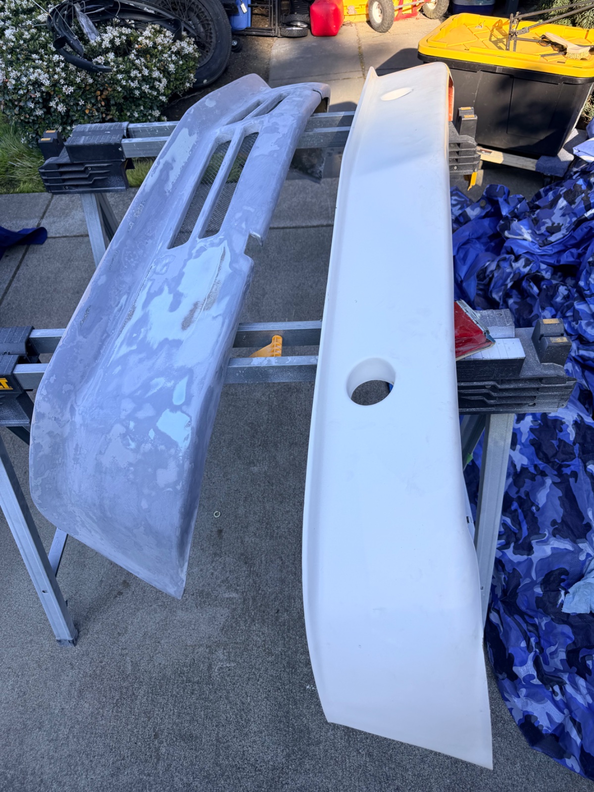

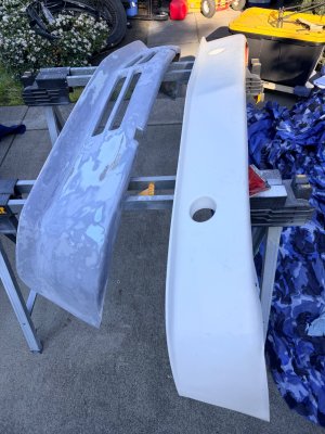

Have been refinishing my air dam which had gotten a bit beat up prior to my owndership of the car. Body filler, sanding done, painting this weekend. The car came with this 635-style as well as a CSL one, going to take a few of the ideas here to make them easily swappable - 4 bolts to remove bumper and then two push-release bolts to drop the air dam.
I’d love to see some pics of the air dam mount once it’s on
