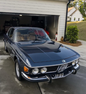

Have been refinishing my air dam which had gotten a bit beat up prior to my owndership of the car. Body filler, sanding done, painting this weekend. The car came with this 635-style as well as a CSL one, going to take a few of the ideas here to make them easily swappable - 4 bolts to remove bumper and then two push-release bolts to drop the air dam.
That's nice to have a couple choices or in my case it would have been really nice to swap out when I damaged on or the other. My Bavaria Alpina-Style air dam got damaged so much I called it my $10K Dollar Air Dam. As much as I paid my neighbor to fix it, it probably added up that much over the years. And I thought I was careful but going fast on back roads that aren't in great shape and crowned if you don't hit the turn just right and make split second decisions, one wrong decision and BLAMO! :mad: The way and where it was mounted was slightly different than others and it just seems to attract curbs, gas station entries, driveway transitions etc.Even slow and at an angle. My personal garage was a terrible angle, no matter how I tried to take the angle it would just barely scrape, not enough to do any real damage, I just really had to watch it. Throw up some pics when it's on.

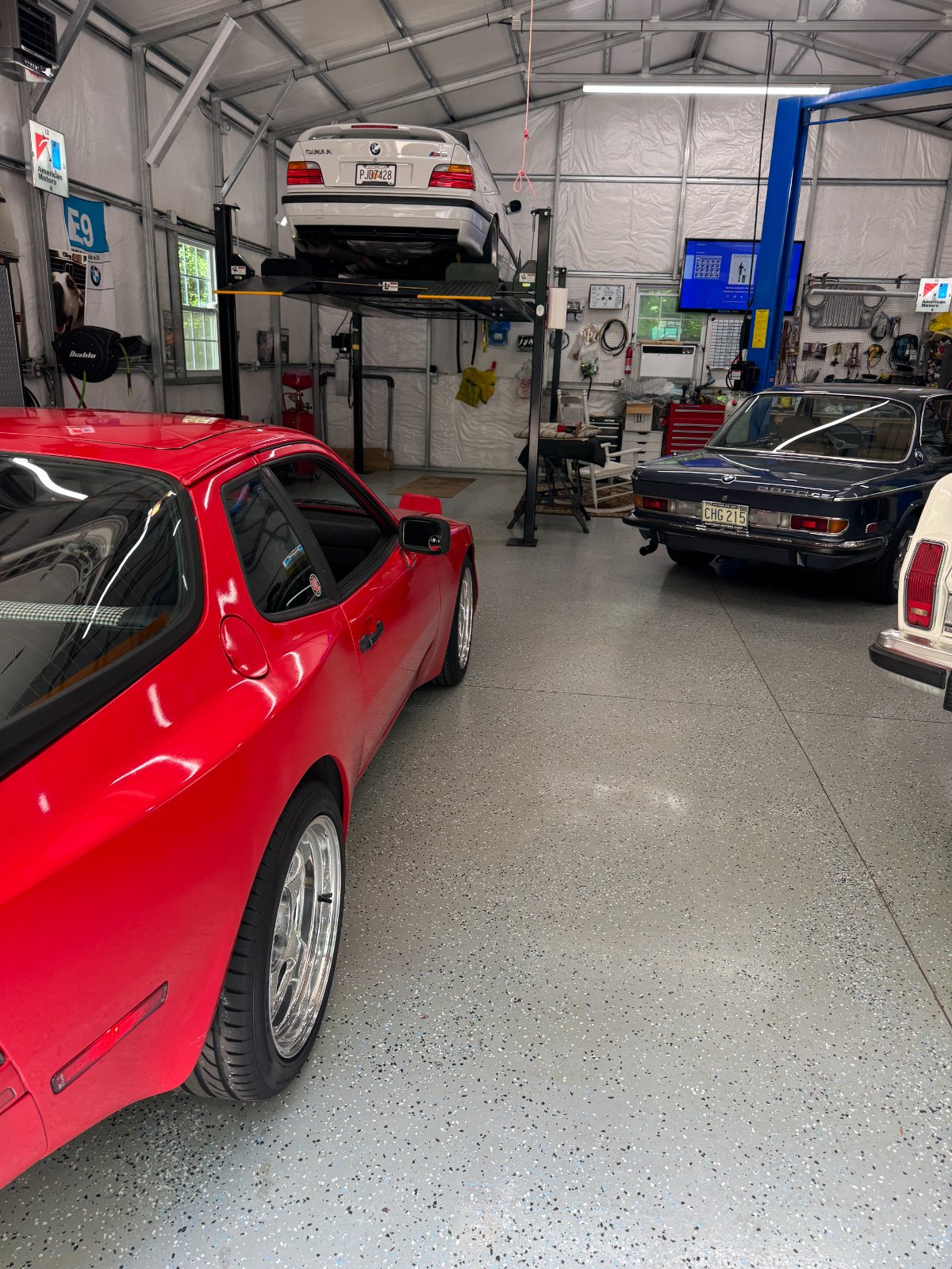

Took the E9 down from the lift to work on it. The radio wasn't working, darn ceramic fuse contact and to check the AC.

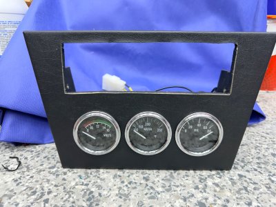

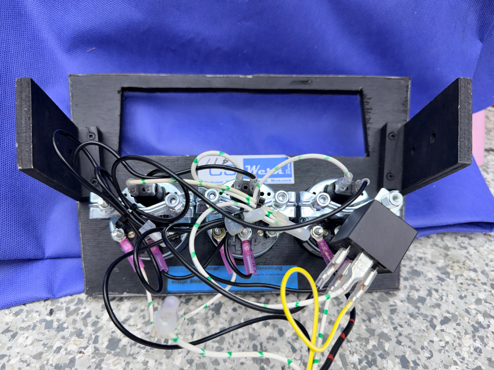

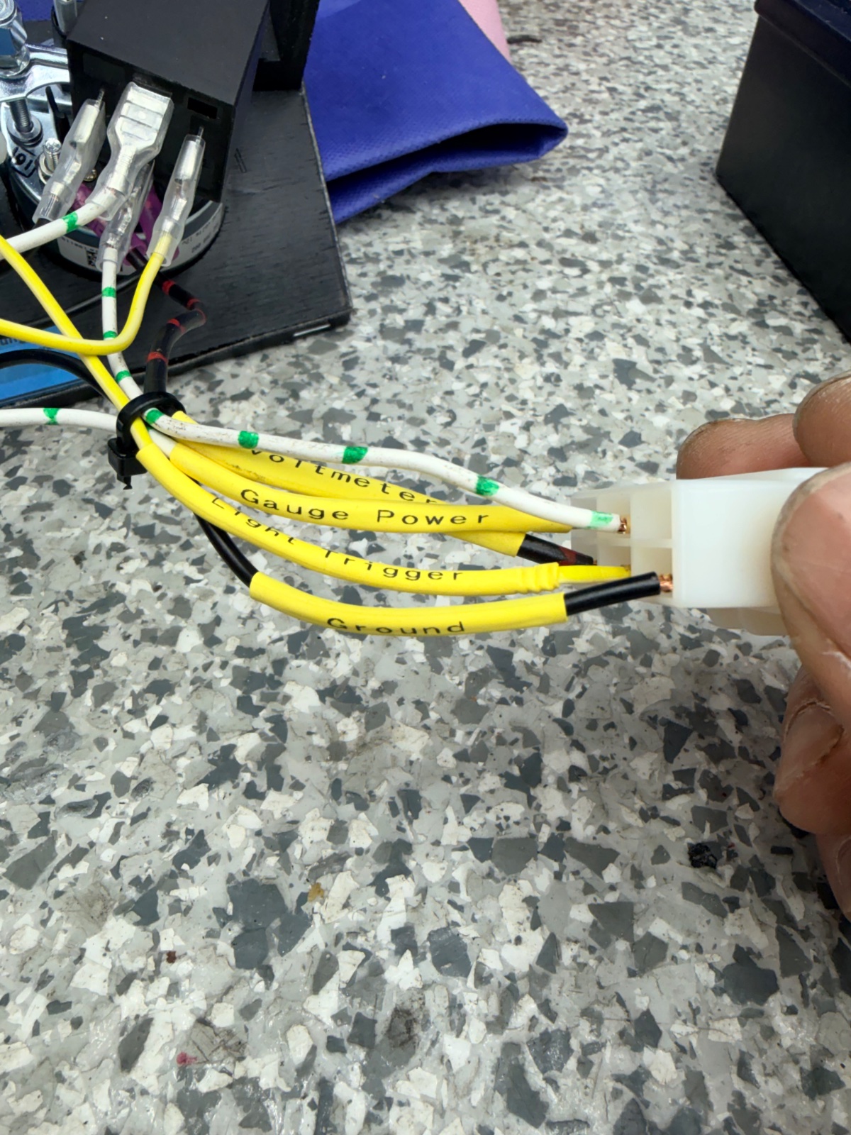

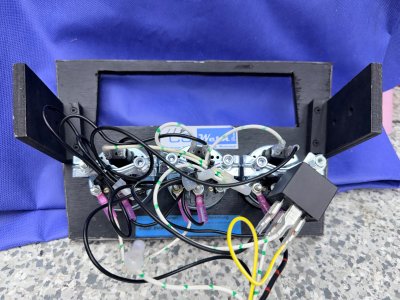

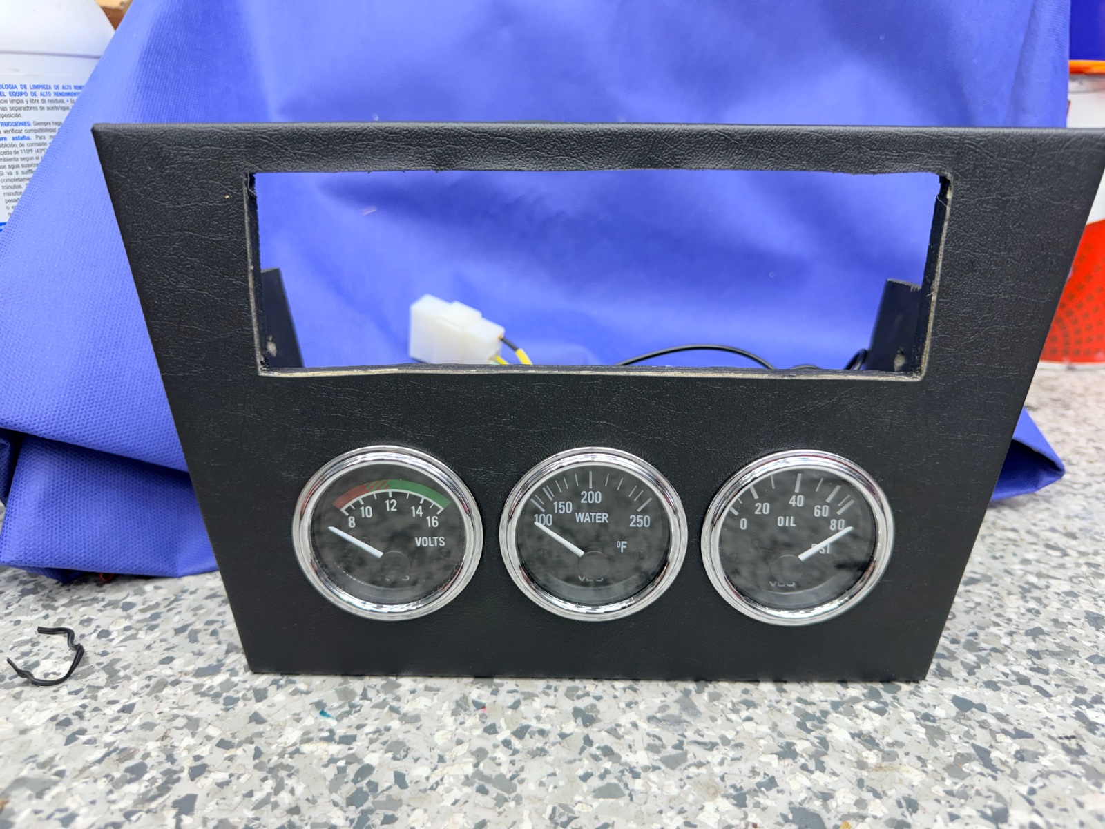

Took some tips from the recent thread in which I had asked for some wiring help and built my 3-gauge panel. I got the panel last week from CS-werk, it’s nicely designed to fit my non-ac car. Slots into the area for the radio and fills the empty space below. I built this to be easily disconnected in the future if needed or to work on it on the bench.
Also gave me a chance to use the heat shrink printer tape. I have been loving this as I’ve been adding wiring since it will help me or someone else in the future know what’s what.
