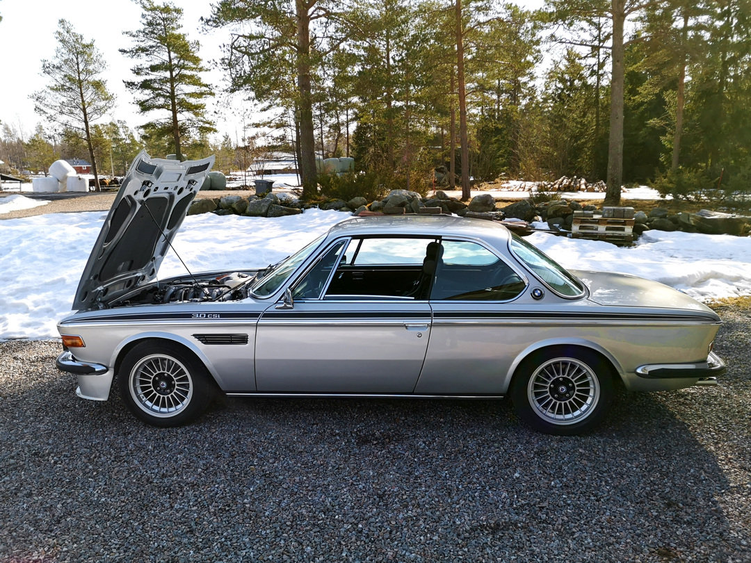

Finally got to breathe some fresh air again, now it's time for pre-season service and overall inspection.
I'm generally not a fan of decals, but that looks really good. In great part because not only does the shape fit real nicely in the space above the belt line but the black matches that of the tires. So it ties the whole thing together nicely.
