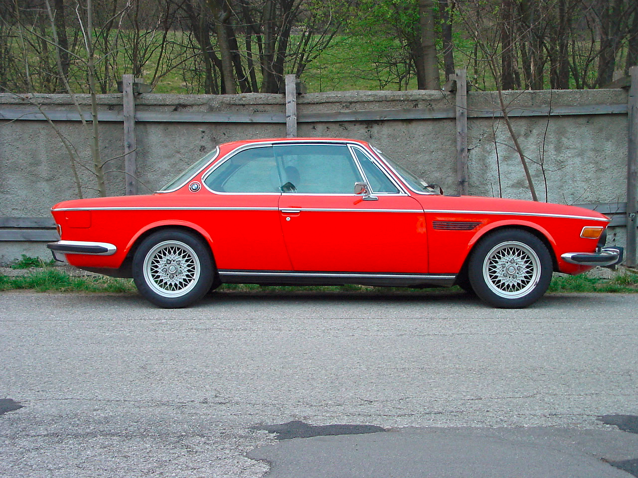

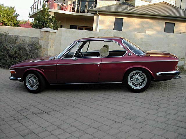

1969 - 1973
FPS 20 Spoke Alpina style
14" diameter / 6" width / ET11

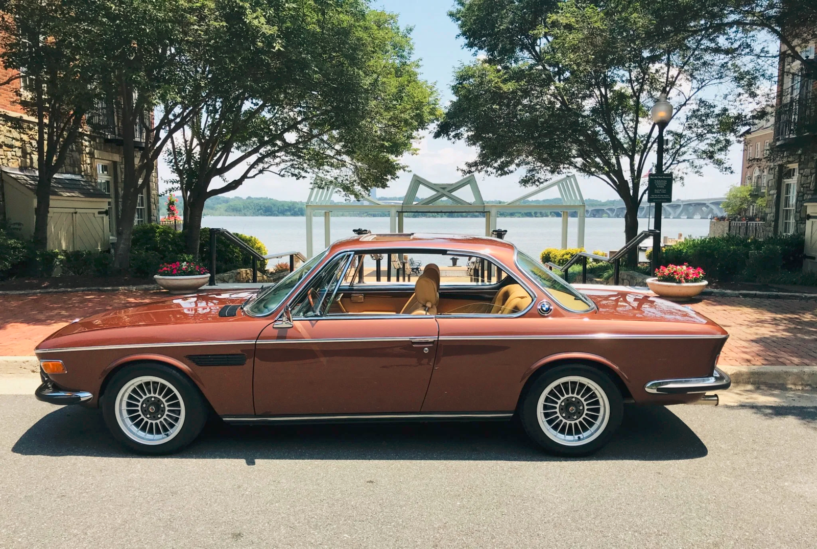

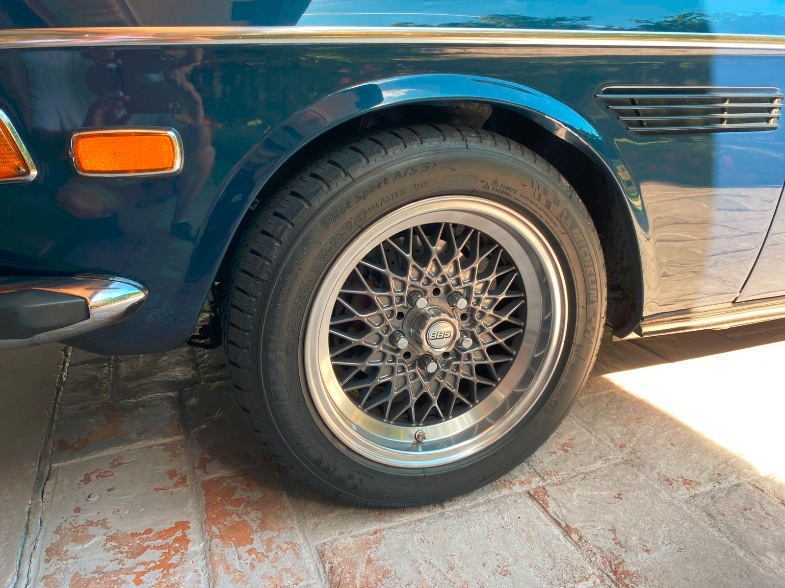

BBS Mahle
14" diameter / 7" width / ET22
<< Note - longer studs or longer lugs are required on e9 coupes due to thicker mounting surfaces of the BBS Mahle wheels >>
ARP 100-7715 - can be purchased from SummitRacing.com

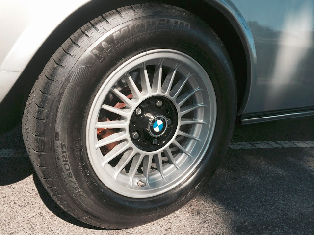

FPS 20 Spoke "Turbine"
e12/e23

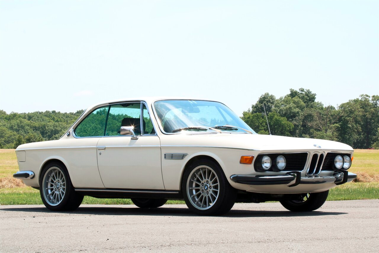

OZ - 'Alpina Style'
15" diameter / 7" width / et
BMW - Style 5 (BBS RZ)
e34 5 series
15" diameter / 7" width / et20

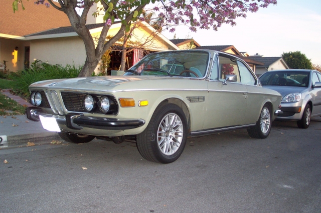

BMW - Style 29
e34 + e39 5 series (may require hub-centric rings and 5mm to 8mm spacers)
15" diameter / 7" width / et 20

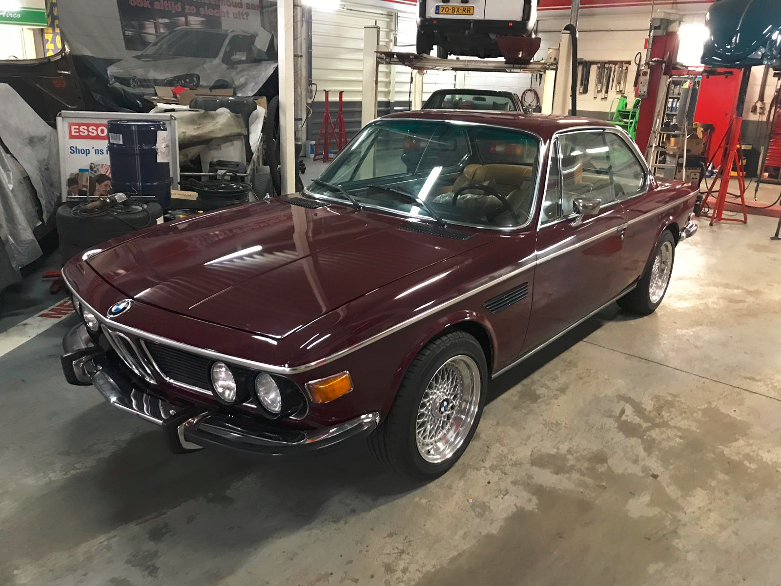

BBS RS
3 piece wheels
(Front - RS 005) 16" diameter / 7" width / et 11
Tire Size - 205 / 55 - 16
(Rear - RS 006) 16" diameter / 8" width / et 24
Tire Size - 225 / 50 - 16

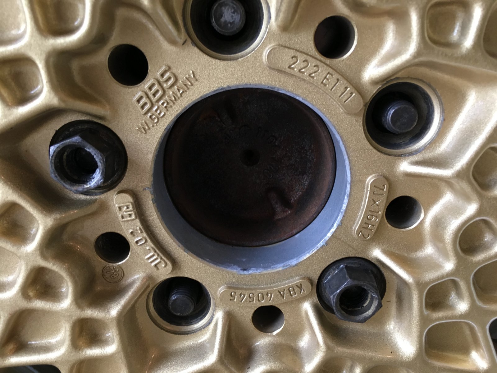

BBS Mahle

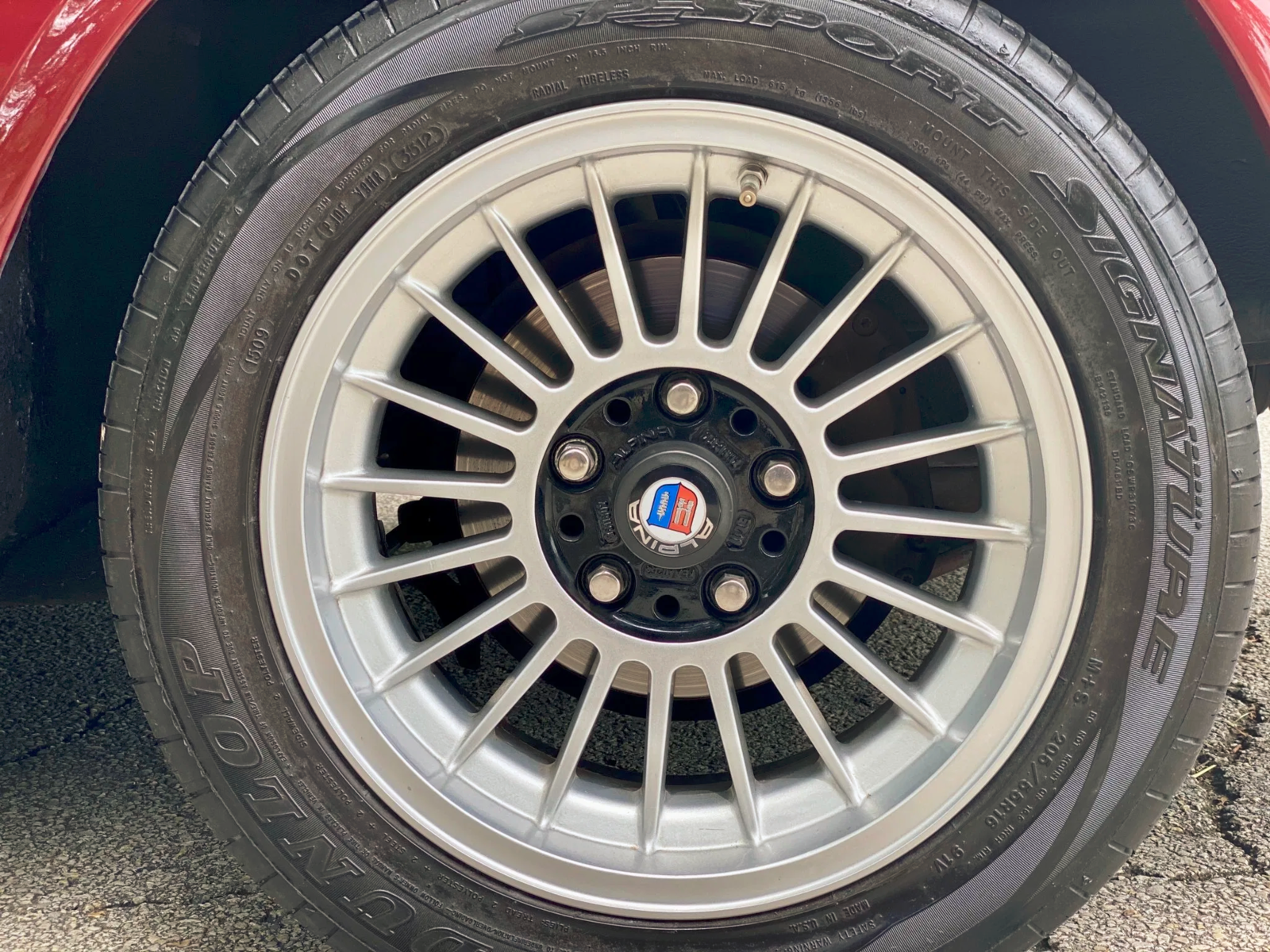

Coupeking Alpina
(Front) 16" diameter / 7" width / et 11
(Rear) 16" diameter / 8" width / et 24

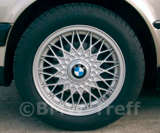

BMW - Style 5
e28 M5
16" diameter / 7.5" width / et20

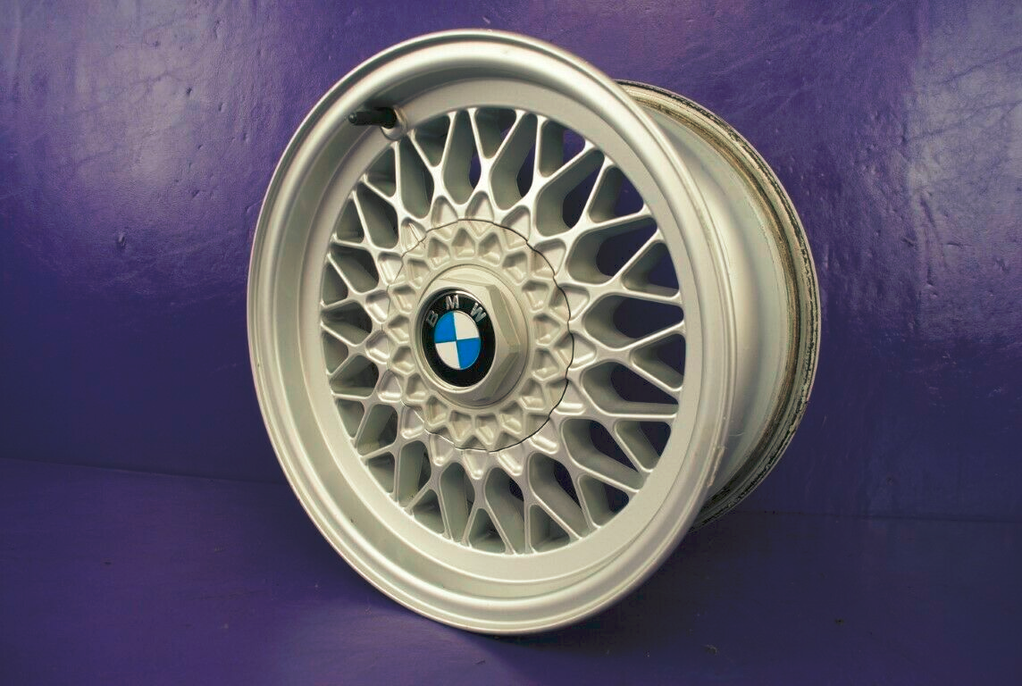

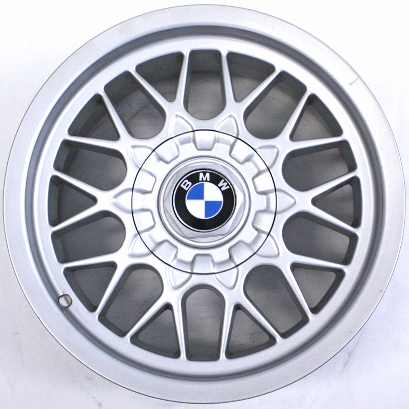

BMW - Style 29
16" diameter / 7" width / et 20

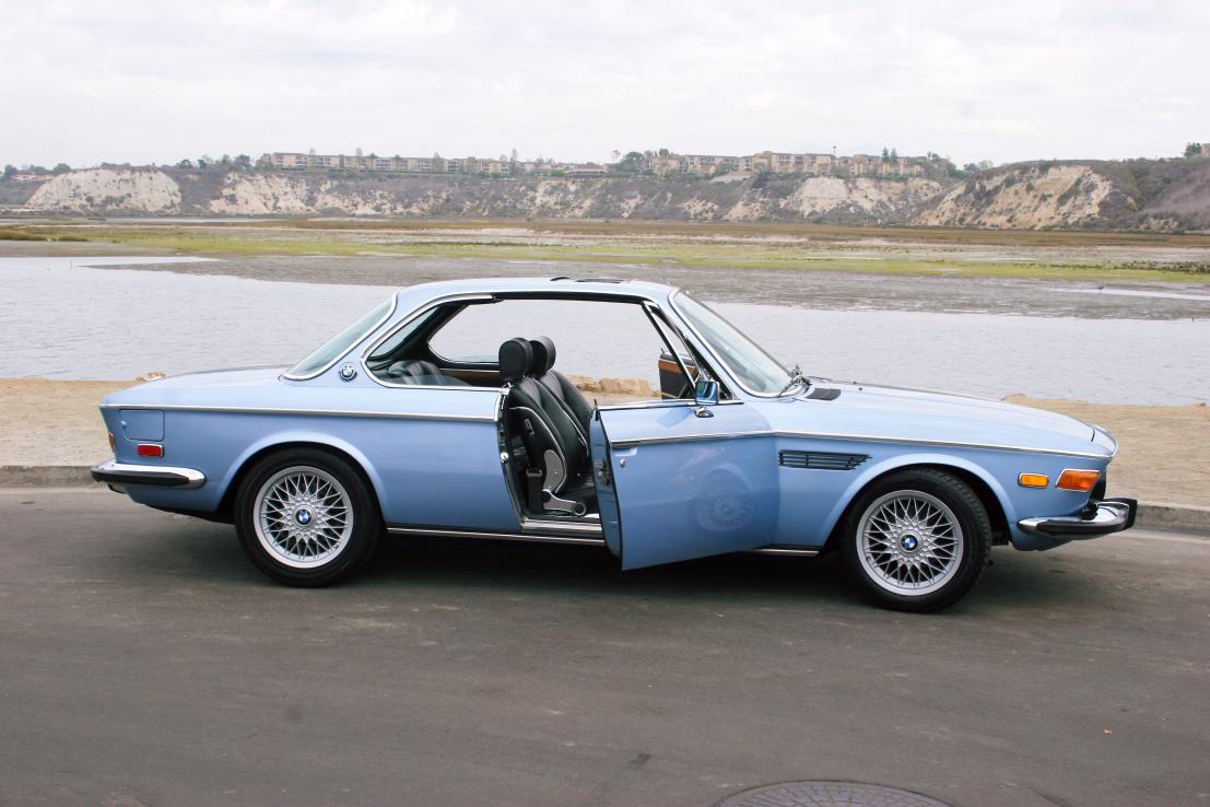

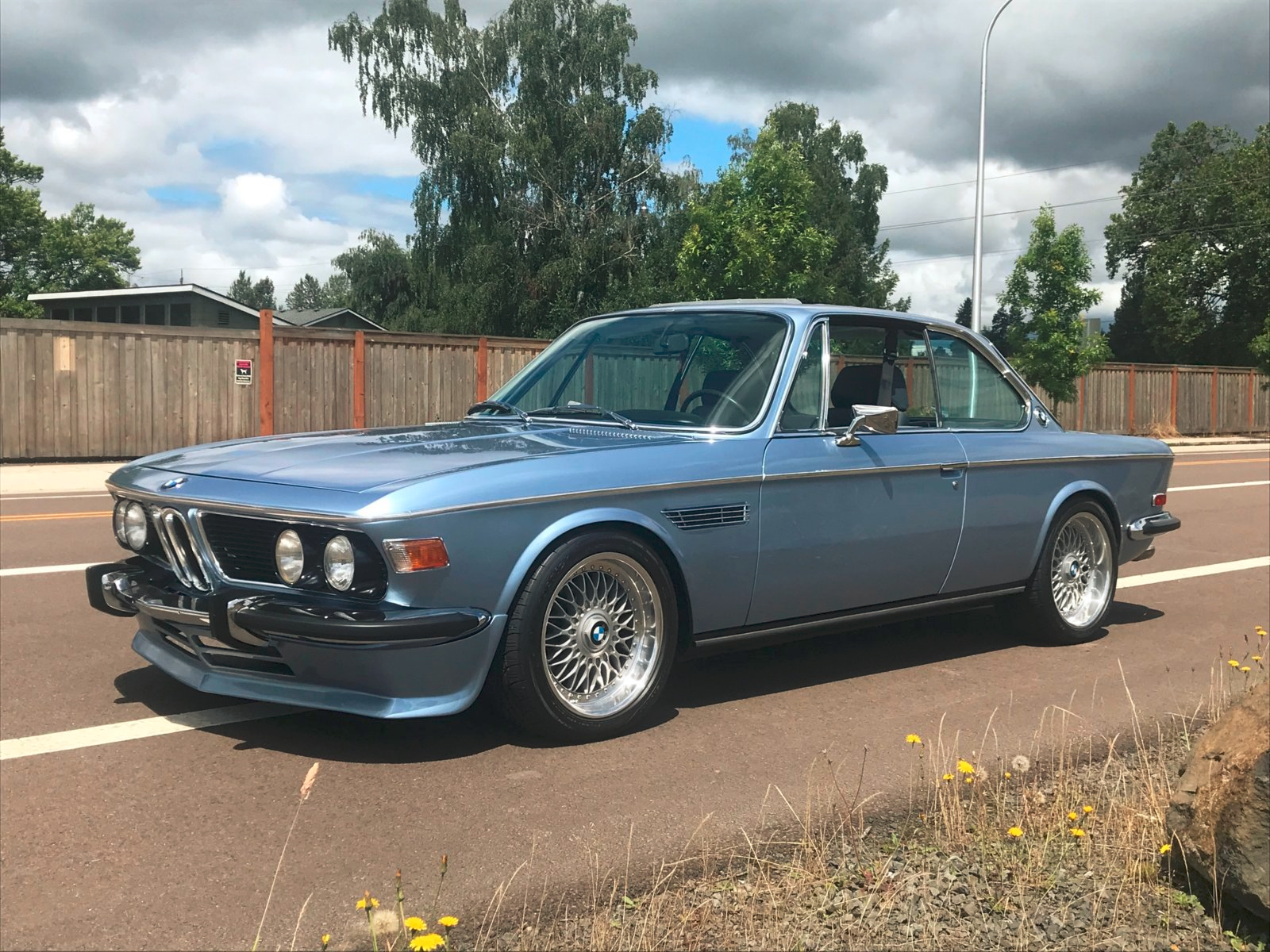

BBS - RX
various sizes + widths

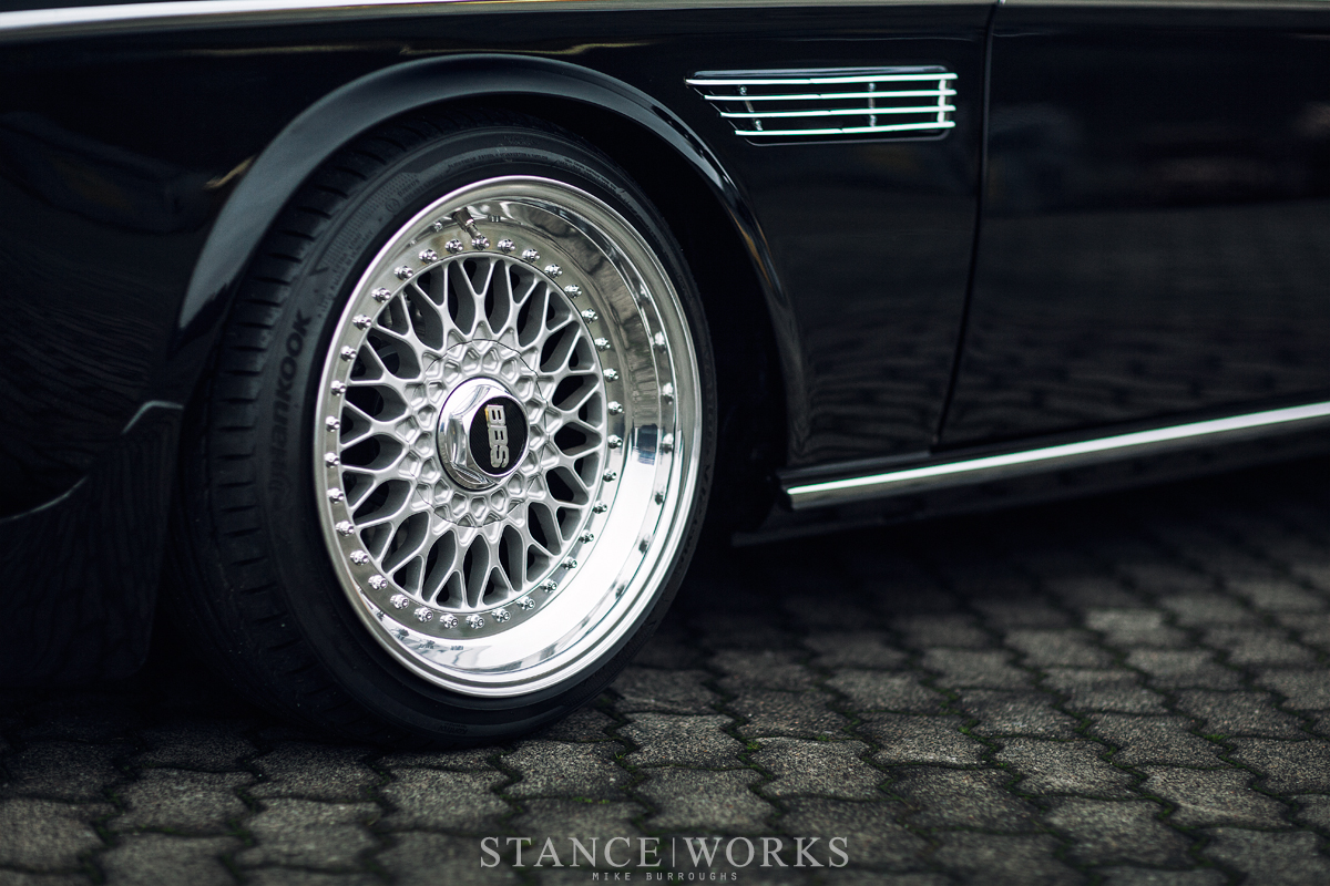

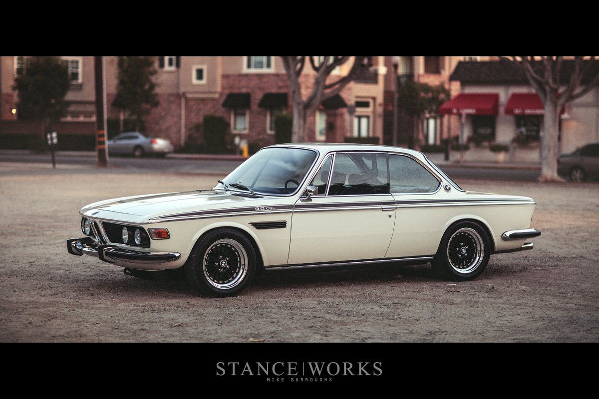

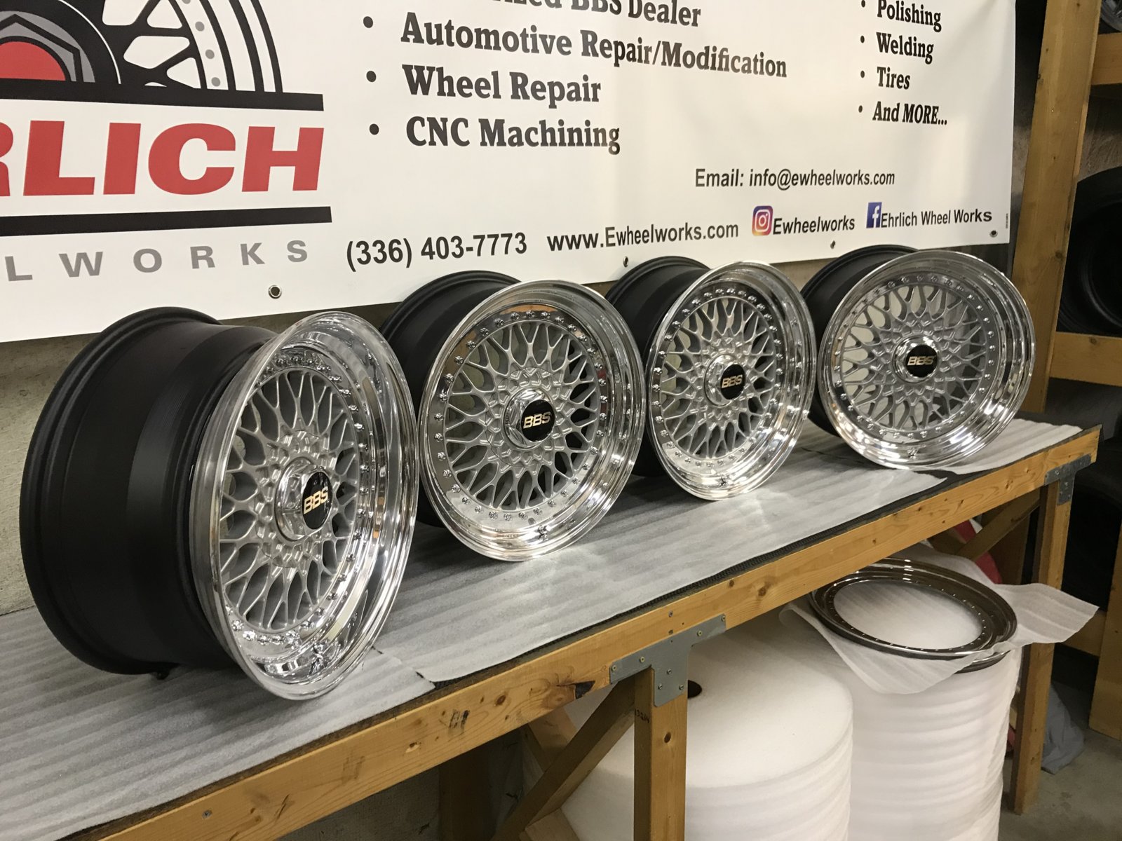

BBS - RS
(3 piece wheels - may require spacers - the face sizes can vary, some use larger faces with single step lips, others use faces from 16" wheels with double stepped lips)
See BBS RS model information below in separate post
<< custom widths / offset are possible >>

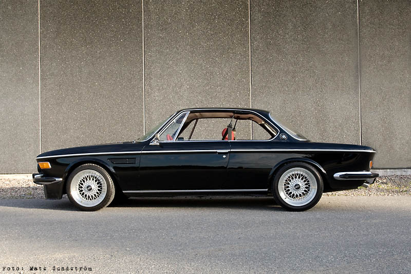

16" face with double step lip
<< 17" with single step lip from Ehrlich Wheel Works >>

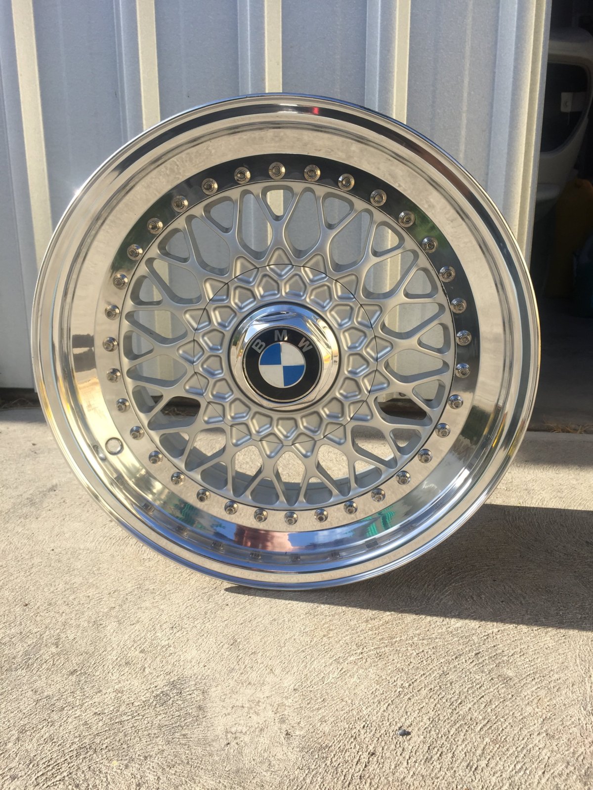

BMW - Style 5
e39 5 series (2 piece - will require hub-centric rings)
BBS RC090 - 17" diameter / 8" width / et20 (may require 5mm to 8mm spacers)
BBS RC091 - 17" diameter / 9" width / et26 (optional staggered rears)

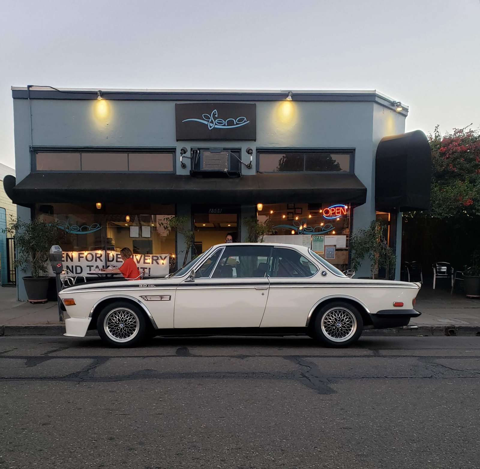

<< this wheel has a custom RS cap - from Ehrlich Wheel Works>>
this coupe is running 8" fronts with 225/45-17's and 9" rears w/ 245/40-17's. no spacers but all fenders are rolled.

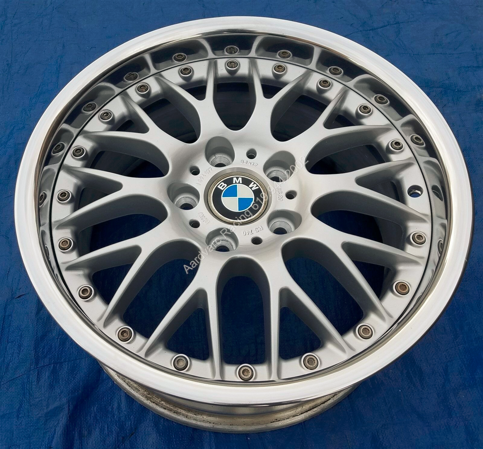

BMW - Style 42
BBS RS740 - 17" diameter / 8" width / et20 (may require 5mm to 8mm spacers)

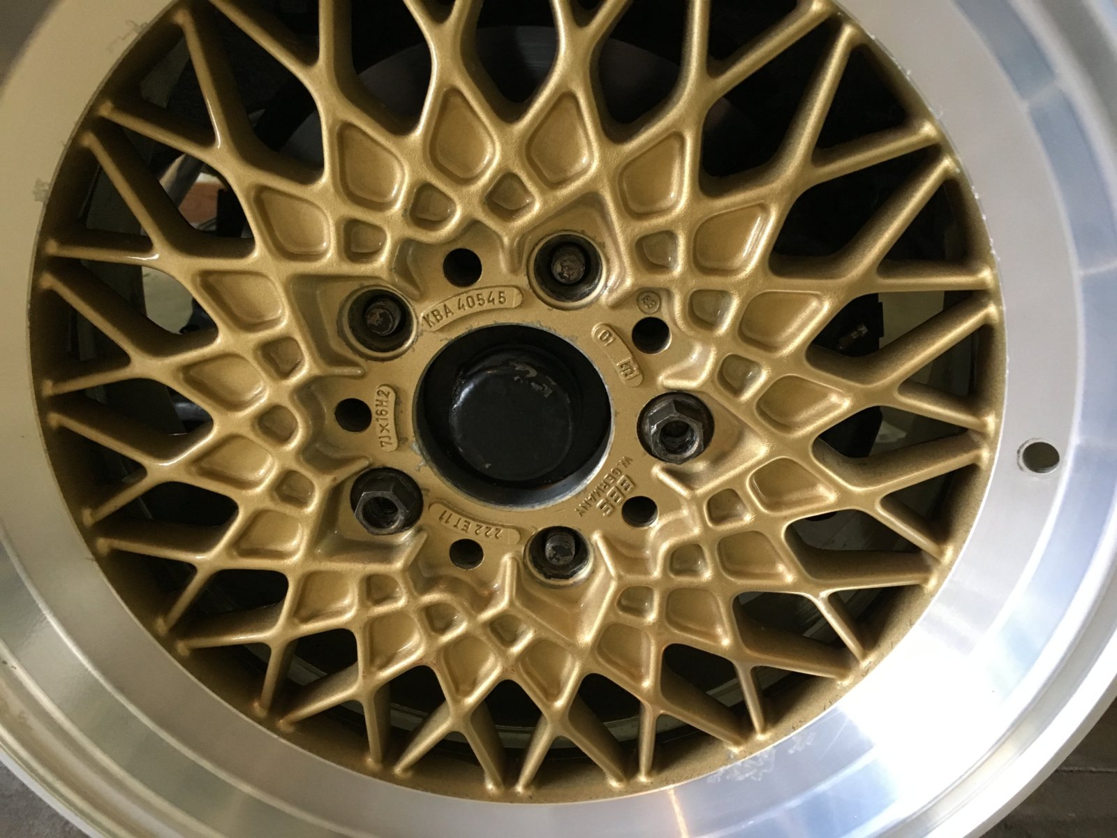

Here are the pics I sent to Victor of the BBS Mahle wheels 16X7" ET11 on the original lug studs. Thought you could use them with this wheel FAQ.

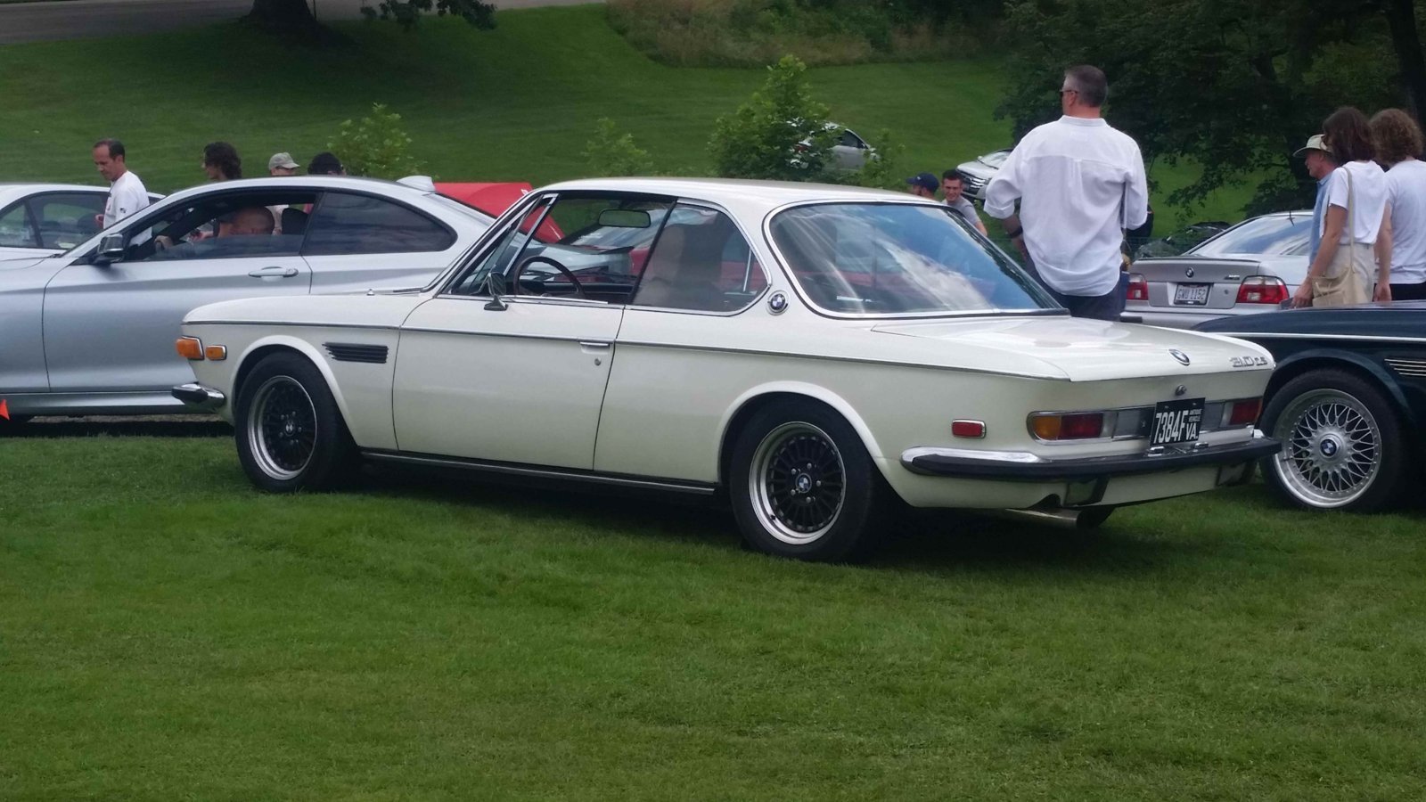

New 205 tires are too small for the car and the wheels are all wrong for an "L" but they don't look half bad. These are 15X7 ATS , not sure what the offset is. Tires were 225/50 15s all the way around with camber plates maxed out and cut springs. It's low....
@tferrer - 225/50-15" tires are almost 1" in diameter too small - only 23.9" diameter. here are the recommended sizes in 15" which more closely correlate to the 24.7" diameter of the 195/70-14" original tire
205/60-15 -– dia. 24.7”, width 8.2" / tread width 6.8", circ. 77.6”, rev / mile = 842
215/60-15 -- dia. 25.1", width 8.7" / tread width 7.3", rev / mile = 827
225/55-15 – dia. 24.7”, 77.7” circ, rev / mile = 842 <caution - tire is 9" wide - not many tires available in this size>
There's no performance tires and more importantly, there's no wheel well space for that diameter. The springs were cut. Like I said, it's low. It'll go back to a more normal height in a bit...
