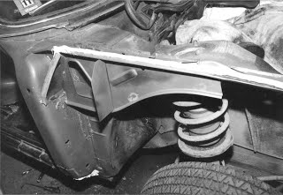

think i found some pic... i miss some plates there :(
Barry,
looking at the pics from your previous post #35 (missing inner fender pieces) these are the parts that have gone "missing in action" in your car. I would think that they are quite essential for the integrity of the car, as the largest of the missing parts is holding up one side of the plate that mounts the strut.
41/02/09 should be in the left upper corner of the wheel house, above the splash shield that Steve has in his hands in post #36.
41/03/04 should be vertically mounted, with the thin end pointing to the front.
41/03/00 is the part that goes ( I think horizontally) between the 41/03/04, the a pillar, and the strut mounting . it effectively creates the bottom of the box that catches a lot of sand/water/dirt etc through the opening in 41/03/04.
Mind you that in the black and white pic you posted, there is a vertical part shown, that was invented by someone. It is not supposed to be there. Probably hand made to keep sand and stones filling the cavities up there.
Secondly, another part seems to have been invented by the previous owner. I think that the strut mounting is welded to a self fabricated vertical piece that sits where 41/03/04 should be. The 41/03/04 should also be welded at it complete top edge to the inner fender. The self fabricated piece just extends upwards to a short flange; it is not as strong as OEM construction.
I wouldn't drive the blue car like you likely drive your rally car. I would think that if you hit a pothole hard enough, that your strut would bend out of location as it is only 75% supported...
i'll try to dig up a better pic of a correct assembled car.
