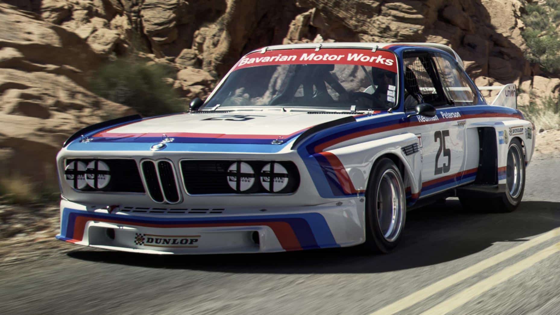

Perfect candidate for a CSL Batmobile Group 2 or whatever project.
e.g.:
now Rob, are you kidding ? building that car "copy" would need al least 50k...to be somewhere .. starting from a good E9 ! i understand dreams... but in the end the final invoice stays the same :D
I honestly think the most expensive part of this will be finding wheels to fill out those flares. I could be an awful human and get some "custom" diamond/bassett steelies up to the sizes needed for very cheap to get it rolling while I source parts for "real" wheels. Otherwise I'm looking at 1600ish for the group4 fenders/front bumper, another 1000 for the tail section of it, and a couple 4x8 18g sheets of metal and a LOT of time. I'm picking up front/rear subframes from an e28 going to the dumpster from a local guy for fairly cheap that I'll likely use for the more modern differential choices and the ability to not use a diverted shock/spring.
