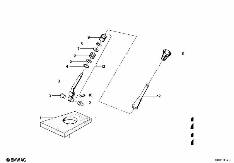

Still slow with the reassembly as everything is quite complicated.
Basically now it's interiors time but I don't know if the gear lever needs a rubber boot or not:
For sure there was not any rubber boot in my car but it was already used as parts car so I don't know if it's missing or not. Any clue?
FGS
156
28
Milano - Italy
Yes Andrew, I've seen that the ZF has a rubber boot and I wondered if I miss it. So no rubber boot?

There is a rubber boot that goes over the gearshift stalk from the interior side. It is used to keep all the fumes out of the car. The original boots are pretty flimsy. On my car I used a CV joint boot as it was a little more substantial and I think did a better job. I forgot which size but it was from an older VW.

There is a boot that goes over the linkage in the car as per Peter Coomaraswamy. The boot you want is on another BMW illustration.

Unfortunately that boot is made of unobtanium. Is there anyone who sells it?
Thank you Peter!

On my car, which is a '72 CSi also, I have a leather "sealing" boot, available from BMW. Try P/N 51161810752. Looks a lot better than a rubber one and works just as well
FGS
156
28
Milano - Italy
Thank you!
