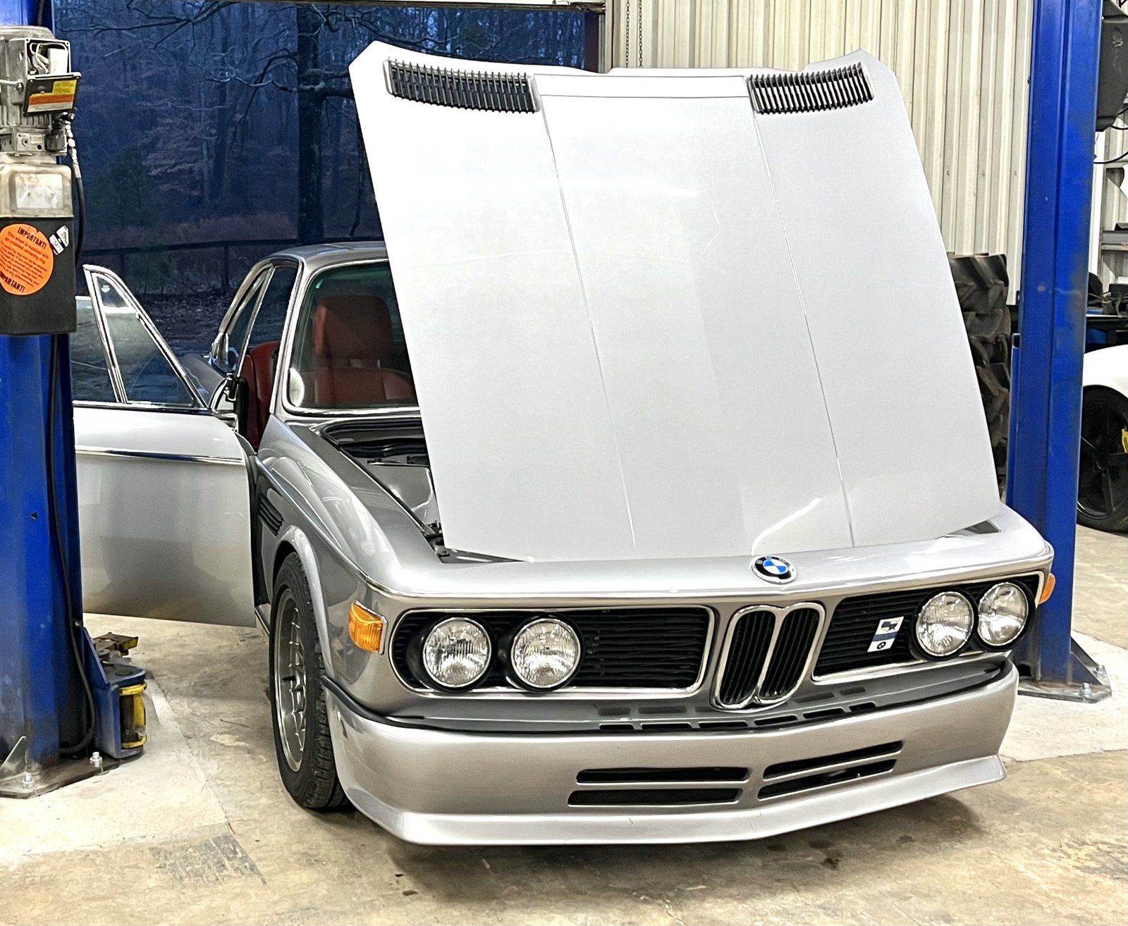

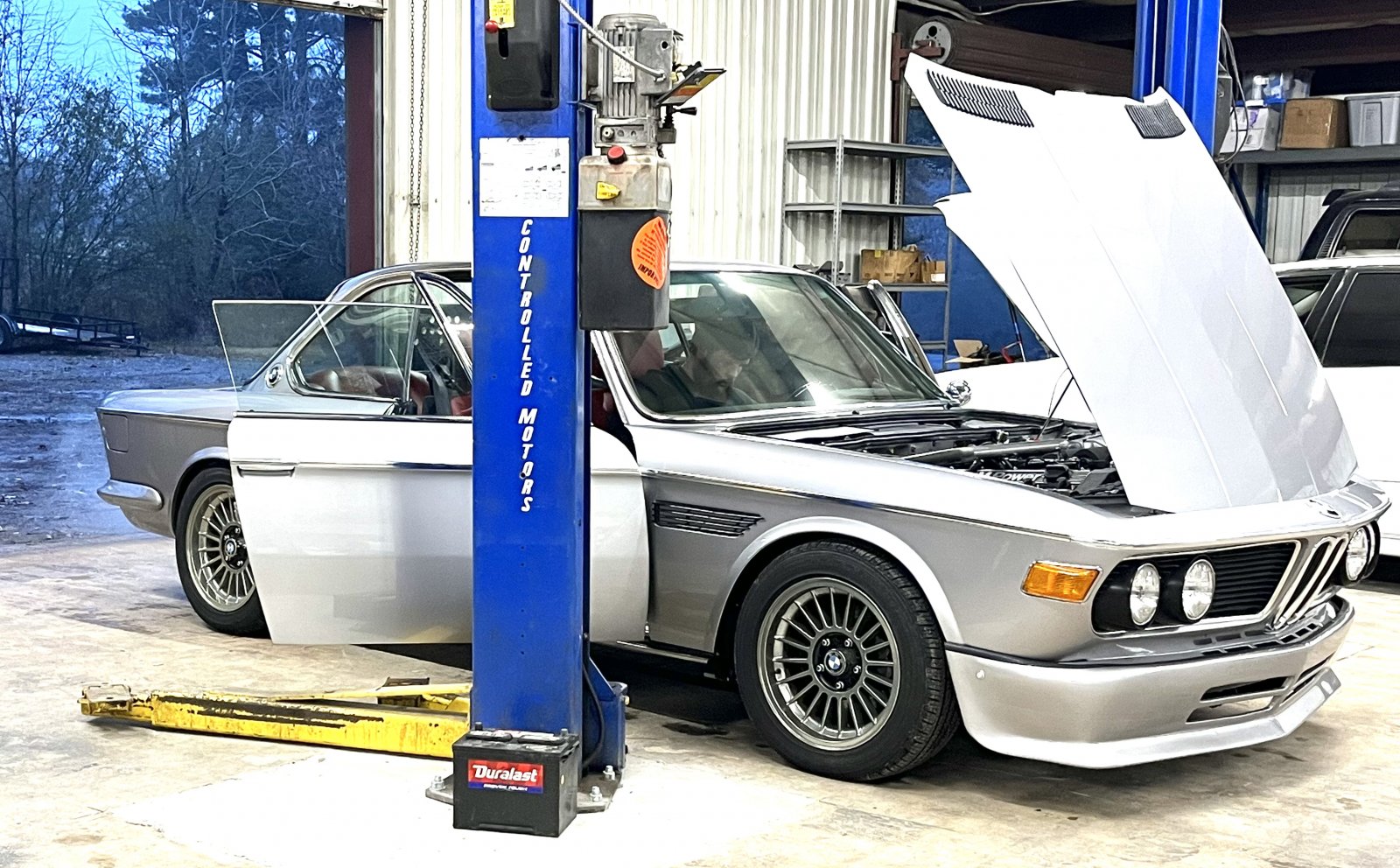

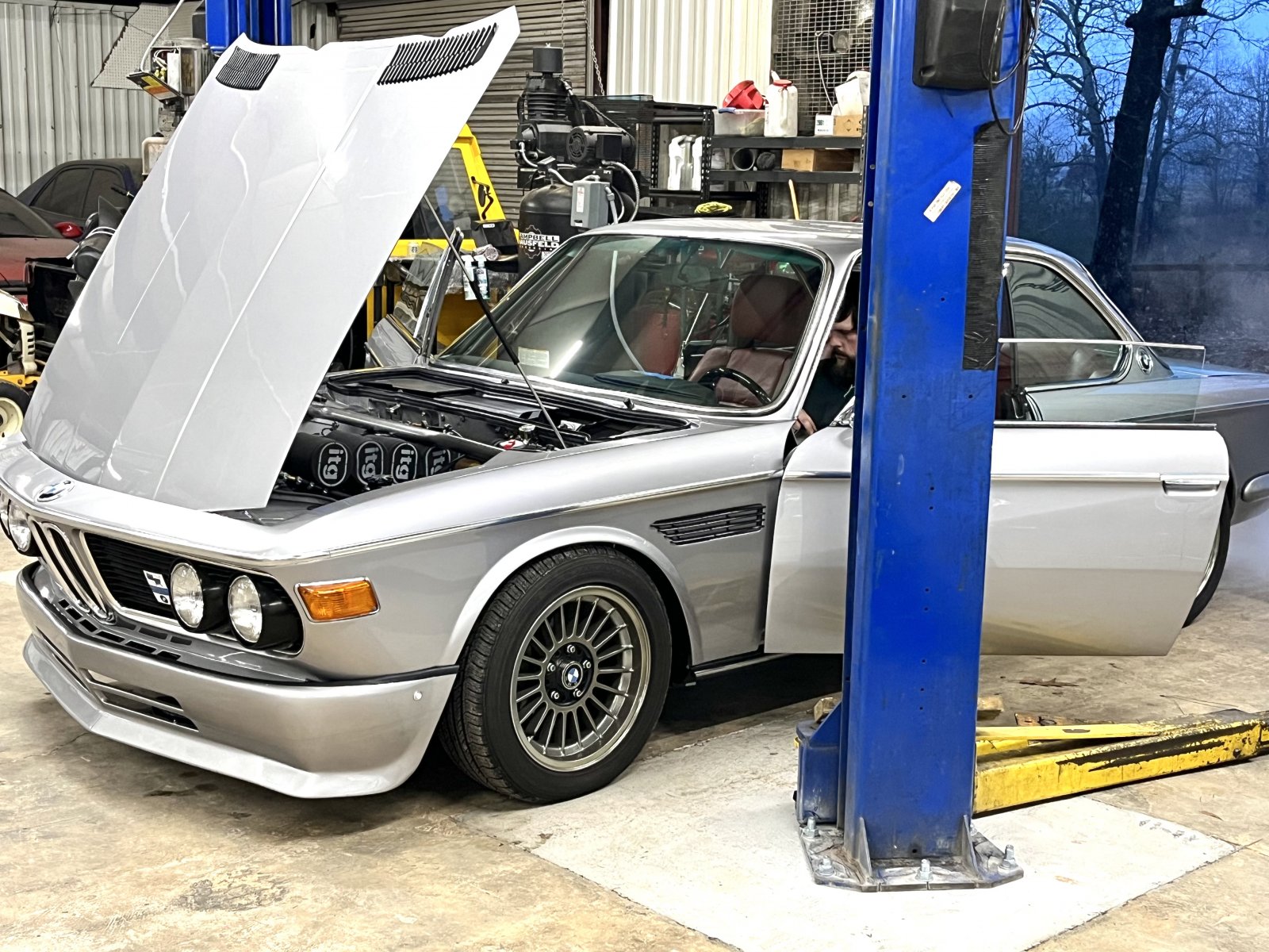

The car has a M88 /European engine from an M635 car.
The conversion was done with a Megasquirt injection system. An E30 wiring harness was used to signal the engine.
We are still tuning the engine for performance.Unfortunately I don’t know how to do the tuning and it is only, say, 80% correct.

Dyno run is complete.
The 38 year old M88 engine put down just shy of 250hp and didn’t miss a beat.
I’m so relieved. Tuning will work great for driving the car on and off of the trailer to go to events.
