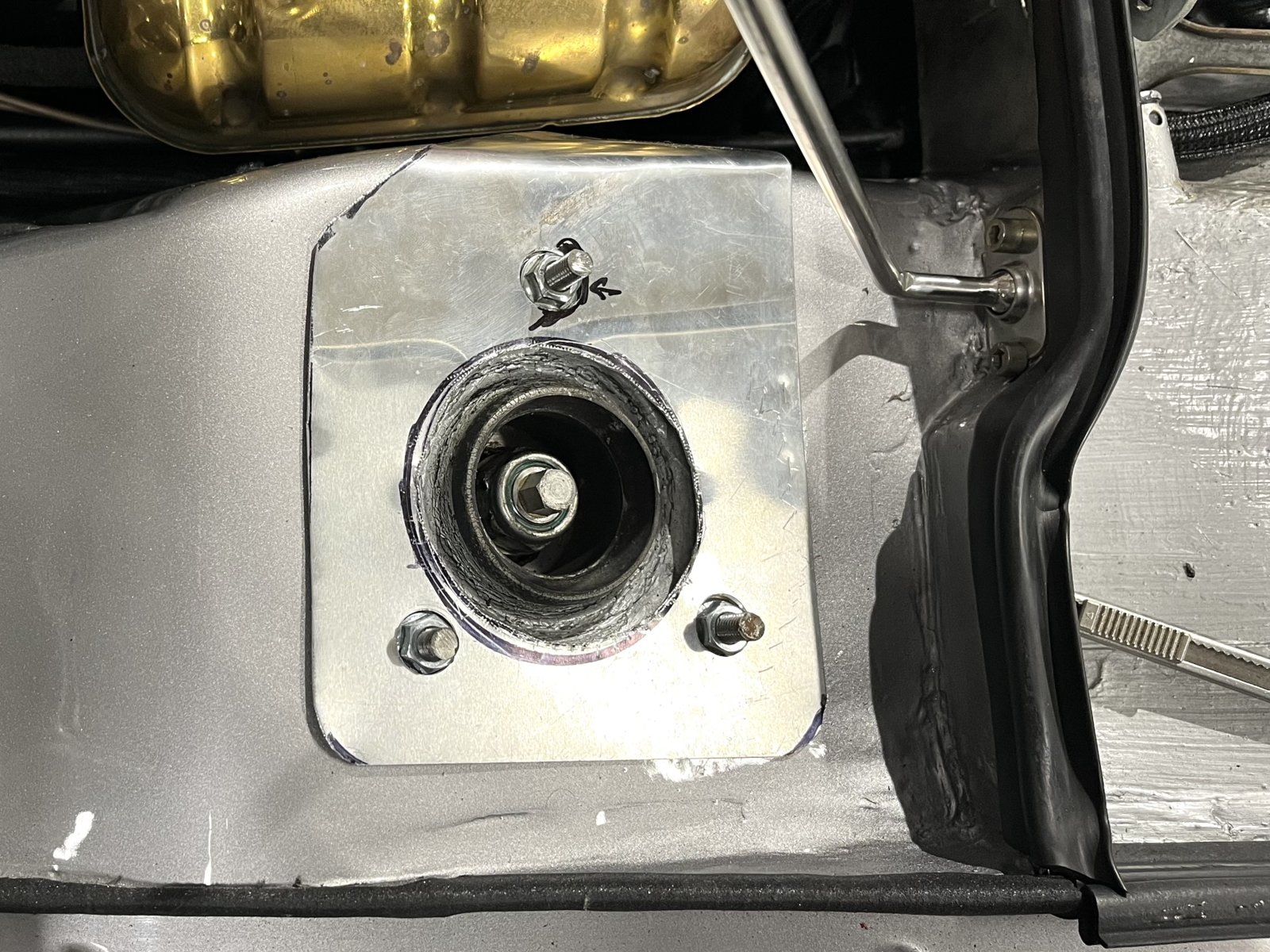

Next up, fabricate a cost-effective strut bar.
The one lying in place is a sample from an E30.
Mock-up plate. The final part will be made of thicker aluminum or stainless and welded to a crossbar to a plate on the other side.
RP

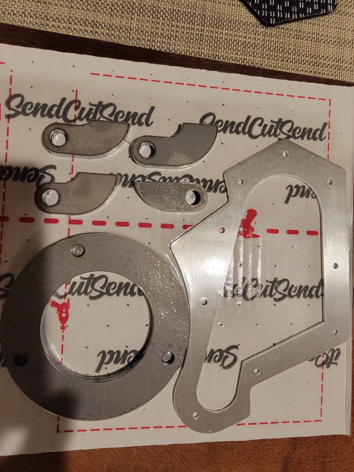

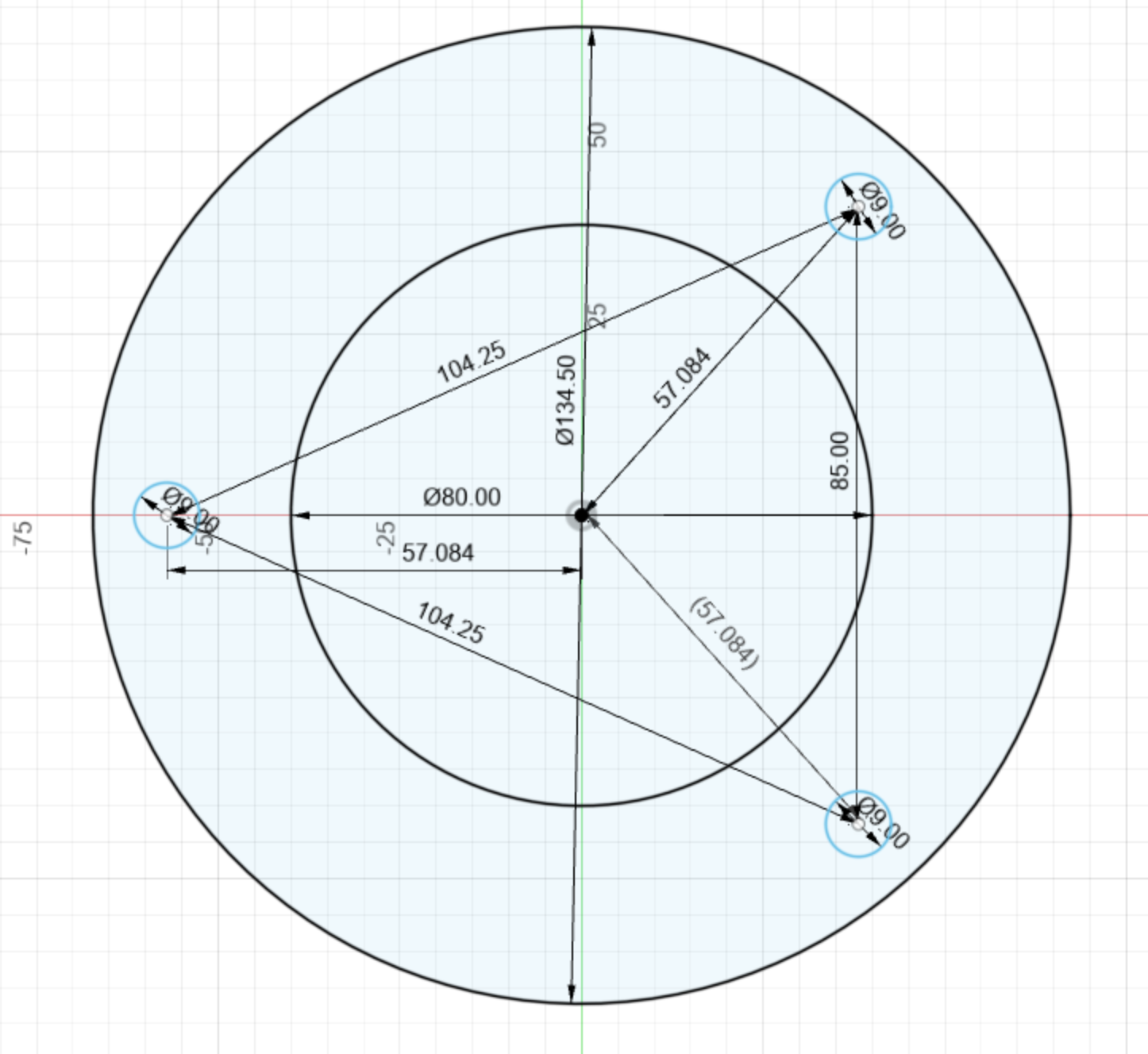

If desired, I drew up shock tower plates in CAD. Already had a pair cut out of steel for my battery box braces. Happy to share the file if it helps. Or, here are the dimensions:
View attachment 136739 View attachment 136740
Thank you for the offer,Jeff.
Thank you for the offer, Jeff.
My local metalworking dude has the redneck template and we are already off to the races.
