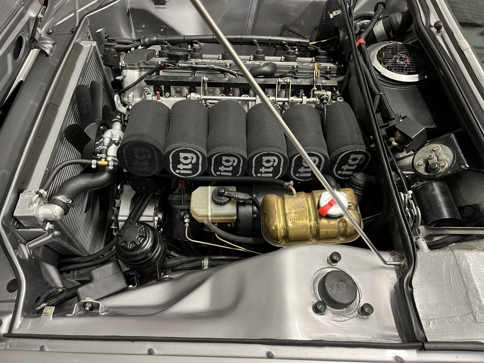

Mega-squirt tuning is too lean.
One step forward, two back.

How can you have Megasquirt too lean?
Change your VE table.
Link me your data log.
Did you auto tune?
Link me your AFR table…
Send me your data log and msq please.
SFDon, thank you so much! I sincerely appreciate your offer and support.
I am as computer-literate as your pet beagle.
Seriously, I'm doing good to post pictures on this forum. I do know how to swap parts and push sandpaper across bondo and high-build primer.
This weekend my buddy and I will do this thing one more time, and I'll share your offer with him.
We had it running acceptable and then the battery went out. Lost what had been learned. (Does that sound correct? Remember, I'm just a dumb beagle.) Replaced alternator brushes and at the next start up it just stayed lean. Removed injectors, cleaned, new filter (a little bit of trash flowed from the backside) bigger battery...so we will see what happens.

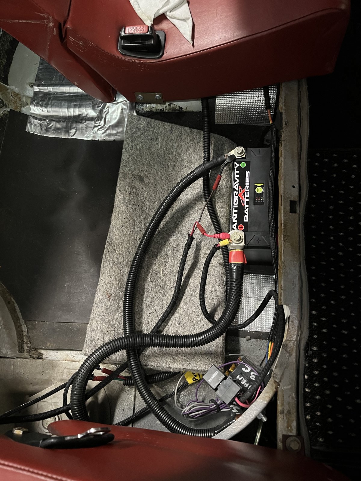

Sense I welded the door lock holes to make the doors “slick,” I thought it might be good to put a battery cut off switch underneath the passenger side rear seat.
Not that that would keep the car from being stolen, but it is a nice way to turn the battery off when the car is not active.
Connect to negative terminal, reattach the vertical carpet piece on the outside, attach on/off handle, clean up and it is done.

Scrapped the lithium batteries and added two AGM batteries in parallel under the rear seats.
