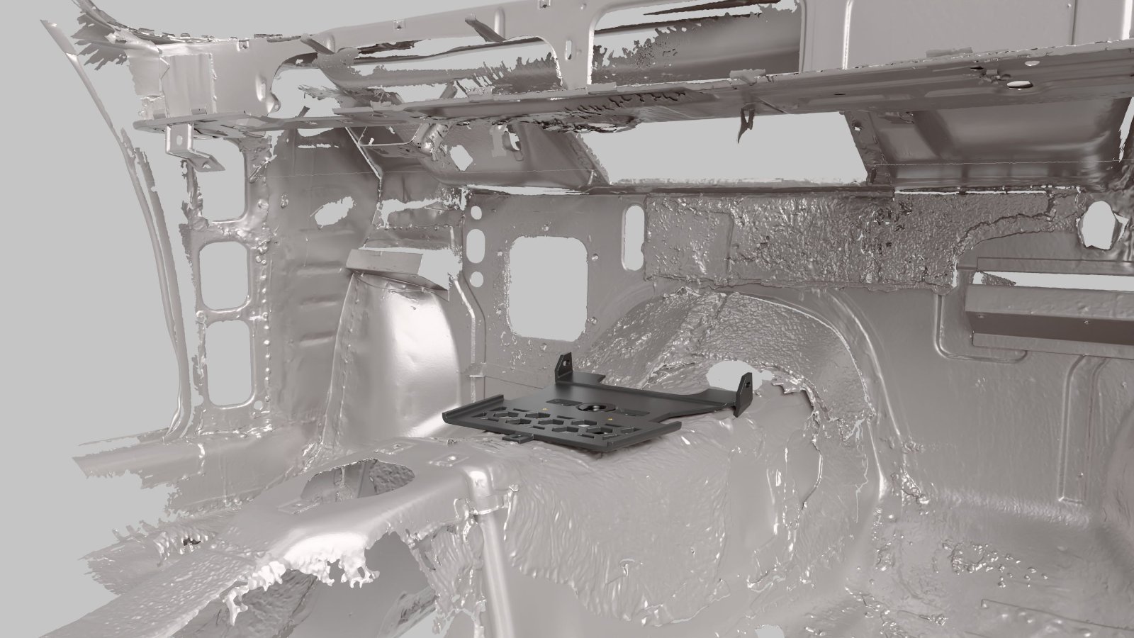

Do you have a bracket for the compressor?
Yes, we have designed a new mount for our compressor from scratch, and it will be CNC and laser-cut next week
Tomorrow marks the official launch of the new, updated full air conditioning system, complete with a detailed description; to mark the occasion, we are hosting an exciting contest with attractive prizes.

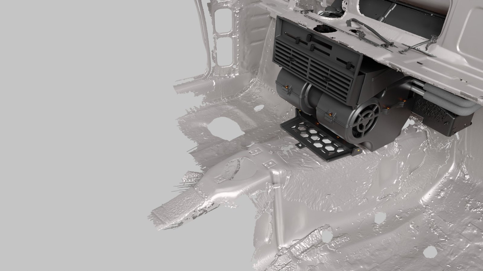

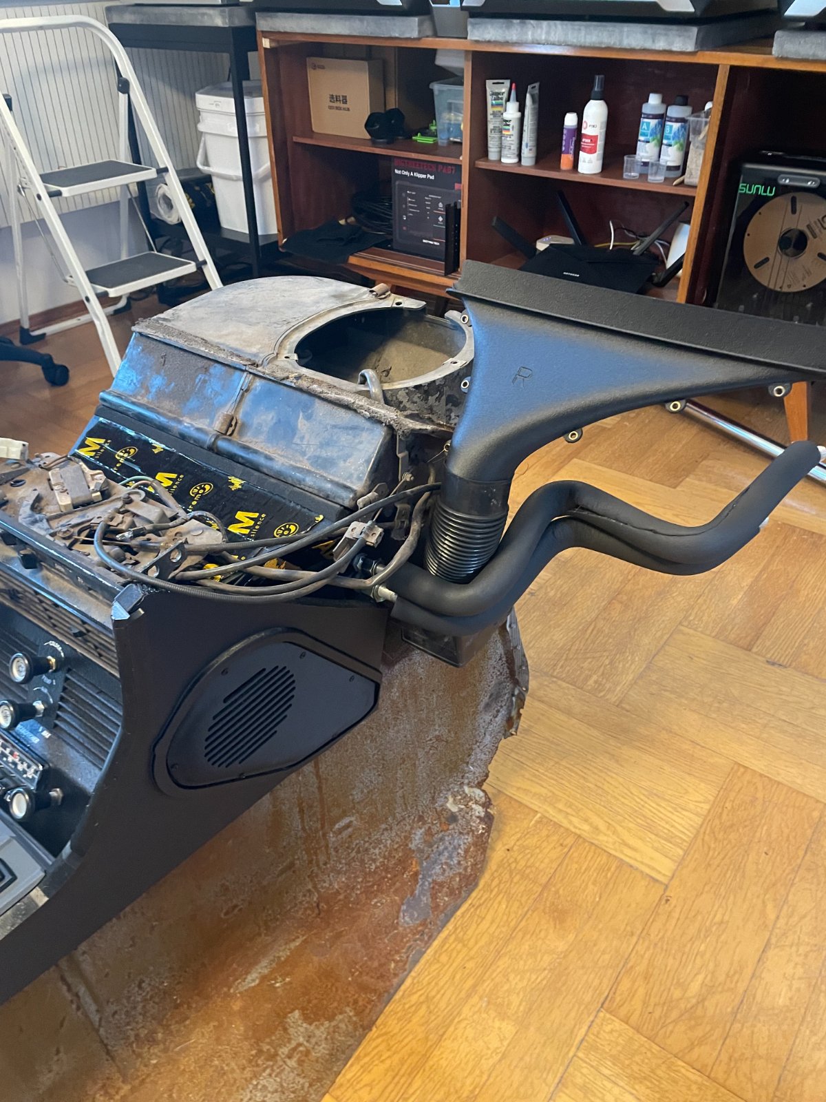

The first photo shows a complete air conditioning system removed from a BMW E9.
It took me nearly 5 years to assemble the set shown in the picture, and in the end, it turned out that one of the key components—which I had purchased believing it to be the correct one—was actually incorrect; and, in fact, completely wrong...
One of the major surprises we encountered—which caused us some trouble (thank goodness for modern technology!)—was the air conditioning evaporator base.
It might seem like a trivial detail, but it turns out to be crucial for a proper installation that won’t lead to further issues.

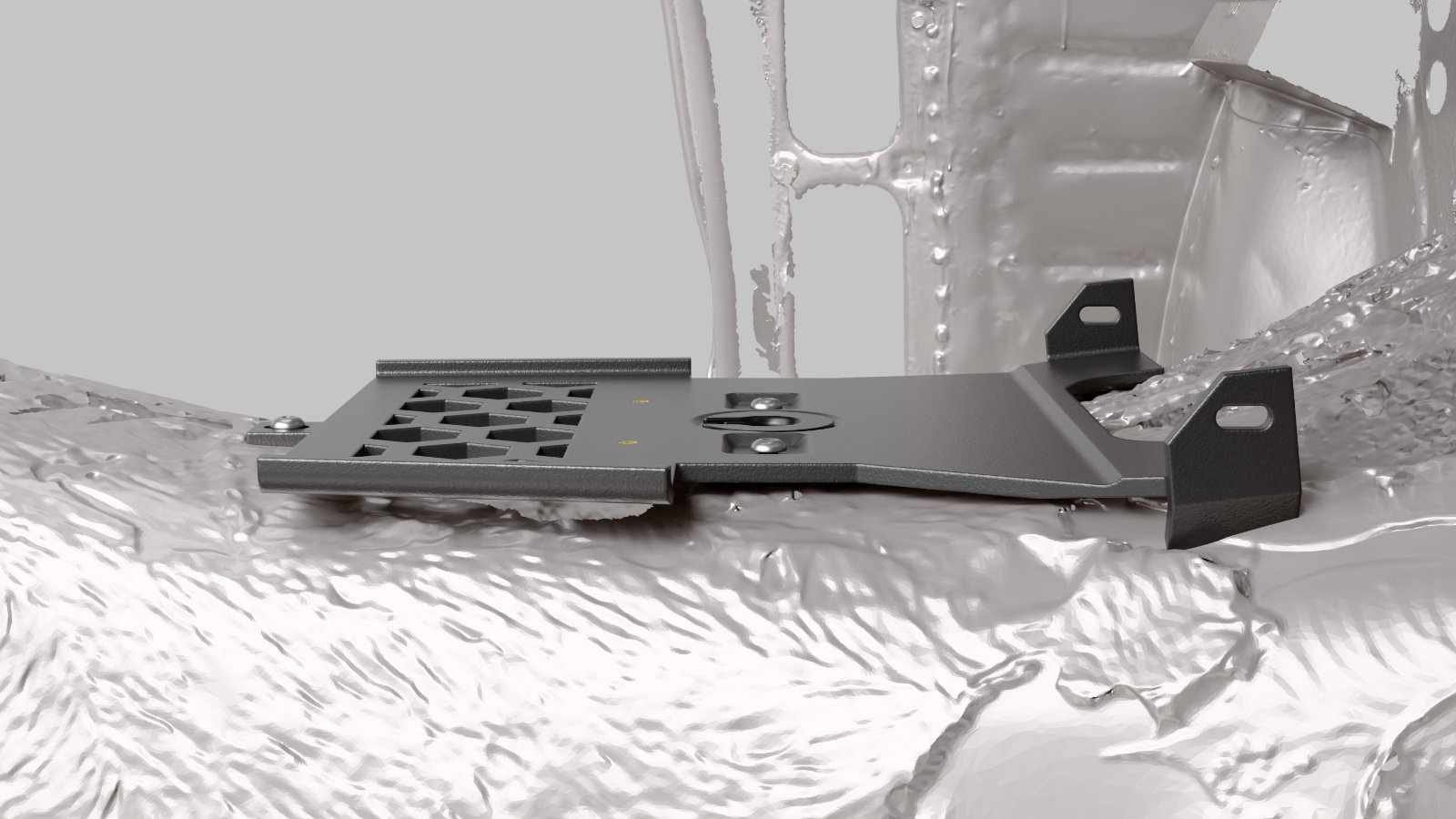

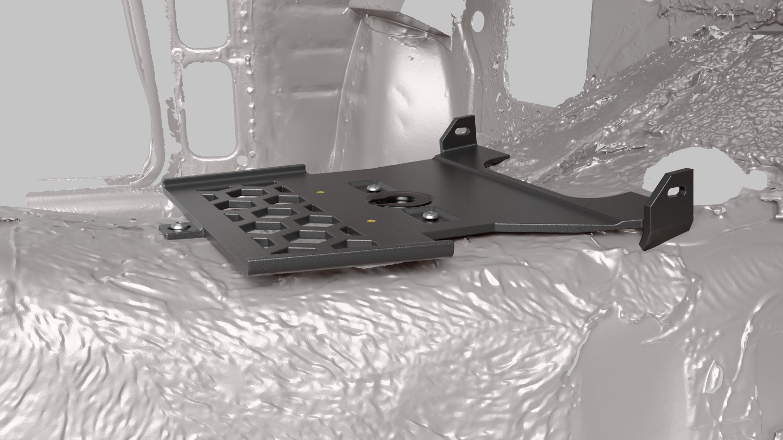

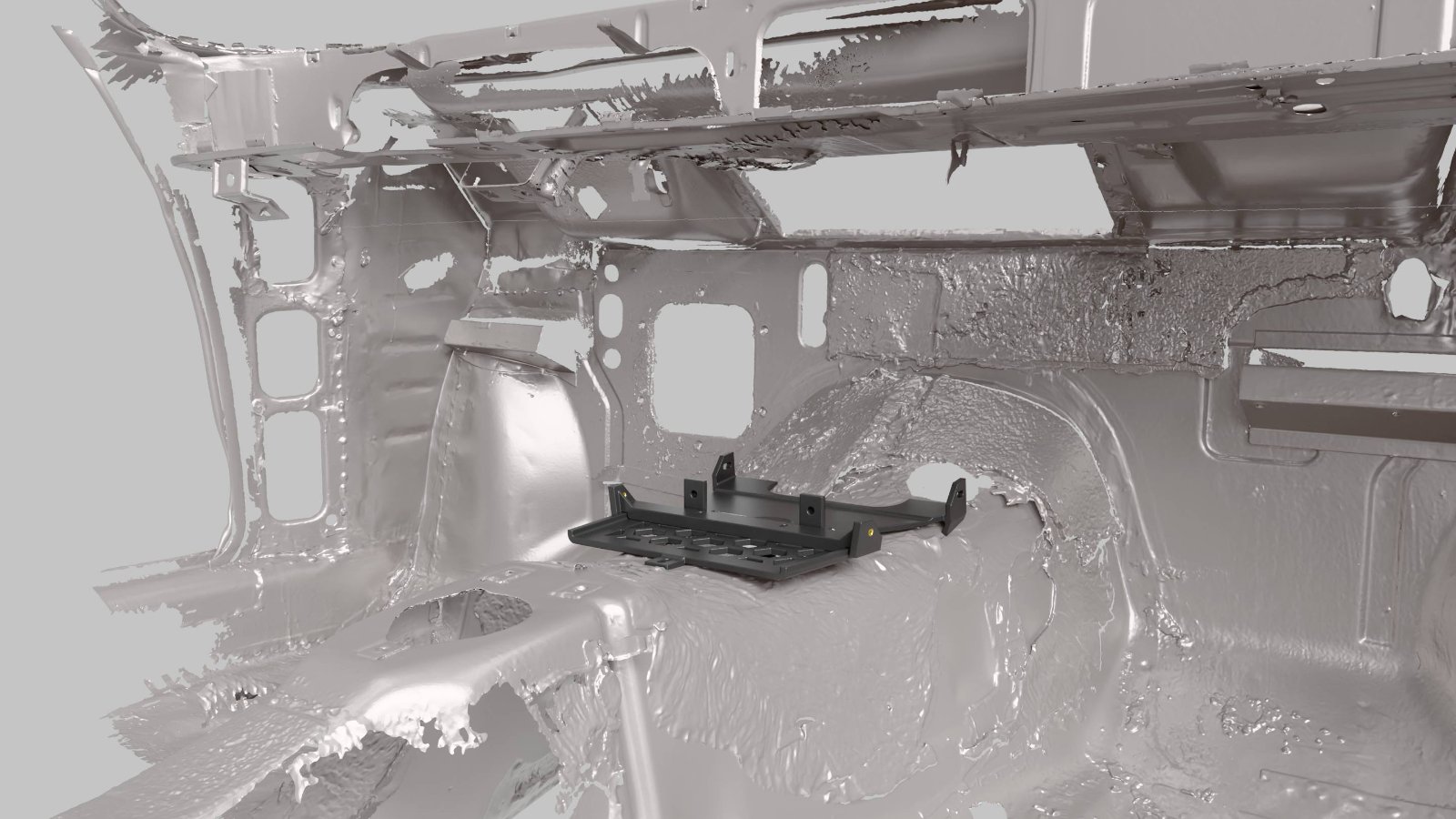

A key factor when installing an evaporator in a BMW E9 is its mounting height, which is determined precisely by this base.
Throughout my discussions on 3D printing—especially at the very beginning—I kept asking about the correct evaporator base.
I received various answers, but some people suggested using a base from a BMW E3—which, incidentally, is actually shown in the "blue book" (official manual) for the E9 under the air conditioning section. In fact, all the interior photos in that manual are of an E3; the center panel and the evaporator base shown there are specific to the E3 and do not fit the E9.
The center panel is—for obvious reasons—larger than the one in the E9, and the evaporator base is also significantly larger.
There were also suggestions that a base from an early-series E24 could be used. Well, perhaps, but…

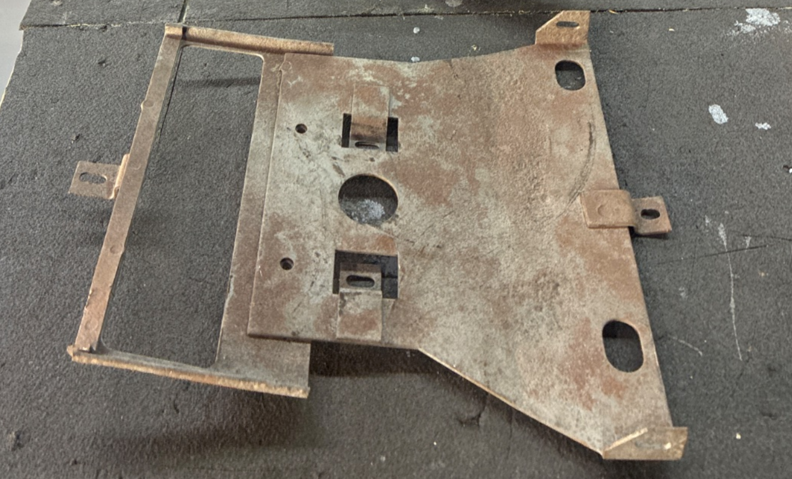

And here we get to the heart of the matter: the correct evaporator base for the E9 is the smallest of them all in terms of surface area, and, most importantly, its mounting plate sits lower than on any of the other versions.
The "legs" of the evaporator base are only 1 cm high—or even less—as you can see in one of the photos below, which shows the stripped-down center tunnel of a car I once owned that had been imported from the USA. It has the correct evaporator mount for an E9 installed, and you can see exactly what the height of the front leg is in this photo. I made a mistake by not removing this mount before the sale, but at the time, I had two metal mounts that were supposed to fit an E9…
The second photo shows correct evaporator mount from my own car.
The third photo shows another correct mount.
The next two photos show the evaporator bases from a BMW E3 and E24.
In the bases for the E3 and E24, the support legs are two centimeters high.
It turns out that this extra centimeter is crucial for the correct installation of the system's individual components—specifically the air duct.
If the evaporator is mounted too high, it will not align with the air duct's inlet and outlet openings.
This elevation also creates issues with the proper assembly of the entire section, including the center panel and the large side panels.
The issue regarding the base came to light about three weeks ago during a trial assembly of our kit.
By comparing our components with an original set, we were able to verify the height differences, as shown in the attached scans and renders.

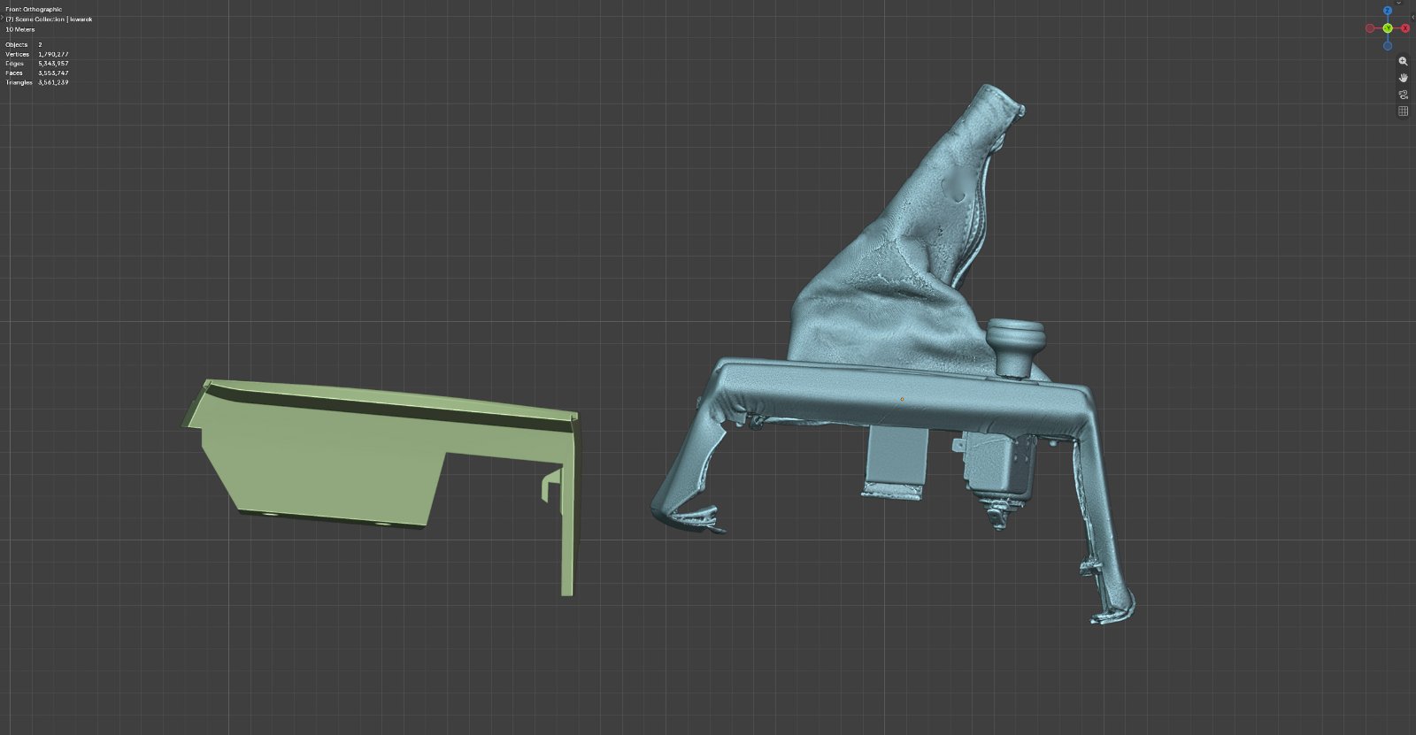

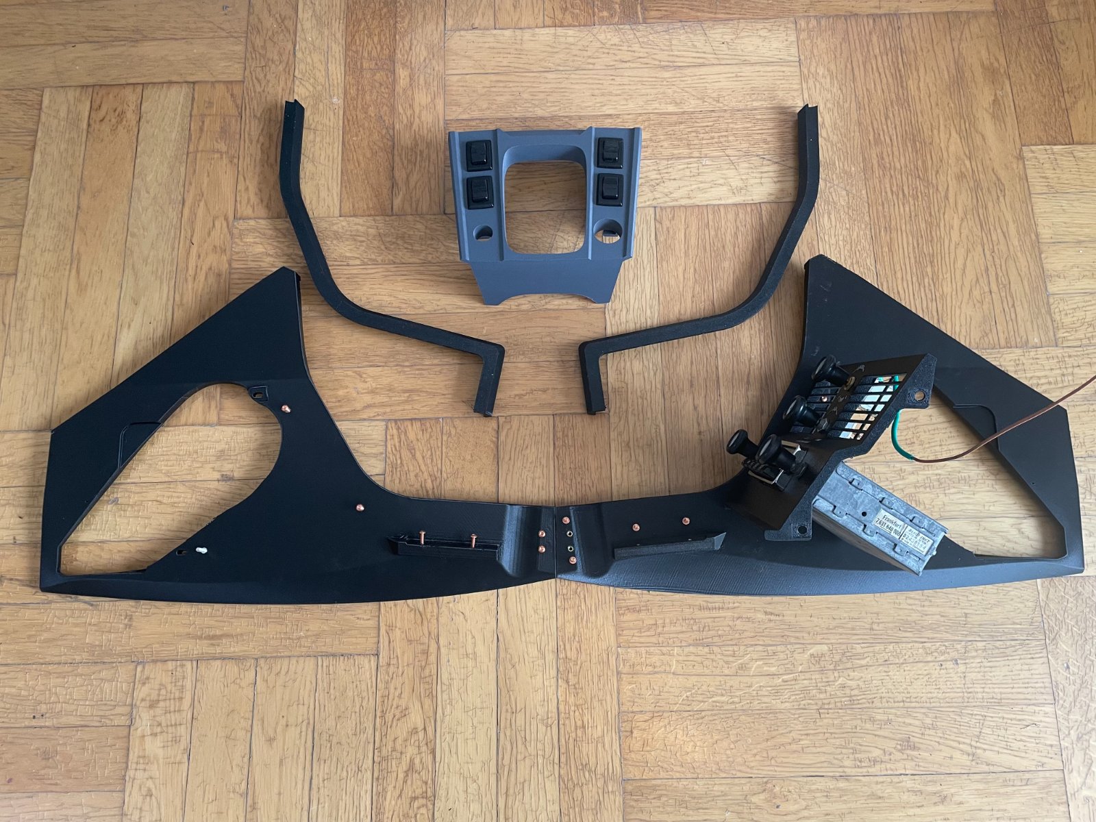

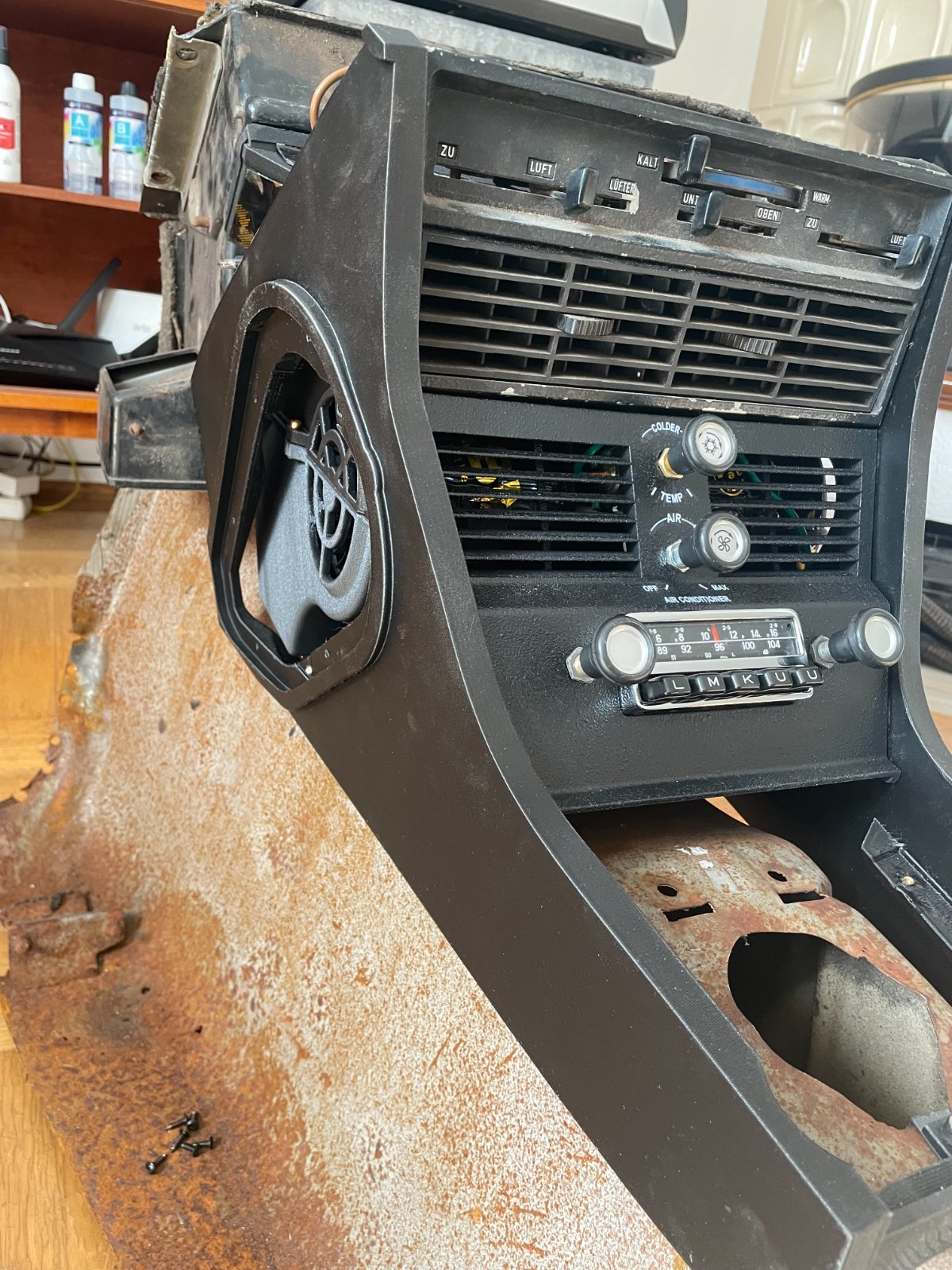

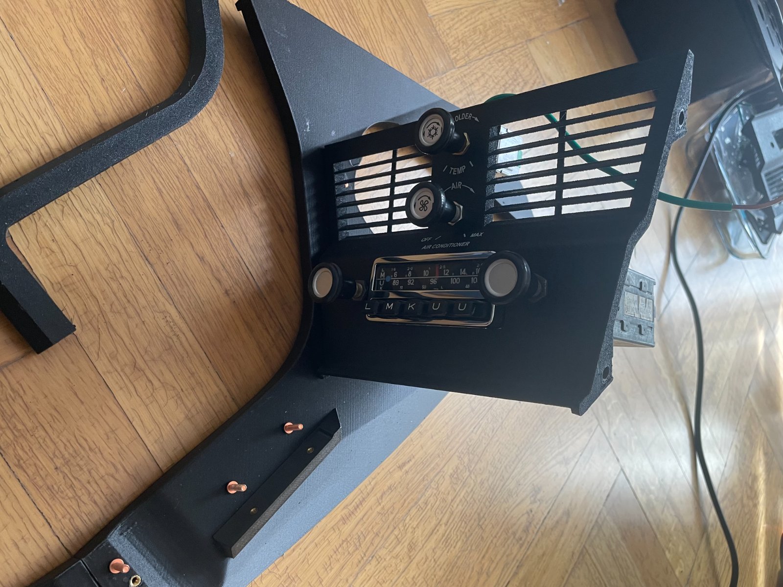

PART TWO:

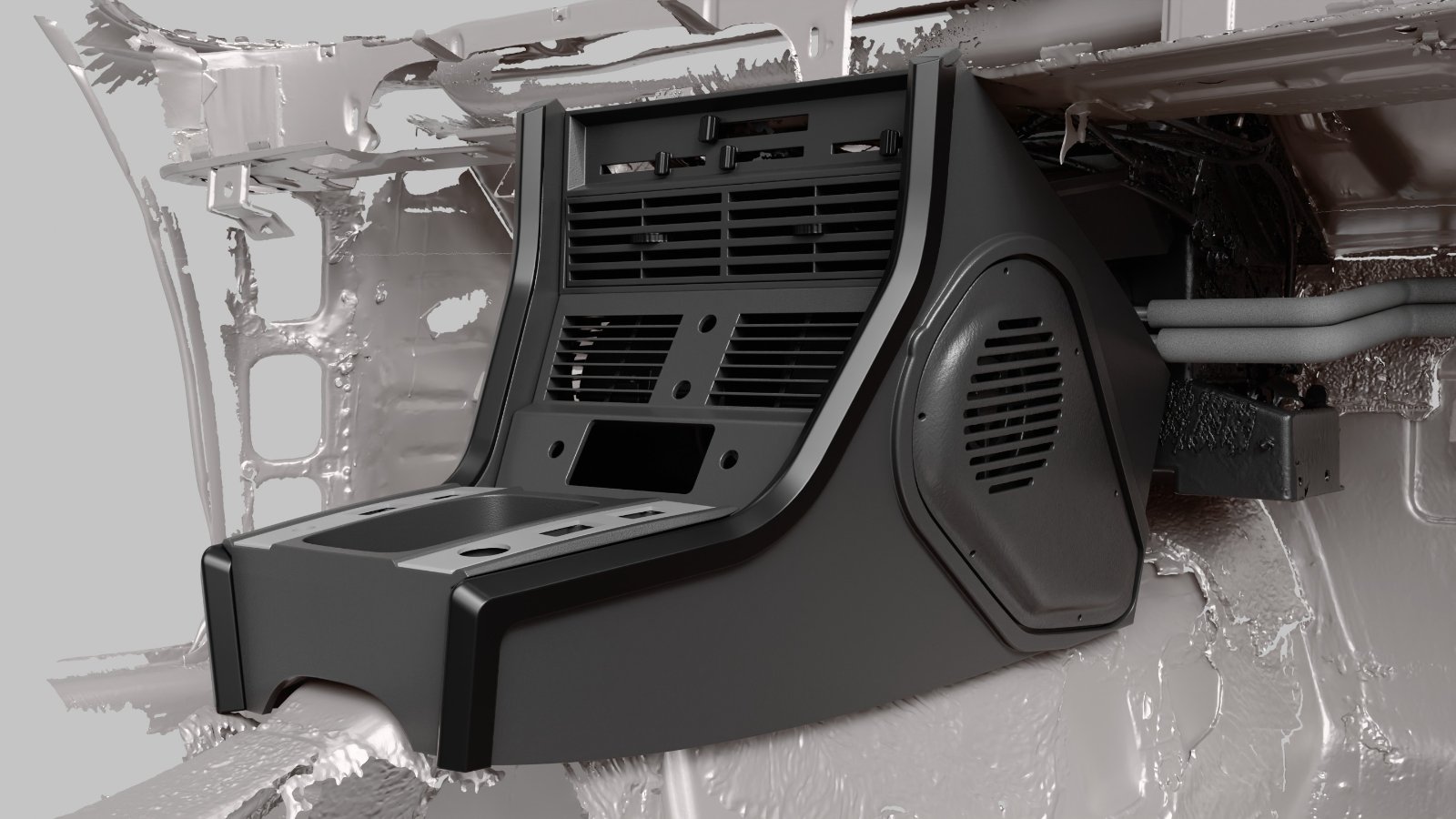

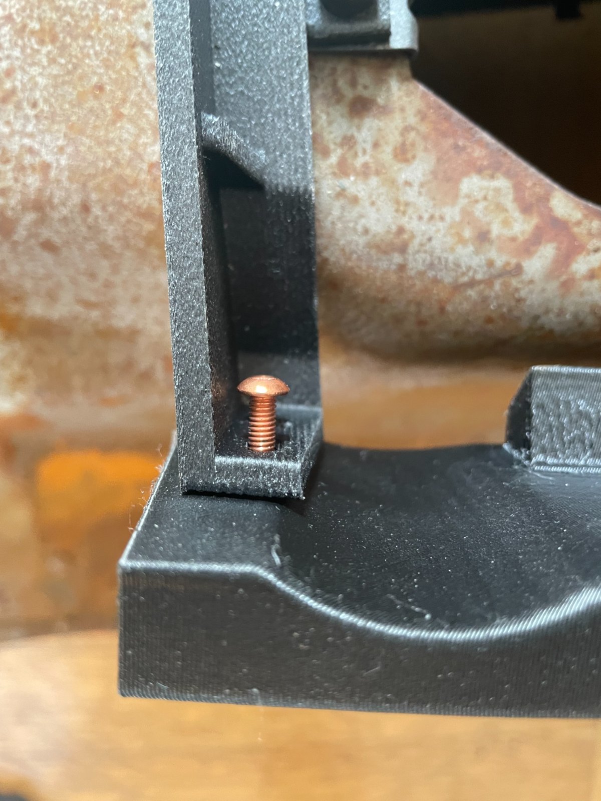

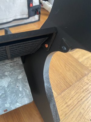

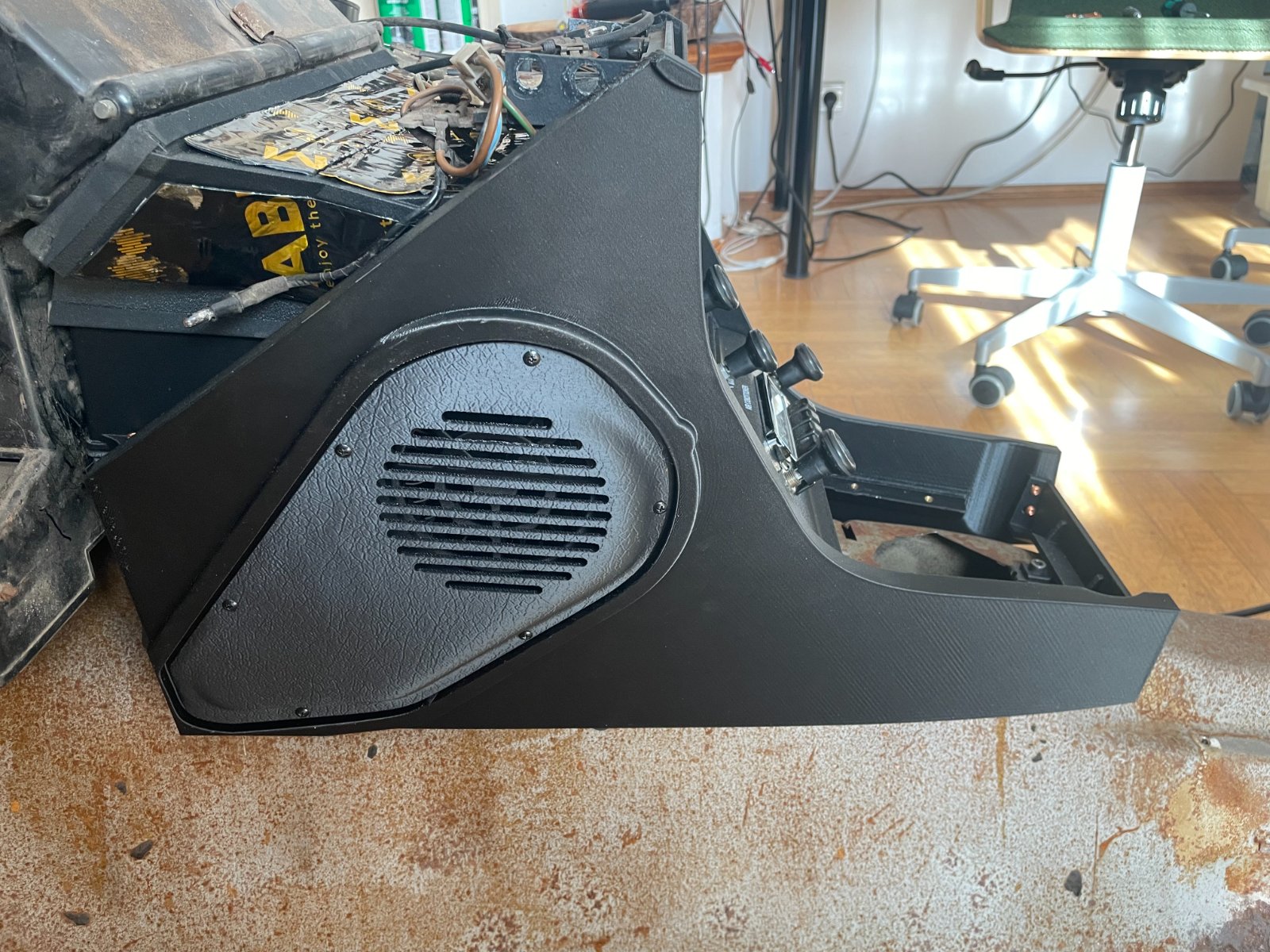

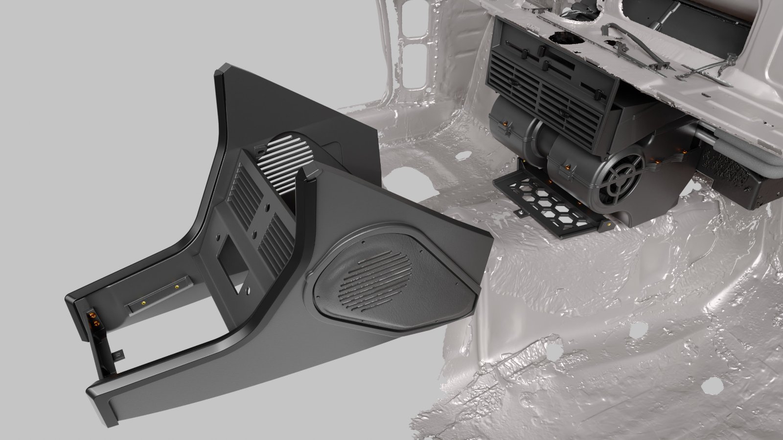

Another change I decided to implement while designing the individual components concerns the mounting method for the side panels.
I have always been annoyed by those unsightly screws used to secure the side panels; they disrupt the overall appearance of the surface—especially around the decorative trim strip on the side panel.
Our system uses only two attachment points, concealed beneath the edges of the panels (which feature an "elephant skin" texture), where internal connectors are secured.
For the central panel, we replaced the original mounting method with threaded inserts positioned on the inner side of the side panels. The central panel is screwed into these inserts before the entire assembly is slid onto the evaporator unit.
Two additional connectors serve to bind the entire structure together. One is located in the center section, attached to the evaporator base, with its ends bolted to the side panels. The second is positioned at the front of the side panels, just below the gear shifter console—a component we also redesigned to improve both its fit and its mounting method, again utilizing a threaded insert and a screw.

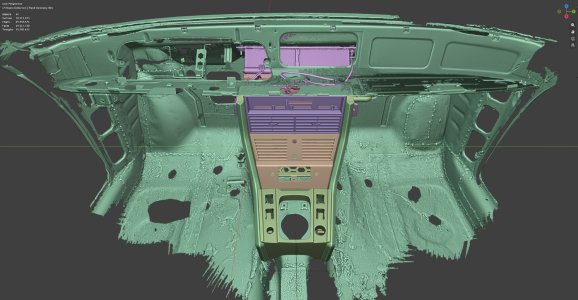

We have refined every component of the console assembly. After scanning the factory-original parts and reviewing a vast number of photographs of interiors equipped with air conditioning, it became clear that, in most cases, these components do not fit together precisely. This often results in uneven gaps and structural misalignments—frequently caused by the evaporator being mounted at the wrong height, often due to the use of an incorrect base.

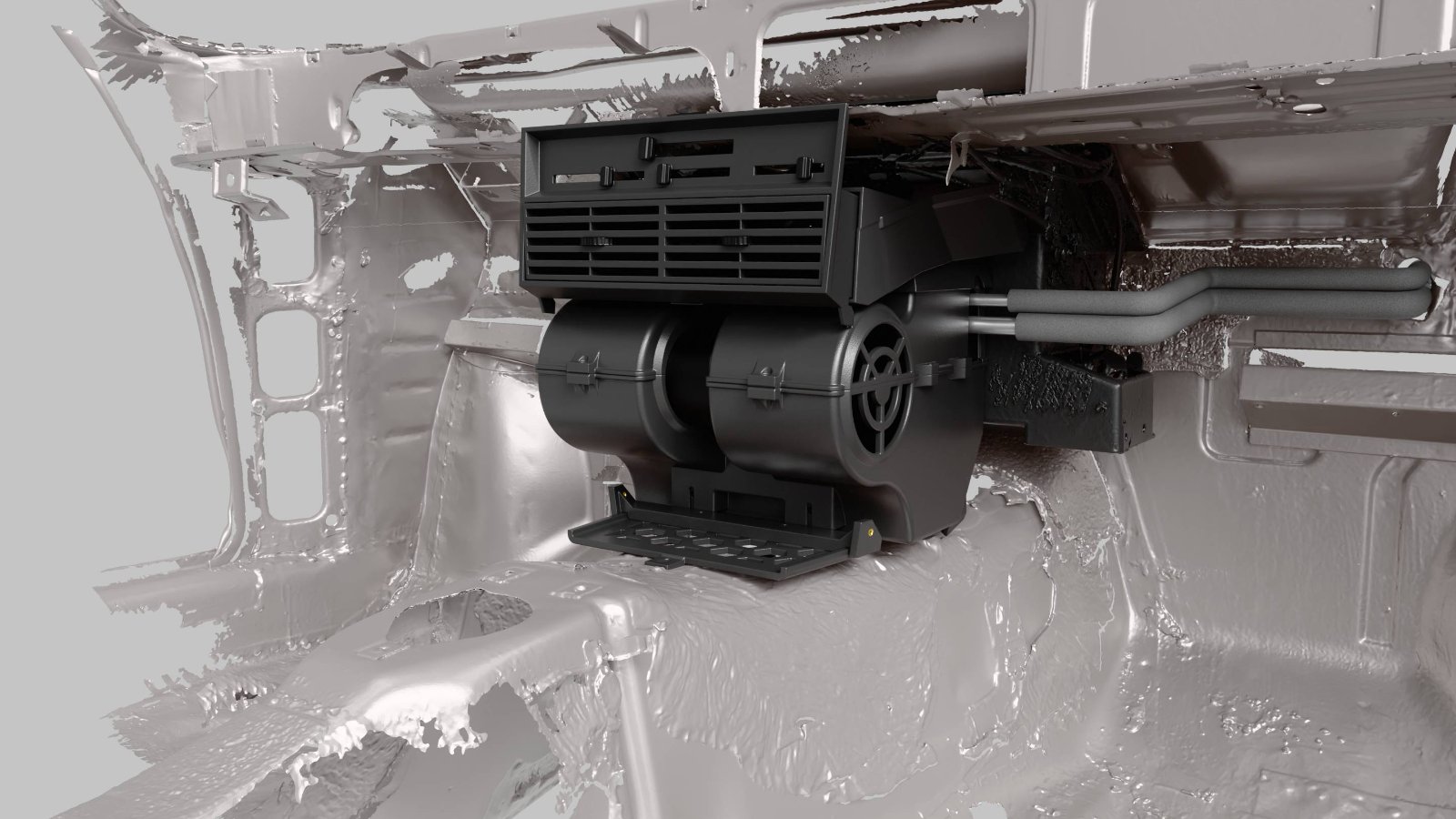

At the heart of the system is a redesigned evaporator unit, featuring a modern core, an expansion valve, and a powerful three-speed blower from Spal, which offers significantly higher airflow capacity than the original unit.

Behind the central panel, mounted on our custom-designed bracket, is an evaporator unit featuring a modern core, an expansion valve, and a high-output, three-speed fan. The refrigerant lines extending from the evaporator core are shaped to match the original, allowing for direct installation.
However, we have updated the connection system to use O-rings.
The assembly is enclosed by a structure consisting of large side panels joined by connectors and finished with smaller panels that faithfully replicate the original surface texture.
The final component of our proprietary system is a redesigned center console, with a particular focus on fitment and mounting methods.
Ultimately, the large side panels and the gear-shifter console will be upholstered.

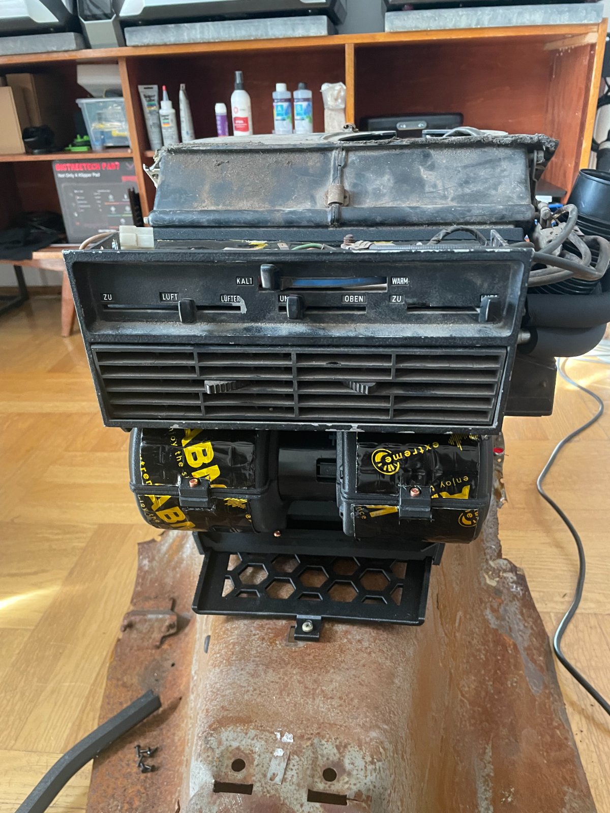

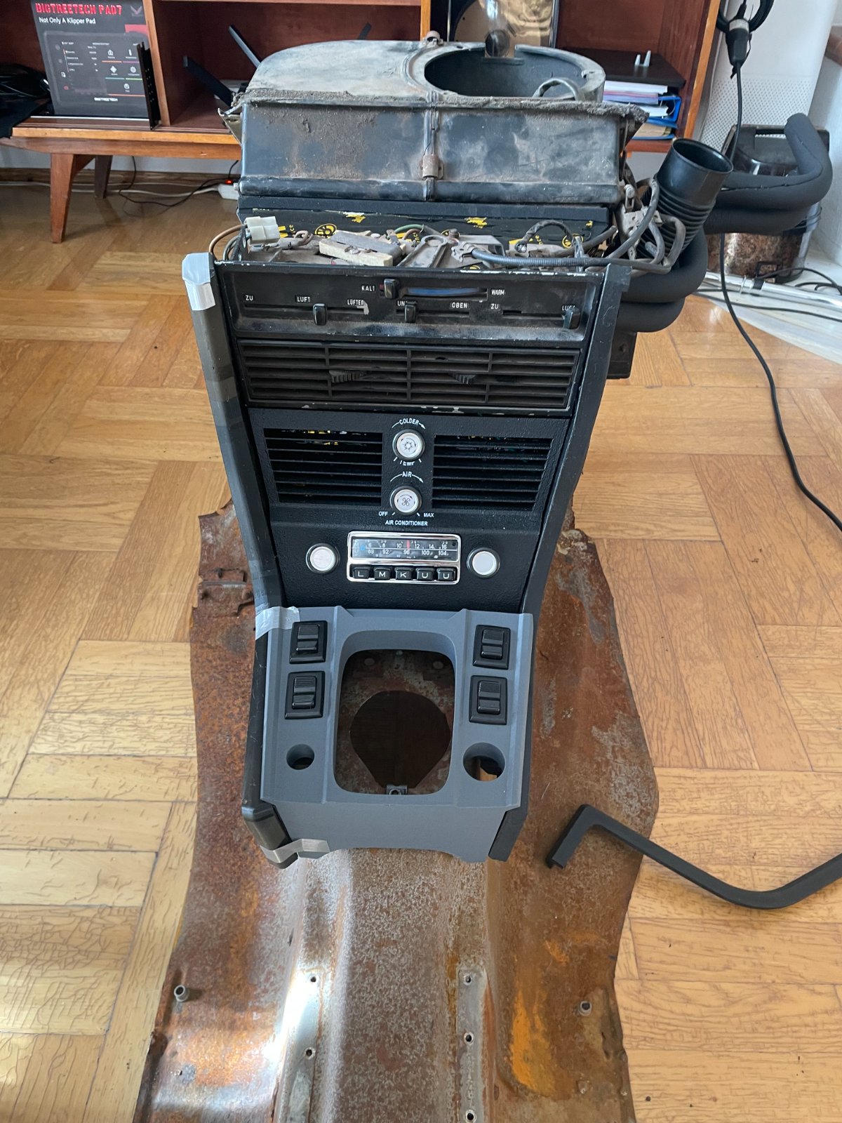

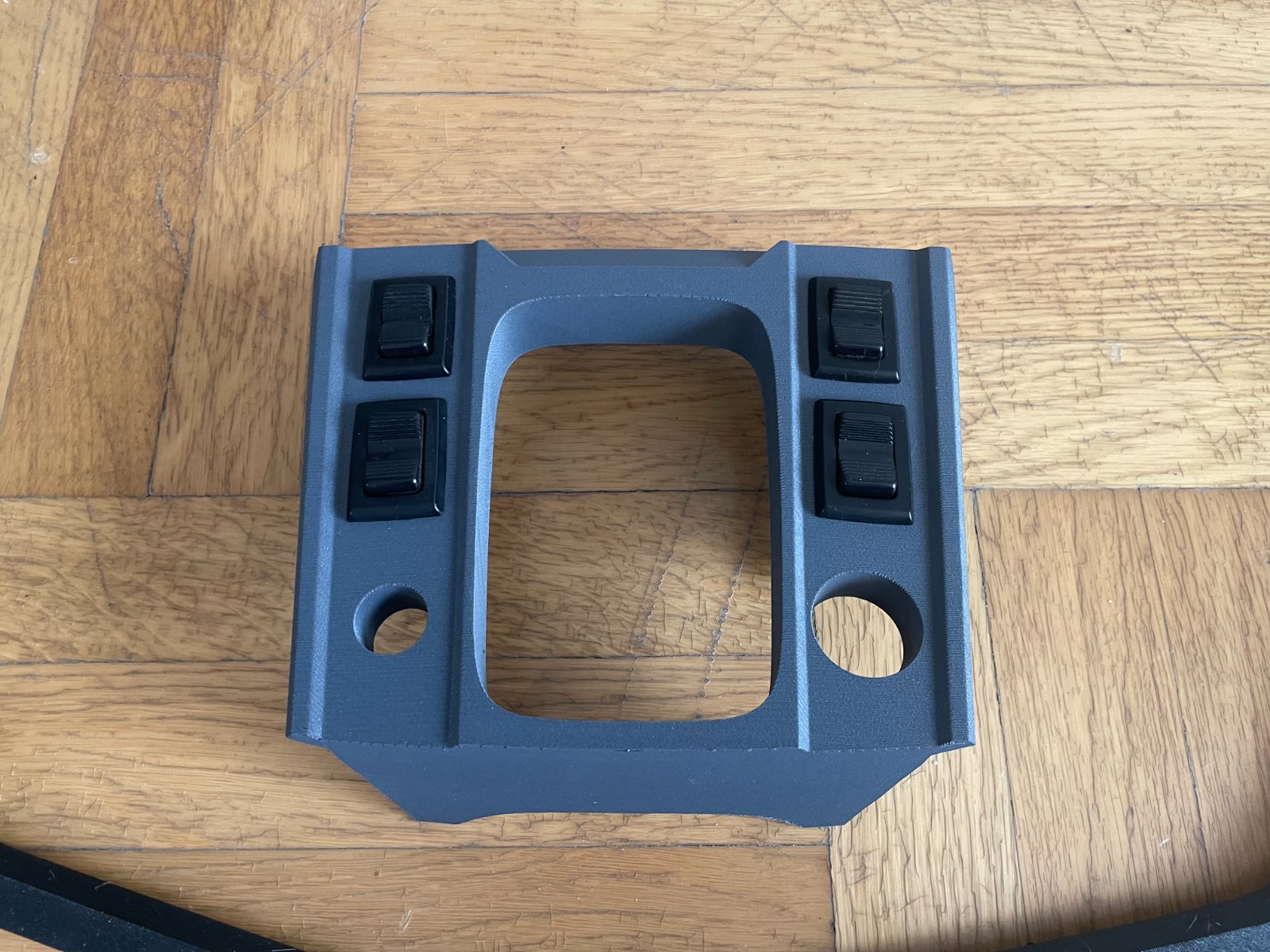

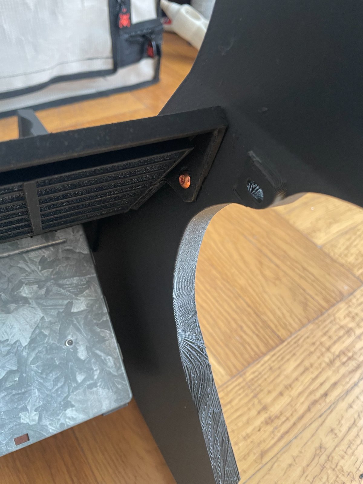

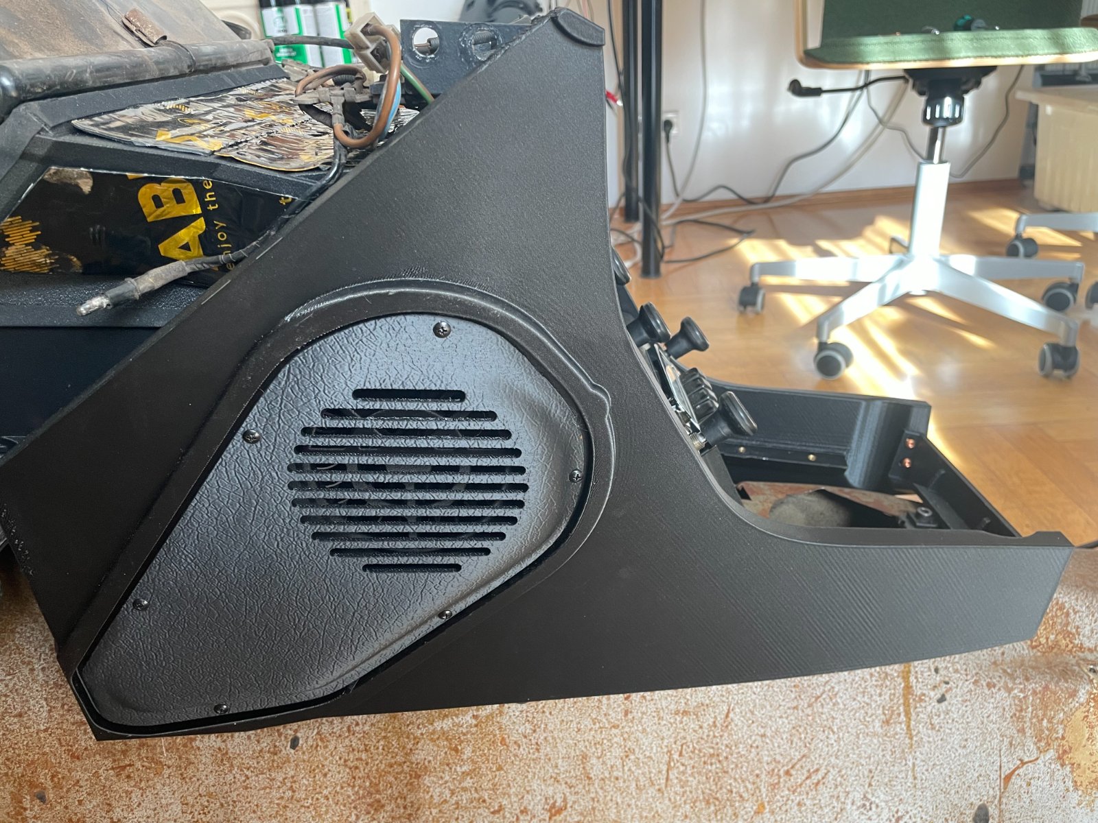

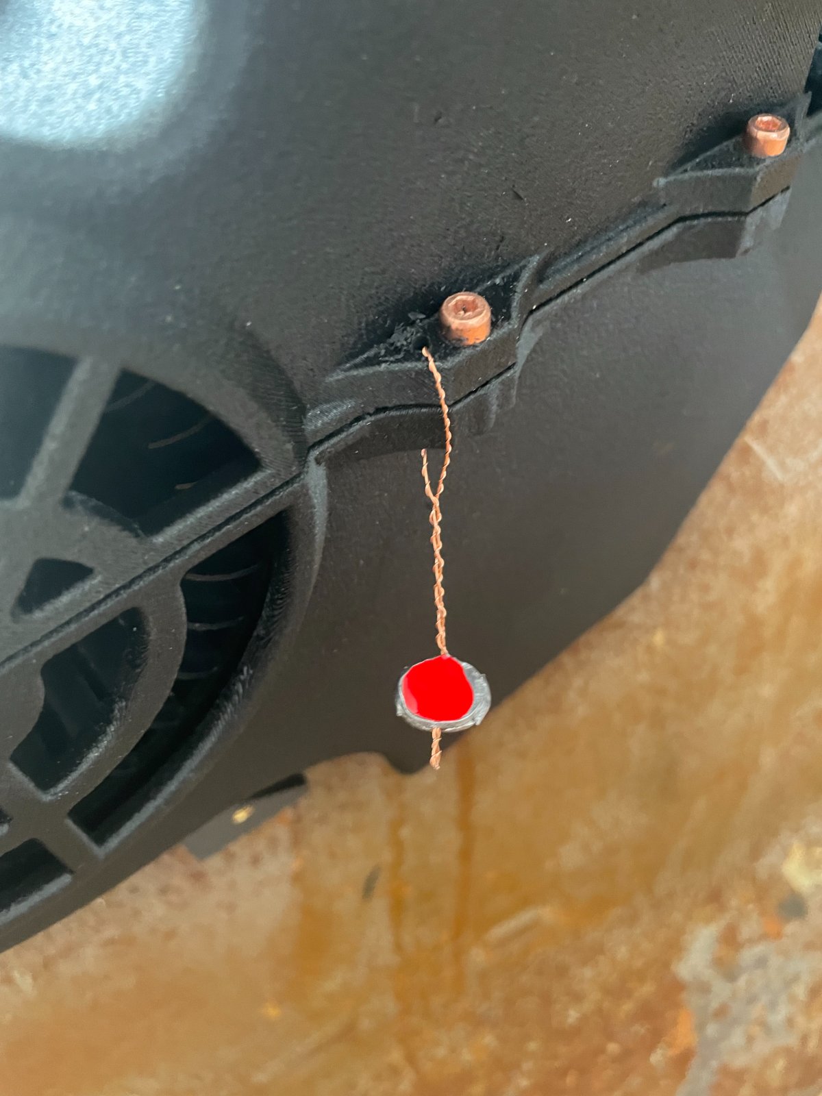

A few missing photos from the installation:

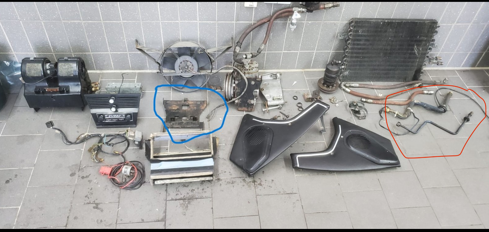

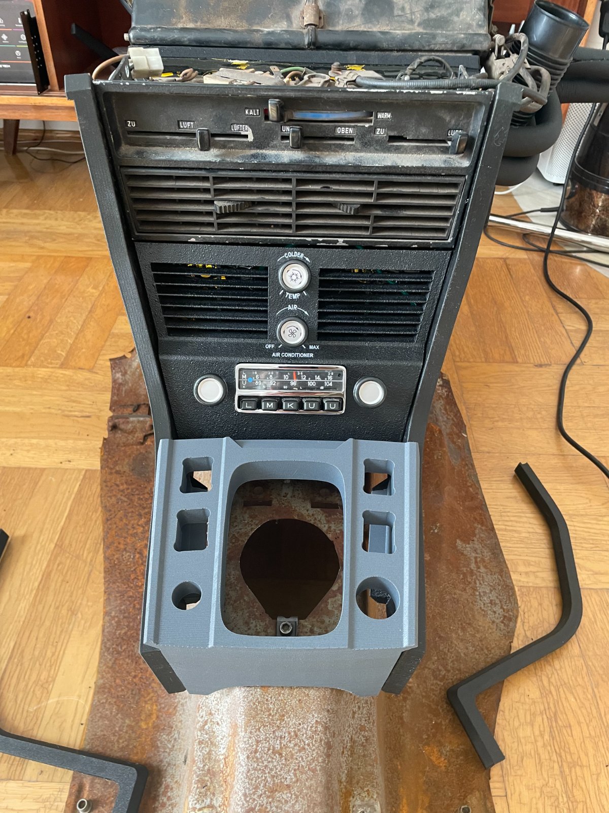

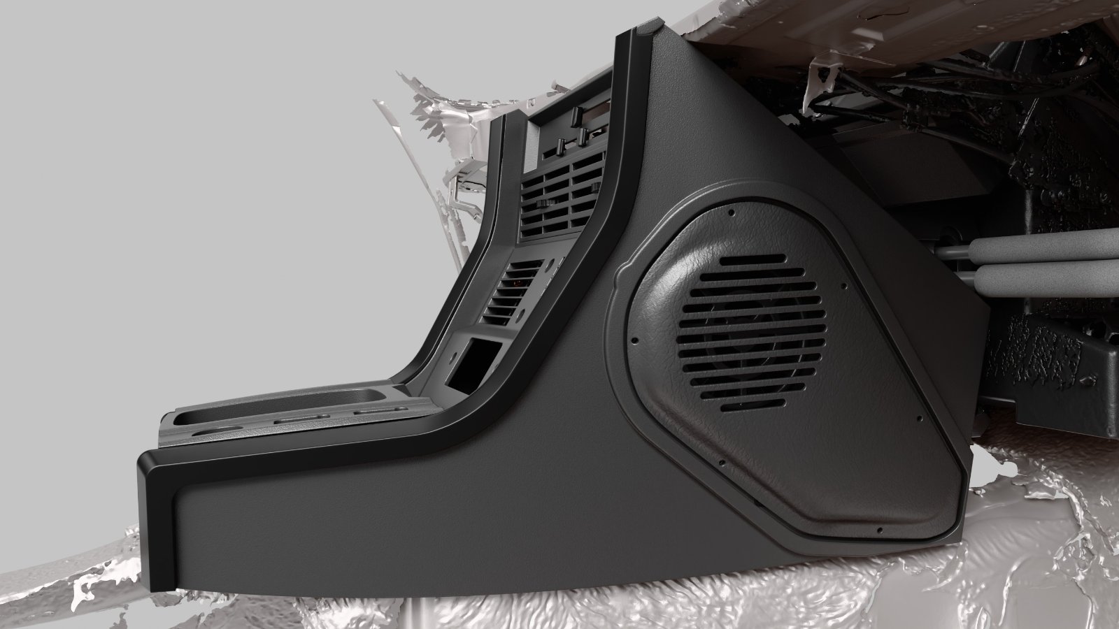

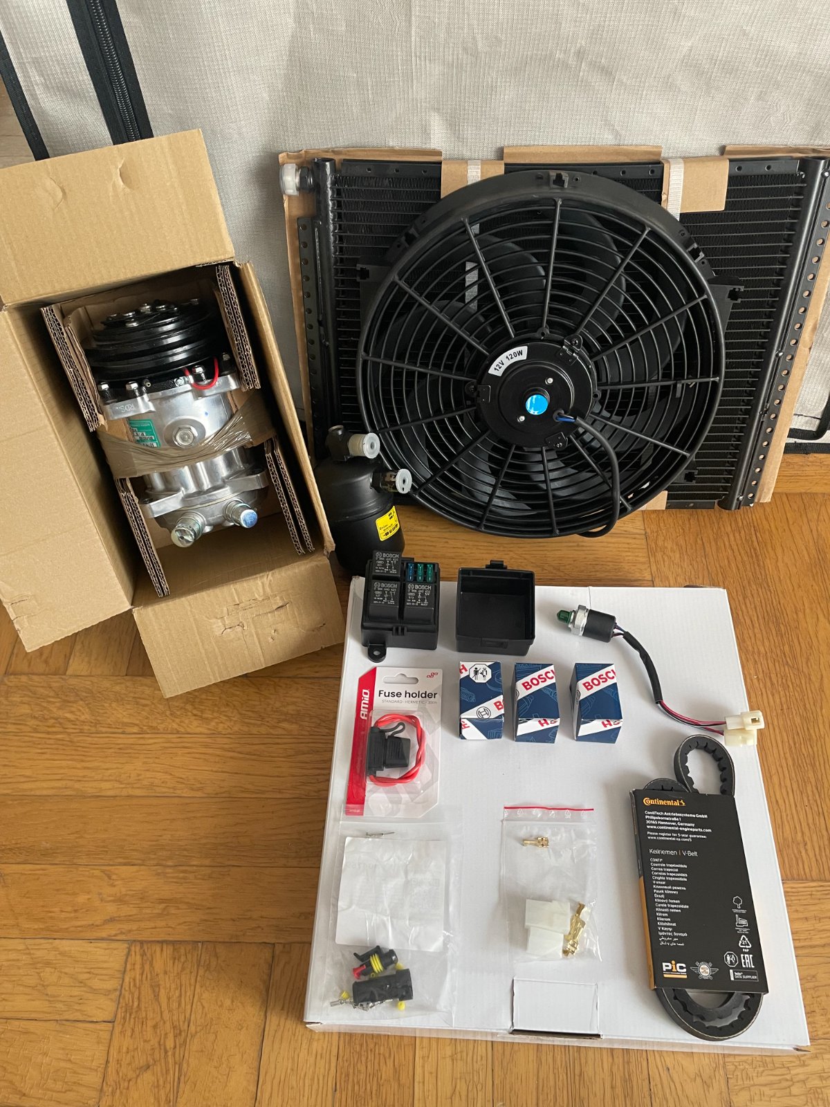

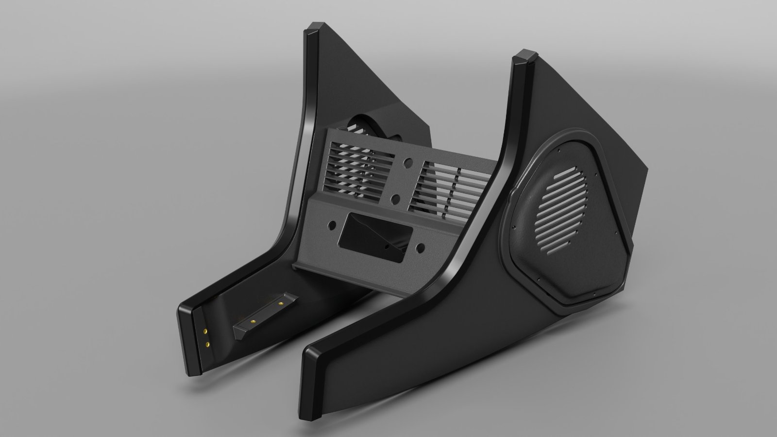

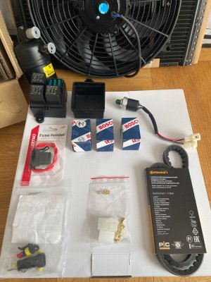

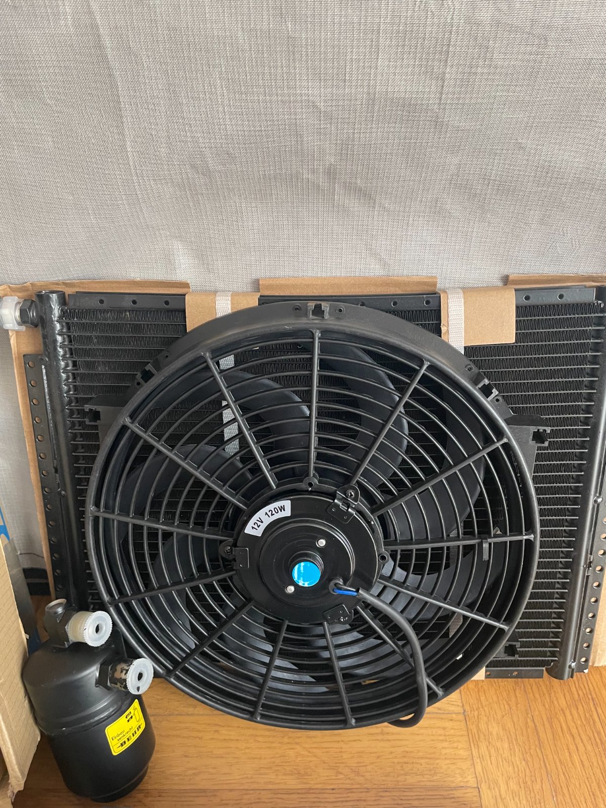

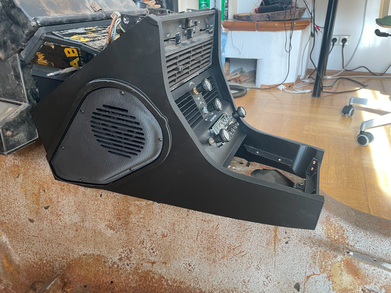

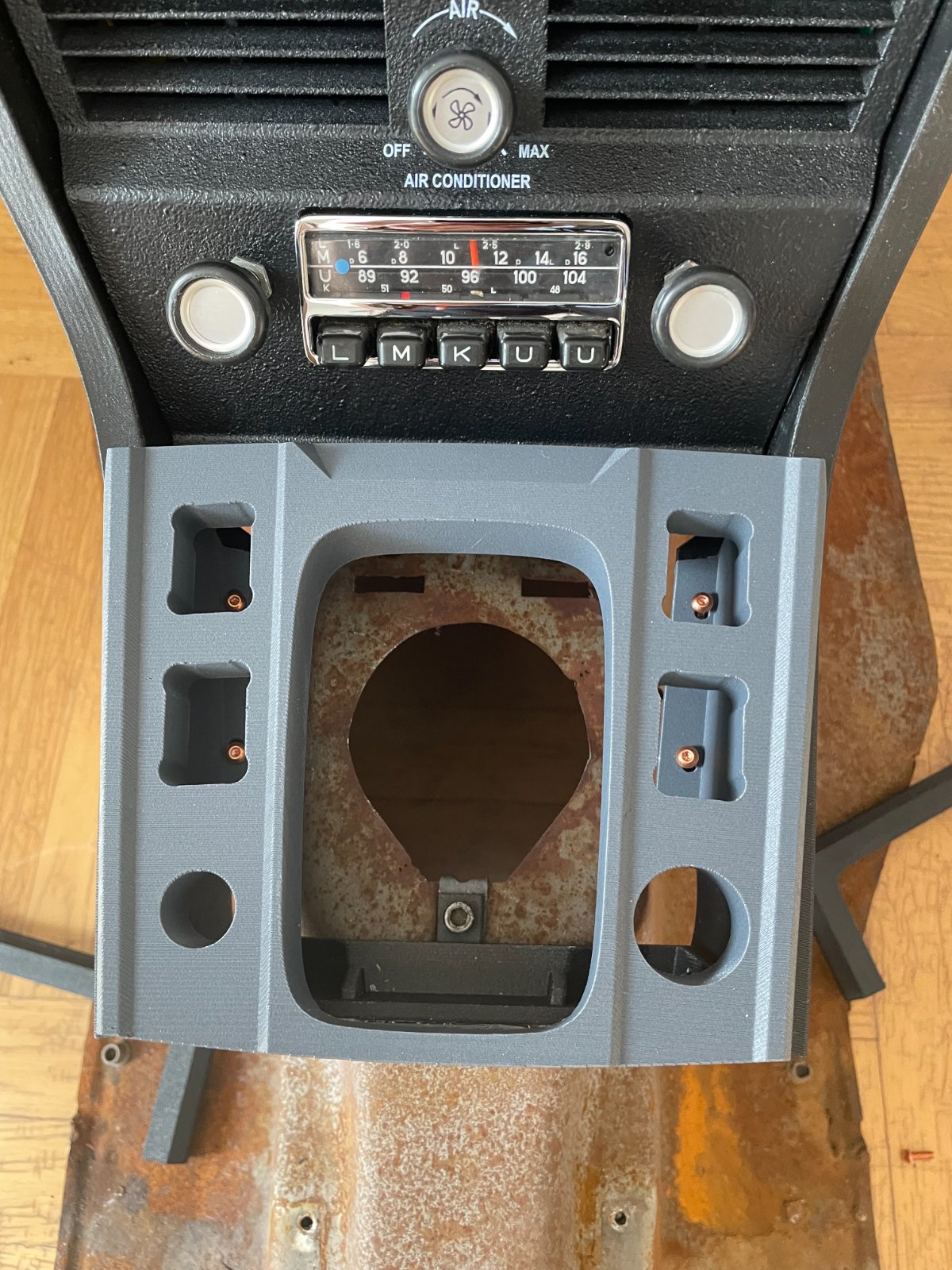

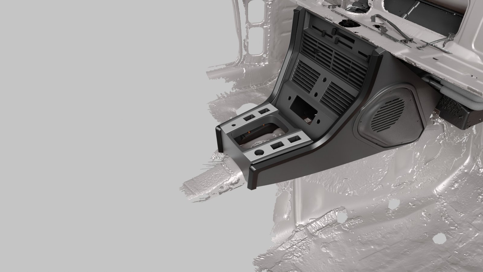

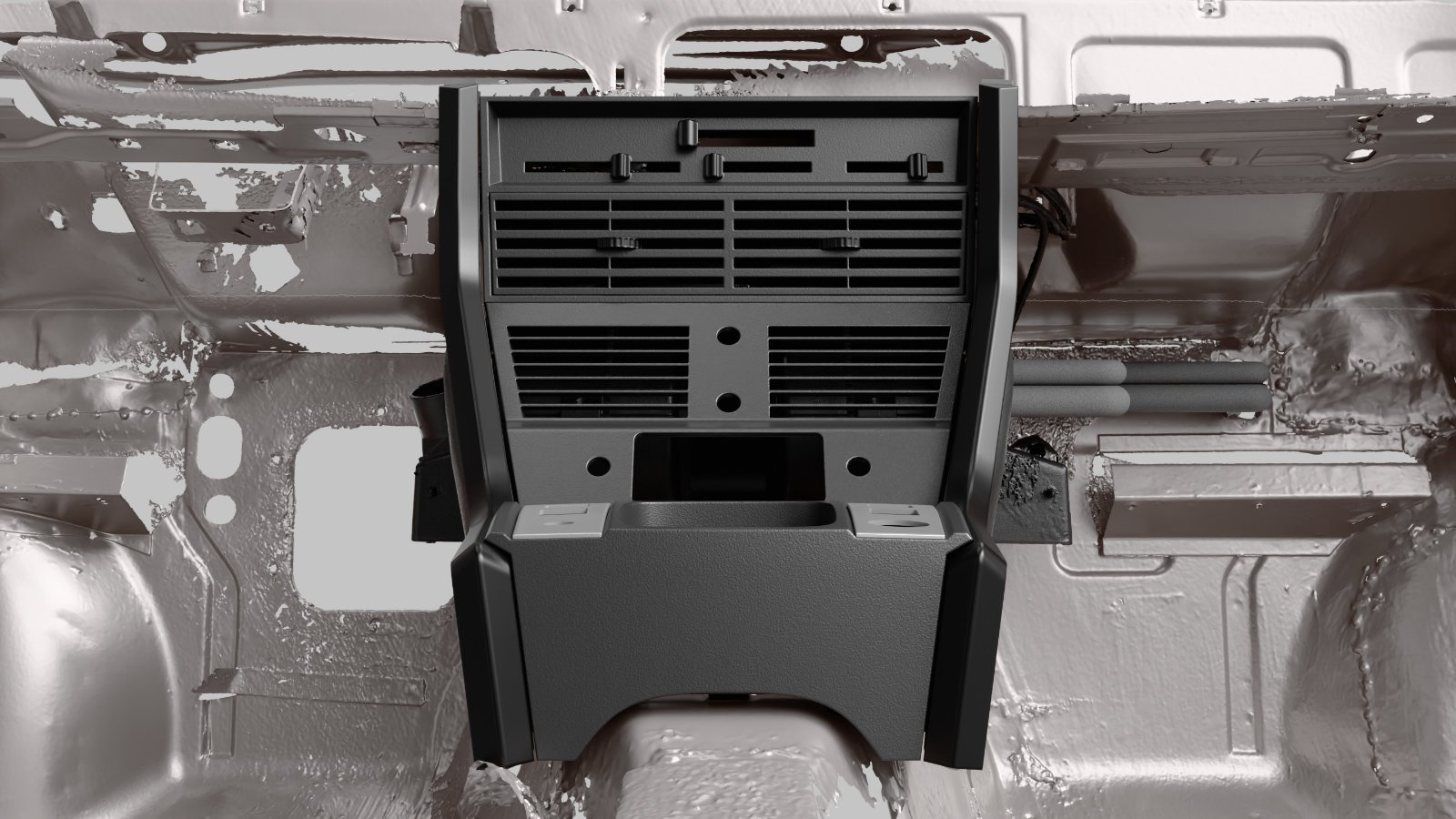

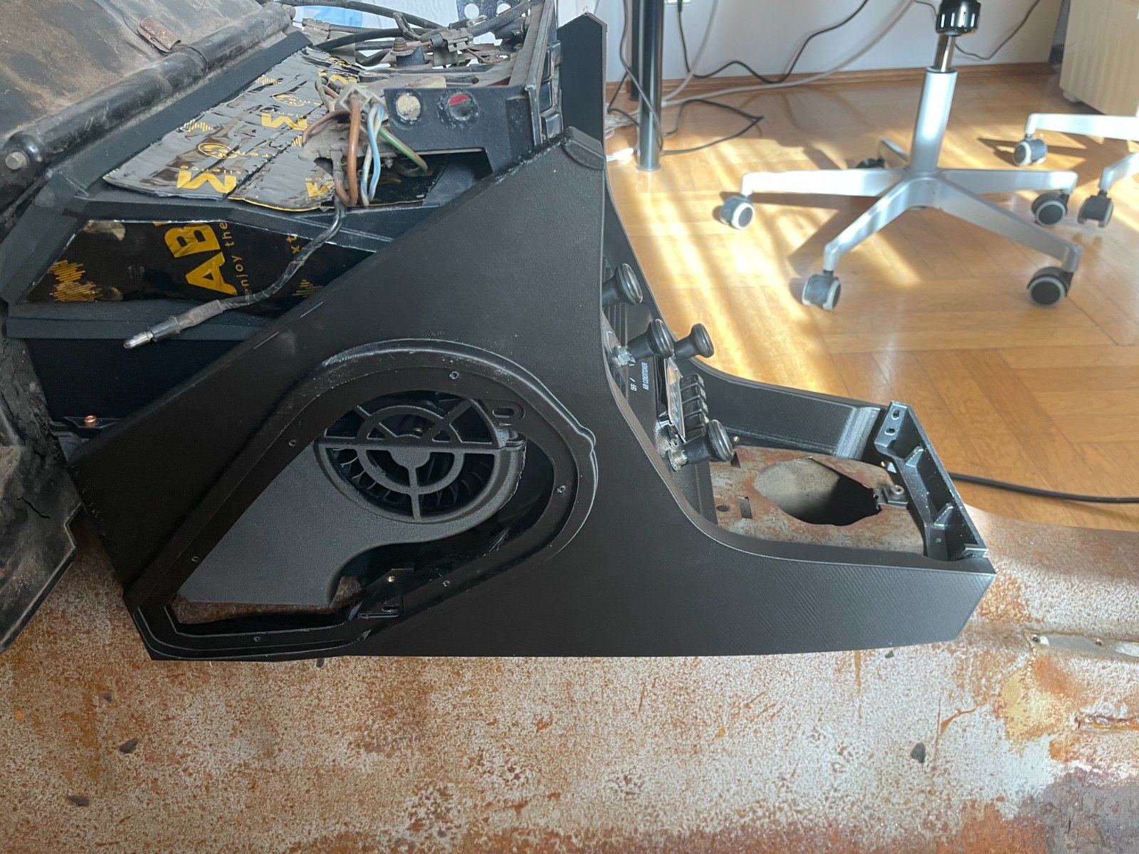

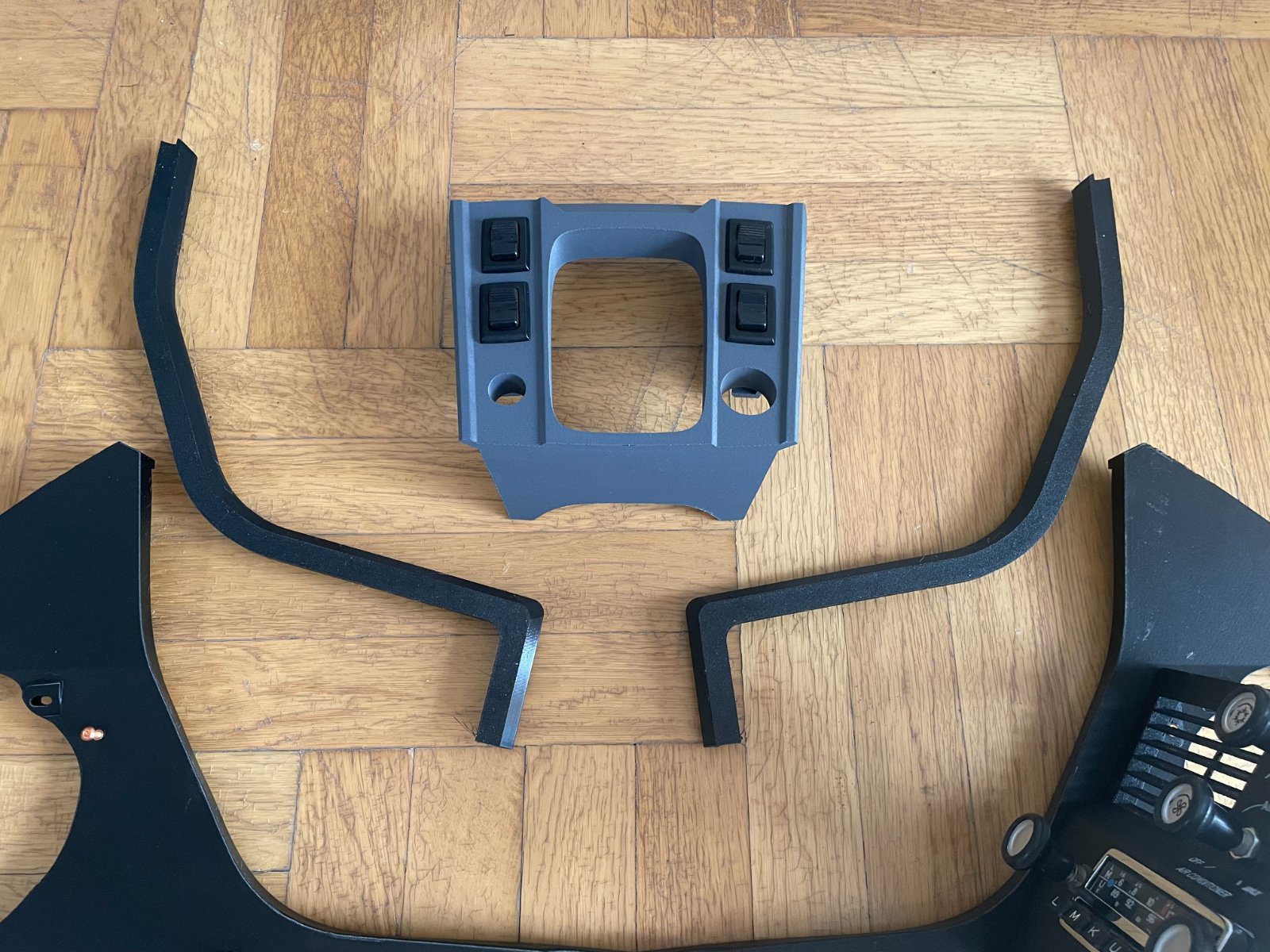

@Lucas - I commented on one of your facebook posts, but may want to modify the above and/or add additional information

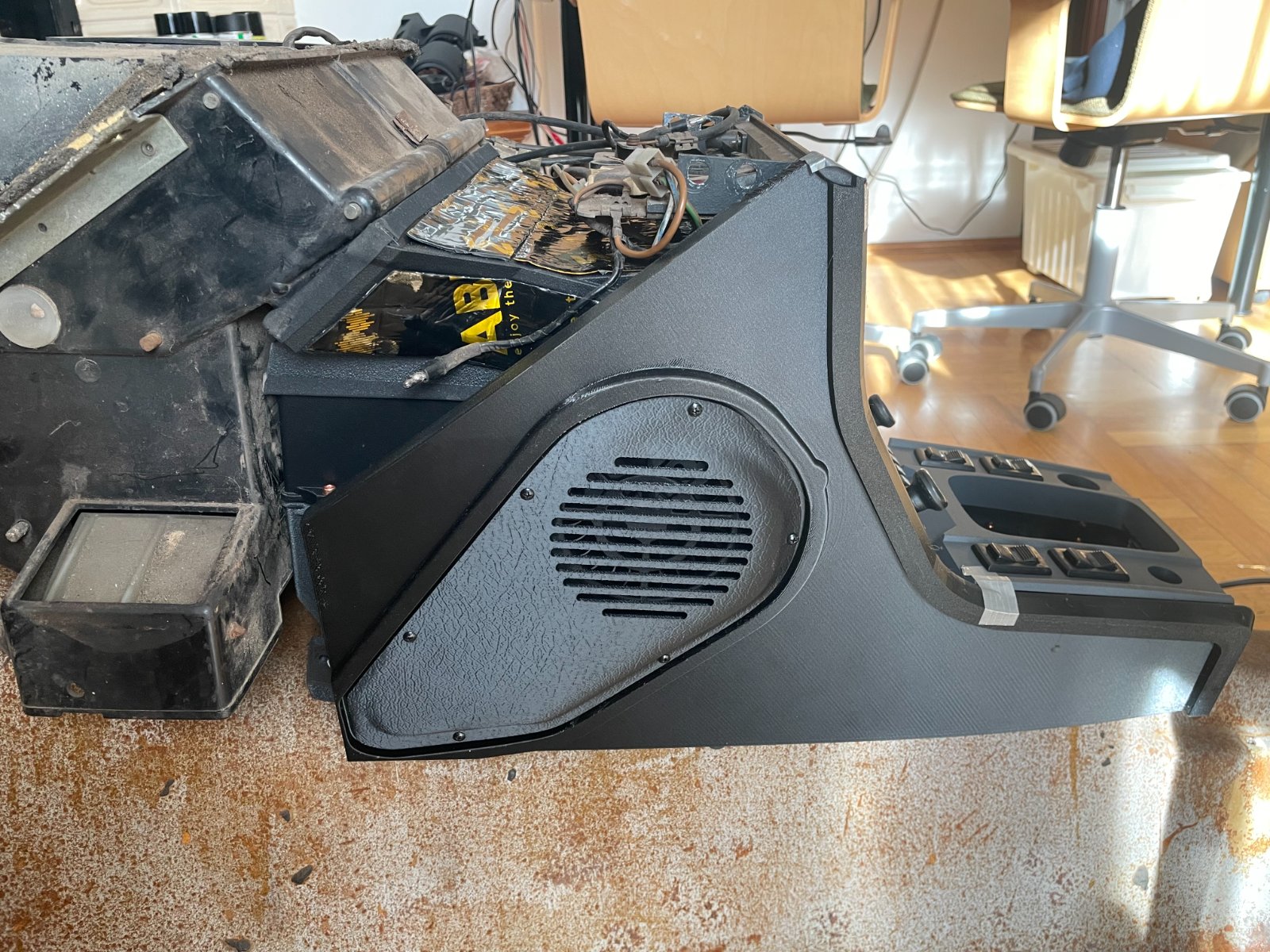

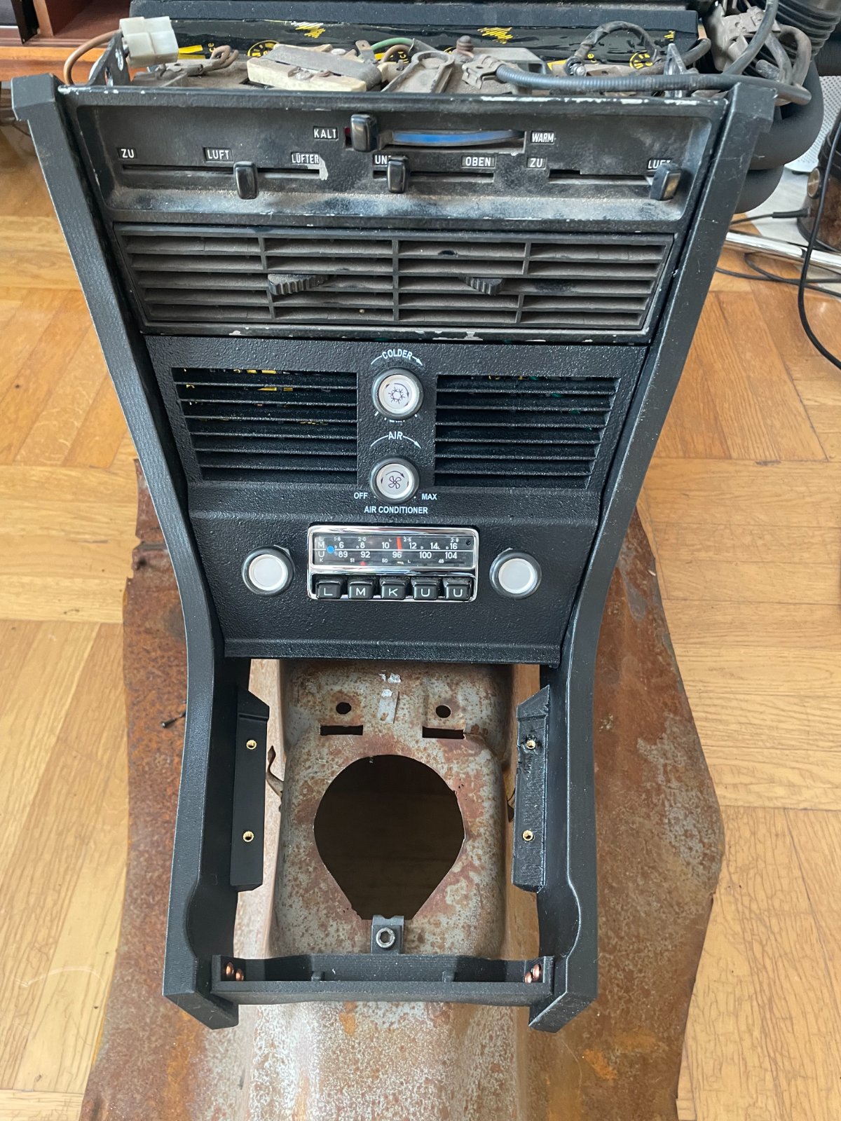

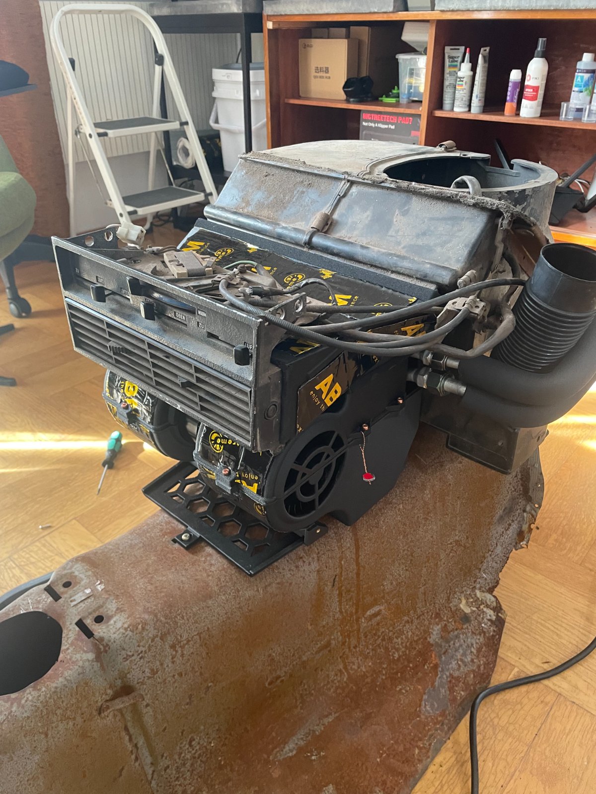

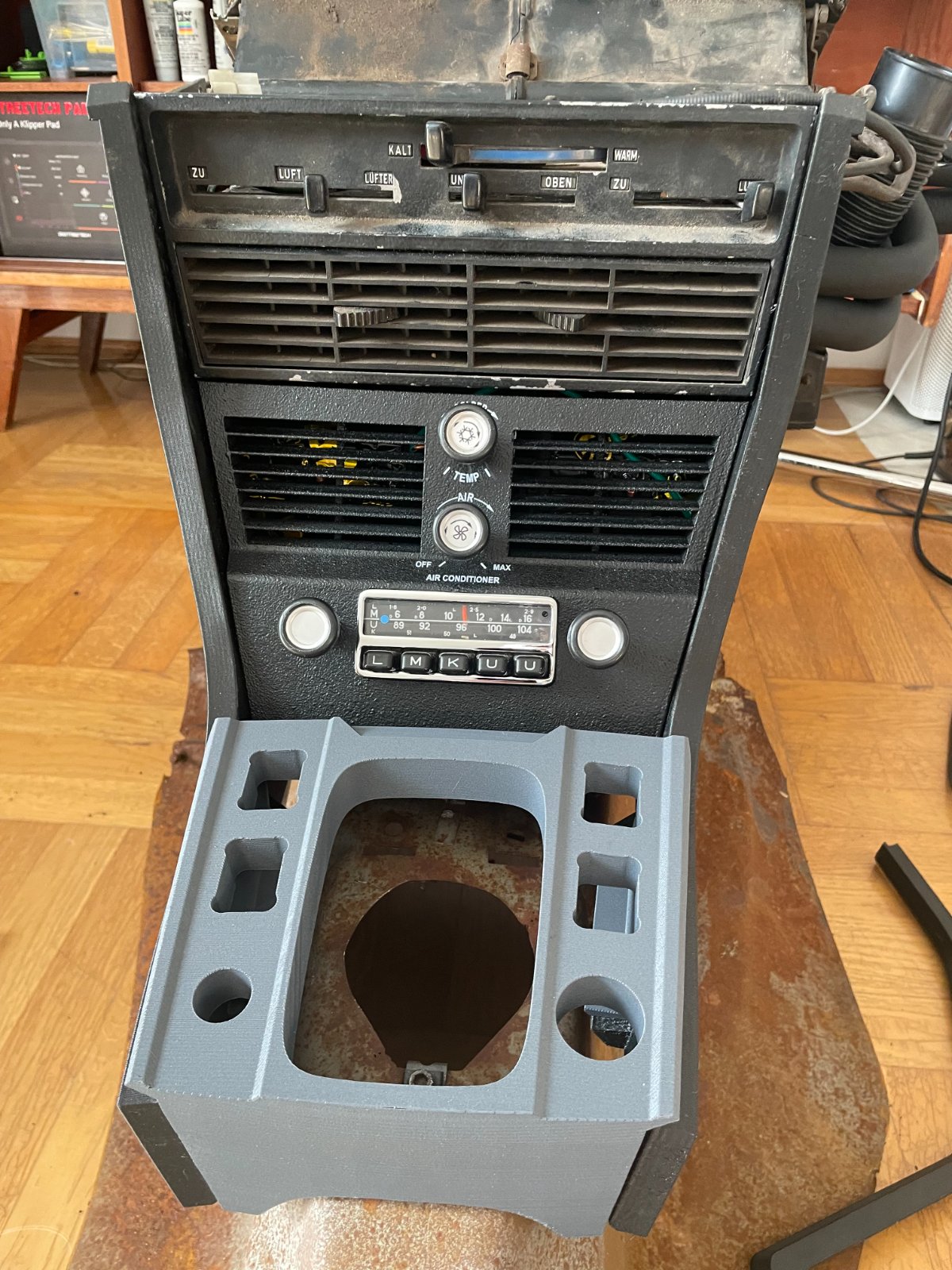

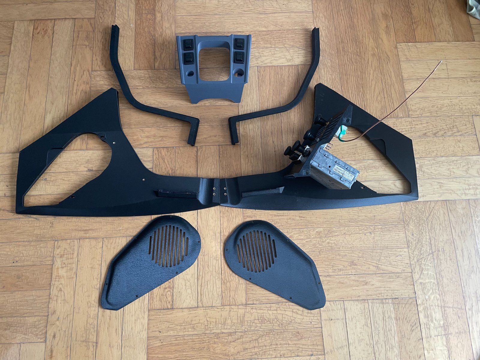

1. You state that a radiator is included but I believe you mean the parallel condenser along with the condenser/radiator fan, both of which mount in front of the radiator currently in the car, which does not need changing for your retrofit. Are you including a means to mount the condenser into the car as well as mount the fan?
2. When advertising this outside of the forum, for the aluminum you may want to put a link to oilsdesigngroup.com since sometimes non-forum members have difficulty accessing older forum posts
3. You've included a fan belt but it is critical for people to know that the pulley on their harmonic balancer may need to be changed to accommodate powering the Sanden compressor. My car is a Euro 1972 CSi and did NOT come with AC, so in order to retrofit AC I would need to upgrade that pulley to allow for that additional belt location. This isn't a HARD job to do, but a full retrofit would include that pulley as well. I'm not suggesting you add that into your package but may be worthwhile to make a mention of this required part.
4. Given the system as you've designed it the choice of refrigerant may be up to the end user but I suspect you designed it for R134A? May be worth including that information. Does the set come with a full set of installation instructions? This obviously could be installed by many of us here on the forum, but we are perhaps the "tip of the spear" when it comes to what we are willing to take on given the numerous restoration projects included in these pages. For the average E9 owner, and for your advertising, I would suggest including a link to installation instructions or the comment "We recommend installation by a person experienced with E9s", etc. Since the TXV valve is contained within the evaporator housing, installation here is a bit of a three-part process - install the basic components mechanical and plumbing components into the vehicle but don't install any side panels or trim, bring the vehicle to radiator shop for filling of refrigerant and checking of all hose connections, then finishing the installation of the side pieces, gear shift console, etc.
5. Is your vision that the side console pieces and gear shift console are installed as-is or are you imagining that purchasers will cover them in vinyl locally? Your biggest competition for this kit retrofit is obviously the Oldenzaal kit, which comes at a significant cost over your option and doesn't necessarily have some of the "upgrades" of 3-position fan, separate relays and fuses, etc, but does include fully finished side consoles and a gearshift console. Your summary is a bit vague on this, suggesting that in the future you may offer it covered but not currently...
My points/questions above are not meant as criticisms - I am sincerely impressed at what you've put together. I hope that you are able to sell lots of these (and of course will be entering the photo contest - just thinking up good photo ideas!) and so am approaching this as "what would I want to know if I were a buyer"
Thank you for your valuable feedback. Since I’m not a fan of social media, a friend of mine—also named Lukas (spelled with a "k")—handles the promotion on Facebook.
I’ve passed your comments on to him, but please keep in mind that Facebook has significant limitations when it comes to presenting the kind of extensive content found in my forum post.
It certainly won’t look as clear or organized as the forum post—which, admittedly, is already massive in scale.
Nevertheless, he will refine it as best he can and will likely include a link to the forum thread for those who would like to learn more details.
As for upholstering the console and panels, I gave it a lot of thought—I have the means to do it and access to a truly excellent upholsterer—but the truth is, it would only really make sense if the entire dashboard were covered in a material with a consistent texture.
The textures of the materials vary, and if I were the buyer, I would want a uniform texture across all the dashboard components, rather than having two different ones.
That said, I can certainly arrange for them to be upholstered upon the request of a potential buyer.
This is a very interesting project.
After many failed attempts to have a good AC in my restored E9 this does interest me.
Although quite expensive there are a lot of componets here.
The key is- has anyone installed this system?????
I don't like the looks of the side panels without the upholstery but I guess they could be upholstered.
Since my car is more like a resto mod than totally original maybe that would have to be a detail I would have to give up on.

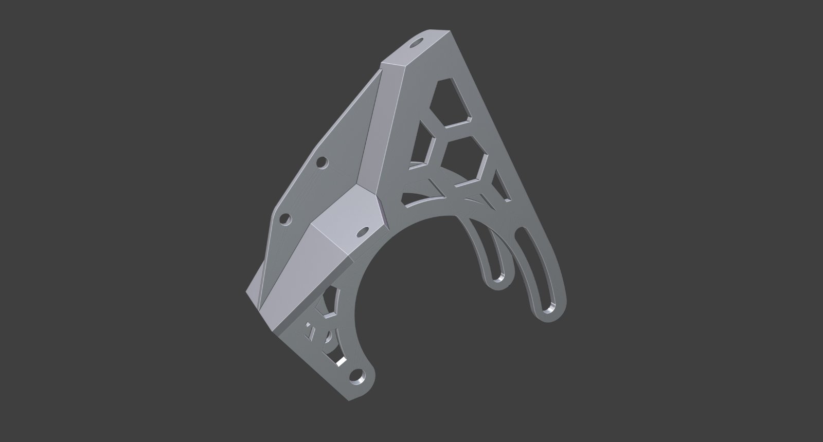

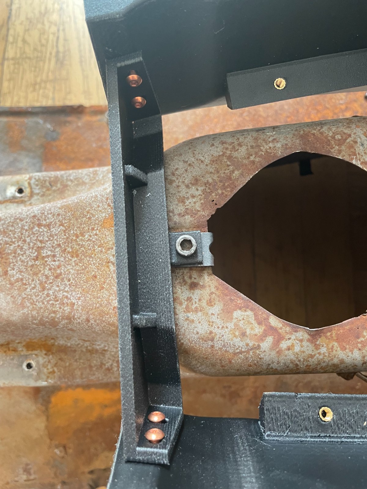

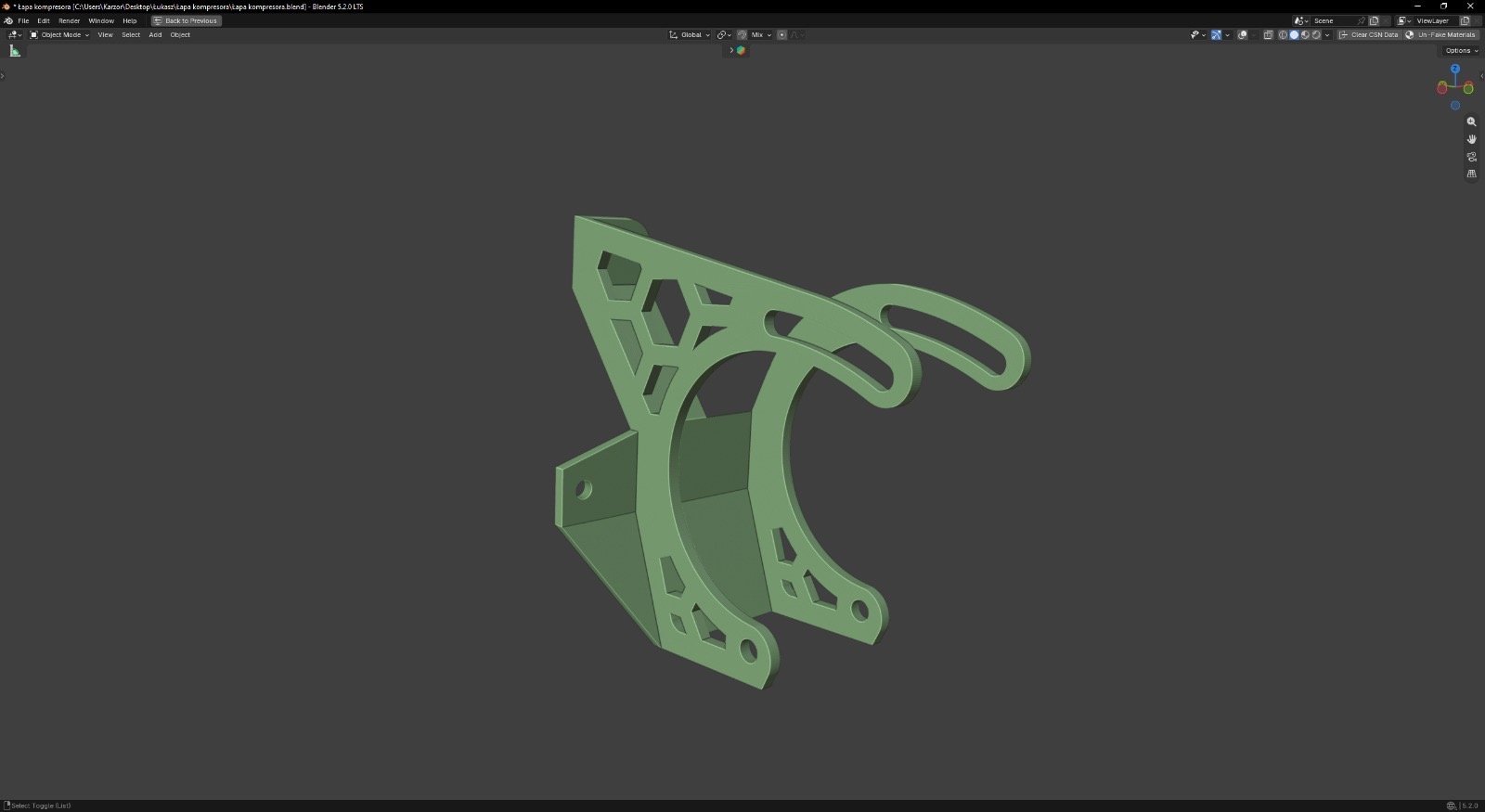

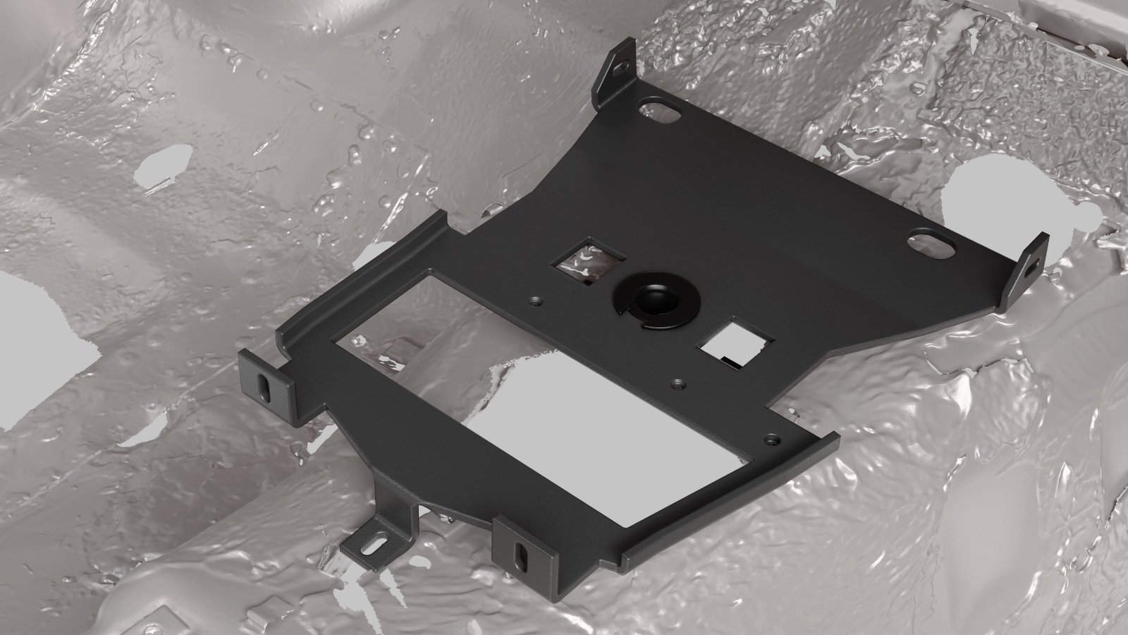

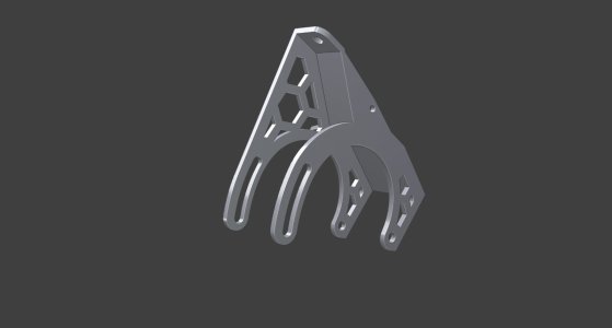

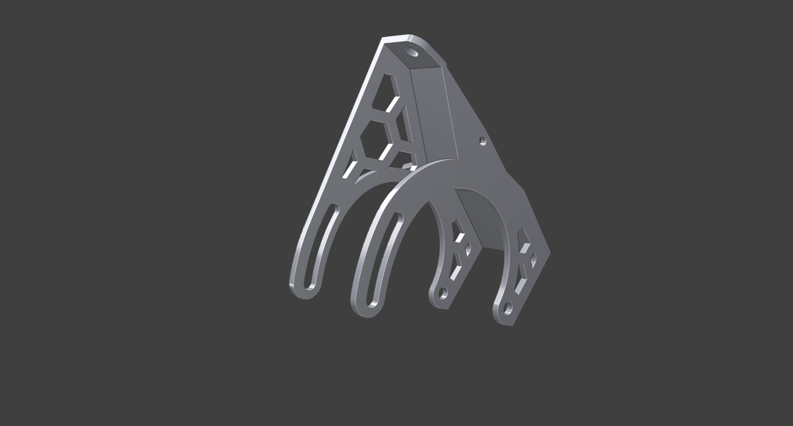

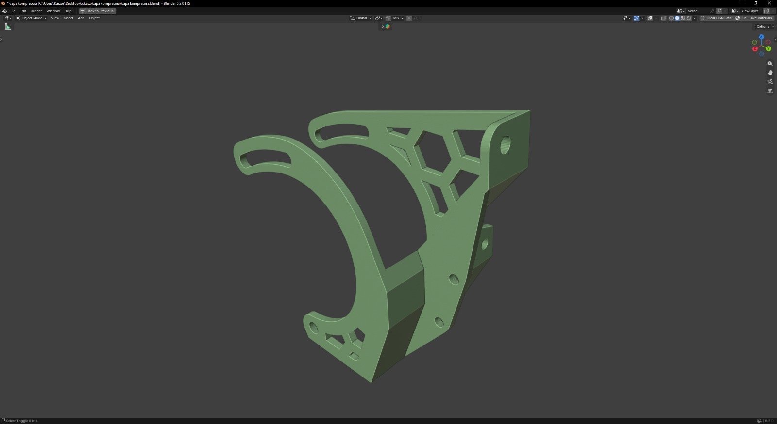

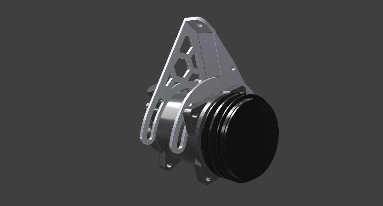

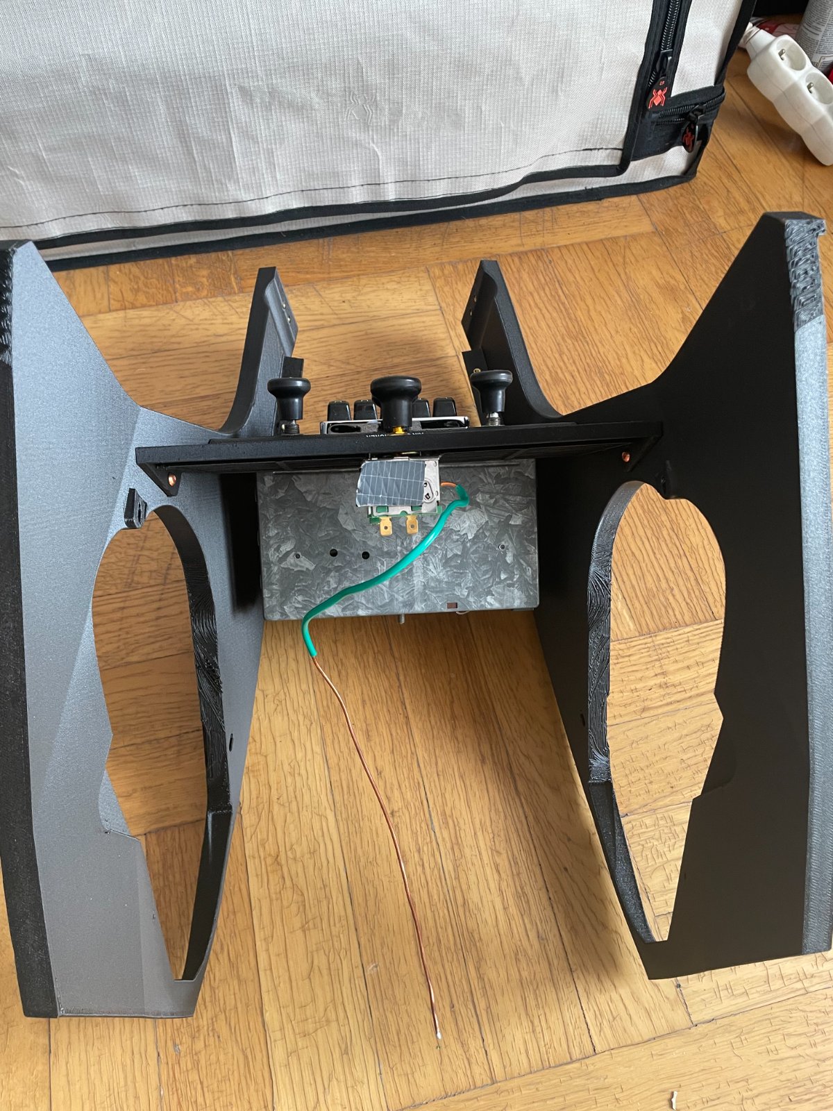

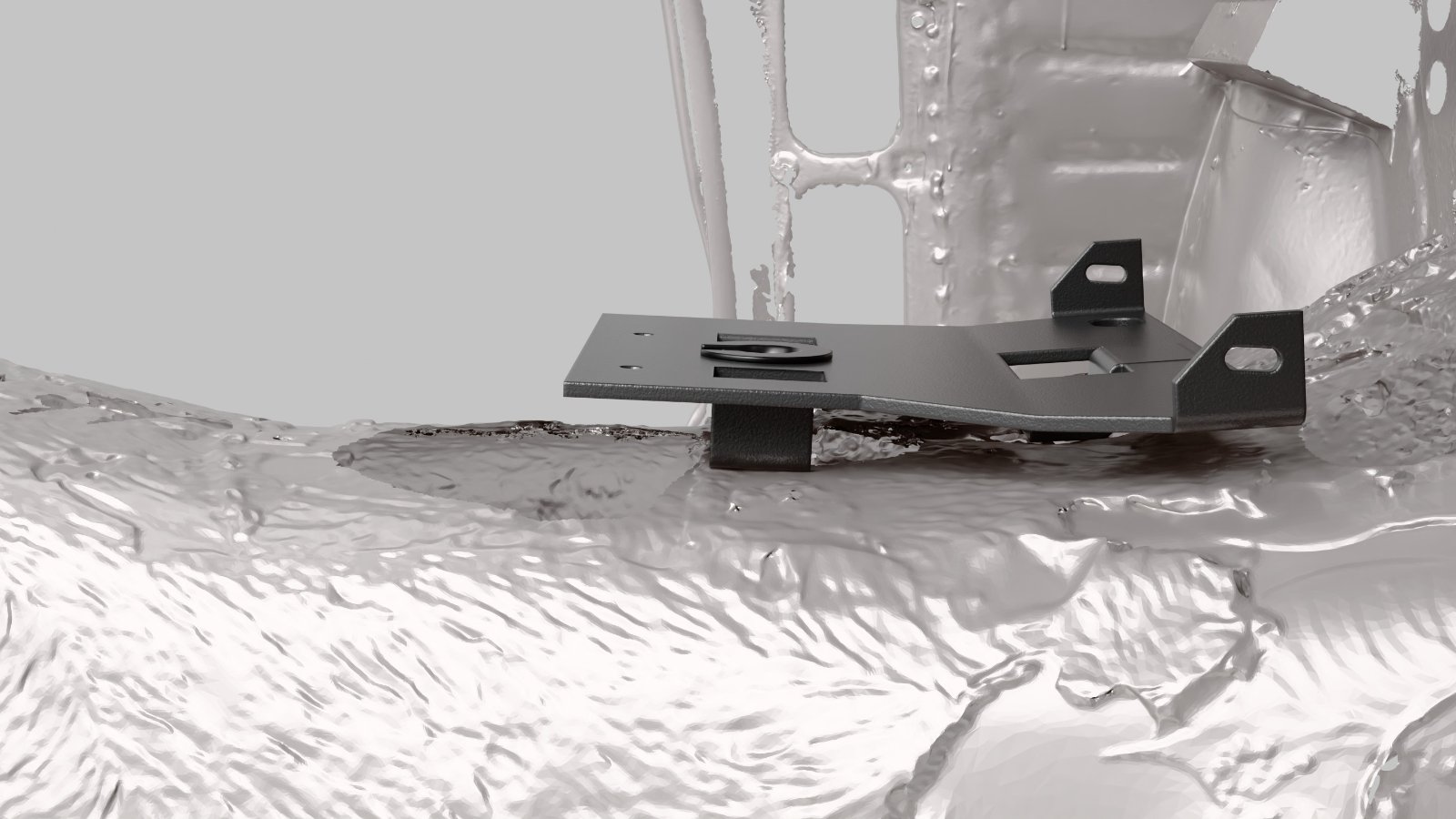

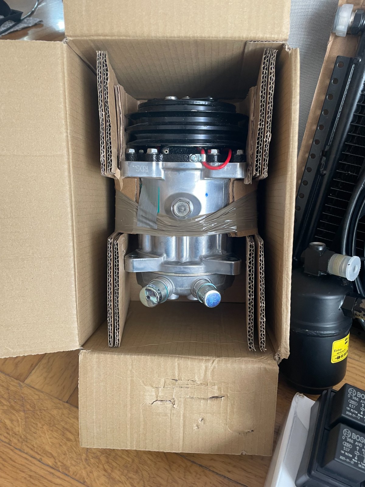

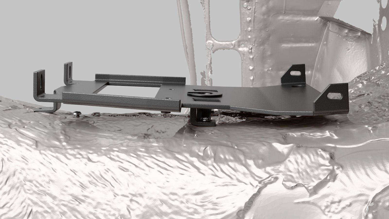

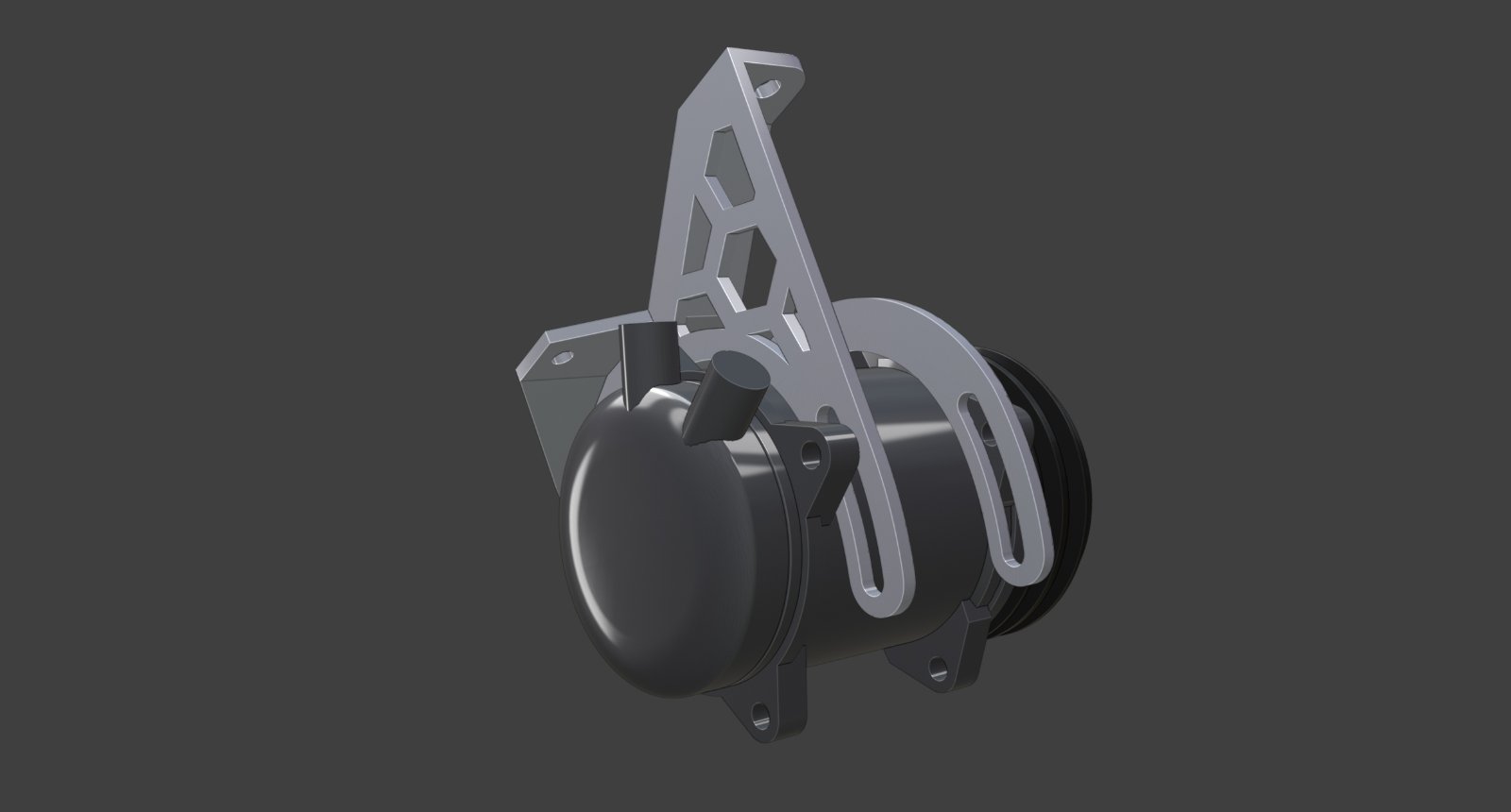

Regarding the compressor bracket—since there have been some questions:
The individual components of the design are currently being cut out.
Once cut, they will be welded and then galvanized.
Perhaps one of the forum members will soon show the entire installation process in a car on the forum...
That missing pulley from the kit is for sale if anyone needs it for their install.
