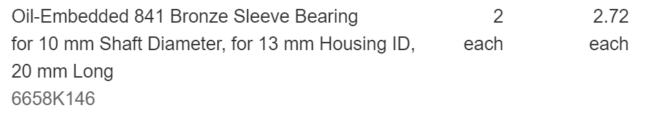

You can buy 2 from McMaster Carr. The shipping will cost more than the 2 parts.
In preparation for my Getrag 5 speed install I have been preparing the short throw shift linkage and was not satisfied with the crappy plastic bushings that came in the new rod joint or the used 320i lever. BMW does not sell replacements for these. So I measured the size of the bores and it is 10mm ID x 13mm OD x 20mm long. A quick search yielded a most excellent company that sells the exact fit bronze bushing.

That's the old plastic lever bearing in the above pic. Now I have tight, smooth bronze bushings that won't distort over time like plastic or have as much play.
Here is the bearing source:
https://www.ametric.com/p-40373-10-13x20.aspx
