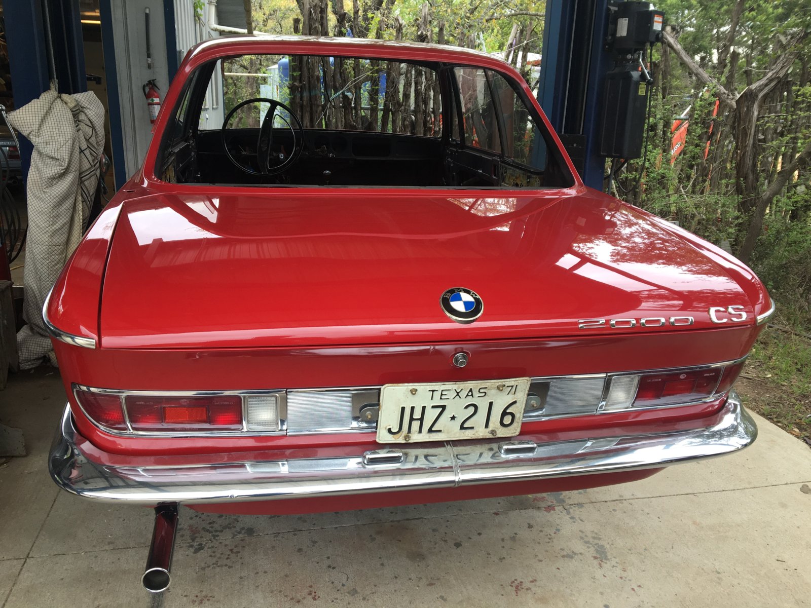

Tail lights are in and test fit the C-Pillar emblem. (Disregard the ‘71 Texas plate...)

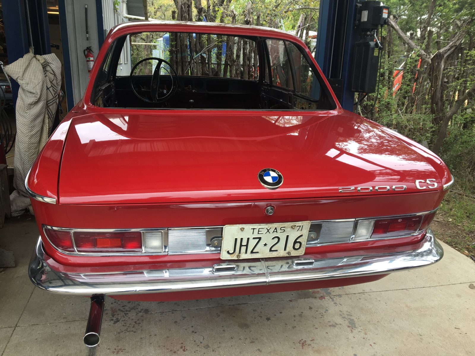

love the red / red taillights of the 2000cs / early 2800cs ... but the red / red on the red car is beautiful. keep this wonderful build going Ed ... its a great coupe
