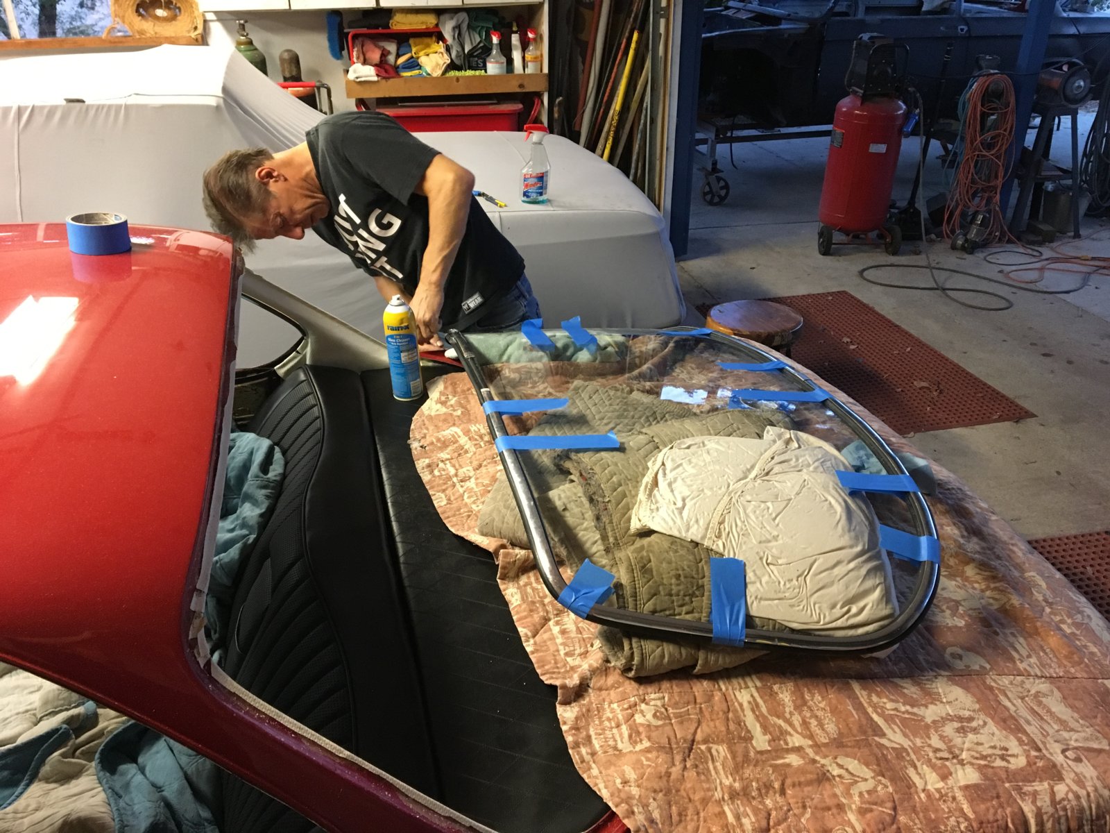

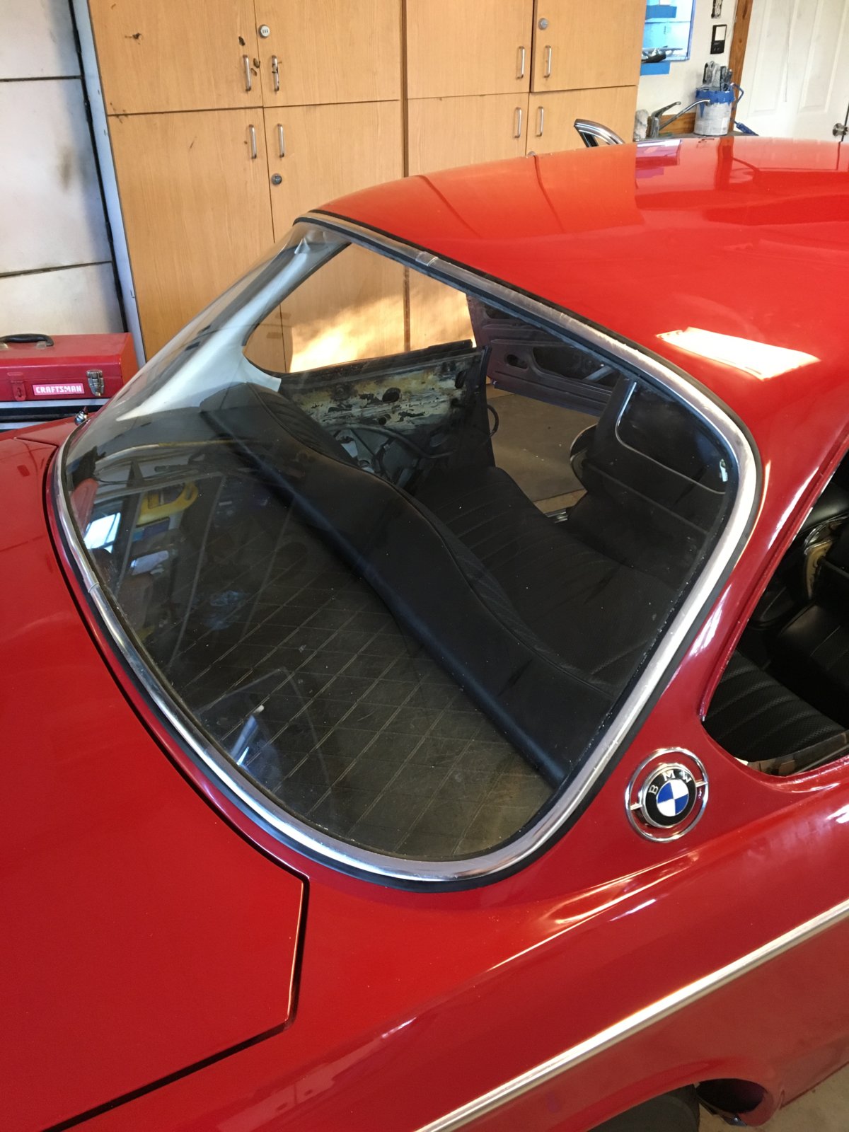

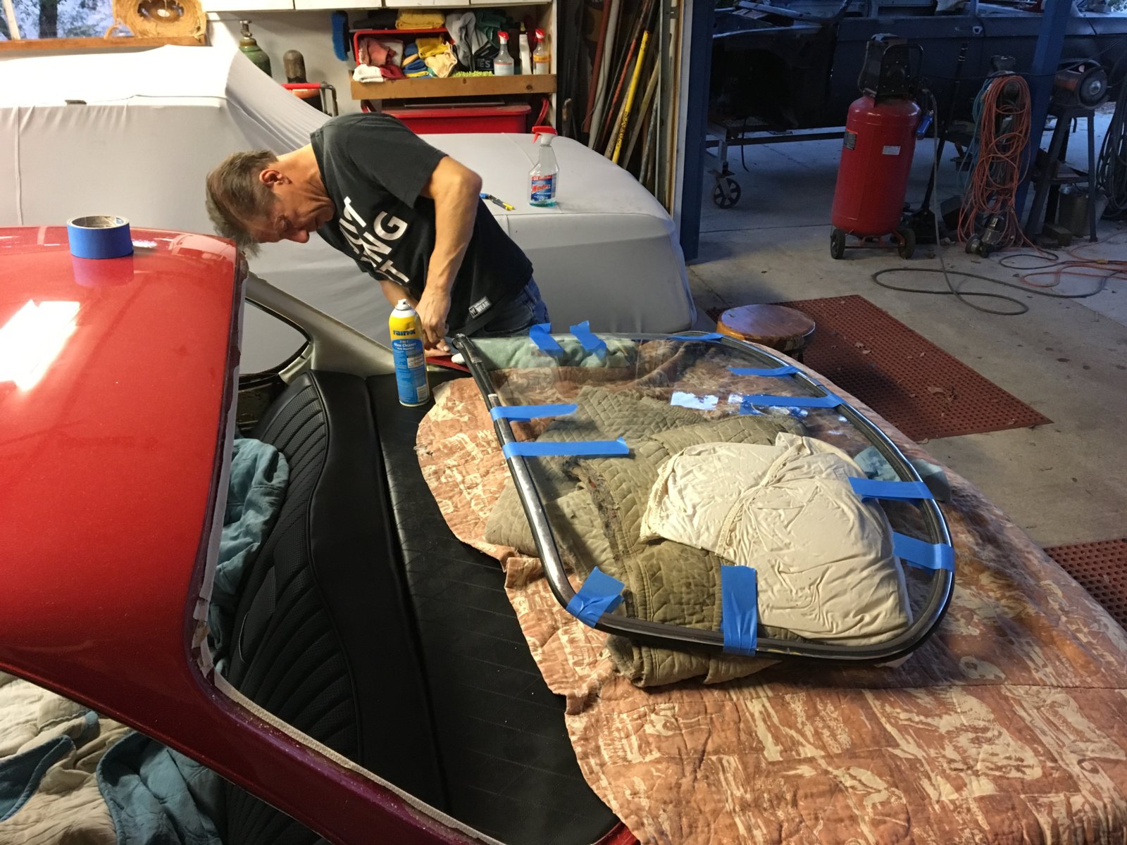

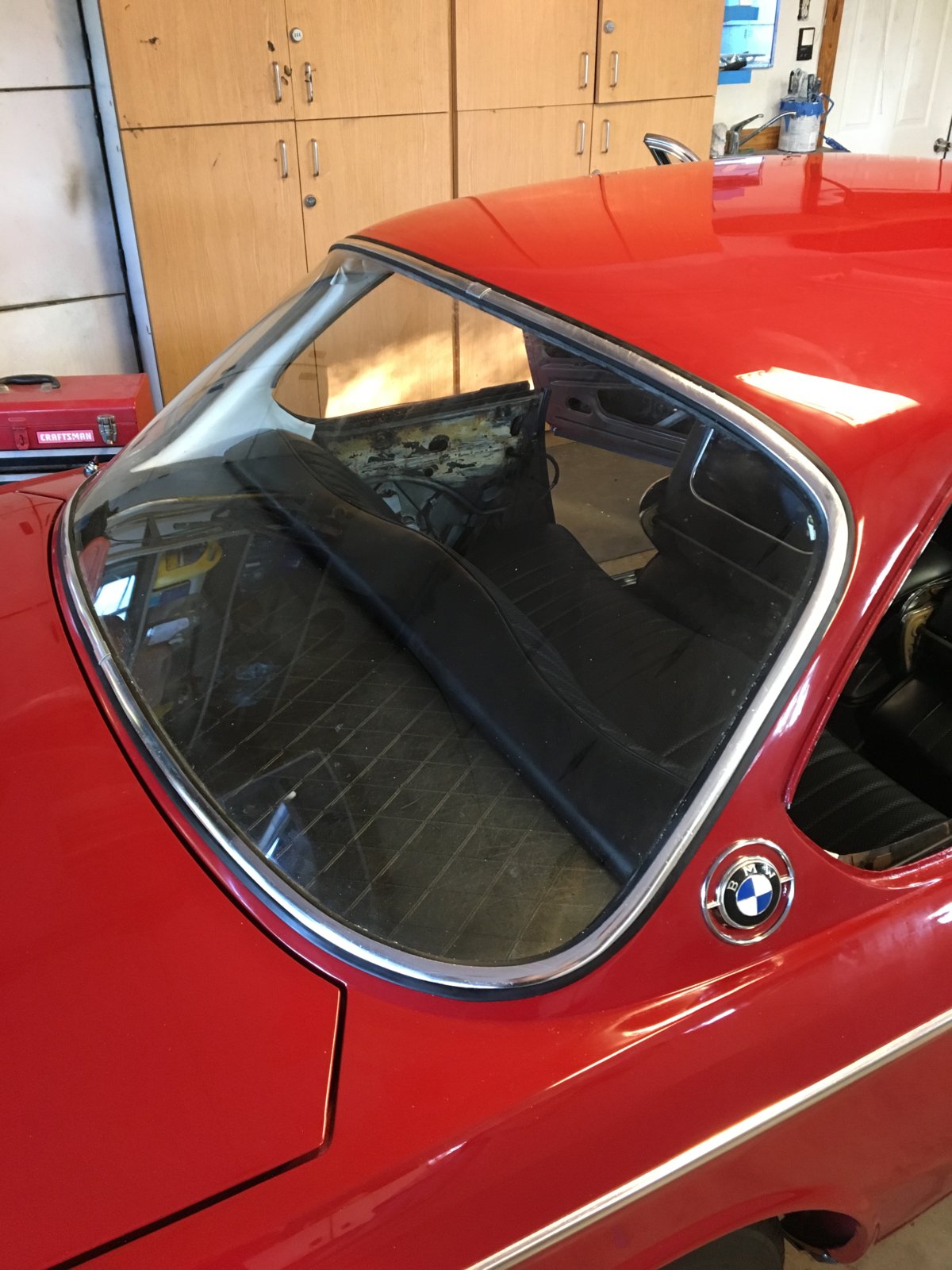

Quick update on the rear glass. I met up with Peter C early this morning and we pulled the rear glass, tweaked the lockstrip a bit, put lots of lubricant on the seal. It went in pretty easily... So happy to have this sorted.
I spent the rest of the afternoon with door jamb trim and other things.
Many thanks to Peter for his expertise and time today. I am very grateful, friend.

Sounds like great teamwork, and a productive day! Also good to hear that some finesse and a copious amount of lube solved this. I'll have to remember this when I reinstall my glass.
