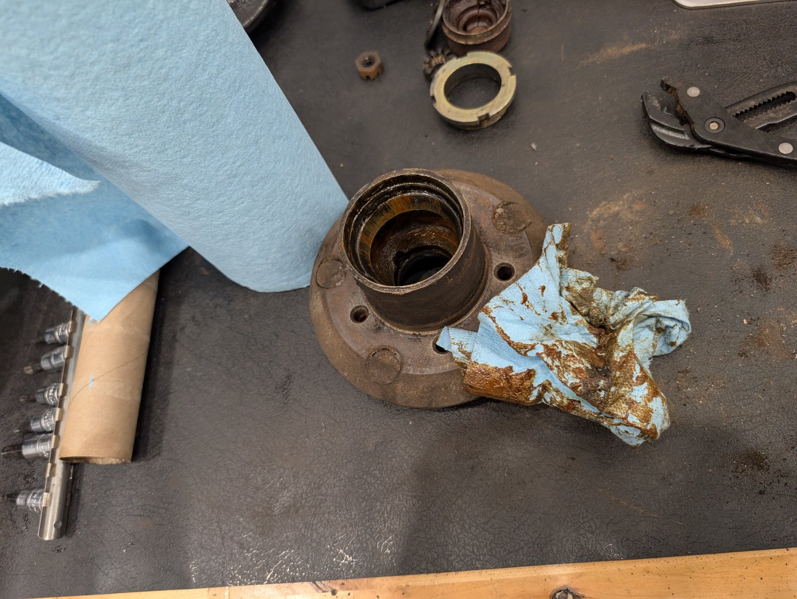

I think I will do the spacer kit from Hal as I have good calipers. Erik... I know its hard to see in pictures but I already procured the rotors and they are on. Did this when I put new bearings in the front hubs.
The hubs were just nasty. I just don't understand why people just throw globs of grease in these and then go.... all good!

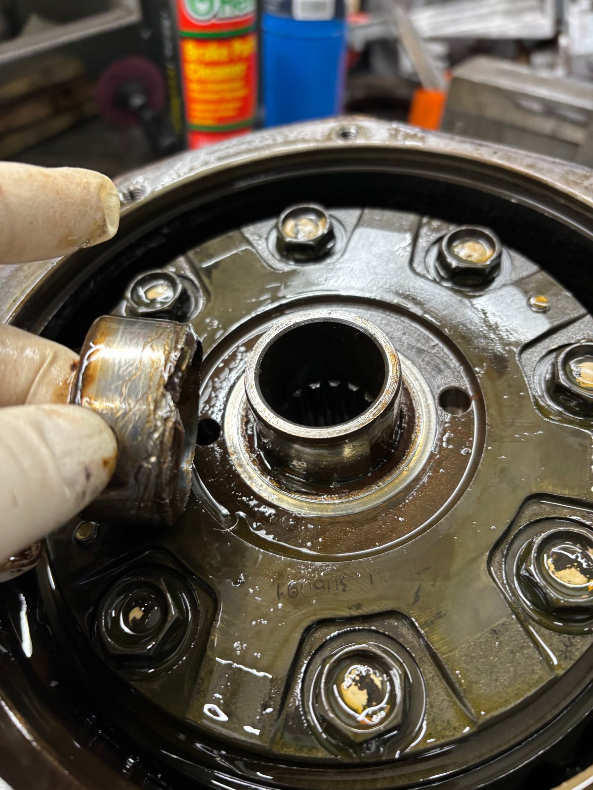

The next item of bad news...

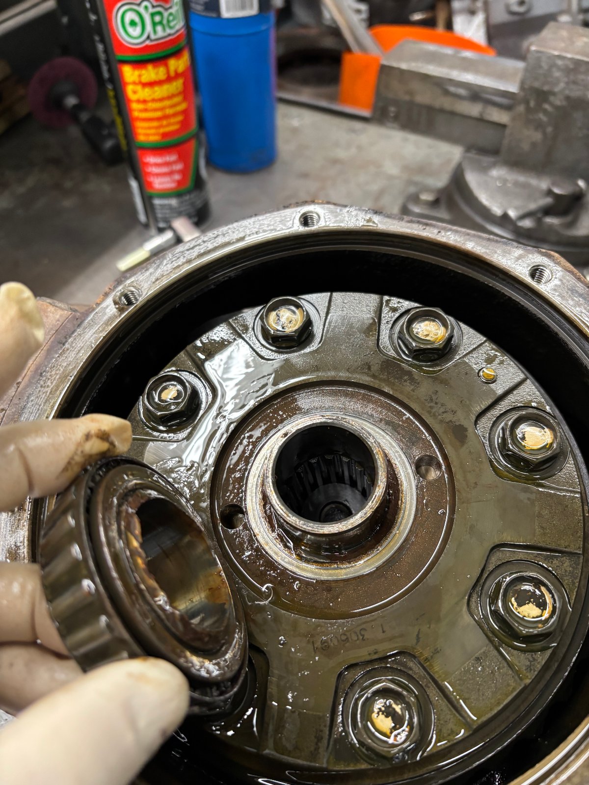

1st my car is (was) a LSD car...thats good.
Bad news... the housing is broken (pics).... and apparently the part (33 14 1 201 950) cannot be located...

As to the diff, it's an 8 bolt diff and those are pretty much impossible to do much with. You can't get different gears for them and you can't covert them to a 10 bolt. The 10 bolt unit is the one to have, although 10 bolt LSD's are getting pretty scarce.

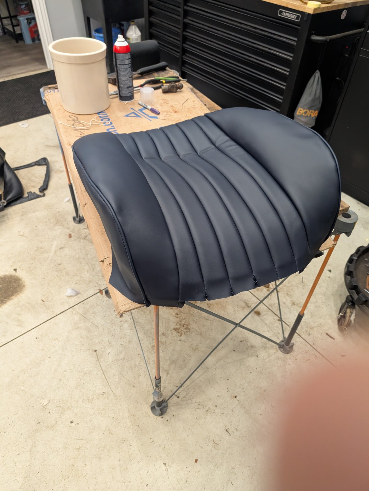

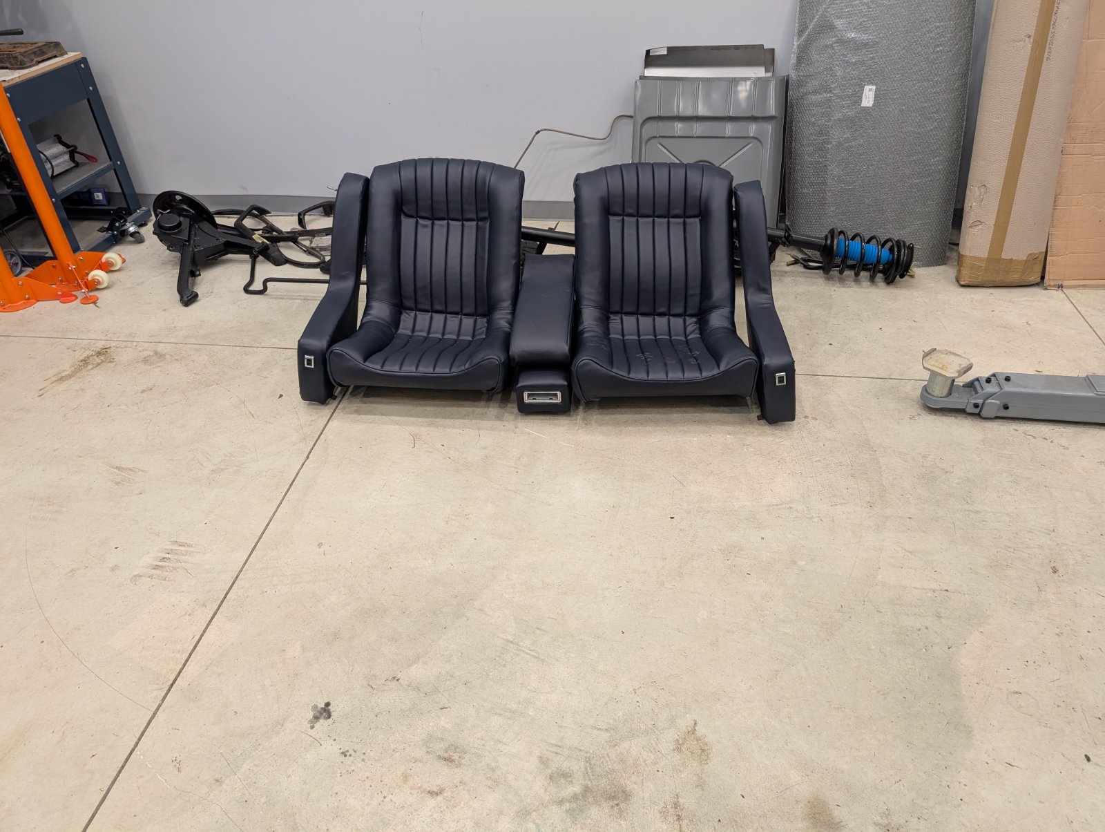

Well I did the rear seats and arm rest etc.
I got the kit from Steve Sperling. Supremely nice guy. Sent samples for approval. Great color in my opinion.
All in all good quality. A few complaints. The corners were a bit bulky.. particularly at the tops of seats where the material is thick. That is a tough thing to master. The material was cut very generous...very large "pockets" in the bolsters. Had to fill quite a bit. But didn't want them to look over stuffed.
The outside arm rests were a little short. Had to settle for cheating at the top as I wanted the seams to look straight.
Now as for the final... Well almost final. I'm still fussing as there are more wrinkles than I would like. But part of that is me... Put them in the sun... Tweek. We will see. But I am mostly pleased.

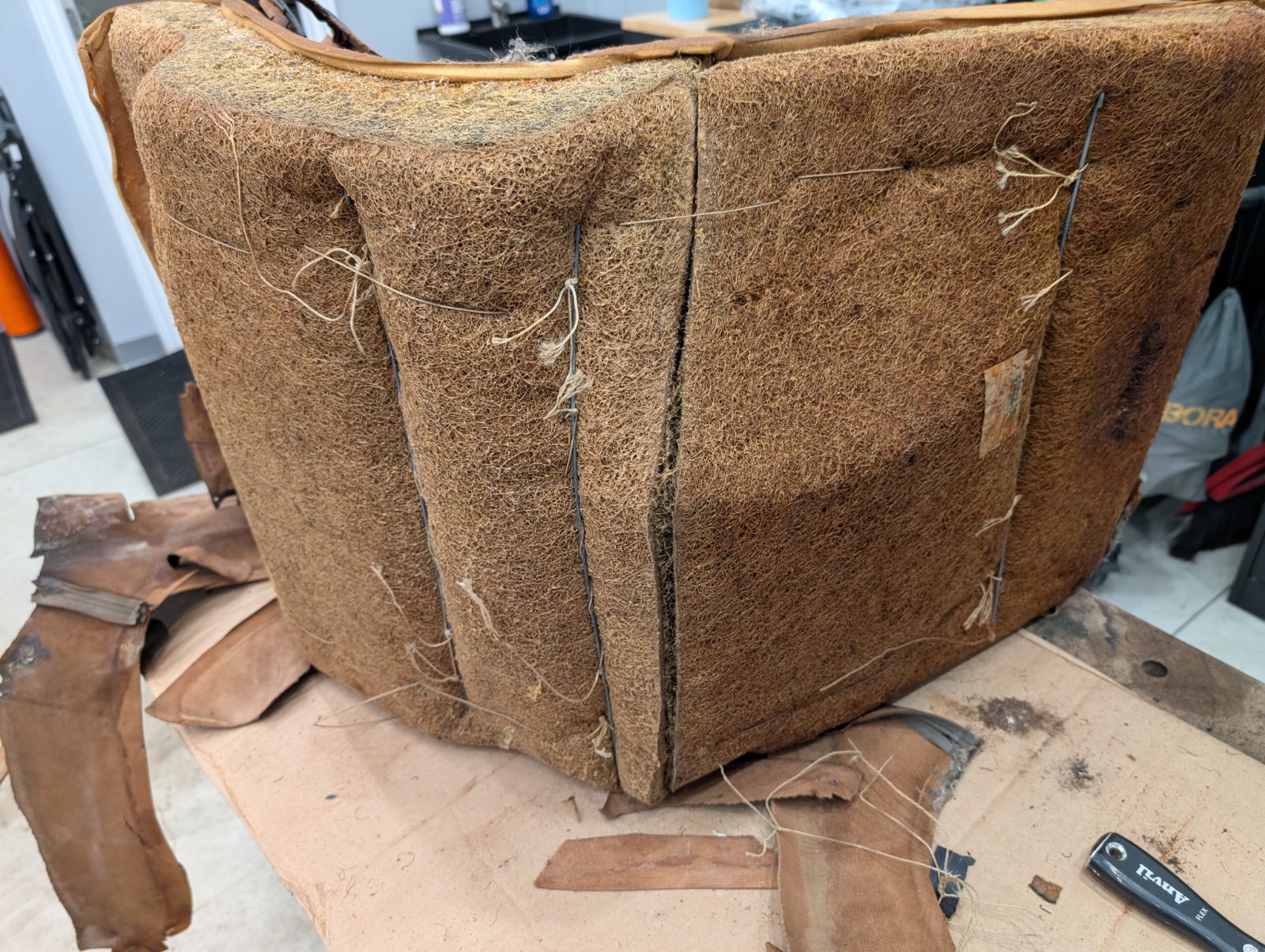

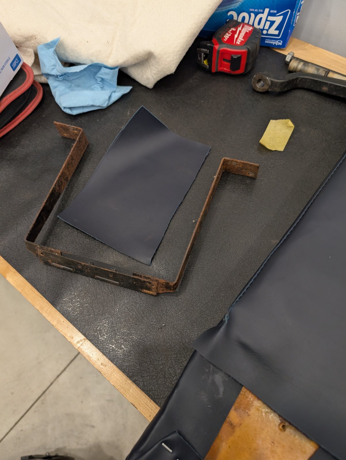

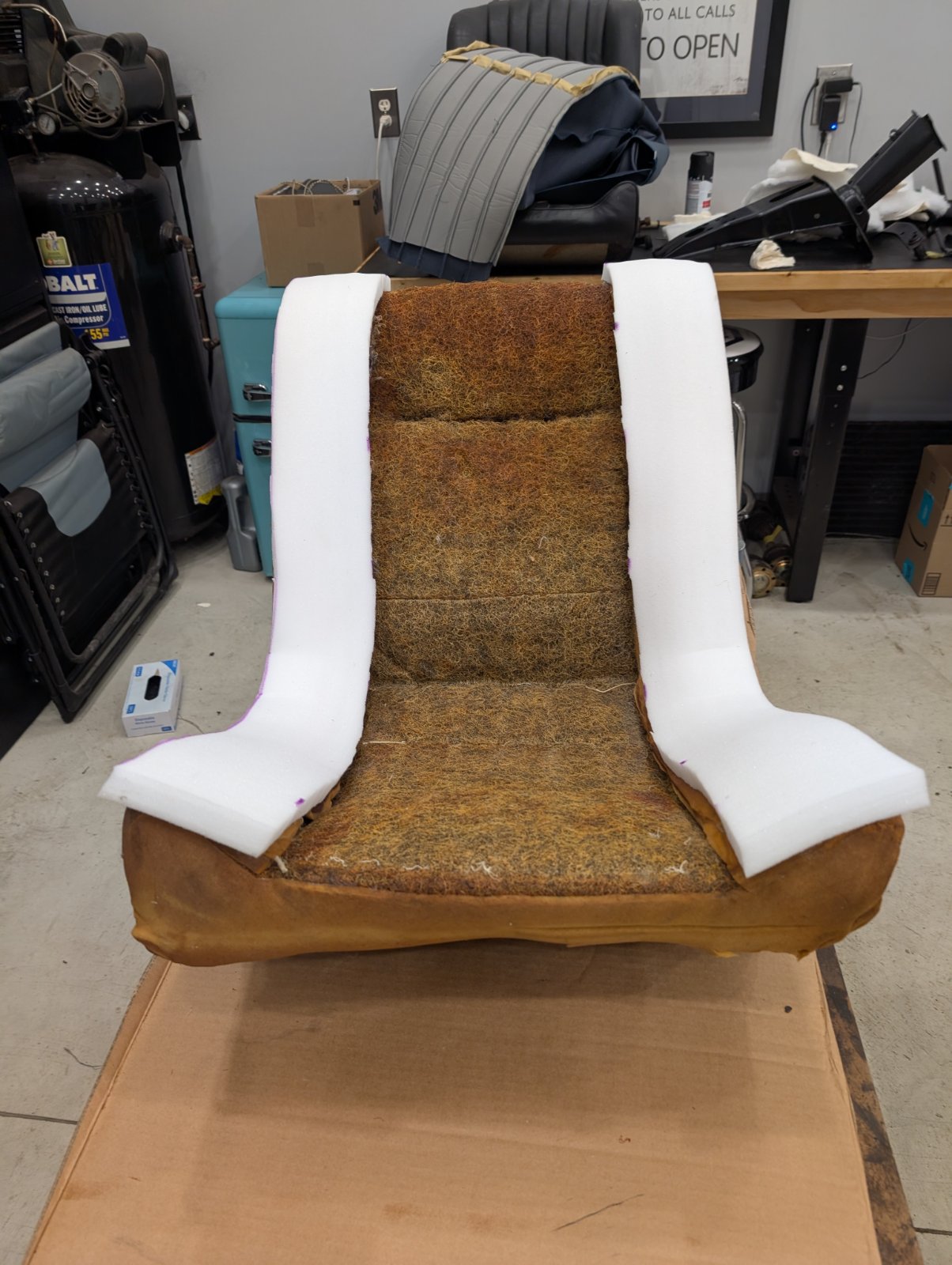

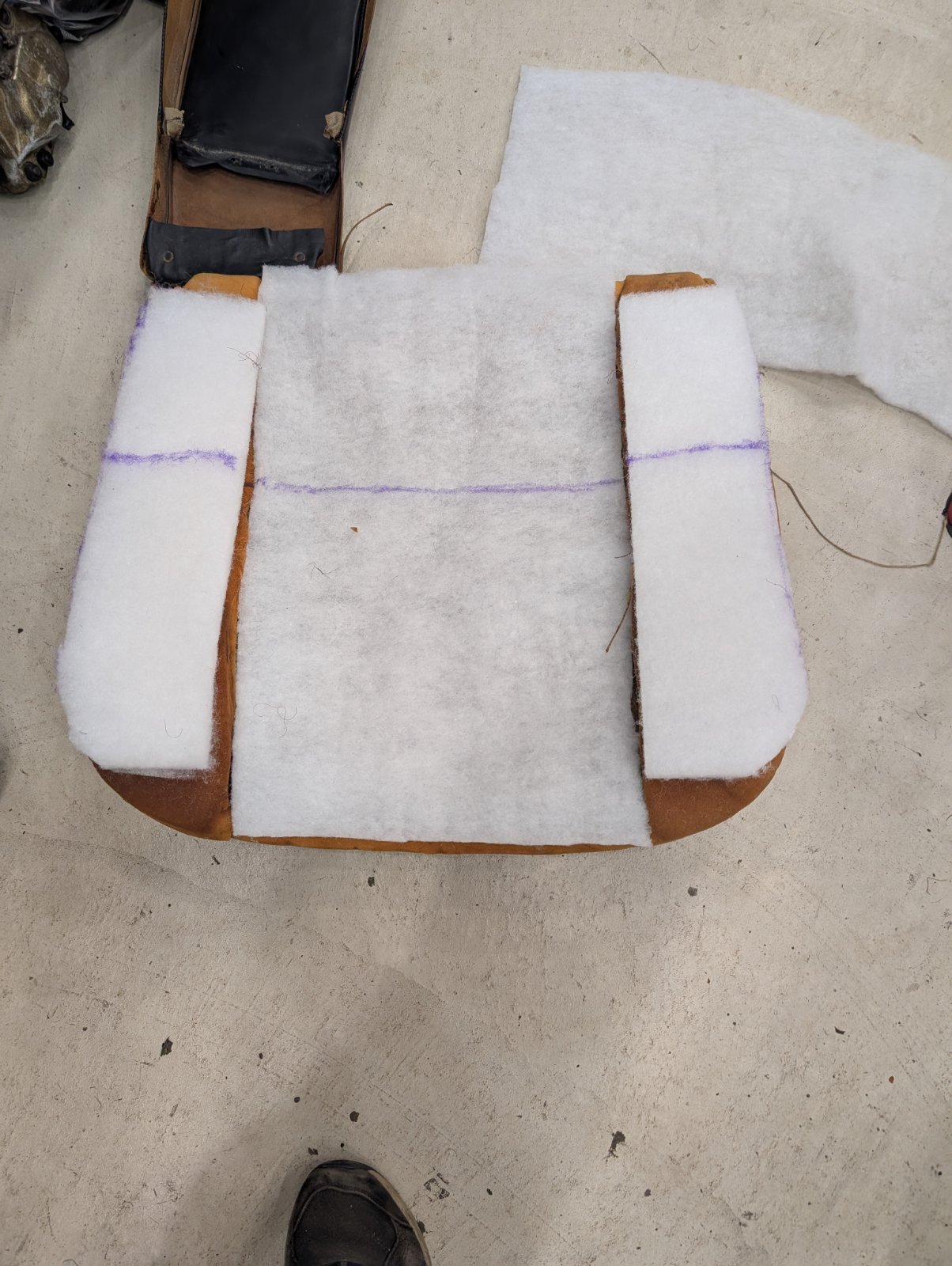

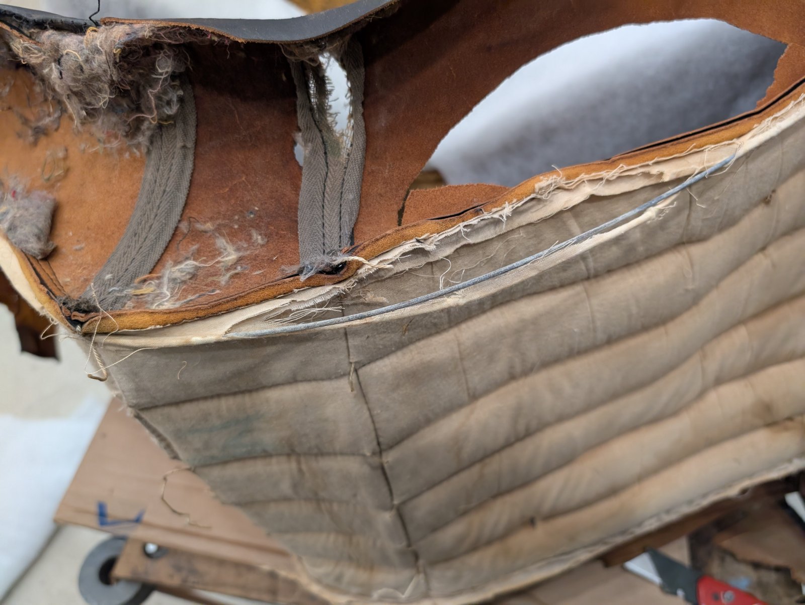

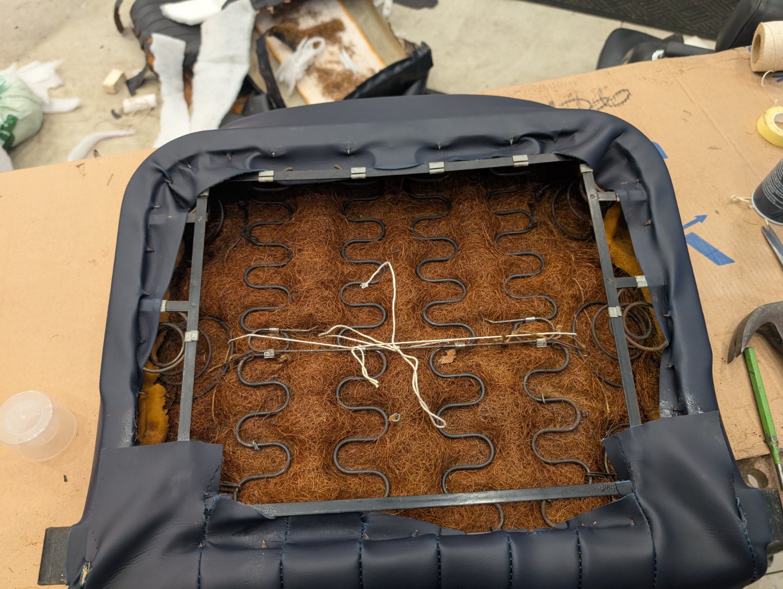

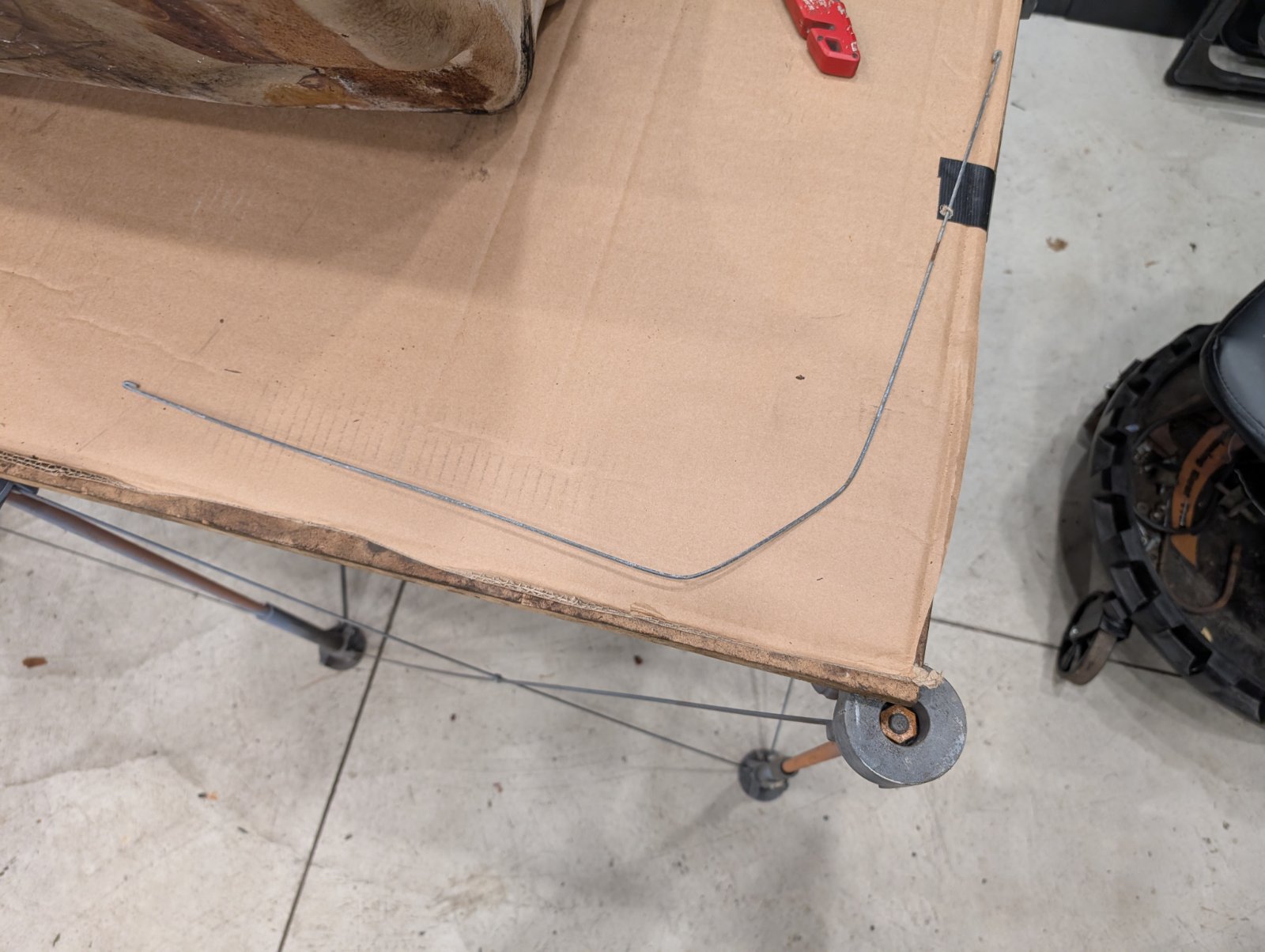

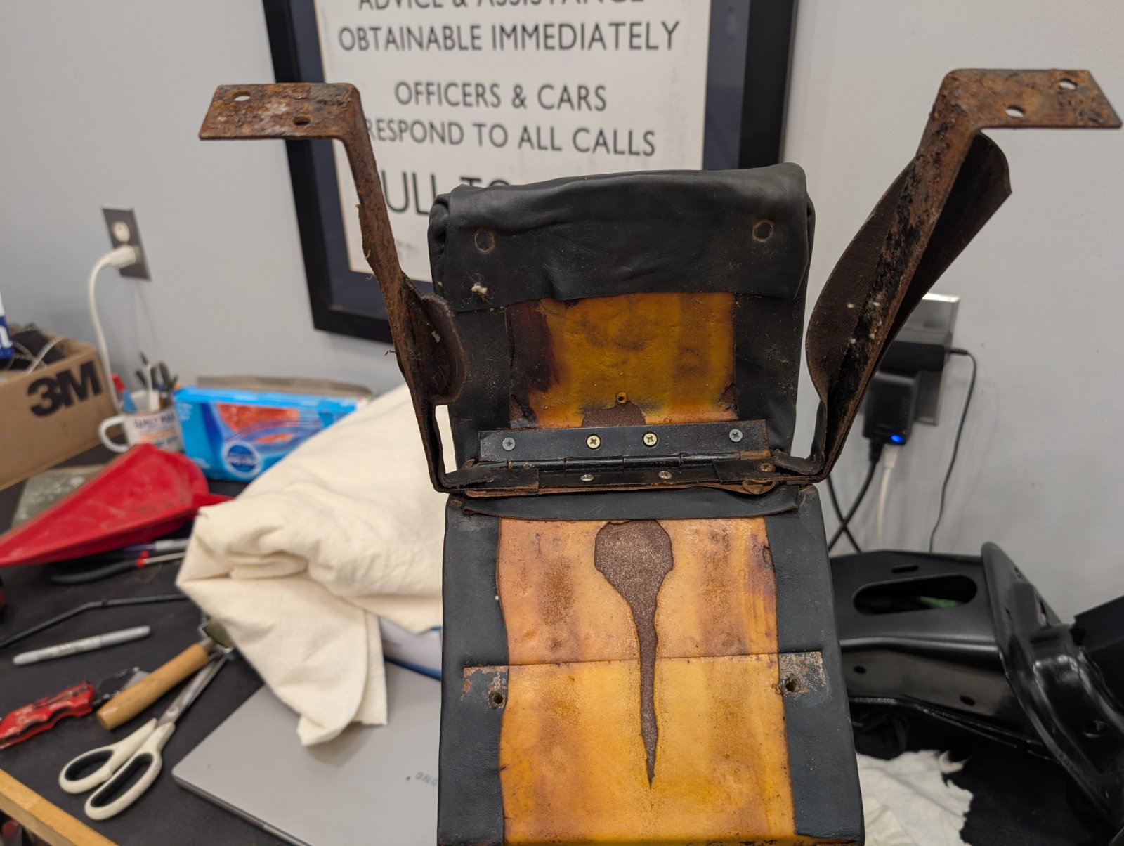

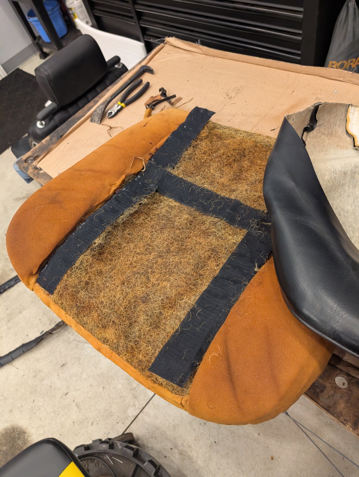

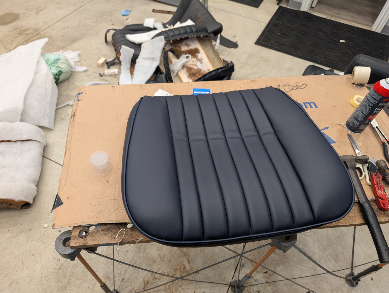

Few things I learned or thought I could pass on.
Make sure you have your pocket rods from the old seats. As you need to tie them down to the horsehair in multiple places. I did this a bit different than factory. I did many small stitches instead of long looping runs... Just easier for me. Tie everything in place first... Then fill foam etc.
I had to add serious amounts of fill due to the generous bolsters pockets. Glue foam and then steal the bread knife from the kitchen...don't tell the wife. To sculpt the foam. Yes the pictures look like over kill.
Take pics. Watch the screw holes in the arm rests... Don't cover them up. Save the material from the flap on the arm rest ... You'll need it to cover the metal bracket on the arm rest... Mine were covered. Have not done that yet as I was waiting on the paint to dry.

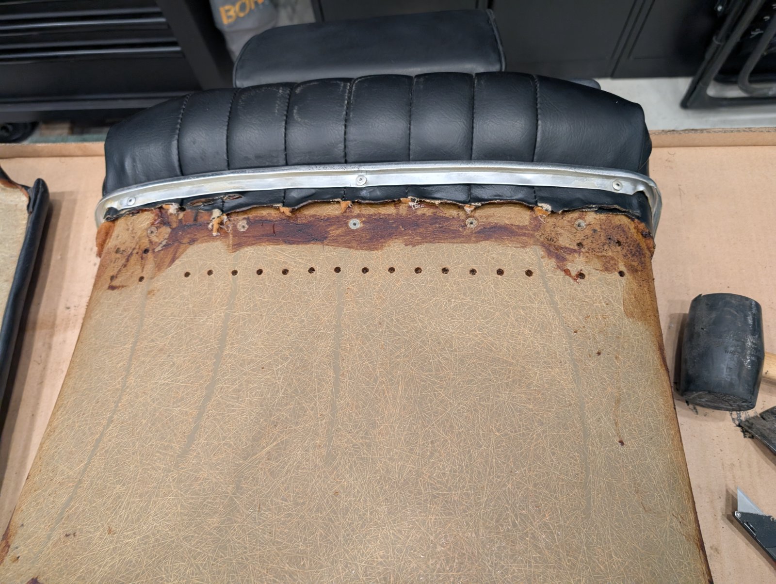

So started on the fronts today.... Umm yah. Much more complicated.
Only got one torn down and the bottom done and the top on but not buttoned down.
The drivers side was recovered at some point ... Very poorly. Velcro and a bad set of covers. They broke things and I wondered why the seat has a bit of a Detroit lean going... They lost the retainers for the recline and had half of it unhooked and crooked.
Had to rebuild the foam and beef up the horse hair. Not quite as bad as the backs but fairly substantial.
Some of the fun... Oh also had to make my own pocket rods... Those were gone.
