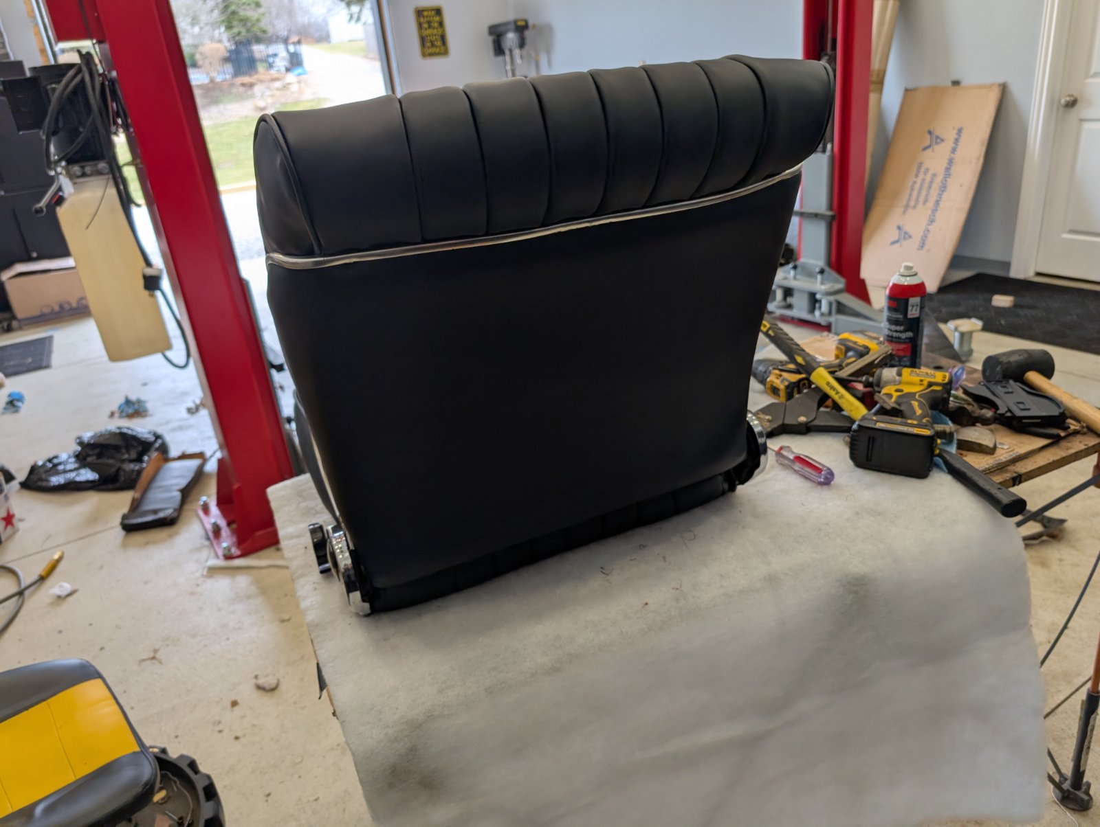

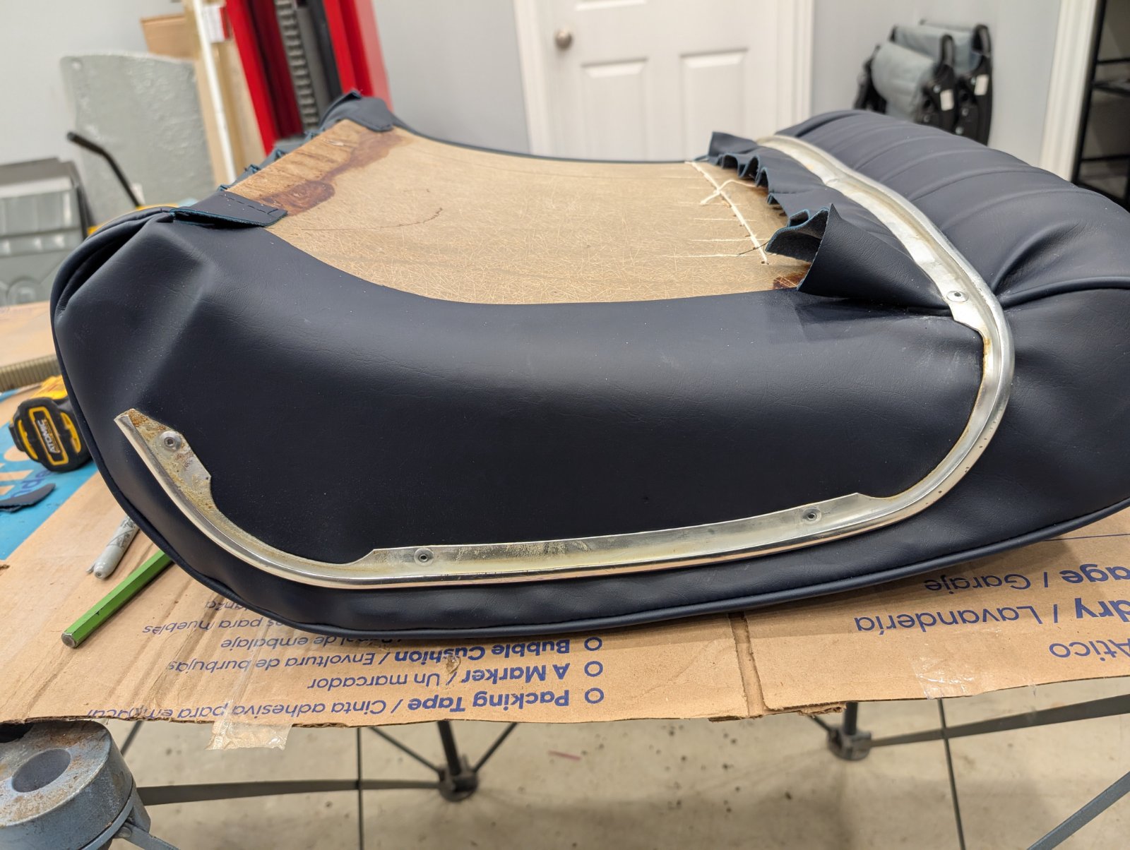

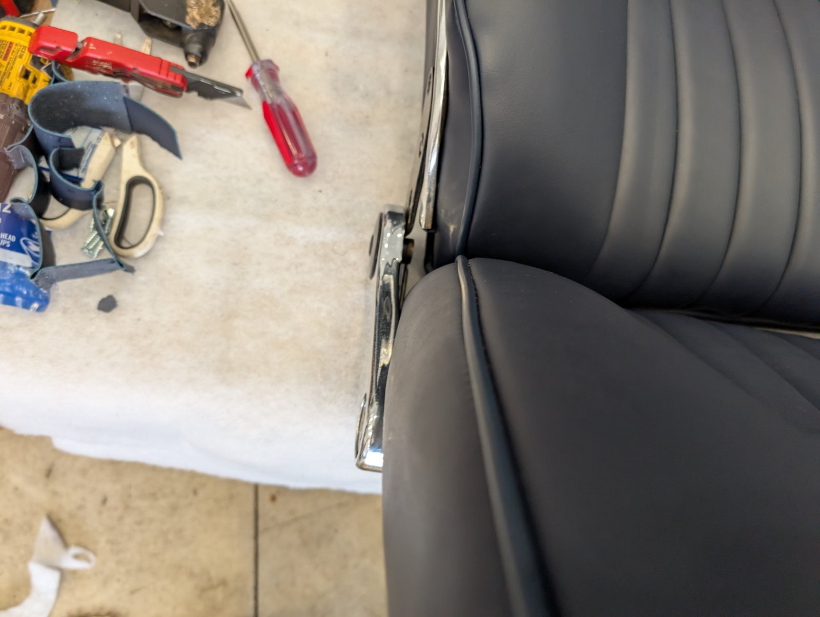

I did finally beat the drivers side into submission. Had to fix the mechanics that the PO messed up and the learning curve was a bit long. Pretty happy with them all except the top corners... Again the covers were cut a bit generous and with the piping on the edges I could not get that tuck around the top edges like the old ones.
They look a little "barco lounger" without the headrest.
Few things I learned...
To reinstall the chrome trim on the back use 1/2 long 5mm rivets. I also had to drill a couple new holes as the old ones were torn up.
Even though I used the original holes as a guide I still had to adjust the trim to meet the back properly and I had to straighten the trim as previous installs dented it a bit. It was okay to reuse but definitely not condition 1.
When reinstalling the top to the bottom do not install the circlips on one side of the brackets you need to move one around a bit.
Install and tighten the 3 side screws with the adjuster cable in the base unhooked so you can even the sides out. I used a profile gauge to get the angle of each bracket similar. Then I tweeked it by eye.
Don't forget to install the back release rod in the seat back... Yes I'm an idiot.
When you have it where you want... Install the circlips on the bracket and install the adjuster cable in the base. Then remove two of the screws on each side one at a time to put the chrome covers on.
I did not expose the screw holes prior to installing the back... Do know if this helped or hurt. Just the way I did it... Lot of material to cut through there.

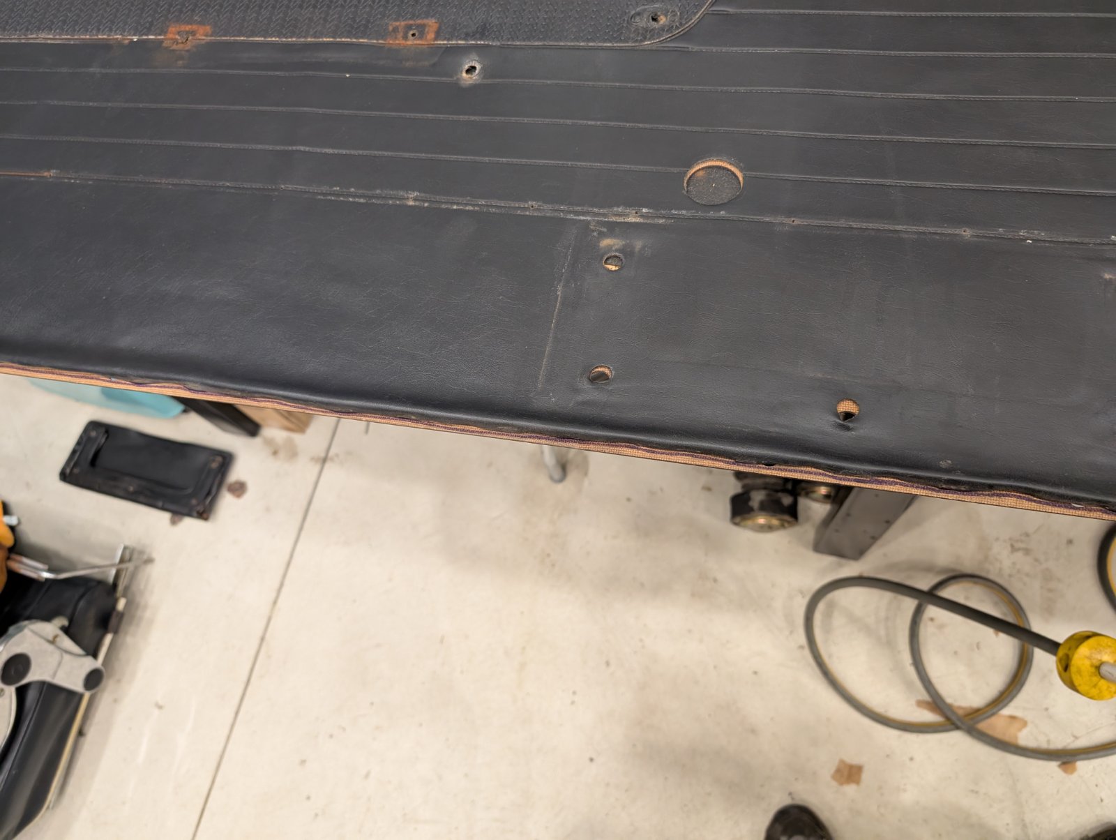

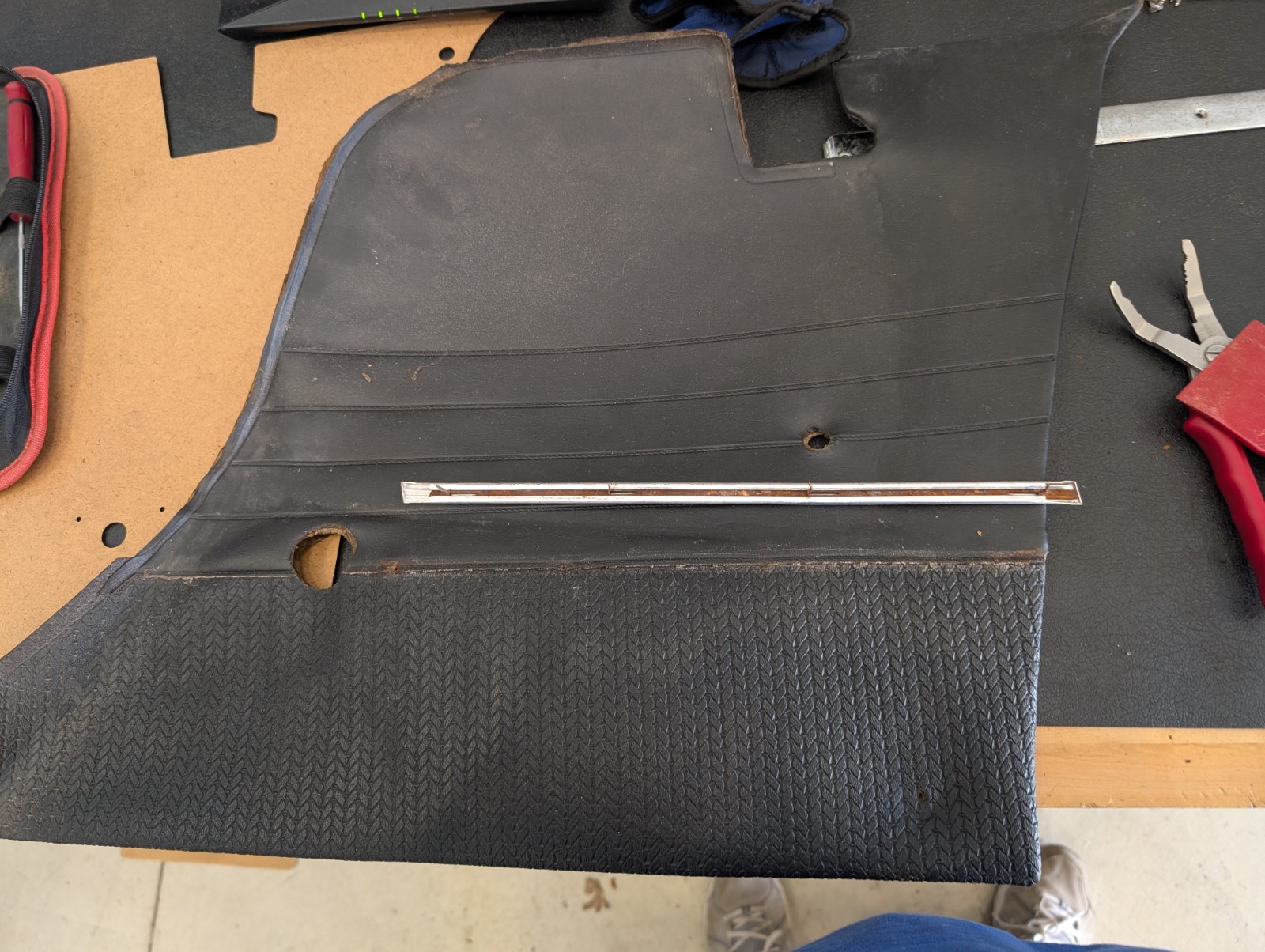

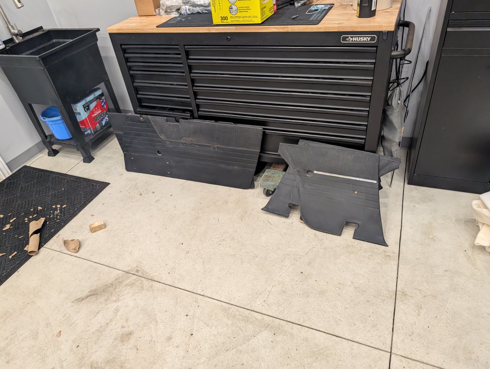

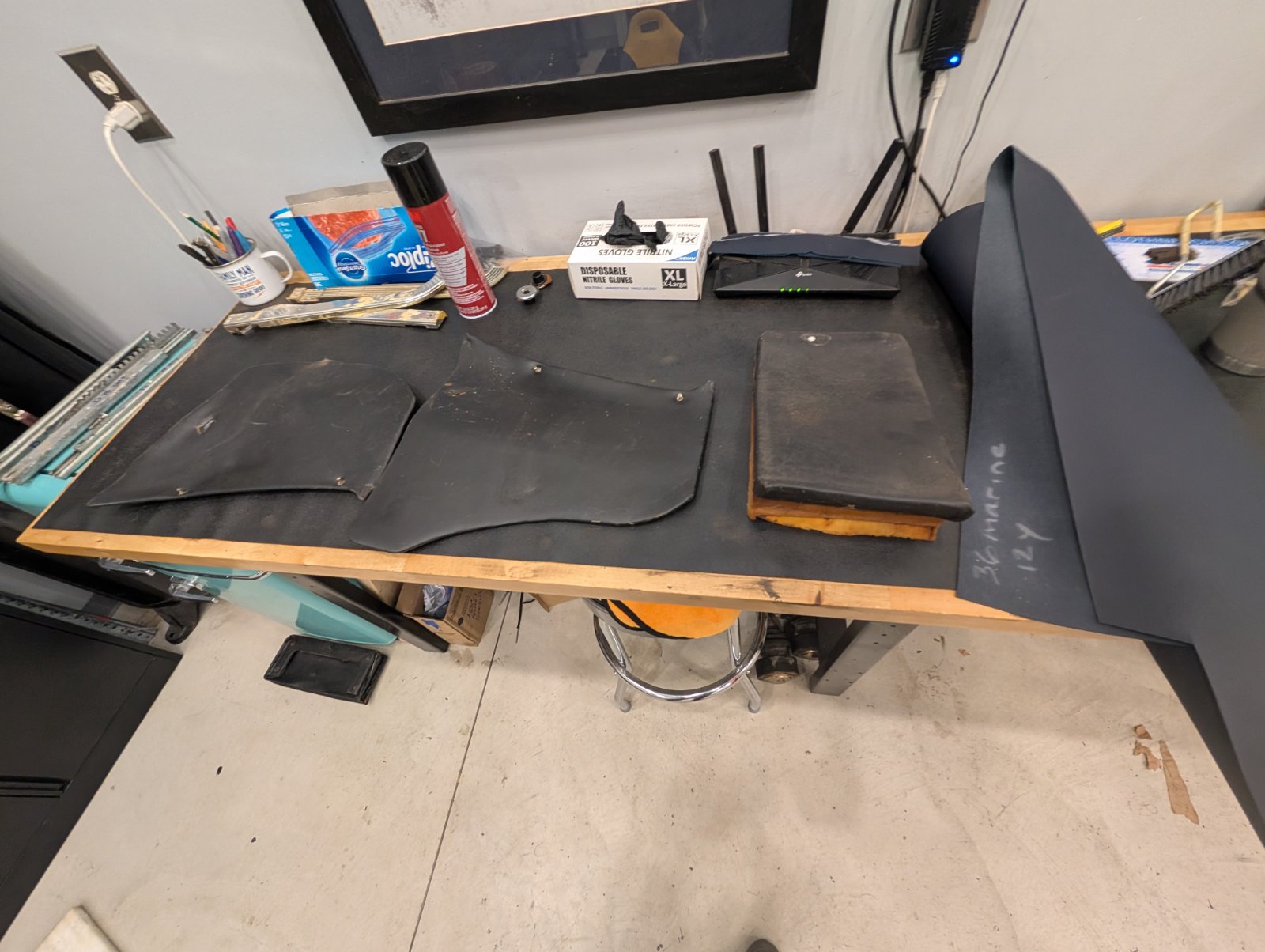

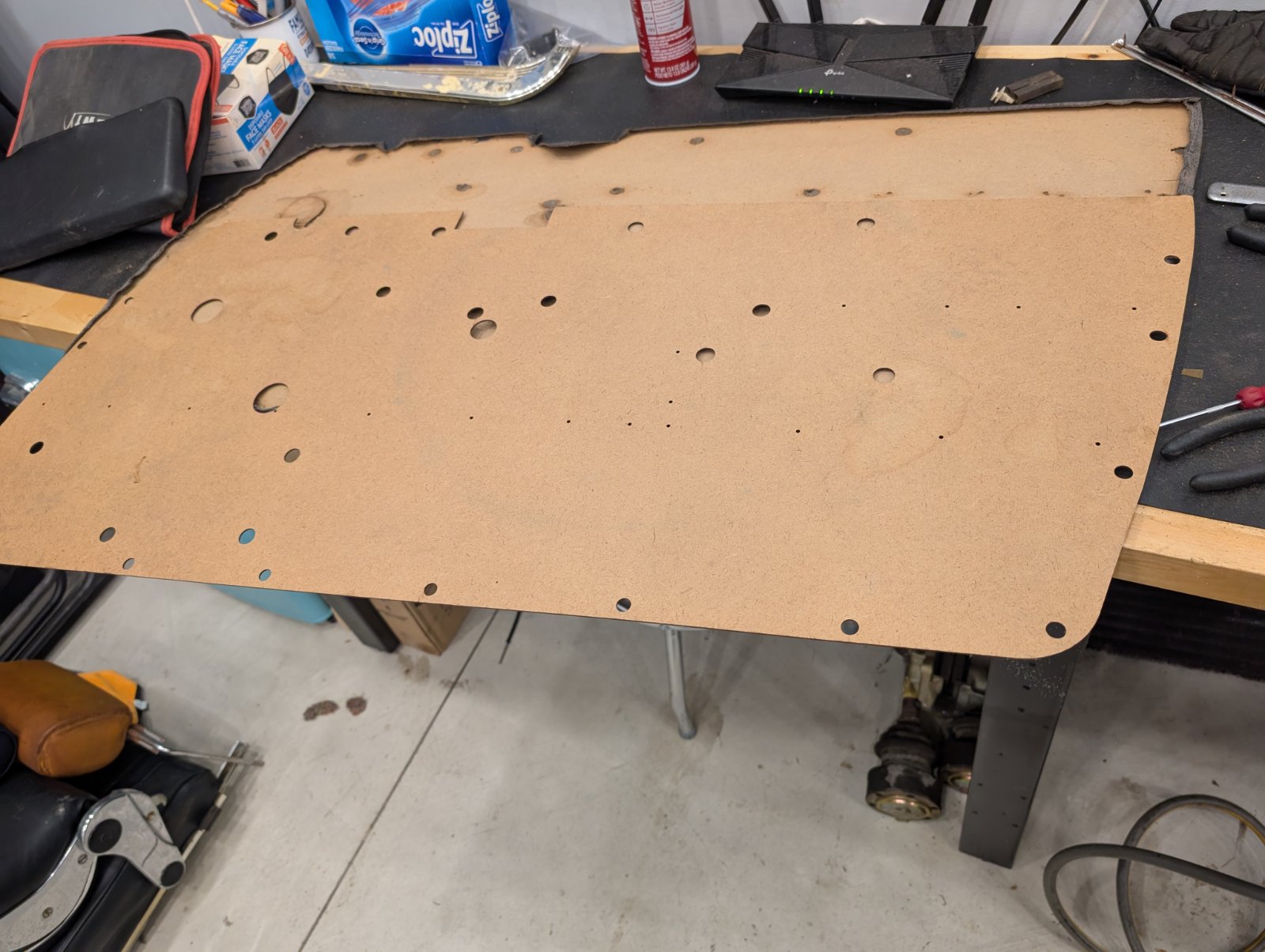

Pulled the trim and vinyl off the door cards.
Big thanks to Alvaro... @alprada70 for the cards and replacement trunk pieces that I did not have. Those to come later.
The vinyl had shrunk a bit so it was a bit of a challenge to get it to fit. The only real problem was the bottom of the drivers door. Most likely saw the most weather.
Took a swatch of the seat material to my paint guy so he can match some vinyl paint. Checked in with him today.... It's a challenge as it's a dark blue and those can be really tricky.
I'm sure he'll get it. Armrests, door panels, tops of the headrest brackets, map pockets... It's a lot to paint. Hope he makes enough.

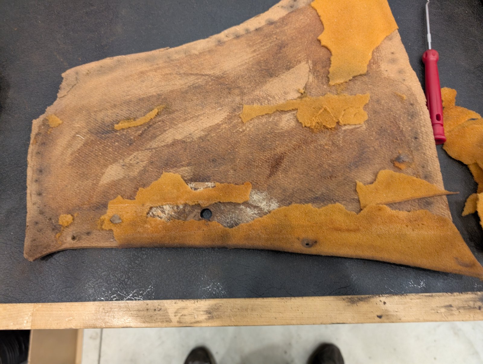

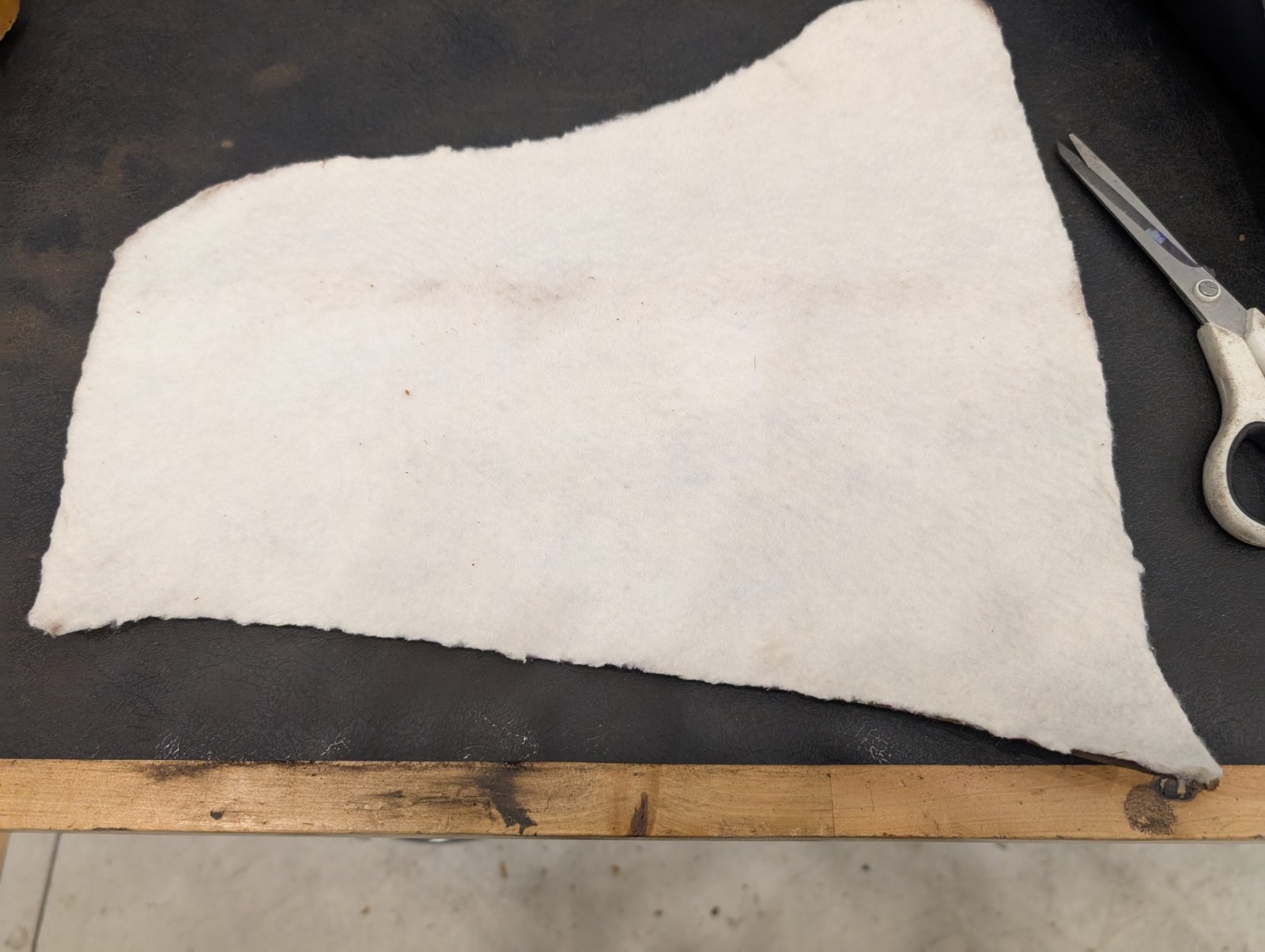

Pretty straight forward... Remove a million rusty staples. Gently get under the paper backing and pry it up... The vinyl is old obviously... It will rip if you are too aggressive. Map pockets are held on by small nuts and large washers.
Nothing more than stretching as you can putting a bunch of staples in... And I mean a bunch. I have an air upholstery staple gun.

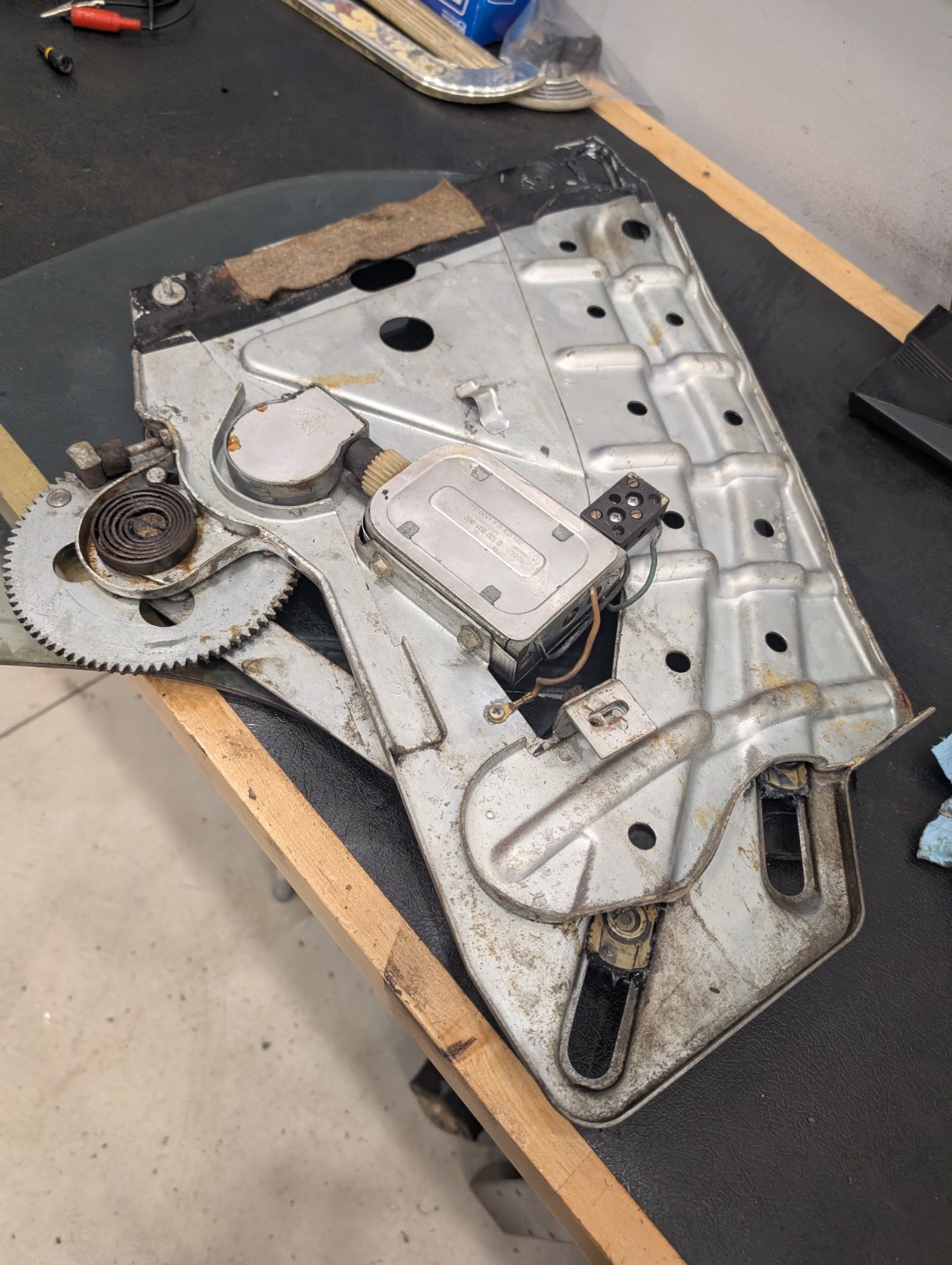

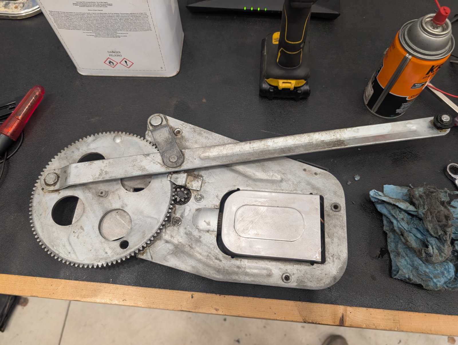

So I was procrastinating doing the last seat. Thought I'd do something else.

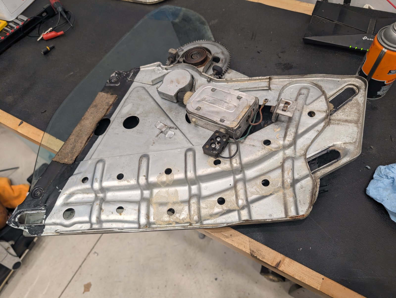

Three of the four windows were not working and the one that worked... Not well.
So I decided to check the window motors. Hooked up a test rig and checked the front ones first. They run perfectly but the mechanisms were all gummed up. I am sure the tracks are awful and I'll get those out and do a thorough cleansing.
I got the backs down from the loft and started on those. Pleasantly surprised that these motors work too. Major caked on grease... Rust and filth. Lots of cleaning.
I put kroil on all the joints and copious amounts trickled into the gear boxes on everything. Moly lube on the guides and channels.
Everything is running nicely now... Faster than I thought

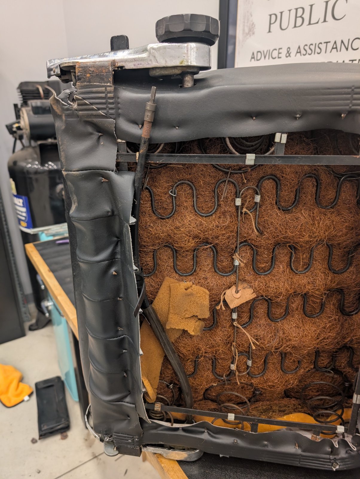

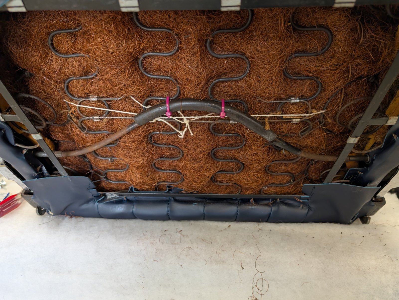

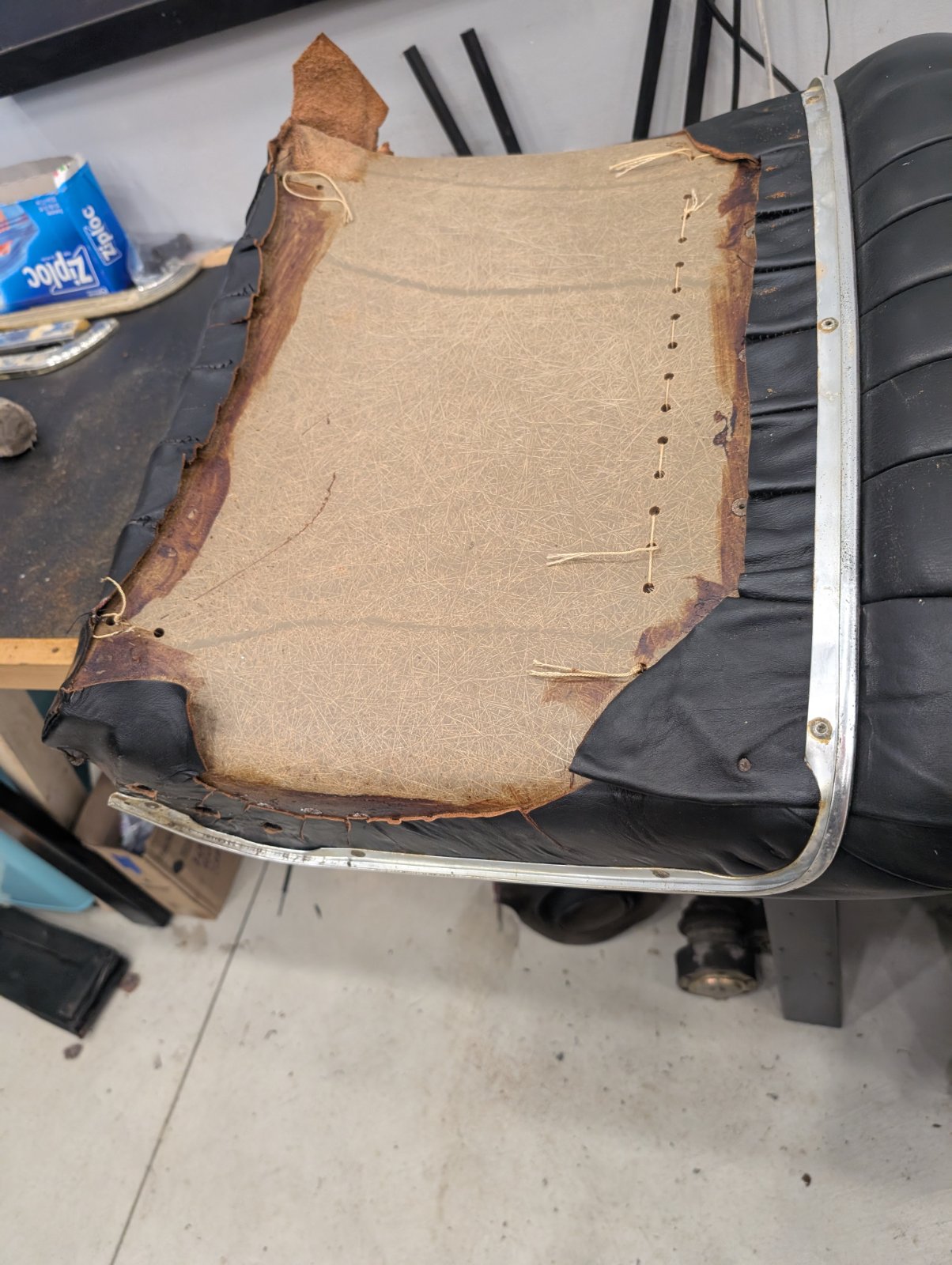

Decided to strip the last seat down... Little head start for tomorrow. This was easier than the drivers side.
Find it peculiar that this seat too had the seat adjuster unhooked from one side and obviously someone had been in there because the circlips were gone on one side and hanging on the other... What the hell were they after?
I digress. Got it all ripped down, rivets drilled out and covers off.

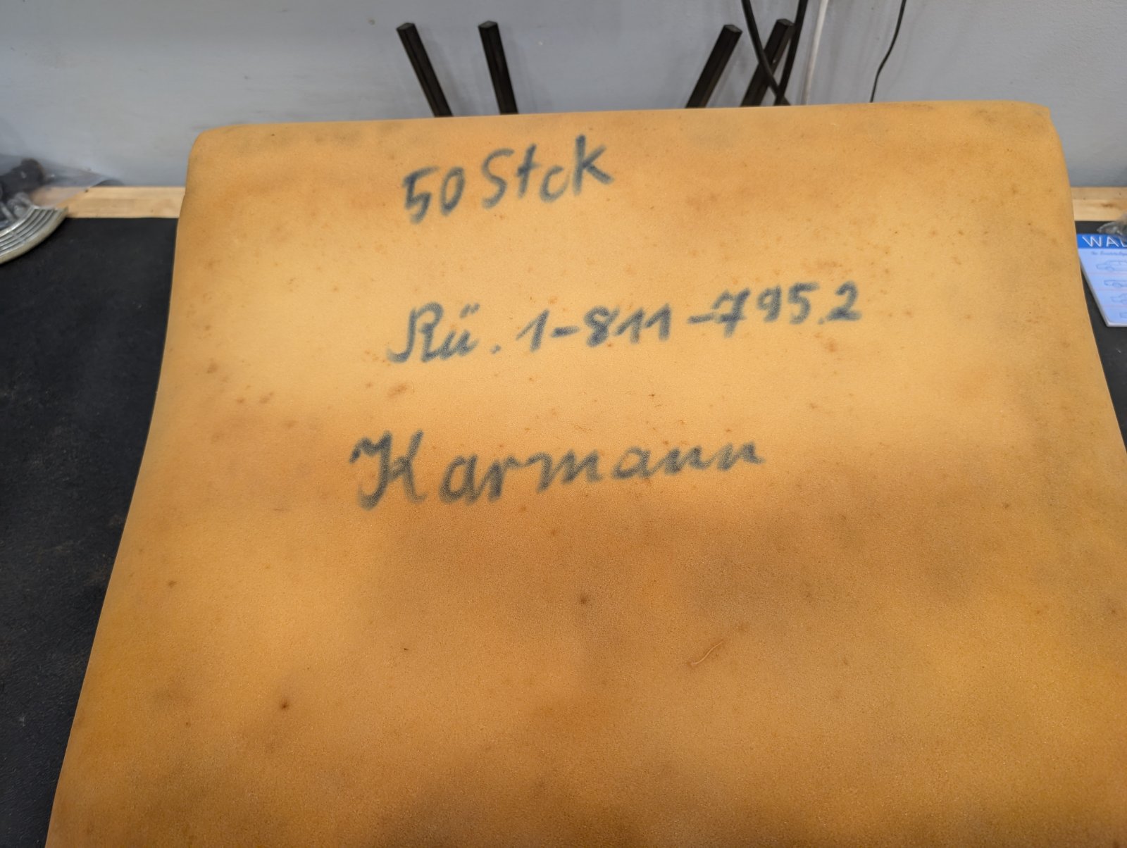

I did find something very interesting when took the material off the back. Would love to know what this means.
"Stck" is short for Stuck, meaning 'pieces'.
Karmann is the assembly plant that build our cars for BMW.
'Rü' could be for Rückseite; litterly backside or backrest.
The number seem to be a part identifier, isn't it just the partnumber? Is a similar numbering format, just 3 digits short.
I'm guessing it's from the production line.
Very cool Erik… I love stuff like that. Just the silly geek in me I guess. Obviously I knew the Karmann reference.
The guy had nifty handwriting.

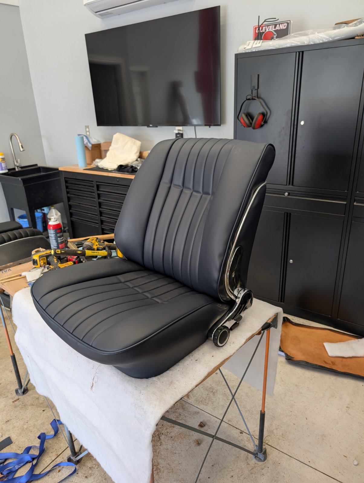

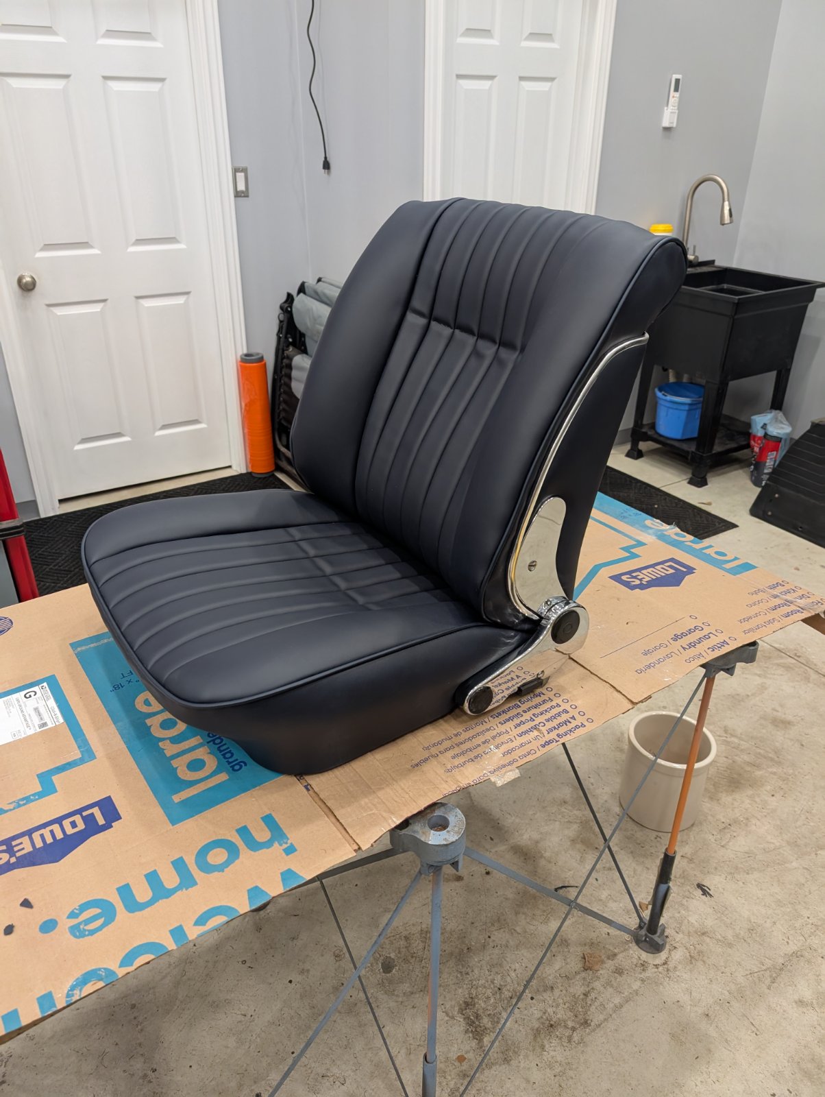

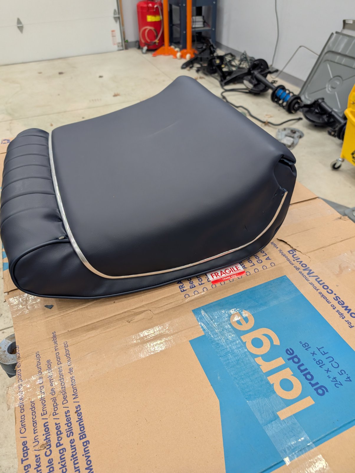

Finished the passenger seat. Much easier when you don't have to correct people mistakes.
Same gig... Covers on then line up the trim in the back. I did make sure that our seams are lined up by measuring and marking the seat backs and bottoms but the wire pockets make this a pretty simple job.
Rivets in... Push the seat back on and then screw everything together. I remembered the seat release rod the first time this time.

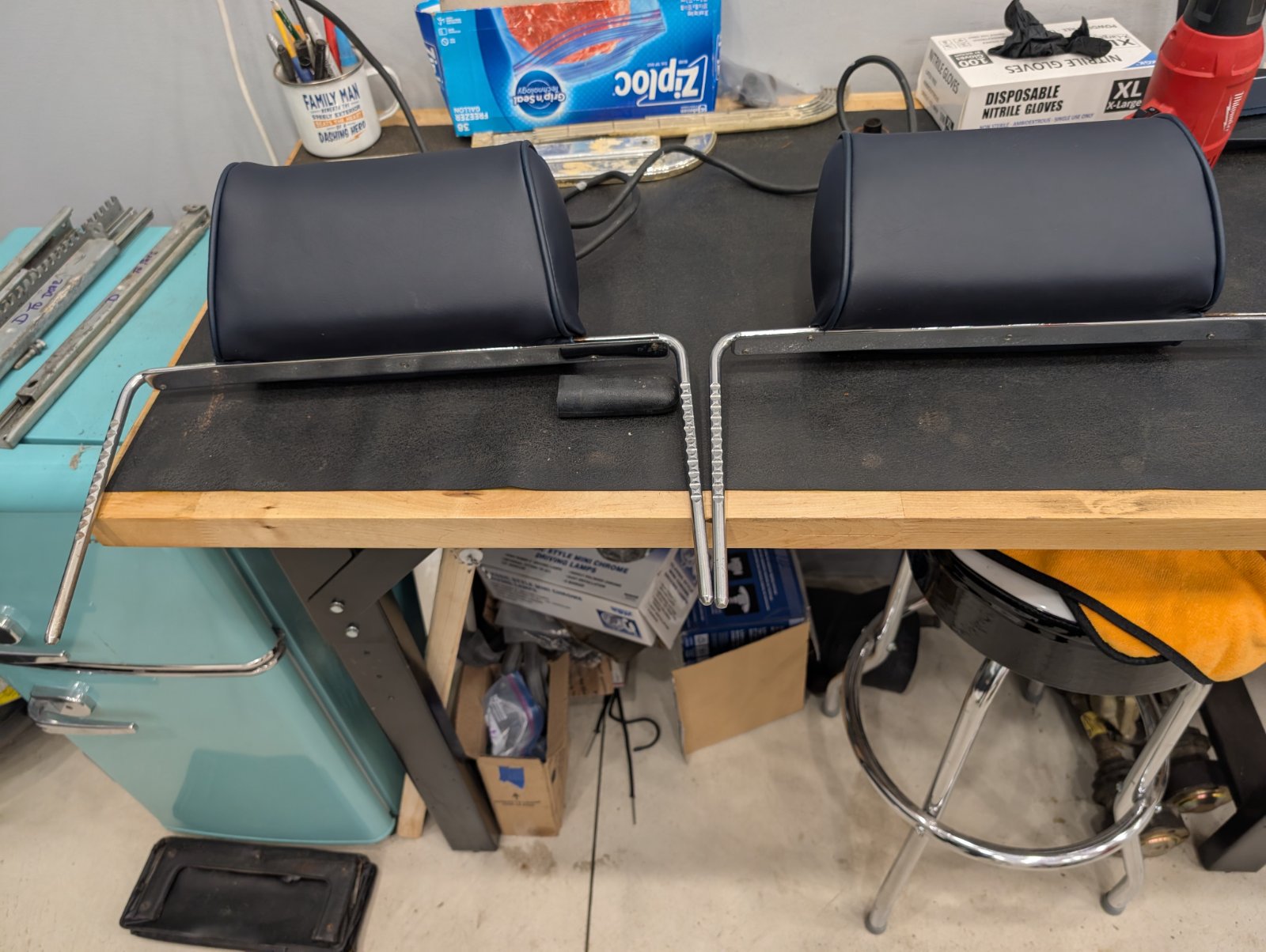

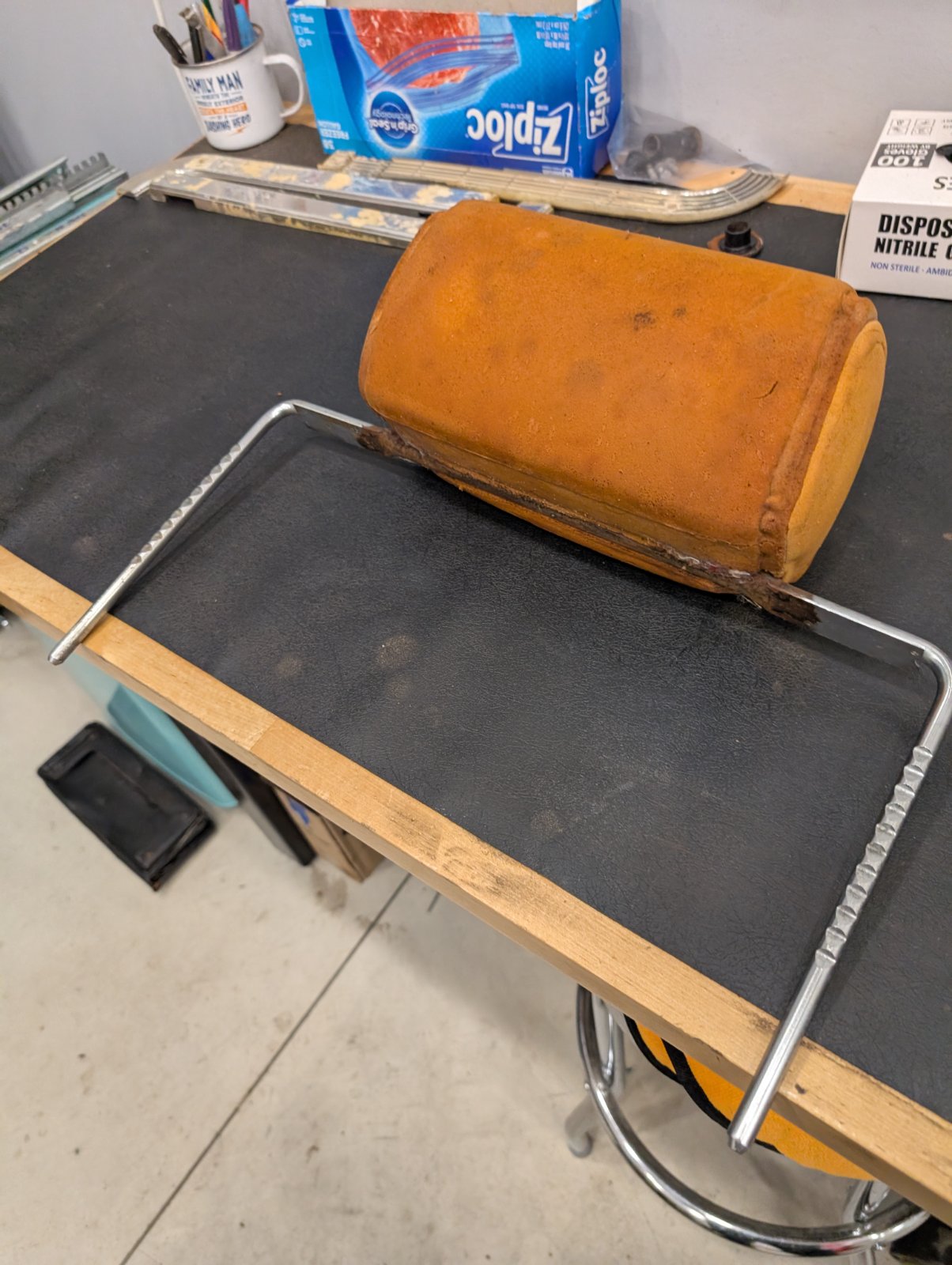

Did the headrests. Again simple... Take chrome bracket off the bottom... Slide the rubber trim corners off.
Mine will have to be painted with the rest of the black pieces... Door cards etc.

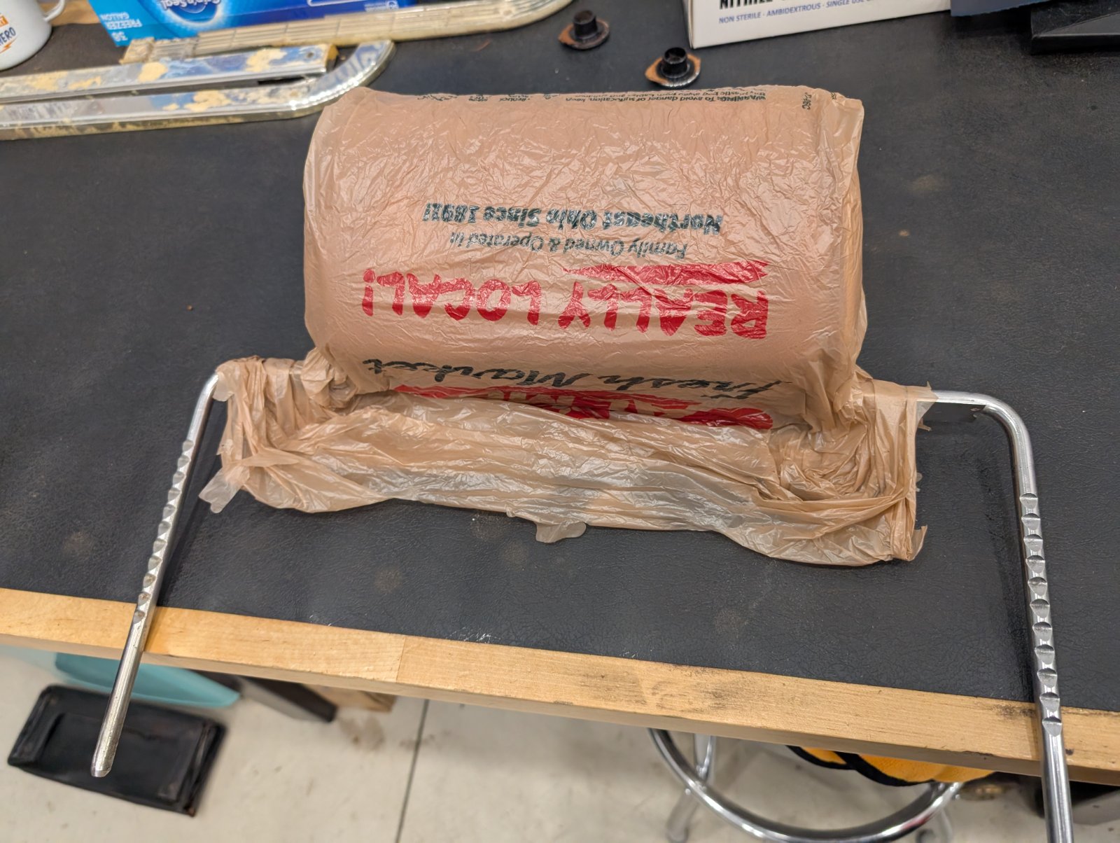

Headrests are a snug fit... For a reason. Employed the old plastic grocery bag trick as that foam is not slickery.
Trim and contact glue on the bottom of course. I put the chrome piece back on to hold it all together while glue dries fully and so I don't loose all the little screws somewhere in the garage.

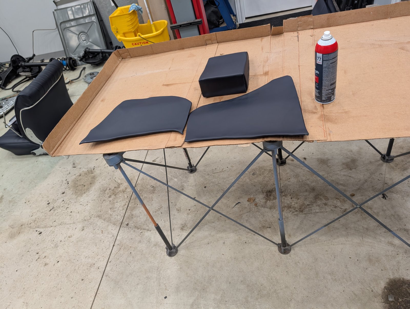

Still waiting on my paint dude. Meantime... Couple other small projects.
I purchased some material from the trimmer that did the seat covers so I could cover the ancillary pieces...

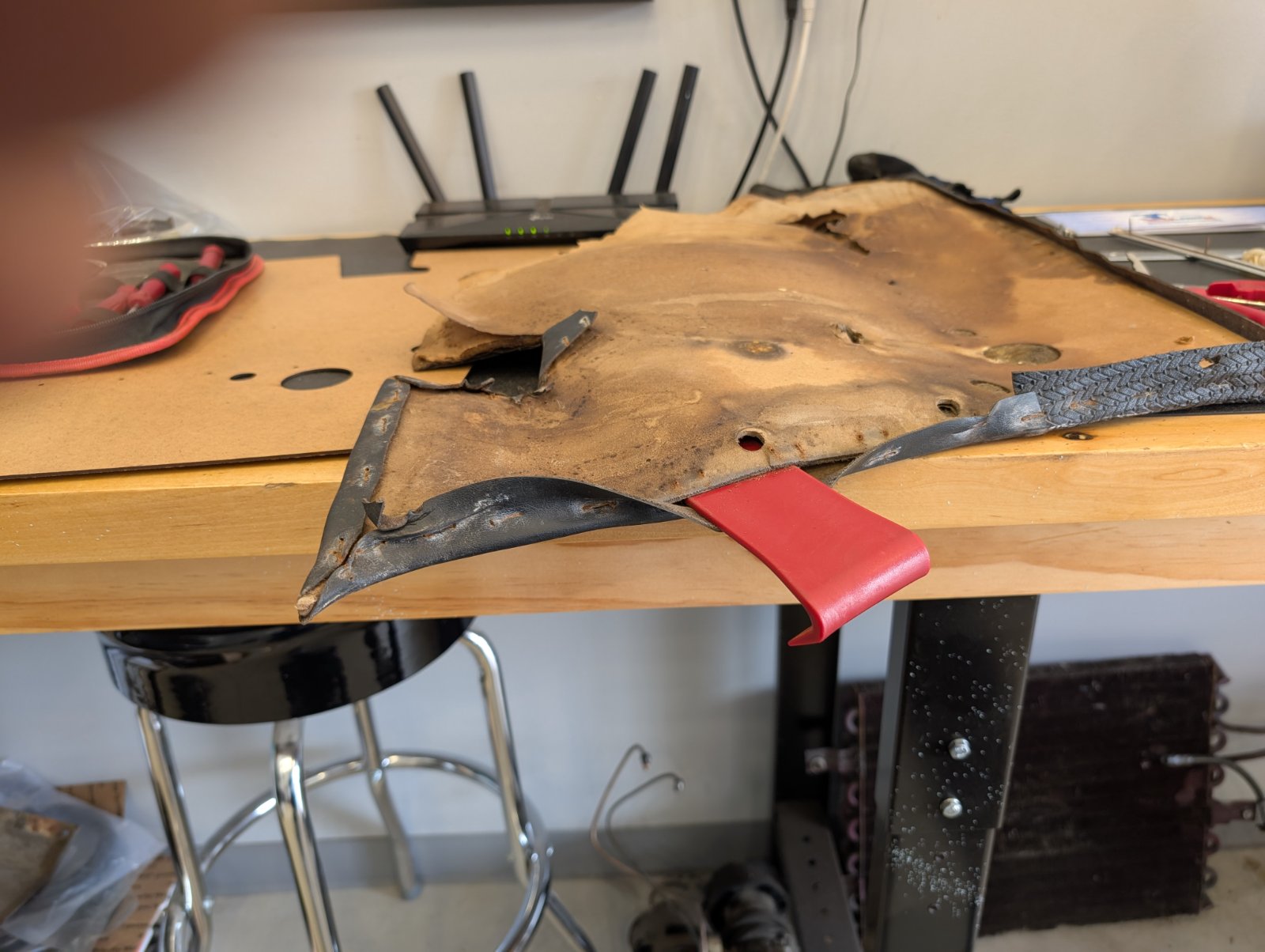

Did the front foot well pieces which were not exactly in very good shape. Some gorilla tape helped bolster the edges.

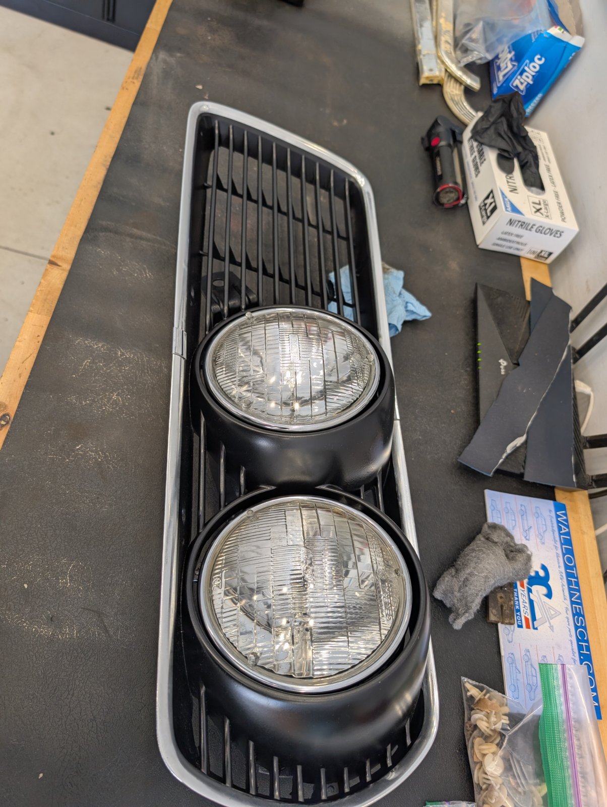

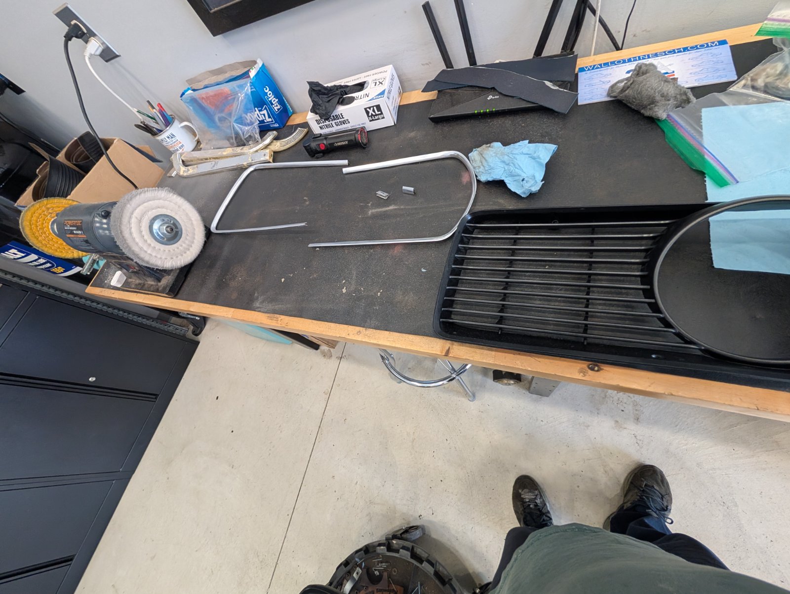

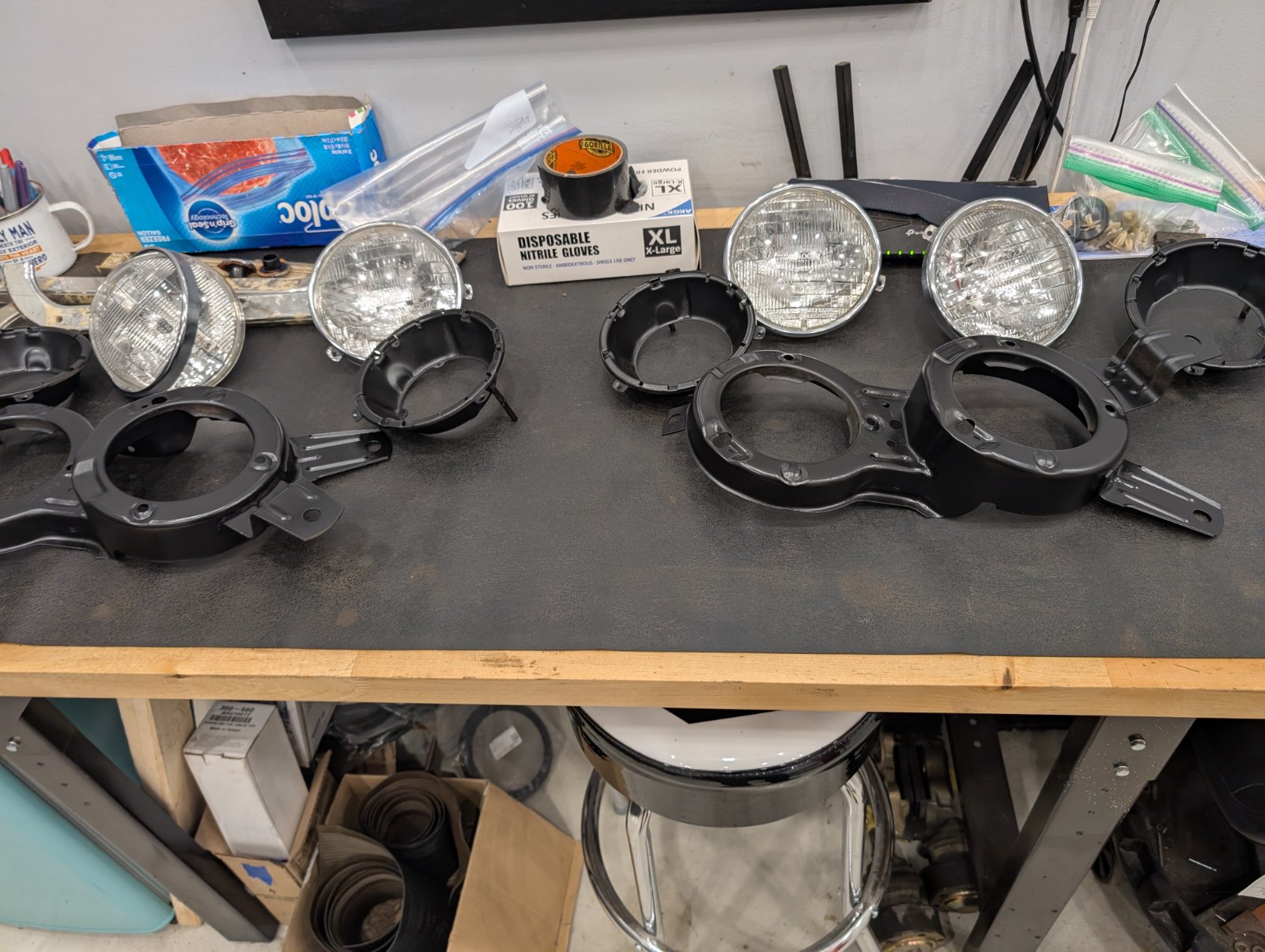

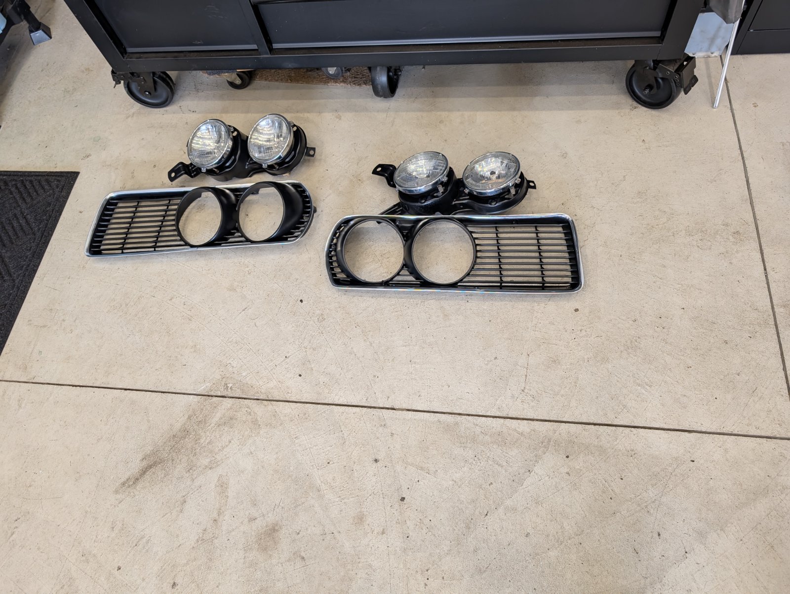

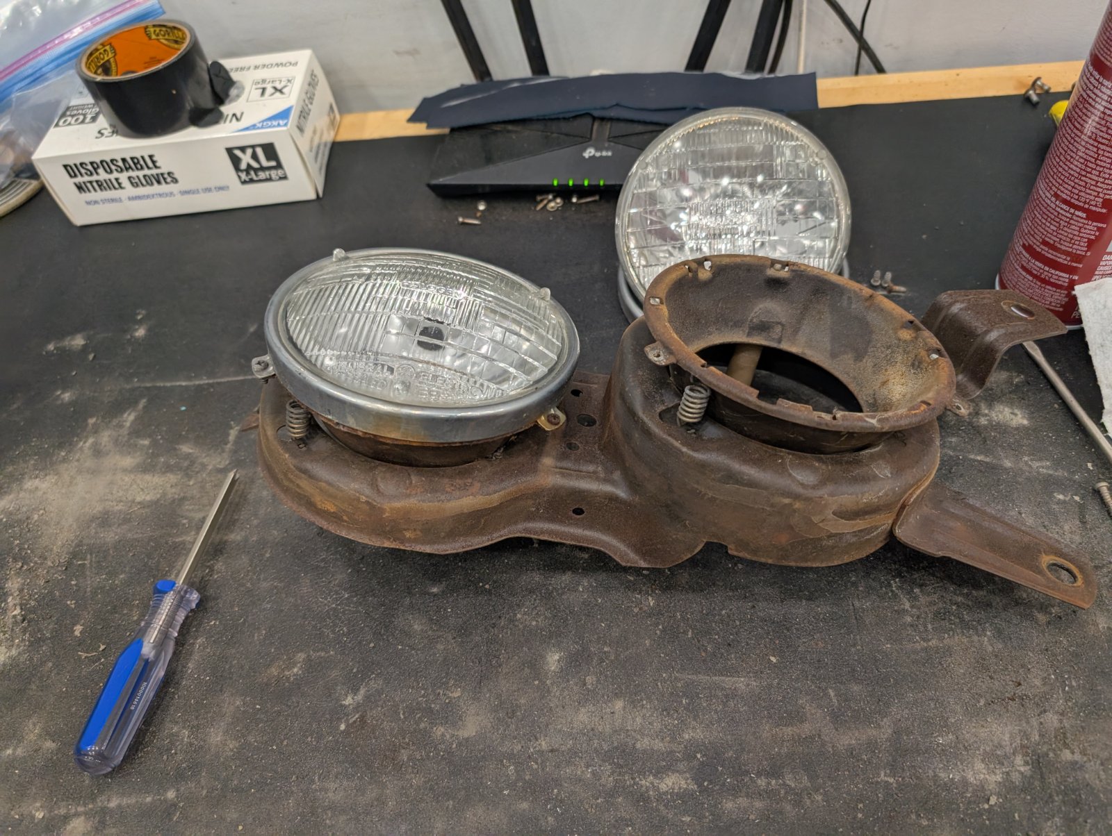

Moved to the headlights and grilles.

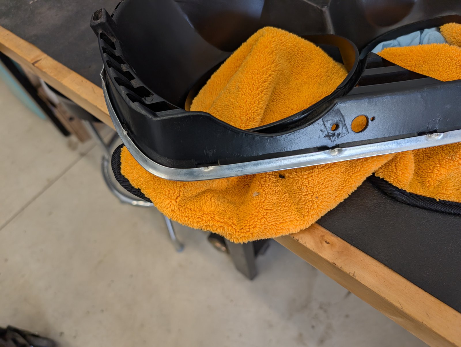

There are several good writeups here on how to carefully remove the trim. Again, patience... It's a tedious task to carefully bend the crimps out without messing anything up.
Clean, scuff etc the metal and plastic. Painted with krylon fusion satin which seems to be my go to lately.
The trim I did 000 steel wool first then moved to the buffer.... Very conscious of the warnings of possibly turning the trim into spaghetti if I misstep. Kept my fingers very close together... Little warm at times but better than a twisted pile of mess.
When assembling a towel under the trim and a pair of large pliers with a very small amount of force gets the crimps back in place.
