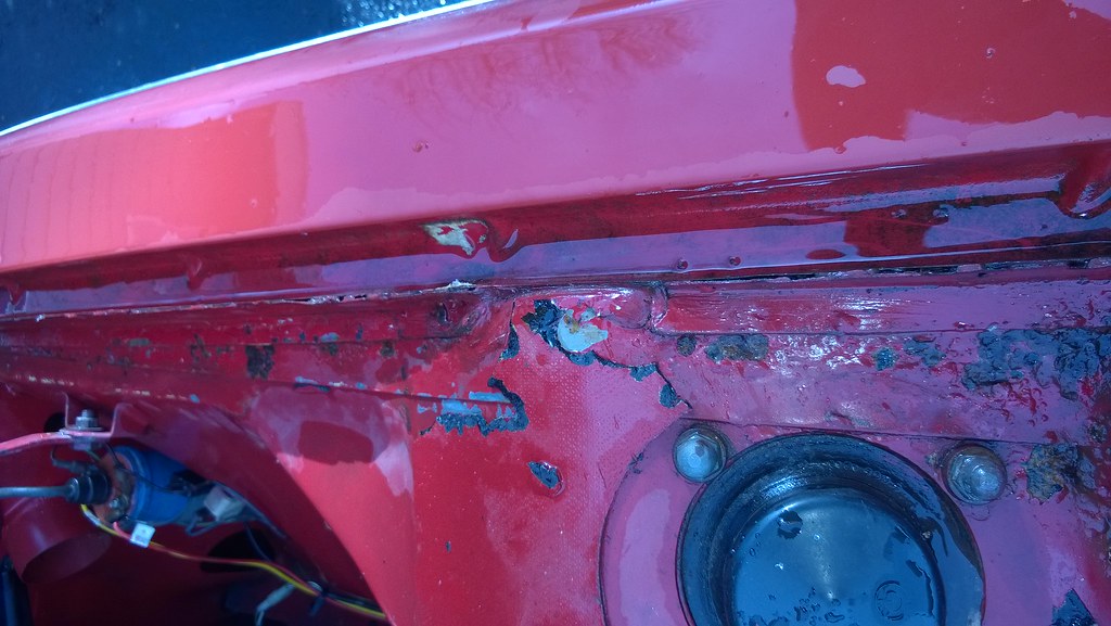

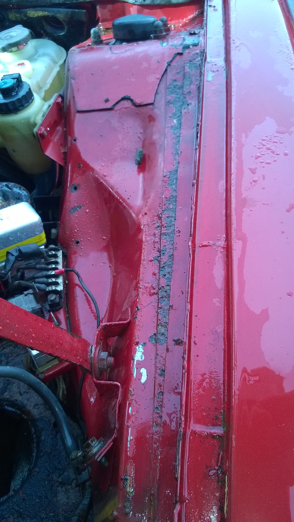

I removed all of the loose sound deadening on the fenders, to observe the rust. As I originally stated, I think the fenders look pretty good. The engine compartment hasn't been resprayed. The rust seems superficial, starting from the top, not the underside. I've seen similar rust on a $15K-$20K E9's. The pictures may portray otherwise, but I think I'm doing okay up top. The sides of the fenders have typical bubbling, so they still need to be removed.

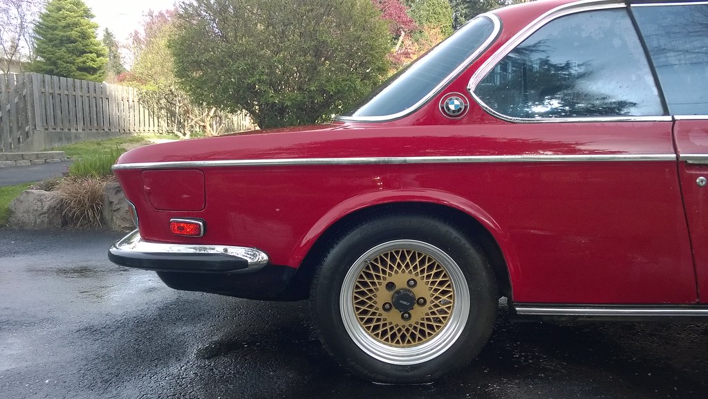

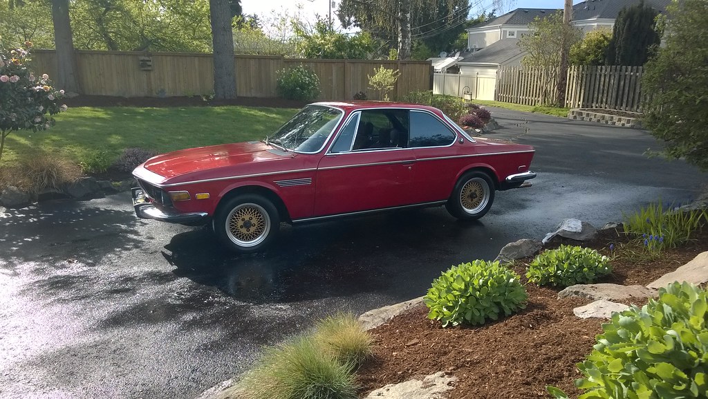

The car is starting to clean up. I had to do something. I'm leaving it in the elements until I can get the interior out and cleaned. No other financial investment as of yet.
Before I pull it inside I will take my electric buffer to it with some Meguirars Machine Glaze. Red cars tend to oxidize more than others over time, and they tend to look significantly better after you buff them.
I'm pretty certain that I will keep these vintage Enkei 92's for the near future. I'm likely going to repaint the centers silver, or gunmetal.
Markos WOW, car really cleaned up nice...didn't really expect that. Like going to the barber and getting a fresh cut, even though the grey is showing more and more, you still feel good about getting a cut. I was lucky on the Bav and not much rust but I was introduced to a product that you brush on once you remove as much rust as possible and it somehow chemically turns the rust into usable metal again. Obviously only talking about surface rust, seems to be working thus far. I can get you the name of the product if your not familiar with what I am talking about. Keep up the good work. The wife should be happier seeing it "cleaned up." Plus you have the red thing going for you. Just don't call her Ginger, she might get jealous!

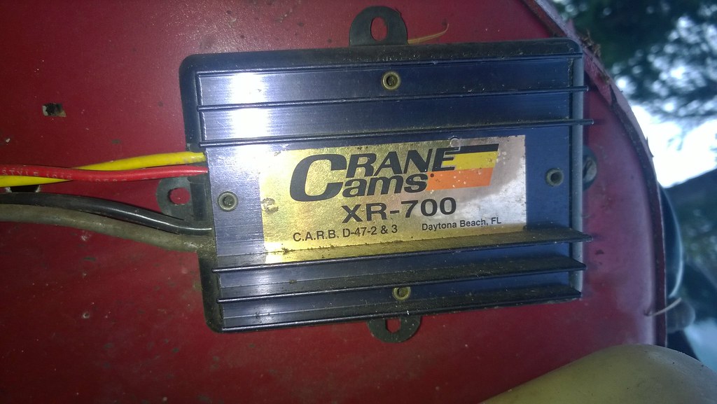

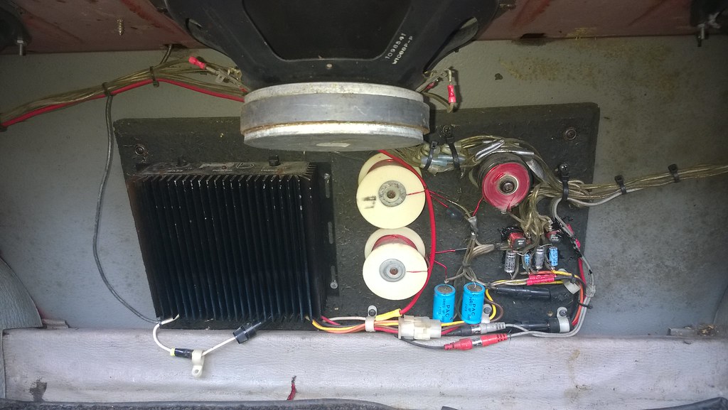

I spotted at least one home wiring nut under the dash. The previous owner had what appears to be a radio-shack built amplification system. I'll snap some pics, as it is still in the trunk.
I don't even know what I'm looking at. Sadly, I presume that I have a 6-10" hole in my rear shelf for this speaker. Nothing a little sheet metal work can't fix.
That home made amp is very cool looking, should keep is for posterity. :)

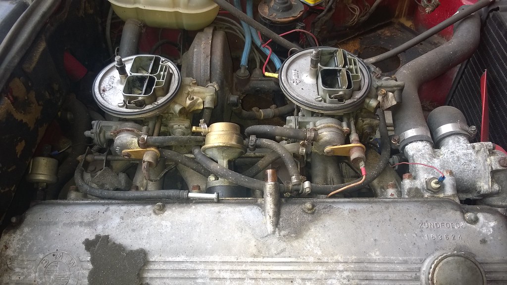

I snapped some pics of the engine. If you look closely, you will see that the fuel line is disconnected. This is where I ran the outboard gas tank to avoid using old fuel.

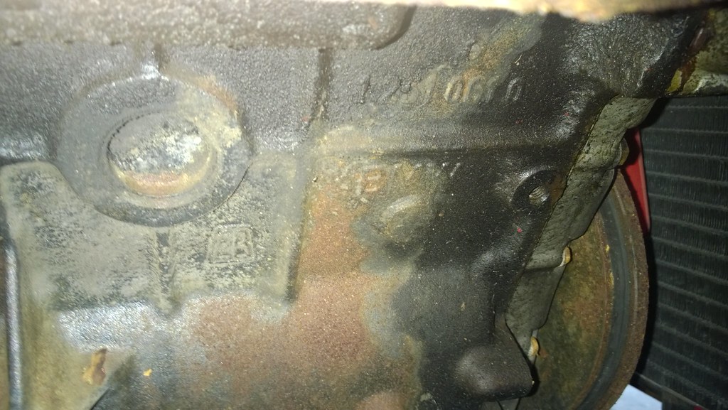

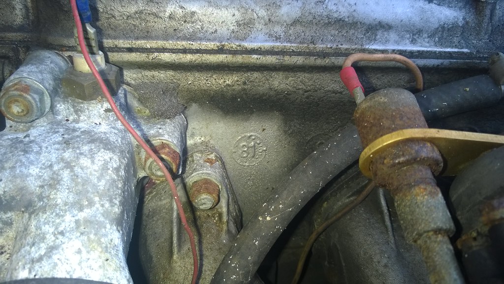

Again, the VIN is 2204650. It looks like my head is from an '81. It is my understanding that this is a 'late' head, as of 1980. I suppose the old head cracked at some point. I haven't figured out where the block numbers are. I found a set on the passenger side front of the block. Please chime in so I know where to look.
Have you drained and flushed the coolant?
The VIN number on the engine is on a pad above the starter. Should match the one on the passenger firewall and top of steering column if it's the original engine.
I'd replace all rubber fuel hoses, in the engine compartment and the trunk.
