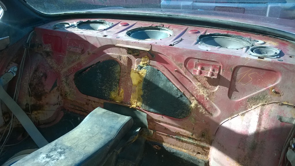

My plans to dry out the car are coming along. A big source of moisture was the rear parcel tray. You've seen the underside, with multiple speakers mounted. The top side was a custom speaker cover was what appeared to be 3/4" particle board, swollen to a thickness of about 1.5". The entire parcel tray was a giant sponge, and it is now gone. I now have a sad view of the hacked up sheet metal. I will likely fill these holes.

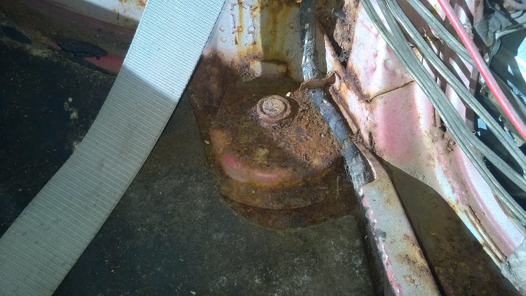

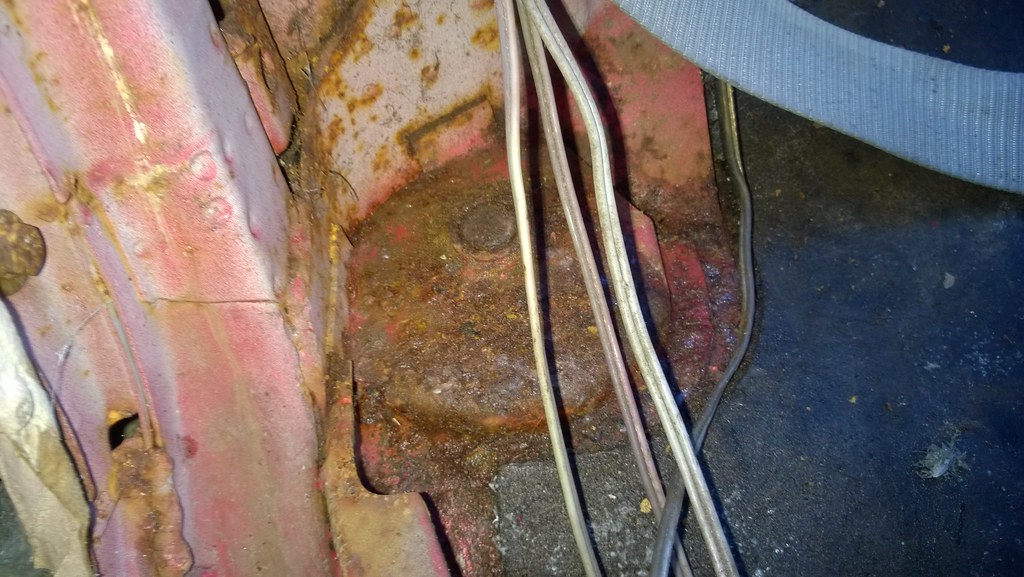

The rear subframe mounts have a lot of surface rust on the top side. I don't think it's structural.
I will likely weld on some reinforcement plates, something like this:

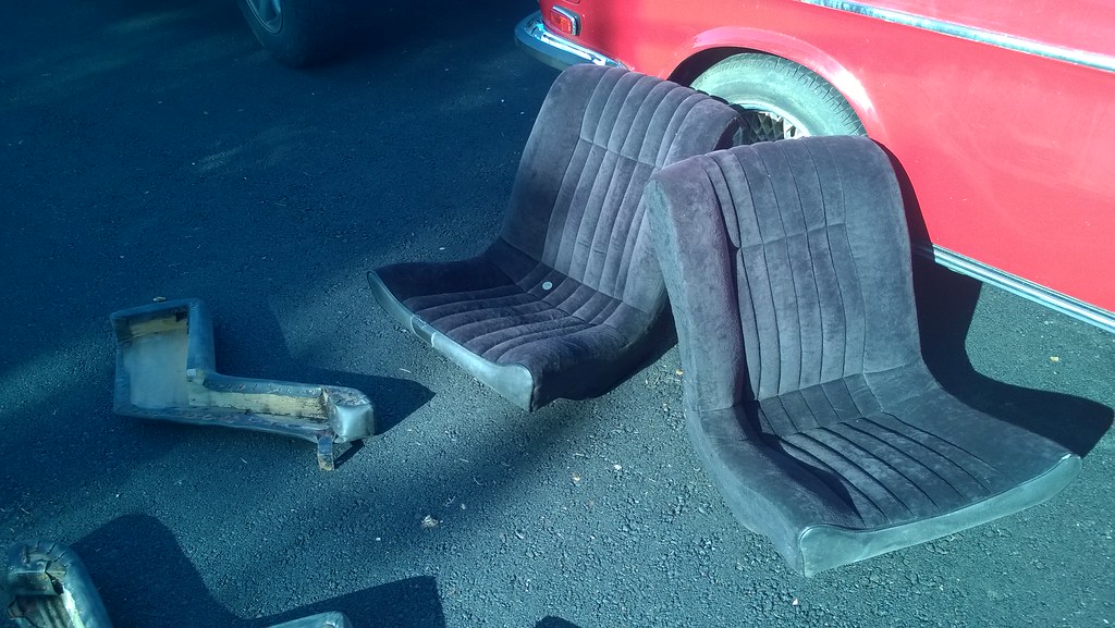

I took my seats out to dry:

Not much progress. I'm just letting the car dry out. I cleaned the garage so I now have a place to move it inside. Now that the rear shelf is removed, I can clearly see how much water makes its way in from the bad rear seal (quite a bit). Fortunately it's just pooling on the metal for now. I'm going to cover the car with a tarp while I work on cleaning the fuel system.

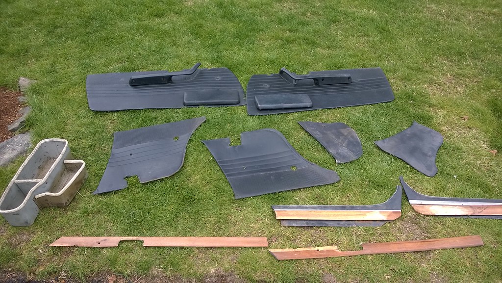

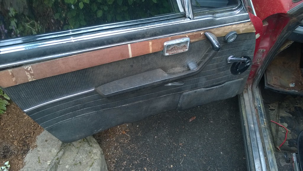

I visited a fellow forum member and bought some interior bits. I now have another set of panels and wood. Between both sets of wood, I should be able to create one good set, which will still require new veneer (which I intend to do myself). My door panels wouldn't look half bad if cleaned and sprayed black, but they have speaker cutouts that I do not want. The windows cranks interfere with them, which speaks to the terrible choice of the speaker location. In addition to being wet from a bad windshield seal, my kick panels have perforated speaker holes in them. Unlike the rest of the speakers mods, they did a halfway decent job on this. A stereo is priority Z for me. All speakers will be removed.
Total spend to date: $3,200
My existing door panels
New parts, $200

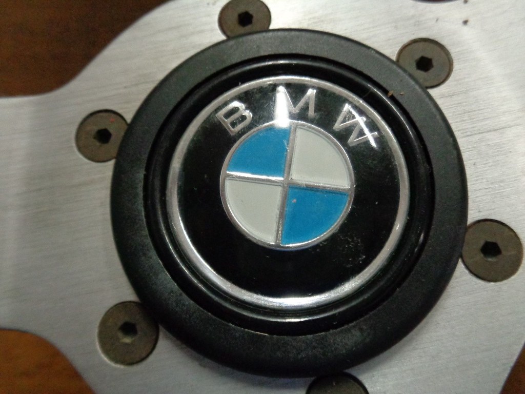

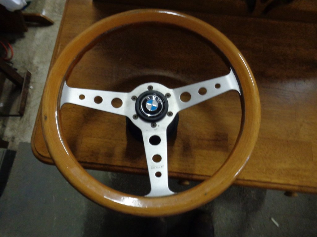

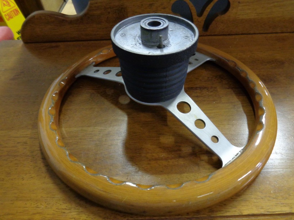

This should be the last of my priorities. What can I say, I have significantly more time available in front of a computer than in the garage. I'm not sure if I like the thickness of the wood compared to a Nardi or OEM wood wheel. I will likely darken the finish as well. I'm also not sure if the hub will fit. It looks like hubs are going for $80, so $100 for any wheel seems pretty fair. Also, no hunting for a horn button with this purchase.
Total Spend: $3,601
Vintage Momo Wheel & Hub: $170
That steering wheel does look too thick, it also has a 2002 hub since it has the brass pin in the hub. E9 hubs have a brass horn ring with pin on the steering column.
