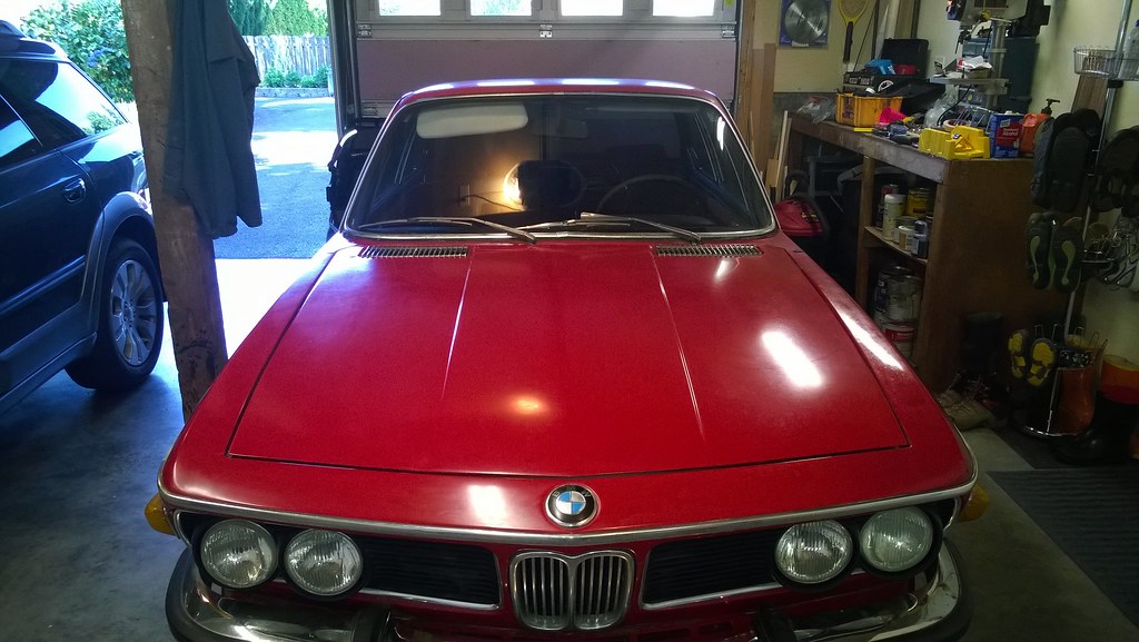

Typical update - more parts and no progress. :) A few noteworthy comments though. Firstly, the car out from under it's cover and living happily in the garage! Please excuse my messy workbench. I'm going to build a new one out of a bowling lane.

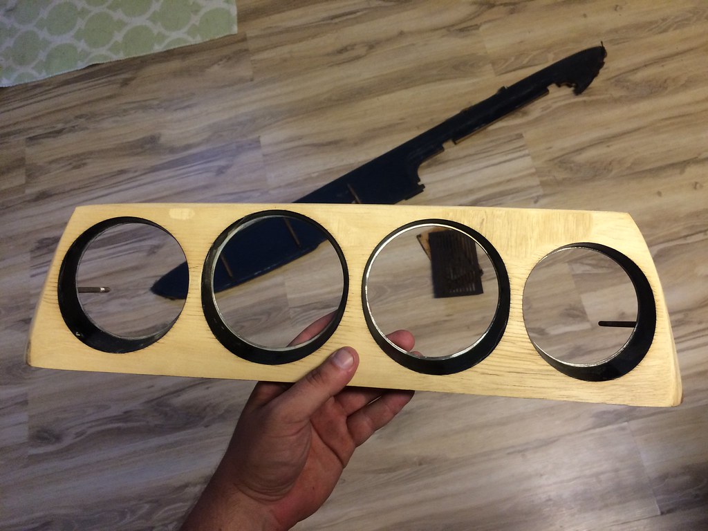

Secondly, I now have all the wood required to refresh the interior! I received a quote for a local woodworker to re-veneer and refinish for $400. Now I need to do some research. If I do it myself it will cost me $100 in veneer, $100 for a vacuum pump on CL, and just under $100 for a large new vacuum bag from http://www.veneersupplies.com/. I have to ask "will the woodworker go over $400?", or "Do I really need these veneering tools for future use?". I also only called one woodworker. I need to shop around. I have an Angie's list account, so that helps. Lastly, I may be able to veneer without using a vacuum pump. I even thought about using Ikea clothes storage bags with my shop vac. I'm excited to have these pieces, because I don't have to take my dashboard apart to work on them. That means I can leave my dash intact for a bit, since I do want to drive around a little this summer.
Total Spend: $4,598
Used dashboard wood & parts (Thanks floridabmx!): $300 + $30 shipping
Some might think I paid a lot for the wood cores. My thought process was that Bela purchases values cores at around $190 (I thought was $100, but double-checked). Wazza.csi is working on newly molded cores that would likely go for at least $300. $250 for the dashboard wood seems fair. I paid another $50 for the dashboard tray. Mine isn't in terrible shape, but the wood inserts are spongy and it may have some mold/mildew under the vinyl.
I offer a complete original OEM set restored for $990, and if someone send his LHD cores,I restore them for $800. RHD set restoration cost $900. Just FYI.
The good news is that if one disagrees about the value of used wood - one can always run down to the local salvage yard and pull a dashboard from the plentiful supply of E9 parts cars. :D

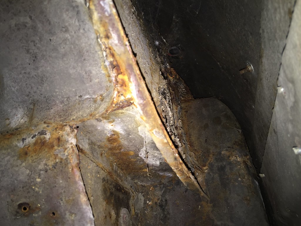

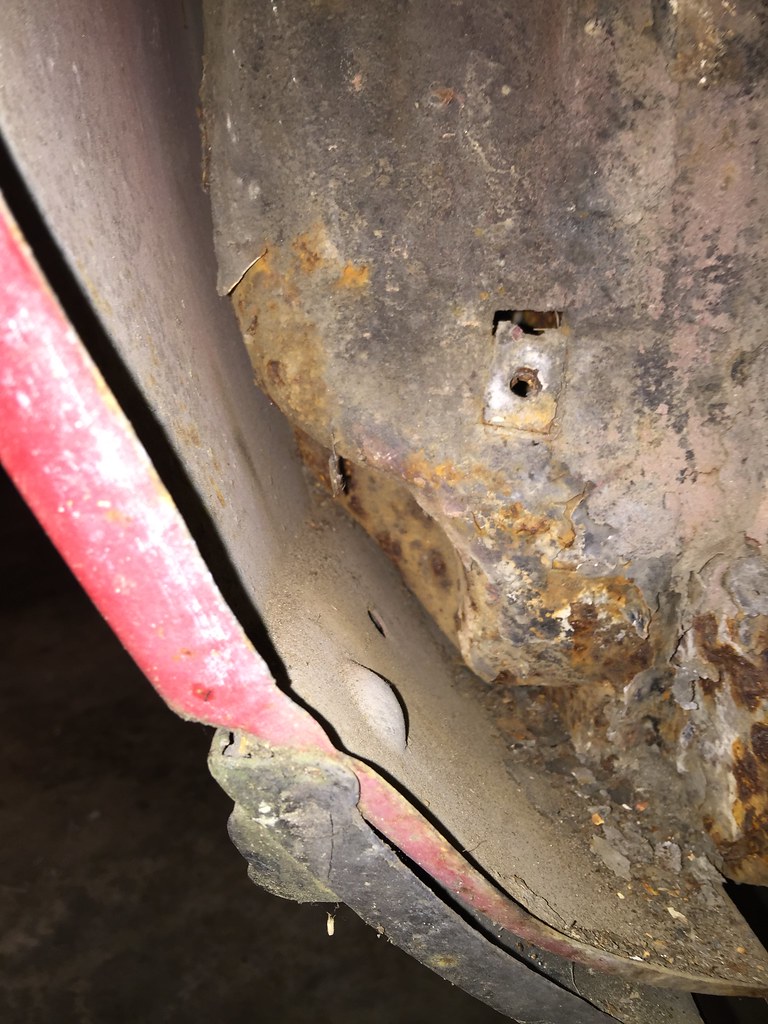

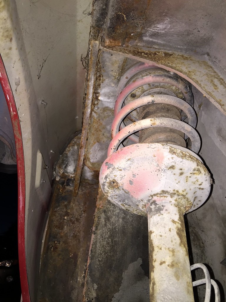

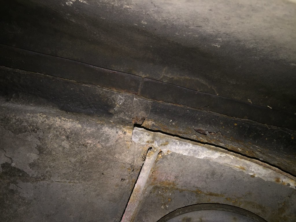

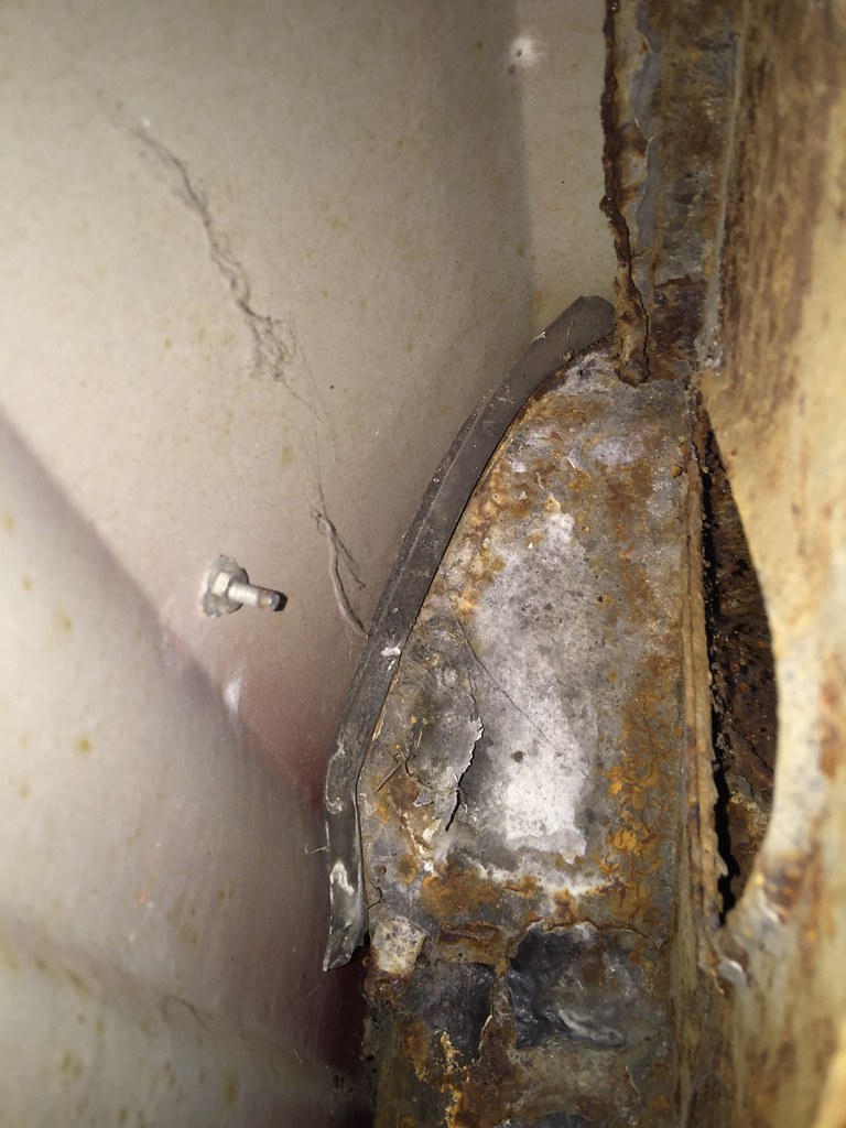

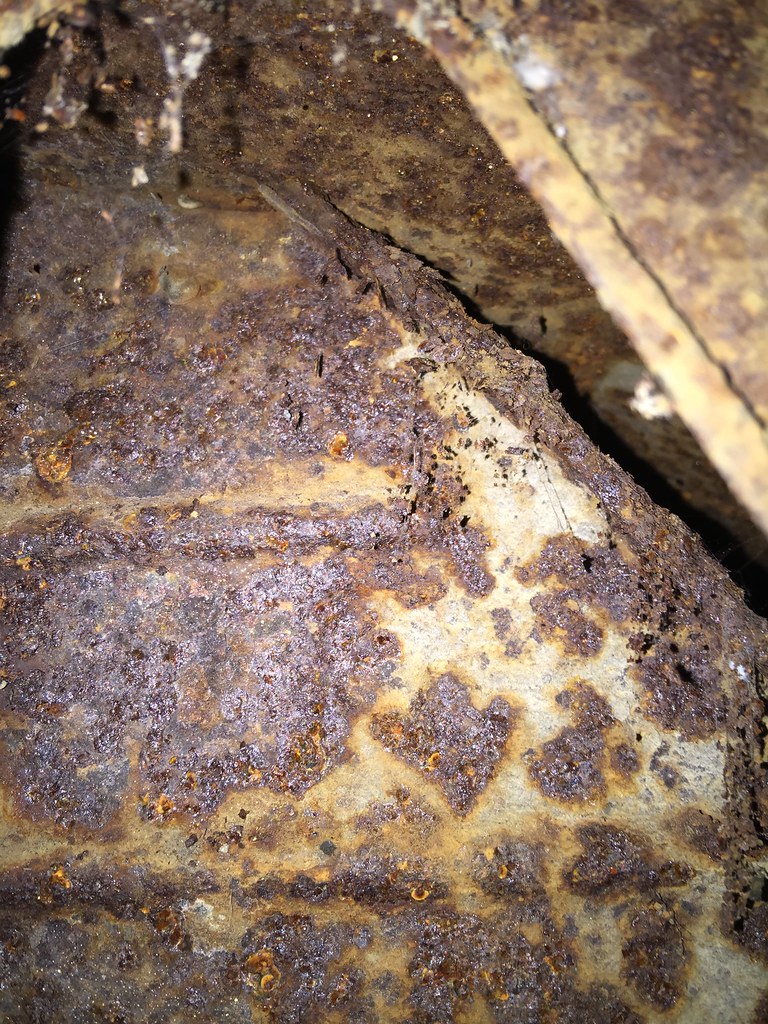

Last night while tinkering with the wheels that wouldn't fit, I removed the fender liners. I've spent the last 6 months reading about E9's, but I had a presumption in my head that I debunked yesterday. I was under the impression that the fenders were nearly inaccessible without removal. To my surprise, one has access to the entire back side of the fender while it is mounted to the car. There is no mystery as to what resides behind a lower fender that is bubbling. I learned:
My passenger fender is in great shape. You can see the factory primer, there is no patchwork, no fiberglass, no body filler, etc. The driver's fender was patched at the bottom. This is the area that I took a welding magnet to last week. You can feel the patch, which was butted to the backside of the fender. My guess is that they held it in place and plug welded (rosette welded) the patch from the front. There is likely about 1mm of body filler over the patch, which my magnet didn't like. The driver's side fender has been 'undercoated'. I have no exterior bubbles on the passenger fender, but the driver's fender is bubbling.
I stuck my giant iPhone up into both boxes. The passenger side was rusty, and may be worse than it looks. I have a lot of windshield frame issues on the passenger side. The driver's side has enough sand in it to build a sand castle. The same goes for the lower fender. There was an amazing difference in the amount of junk in the driver's side fender versus the passenger side.
I removed my antenna and let it drop into the fender about a month ago, facilitating the tarp application. I took a look at it inside the fender. It is a manual unit, made in Germany. I'm pretty certain that I will be plugging the hole and skipping the radio altogether.

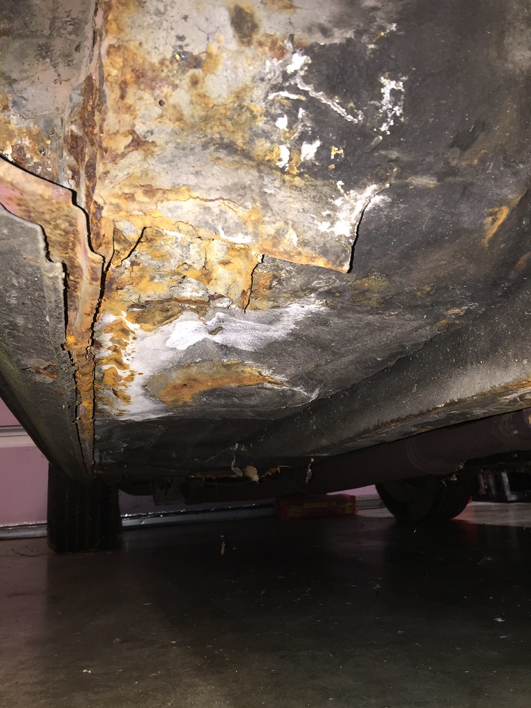

Most of the rust and discoloration outside of the fender boxes appears to be superficial. Try as I might to bust through the sheet metal with my hand, it's all solid. The passenger rocker is in much better shape than the driver's also. The floorboards are all solid, but some of the drain plugs need replacement. The front-most portion of the passenger front floorboard appears to be subjected to a floor jack. I'm not sure what the fix is there. The more I look at the car, the more I lean towards an acid dip. My biggest obstacle is time. I'm saving money on the metal work and re-spray, I wonder if I should dip the car?
Passenger Side:
Driver Side:
I just did the "put iPhone up in the crevasse" check when I did my CN springs. Mine thankfully passed, but man was it an interesting moment.
Yours honestly doesn't look as bad given the windshield rust and how it was mossed over.
I know it's all relative, but compared to some of the successful projects that started in worse shape, I think I'm doing ok. If you look at the last pic, it appears that there are holes. If you look closer, they are just shadows of flakes caught in a spider web.
