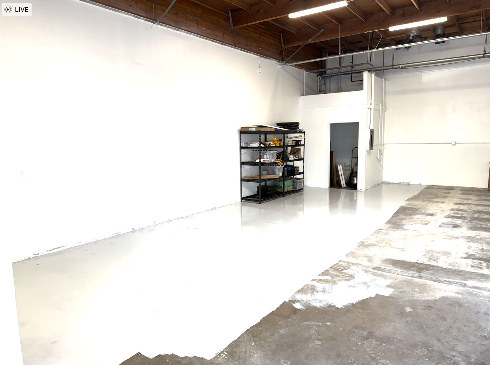

OK, so I am finally getting the stars aligned to get this project underway. As noted above, I have stored these cars (1980 635, 1972 Bronco and 1972 3.0 CS) in a converted chicken barn for about 15 years. I have been actively collecting parts for the E9 for the last 18 months or so. The missing piece was place to do the work. My home garage is used for other purposes, and does not have room, and the chicken barn was not a great place to work (on someone else's home property, no water, no bathroom, etc. ).
I finally located an industrial work space in town (conveniently, right around the corner from my athletic club!), and have been setting that up to get the E9 restoration, and the 635 refresh underway. Currently cleaning up the floors, and setting up shelving and work benches. Moving the cars, tools , etc. next week. Probably going to install a compressor and a vapor honing unit this winter..
Hope to start dismantling the E9 this winter and get her ready for paint by summer.
Really looking forward to having a large enough space to catalog and store all the parts while I am working on the body.

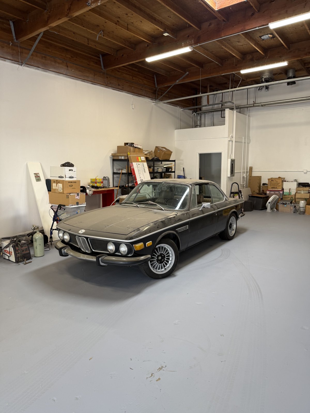

OK, progress!! I went to the barn today and changed the four flat tire 14" wheels for my new 16" Alpina replicas.
Changed the battery and turned over the engine for a bit to get some oil circulating, then sprayed some starting fluid into the carbs, and cranked it for about 15-20 seconds and she fired up!
Been a while since I have heard her run! The exhaust is clearly shot, but she revs and drives fine. I was, frankly, not expecting her to just start without some serious coaxing!
She is VERY dusty!! The trim bits are in the car...and the rocker covers are off for inspecting any rust. So far only some minor rust around the right rear rocker...
Next step is to move her to the new shop, and then do some serious rust inspection... I'll keep y'all posted!
One thing I noticed after getting into the front seat, and that being 6'2" I sm either going to need to move the seat rails back, or get some longer rails. I assume this is not a new issue!

Was in Austin visiting the kids and attending the USGP. Heading home tomorrow, and plan to move the E9 to my new shop Saturday. Once there, I can really start disassembling the car and will have a better idea of the body work needed. Exterior is remarkably straight (no visible damage anywhere) so I am cautiously optimistic!
